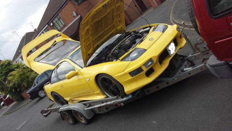

  2. Looking for Info on this 300z friend of mine has just got it supposed to have forged engine and other stuff but got few problems so just trying to track its history Mark

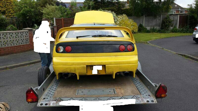

  3. Looking for Info on this 300z friend of mine has just got it supposed to have forged engine and other stuff but got few problems so just trying to track its history Mark
