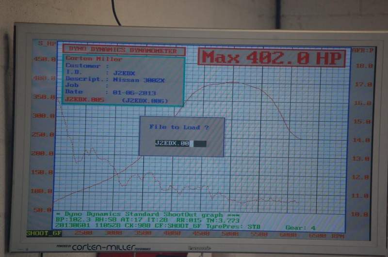

Had my car on the Dyno today, best run was 407bhp but it started climbing out the rollers so they had to stop as it was affecting the readings. The car had a misfire at higher revs too apparently, as it went on the rolling road it certainly wasn't running on all 6 then seemed to clear.

yup, running very rich, did they log AFR for the run?

the afr wasn't logged by the dyno to the look of it

Which Graph are you looking at? Also ECU doesn't monitor lambda on full throttle, it goes off the fuelling tables based on MAF readings.
Boost setting doesn't matter, the ECU should be tuned for any given load value....

AFR is in the high 10's hence the smoke. Either the ECU us way off, or you have a boost leak, or both!

I was expecting to see AFRs in the low 10s or even a couple of dips into the 9s with that amount of black smoke in places.

As everyone else has said that is over fueling like a pig! get that boost leak checker on there barry, come on this is school boy stuff you already know :P. Its probably riddled with boost leaks. whats it running uner the bonnet for those 400+ horses, if its putting that down running rich like that it will run so much better when its sorted, and I bet if that's that much crap coming out the back the plugs are probably fuel fouling hence the intermittent misfiring. On the plus side at least its not running lean hahaha
