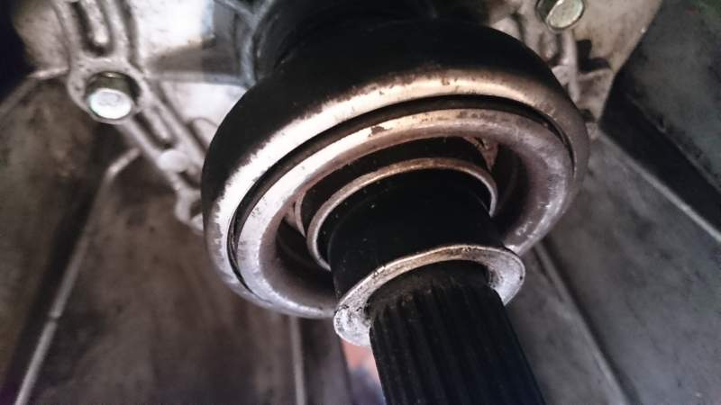

  2. All removed. Dremeled the lip off. Bearing pressed out.
  3. What`s happened is whoever fitted the clutch didn`t grind the 4mm off the sleeve and the clutch did it for them.
  4. spigot bearing? that`s in the crank isn`t it. Do you mean the release bearing on the shaft and or the bearing carrier? looking at the instructions that bearing is giken specific and i`d be replacing that with a stock one. As long as the fact that the shaft sleeve is now a bit shorter than stock and that doesn`t cause any issues all should be fine.
  5. Didn`t it just..thought i was going mad. must have been a badly fitted bearing or plate. I bought it from Jaffa who took it off a breaker. He said he drove it and the box was good. The sleeve metal is obviously soft for this reason.
  6. Well I`ve figured out that the lip looks like it`s been created by the clutch pressing on the sleeve and basically heating it up and reforming it. Giken twin plate was fitted according to Jaffa. I`ve managed to take the lip off with pliers, tomorrow I`ll smooth the rest off and hopefully the carrier should pop off. I`m guessing that`s not normal. Anybody with experience of these clutches had anything similar? Just hope the box is ok.
  7. [ATTACH=CONFIG]85012[/ATTACH anybody know? I thought it was just on a shaft. Not with this lip.
