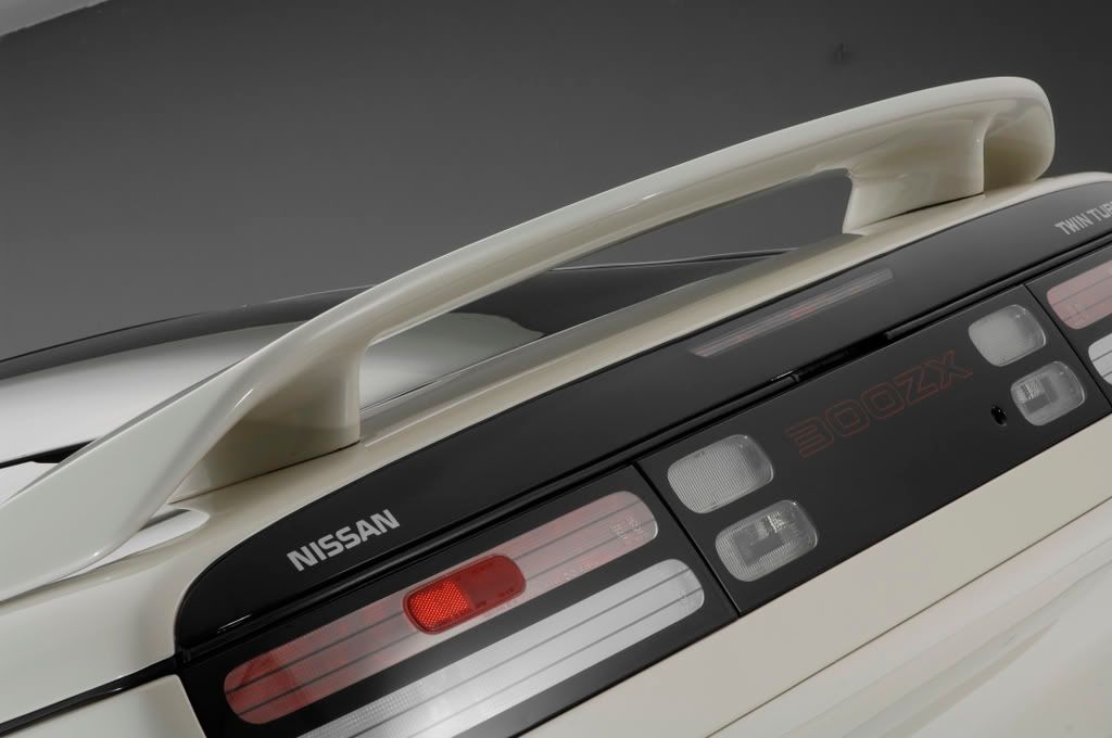

just bought some of these, should arrive in the next few days, do you have to do that heating up of the original lights to get them off the car, and what do you use to reseal the 99 spec lights so that water doesnt get in
Yeah, they are easier to remove if you warm up the panels to loosen the tar. You'll also get new rolls of tar with your new lights if you're buying brand new.

do you heat up the standard lights from the inside or outside, i tried to do the replica 99 spec lights on some spares i bought and no matter how much i heated the lights they wouldnt come apart.
Heating the lights themselves to split the skins is much harder than removing the lights from the car itself. Take all the trim out of the boot along the edge and heat the back of the lights so the metal they mount to becomes warm. Make sure you remove the centre peice first as you can use the edges of the lights to pull on.
did you buy the 99 spec centre too, i havent bothered yet, wanted to see how the lights looked first, not sure on the red lettering??
Yes I did. I prefer the chrome bezels in the centre panel as they match the lights.
Advise on taking the centre panel off first for easier removal of the lights.
i found that i didnt need to heat anything when removing the lights from the car, just a bit of 'gentle persuasion' but better safe than sorry i guess! possibly in this weather you might not need it tho?
no need to heat. Just unbolt them all. Remove centre section first (its not sealed on), then gently work the rear lights, bit by bit to pull them out. Once they start pulling away you can use a flatblade screwdriver to seperate some of the tar/glue stuff.
I found it easier to heat them. I didn't want to break mine or crack them as I sold them on as a near-perfect set which Glenn used to make is J-spec replicas.

are they the red on top & white underneath ones (insted of orange)
Yes. You can pull the lights apart and make replicas, but they don't look as good as the genuine thing. But they are a big improvement over the original ones.
