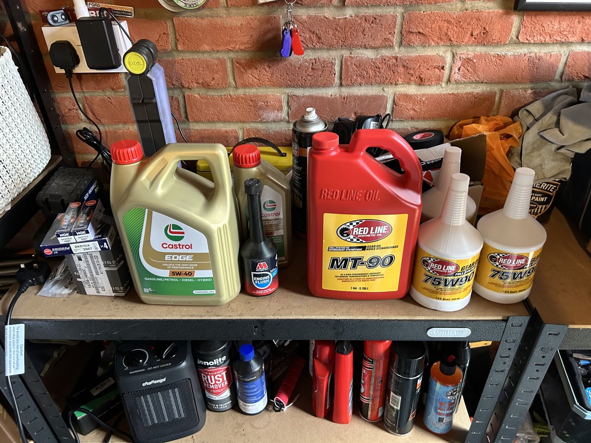

Took the car out for the first proper drive since it passed. Belts haven’t been done since 2004 so didn’t wanna risk driving it much or giving it any heavy revs so just wanted about.
So took it to the garage for a belt service last night via Shell for some fresh V Power and a shot of Redex.
Belts and water pump being done by the garage but when it’s back I’m doing engine oil, filter, air filters, new spark plugs, new gearbox oil and new diff oil too.

Good call on the Fluid choices Rob.....😉
You won't need the extra litre of engine oil though - capacity is just under 4L with the filter change. Save that one for topping up, if you ever need to, that is!
They only sold it in 5 litres so to get a 1 litre and a 4 litre was a bit annoying! 😂

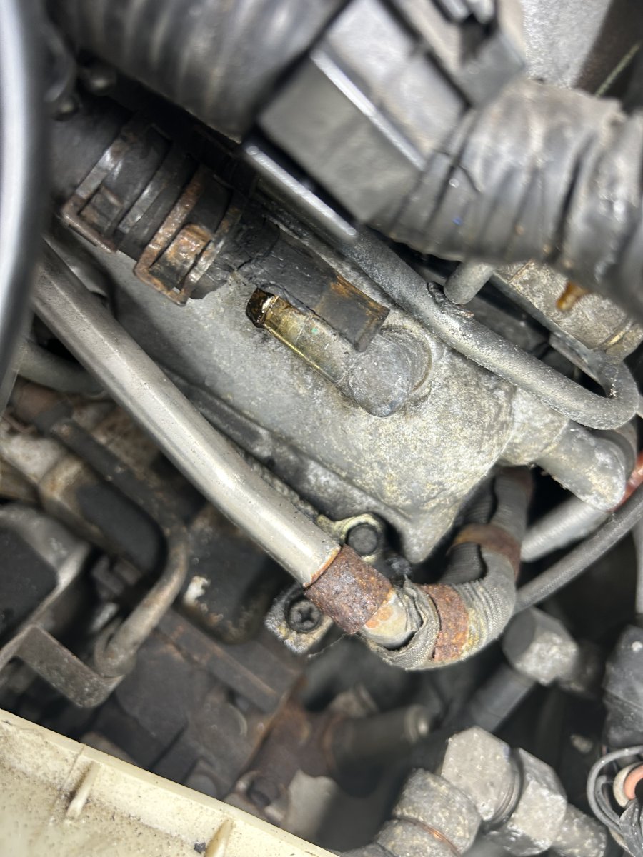

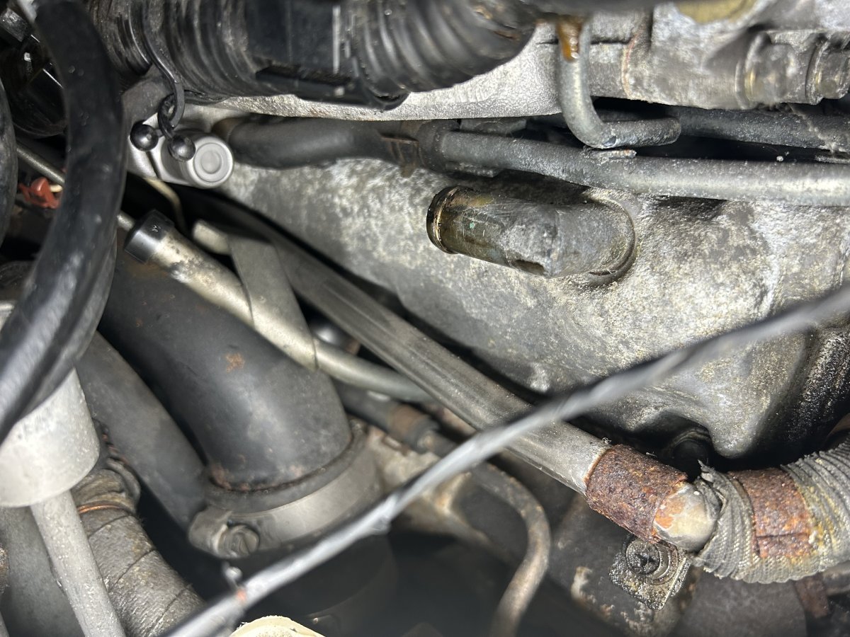

New PCV valves in. I didn’t have replacement pipes, and managed to get the old pipe off without destroying it.
Different story on passenger side. Had to cut that one off annoyingly.
Got the new valve in and have ordered new Nissan pipes for both sides.
There was a lot of oil in both pipes so will swap them both out. Will be a few weeks before it arrived though as it’s coming from Japan and they’re on a weeks holiday!

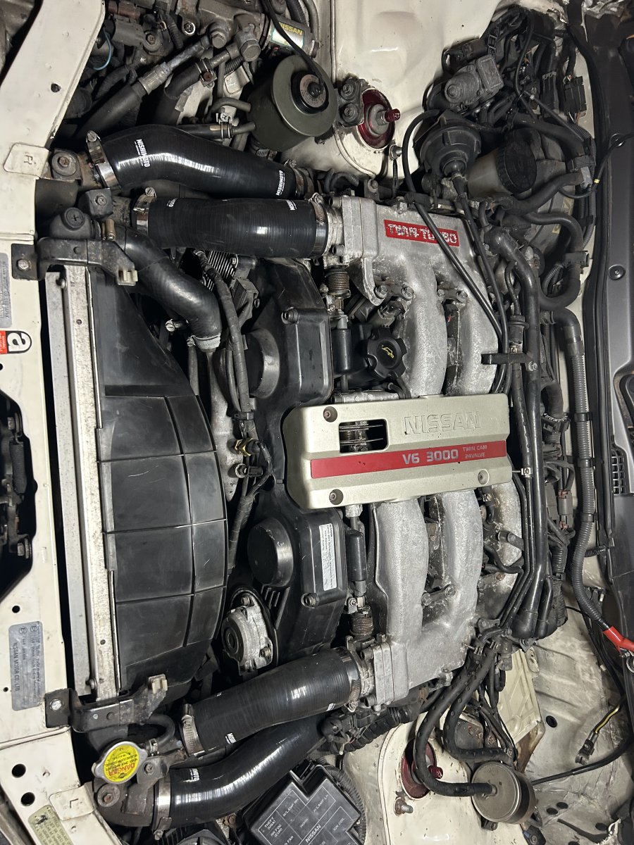

Also replaced my air intake hoses with some lovely looking silicon Mishimoto ones. The old ones were is really good shape still to be fair but the new ones do look tidy!

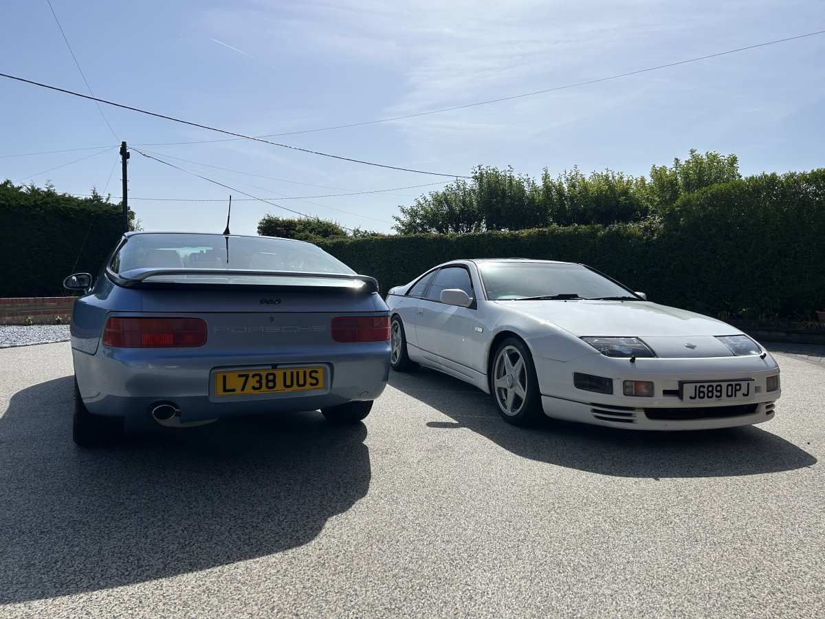

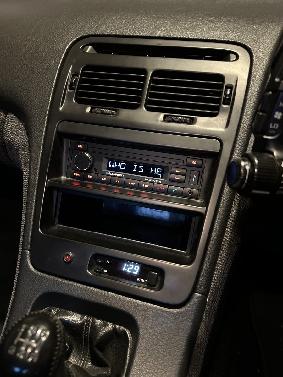

I did install a new cheap stereo so I can have Bluetooth! Went retro as it kind of suits the age.IMG_8764.jpeg

Thanks mate, it was only a cheap one but I think it looks the part!

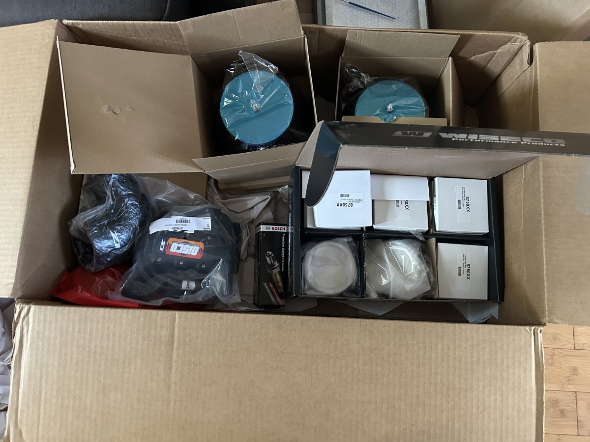

After many busy months and some waiting around for Z1 and CZP in the USA to get some stuff on back order, all my parts have arrived!
I’ve somehow ordered two wiring harnesses though so will send one back. I’m easily confused by things.
Opening those boxes were proper exciting!
Cars off to Jim in October, and I cannot wait to get it back! Typically it’ll be in the middle of winter but I don’t care!
In the meantime I’ve got to convert my utility room of my new house back to a garage to fit the car in to!
Some of the bits I’ve got:

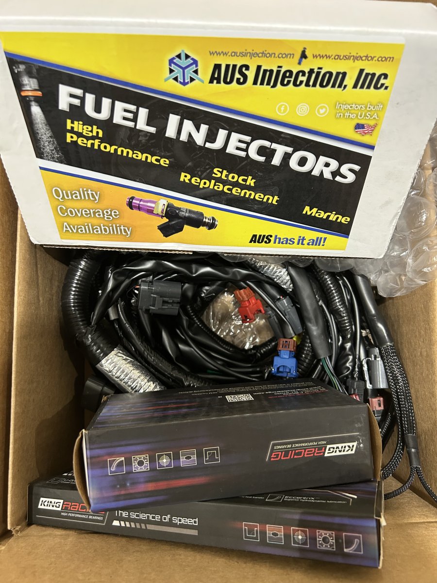

  • Wiring harness

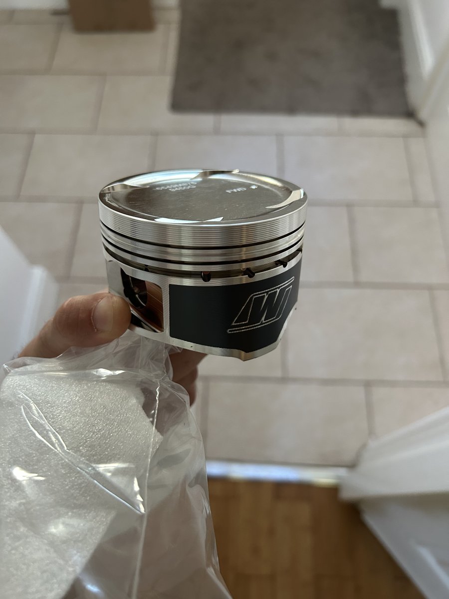

  • 750cc injectors

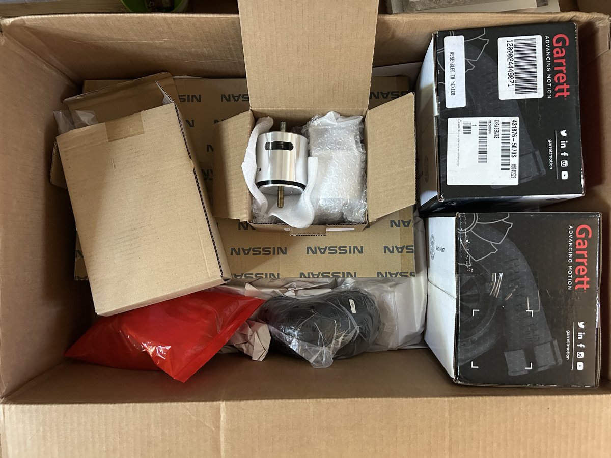

  • Garrett turbo cores
  • Forged pistons
  • Dual intake kit (for the noises!) and MAF kit
  • Race bearings
  • Z1 PCV hoses
  • Urethane motor mounts
And other new pipes, tubes, gaskets, thingamujigs and wassits.
