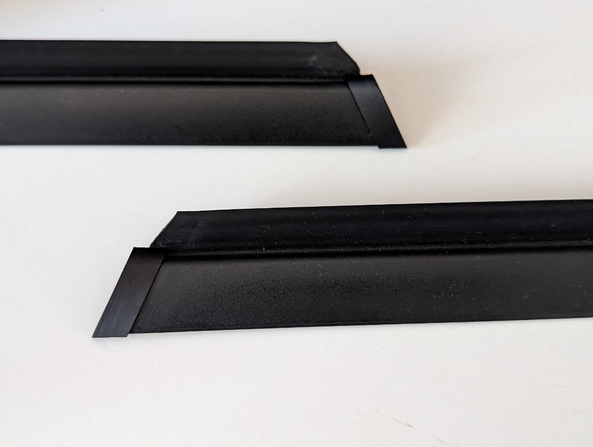

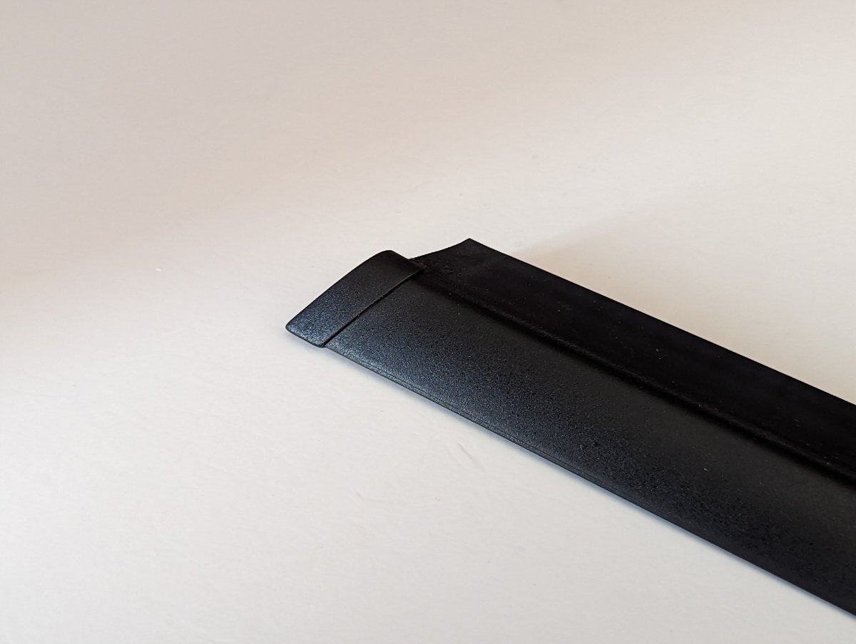

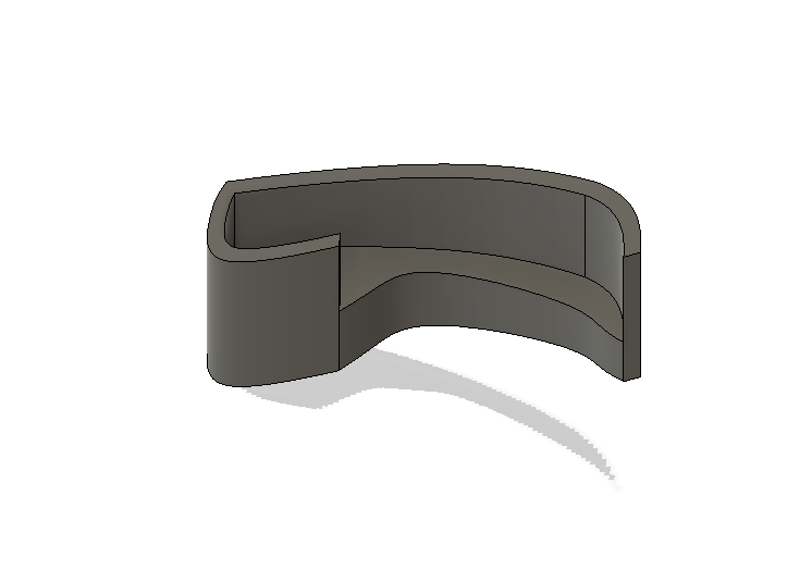

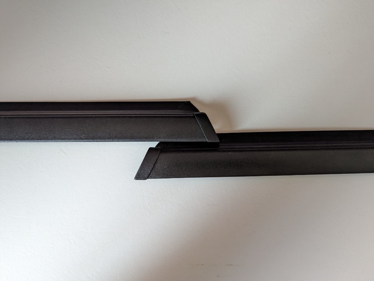

Here is a look at the product below. All pictures are shown fitted to my own refinished set of OEM moldings...
3D Model:
"Raw" finish:
Refinished to match my own refinished trims:
