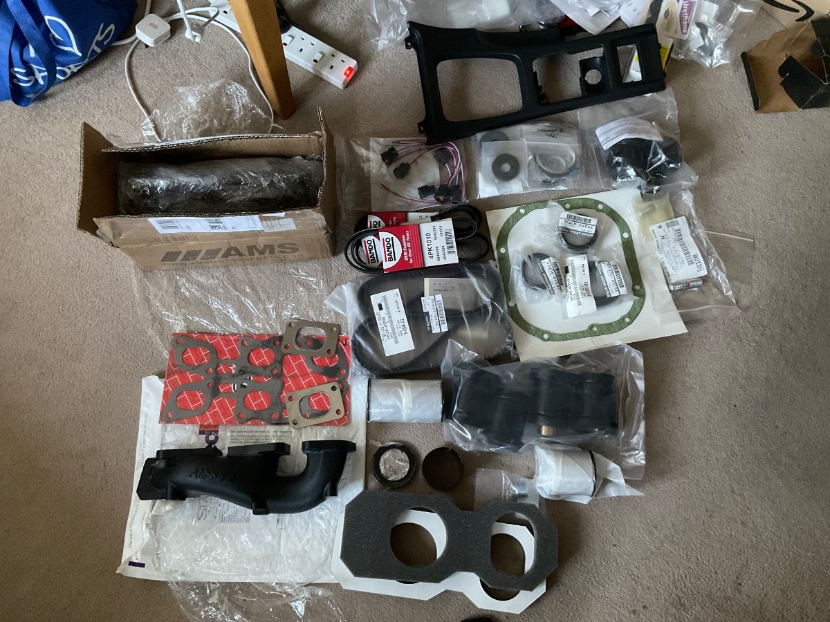

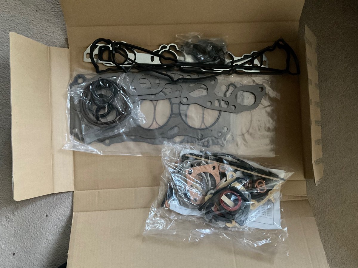

  • Collecting parts for the rebuild.   Nissan OEM Timing Belt - Nissan 300ZX Z32  Part #: 13028-45P86     ZSpec Design Outer B-
49D15169-000D-429E-B466-F1D31F560044.thumb.jpeg.e8ea94cb797f535551587e6b423e6664.jpeg2C6A2B4A-B7C0-4089-9607-44EF7BC01910.thumb.jpeg.45dde2d6203b151d3cd65bf27b8c0883.jpeg4579E679-F0A7-41F4-ACE5-EEF20BAFF13C.thumb.jpeg.07a71e1f2c911e6e98d1fdbe680971f1.jpeg7D2C83BB-44DC-4BCC-87E3-5A0C34EDBA64.thumb.jpeg.bb3166509a4dcbe7762bc3af42afaf39.jpegCollecting parts for the rebuild.
Part #: 13028-45P86
  ZSpec Design Outer B-Pillar Finisher / Cap "WITH Z" - SOLD PER SET (Left/Right) - Nissan 300ZX Z32
Part #: Z32BPLRZ
  Nissan OEM Rear Bumper Grommet - Nissan 300ZX Z32
Part #: 01281-00701
  CZP OEM Replacement Headlight Foam Seal - Nissan 300ZX Z32
Part #: CZP-62568-40P00
  Bando Drive Belts, Complete Set of 3 - Nissan 300ZX Z32 || Model: Twin-Turbo || Year: 1990-1993 || Crank Pulley: Stock or Stock Sized Pulley || Water Pump Pulley: Stock || Power Steering Pulley: Stock
Part #: BPK-Z32
  Nissan OEM Differential Drain Plug - Nissan 300ZX 90-96 Z32
Part #: 32103-U840A
  Nissan OEM Nismo JDM 1999 J-spec Front Bumper Mesh Grille Clips - Nissan 300ZX Z32
Part #: 62318-VP100
  CZP Subframe Sleeve Kit w/ Energy Suspension Bushings - Nissan 300ZX Z32 || Bushing Color: Black
Part #: 55400-74102G
  AMS Max Flow Upgraded Exhaust Manifolds V2, Twin Turbo TT - Nissan 300ZX Z32 || Hardware and Gaskets: Add Hardware and Gaskets (+$50.00) || Ceramic Coating: Black (+$100.00)
Part #: AMS-MXFL-EM-KT
  Nissan OEM 300ZX Rear Rotor E-Brake Adjuster Cover Plug - 90-96 Z32
Part #: 41098-08G10
  ZSPEC Radio Bezel Top Screw Cover (1 Pair - Left & Right) - fits: '90-96 300zx
Part #: Z32CNRPCS-00843612101952
  BlackholeZ Rear VTC Solenoid Caps - Nissan 300ZX 90-95 Z32
Part #: 23790-CZP10
  Nissan OEM 300ZX Center Console Finisher - Z32 RHD (Right Hand Drive)
Part #: 96931-40P00
Nissan OEM Interior Screw Radio Bezel Finisher, Black Head - Nissan 300ZX Z32
Part #: 01451-00801
Image BlasterZ Complete Accent Stripe Kit - Nissan 300ZX Z32 || Chassis / Model / Front Bumper: 2+2 4-Seater / NA or TT / JDM
Part #: BZ-990KT-4S-TT-JDM
Image AUS Injectors Early to Late Upgrade 370cc / 380cc Set w/ Optional Adapter Kit for 90-94TT - Nissan 300ZX Z32 || Adapter Kit Option: Add CZP Adapter Kit for 90-94 Twin Turbo Models, includes NEW Top Caps w/ Connectors (+$119.70)
Part #: 10491-380-6
Image Nissan OEM Differential Front Seal, Twin Turbo TT - Nissan 300ZX Z32
Part #: 38189-40P00
Image Nissan OEM 300ZX Differential Side Seal, Twin Turbo
Part #: 38342-40P00
Image Nissan OEM 38320-40P01 Rear Differential Gasket, Twin Turbo TT - Nissan 300ZX Z32
Part #: 38320-40P01
Image Nissan OEM 300ZX Differential Stud Z32
Part #: 38354-10V0A
Image Nismo Reinforced Differential Mount Stopper Bush, Upper - Nissan 240SX S14 S15 / 300ZX Z32 / Skyline R32 R33 R34
Part #: 55474-RS580
Image Nismo Reinforced Differential Mount Stopper Bush, Lower - Nissan 240SX S14 S15 / 300ZX Z32 / Skyline R32 R33 R34
Part #: 55475-RS580
Image Energy Suspension Differential Complete Bushing Kit - Nissan 300ZX Z32 || Color: Black
Part #: 7.1108G
Image Nissan OEM Automatic Transmission Converter Housing Front Seal - Nissan 300ZX Z32
Part #: 31344-21X00
Image Nissan OEM 300ZX Automatic Transmission Oil Pan Gasket Twin Turbo TT Z32
Part #: C1397-51X90
Image Nissan OEM 300ZX Transmission Strainer Filter O-ring Seal Z32
Part #: 31526-41X07
Image Nissan OEM Rear Transmission Output, Driveshaft Input Seal, Non-Turbo NA Manual / Twin Turbo TT Manual or Auto Transmission - Nissan 300ZX 90-96 Z32
Part #: 32136-01G10
Image Nissan OEM Engine Gasket Kit w/ Optional Cometic Metal Head Gaskets - Nissan 300ZX Z32 || Year/Model: 90-94 Twin Turbo TT Include Missing Gaskets?: Plus Missing Gaskets, TT Head Gaskets: Nissan OEM Head Gaskets
Part #: 10101-40P90

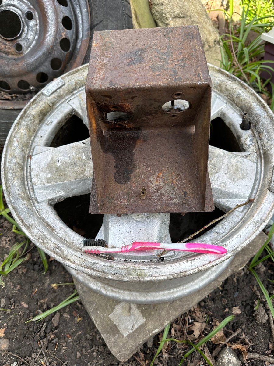

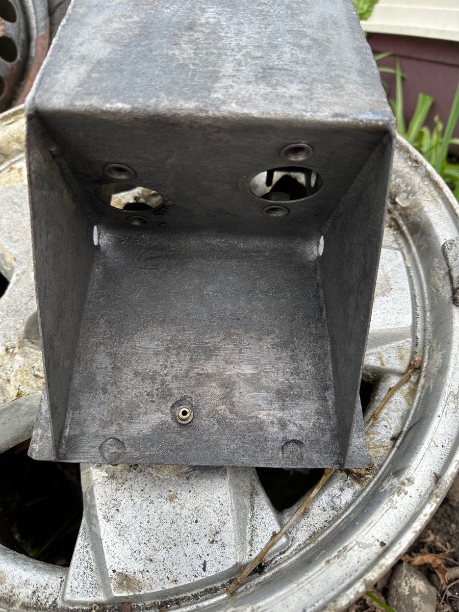

I did some more work last weekend and a rusty peddle box from my brothers +2 elan.
49FD02A9-4D93-43CD-AE68-A56CD1C474D6.thumb.jpeg.3c3535061f2e81ccd63ab3840fc7469c.jpegC961C9AF-4112-4FF4-BC70-F3BFC37AC05E.thumb.jpeg.635249376155f0b0099b7a9c6e5c4025.jpegF7013DD6-4449-4E62-B66E-70C940E11784.thumb.jpeg.26f896fba90044b28432bdb57e7b5d43.jpegCE9F0D1B-760B-4A49-B7A4-617C4B990196.thumb.jpeg.aef5b7af8cda7f9cc459e78cfdff984b.jpegDE91CFDA-4EDA-4645-9239-D2BC5FDC9BB5.thumb.jpeg.91a67086794af44176e3c68c2eeb774e.jpeg60D5D95D-B3E2-4154-A3DB-6BE236969C5F.thumb.jpeg.324eb6cc16a3305d5b83ab3bb541c287.jpegF2F0C6E1-F36D-41E0-BF1D-F624BEE61E6F.thumb.jpeg.883ec6799699628c2779907598a89e15.jpeg86D8141D-90FD-447F-B7FB-A44C5C18F6B1.thumb.jpeg.e4871c5acc86dde88a81dcfbff083b7e.jpegD88443C0-C4B2-46EA-9565-E21A72189EA6.thumb.jpeg.2e487fadbe8ab3d12631b377fbc20aa6.jpeg722E9923-A027-4782-B439-803A6D7F4476.thumb.jpeg.121d7b041323539d1ebe5a6b619761be.jpeg5FE2E84F-AE2A-4079-8598-4A1294119B02.thumb.jpeg.efbf50f242ac39271cd43b88c033fdda.jpeg364F2C7E-7F72-4854-9666-425BCA986B42.thumb.jpeg.2a74bda89110d28e6deeccac91c27fff.jpeg3A1AAC1F-4F83-4655-90F4-B915319A5071.thumb.jpeg.21ba3d02c22561aa2447f484b5647fc0.jpeg

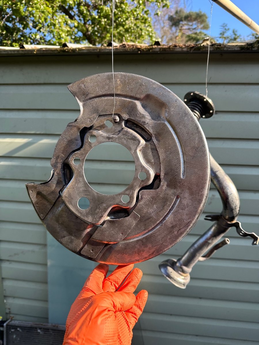

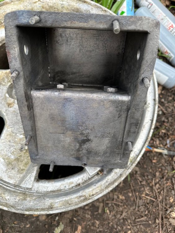

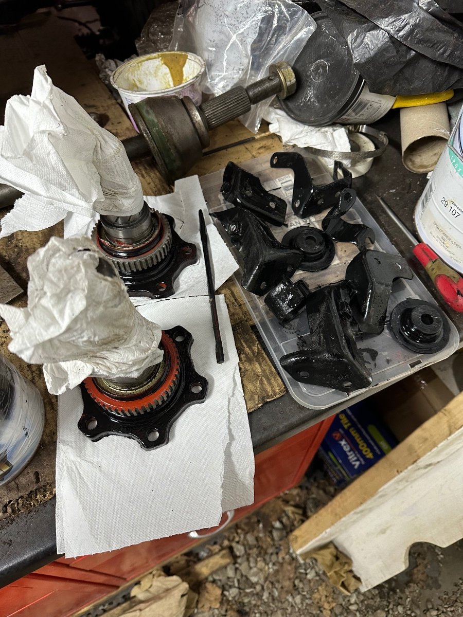

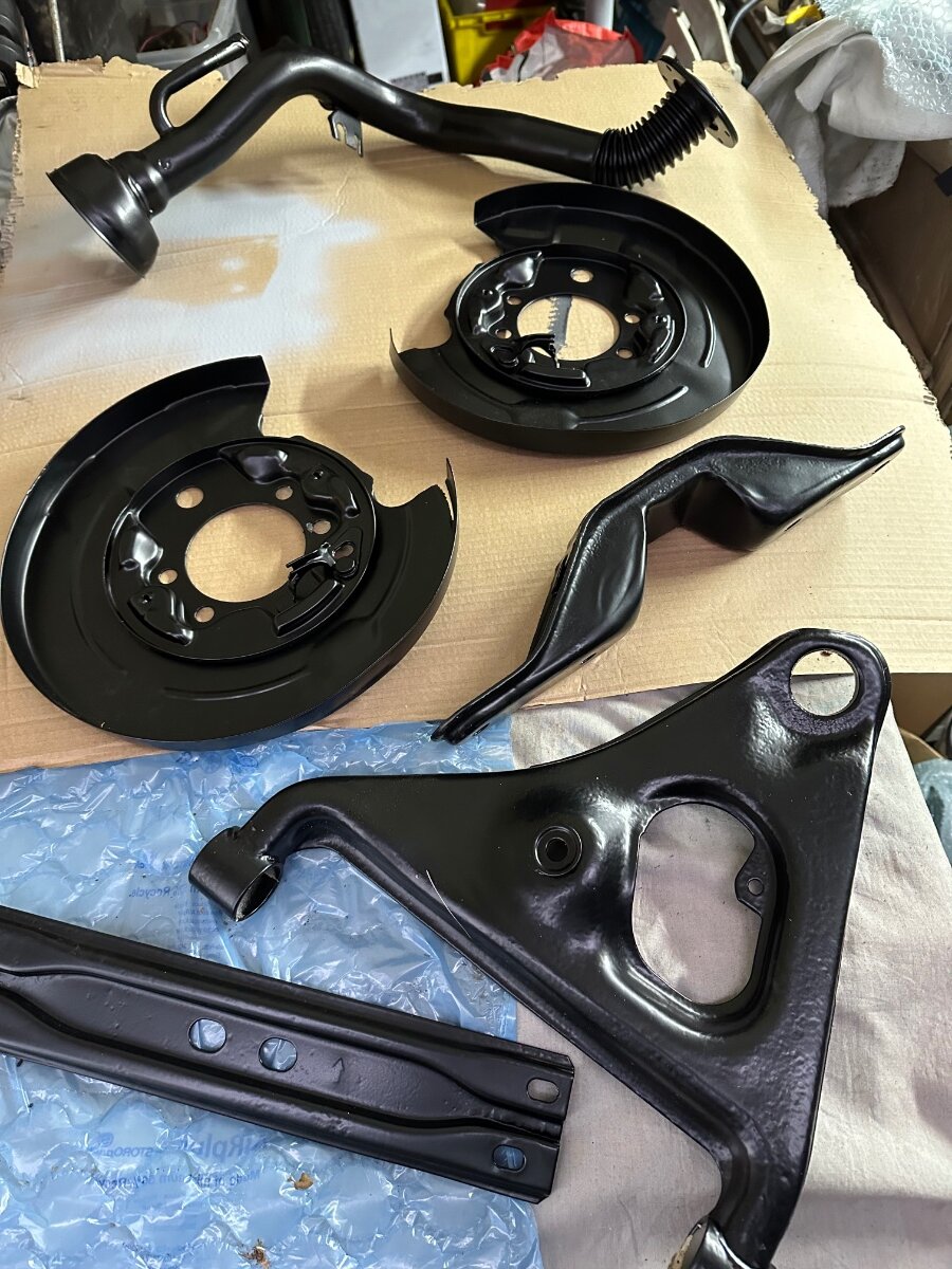

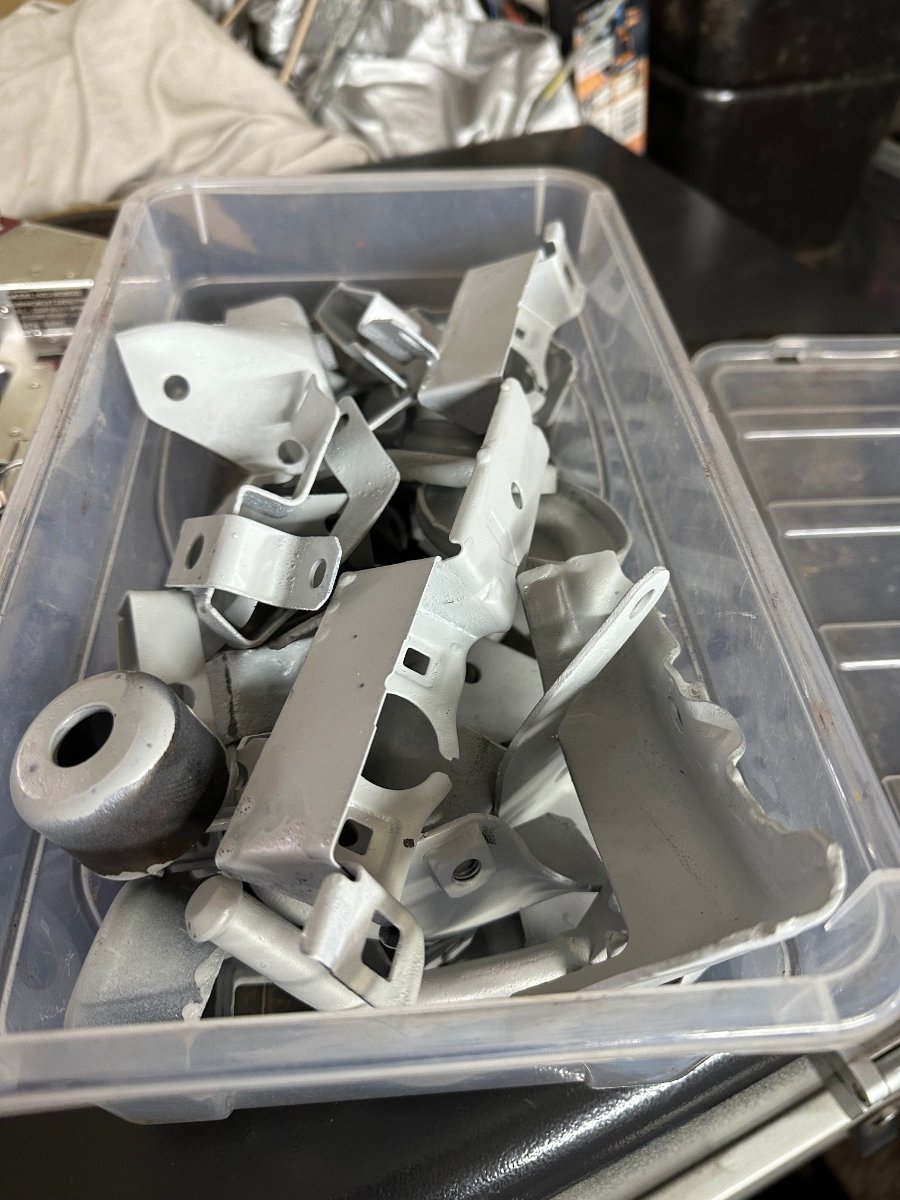

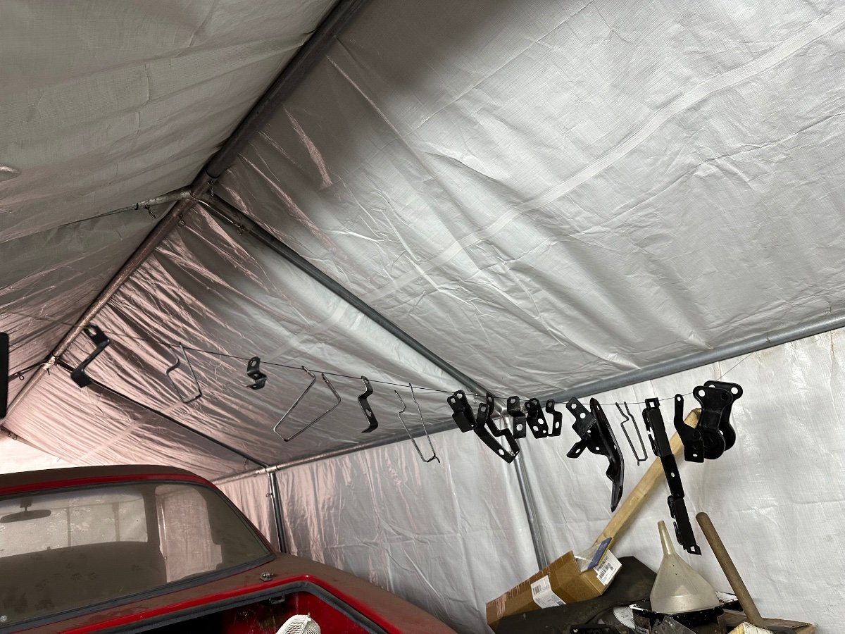

Did some more bits ready for powder coating.
ABAB76CD-E426-4E03-A149-3465EEFF3BA8.thumb.jpeg.03f3224b58c1e864b516834dccbe4cf8.jpeg91882940-855B-42CC-AAF4-1941AF89E6DD.thumb.jpeg.f7ec8a12c31dc1f8f324f1ecd7960ec7.jpeg
5 mins on the wire wheel.
A4222470-8F74-45D4-9918-85831B717CCE.thumb.jpeg.50d3fd5ced253972b8c7fa07955f35f8.jpegE0640B42-3C8F-4DAE-95A9-F8707447D2DF.thumb.jpeg.d0f3d0e597595c4adfc53c8b23e7add9.jpeg
I will use the laser next time I’m there.

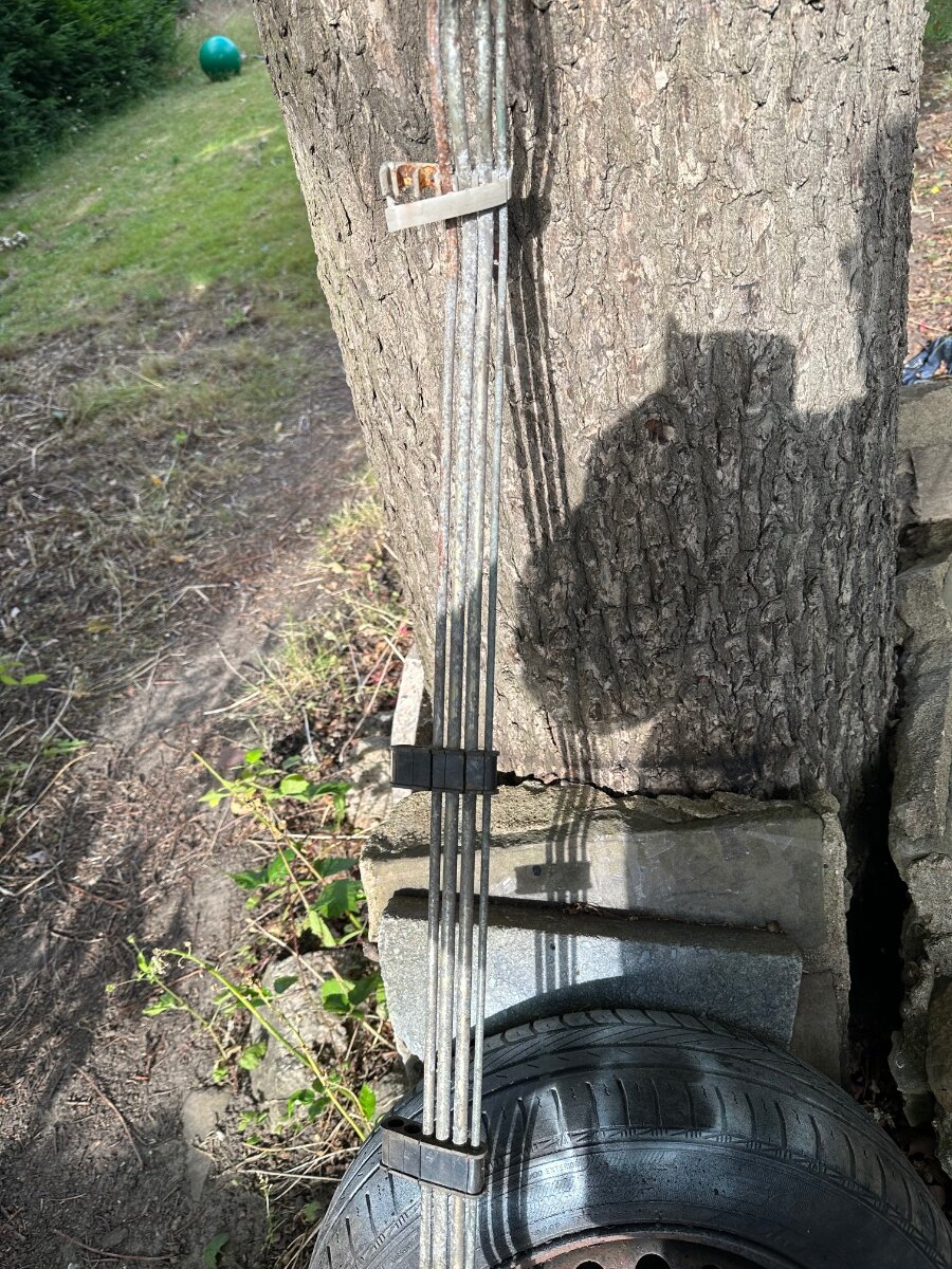

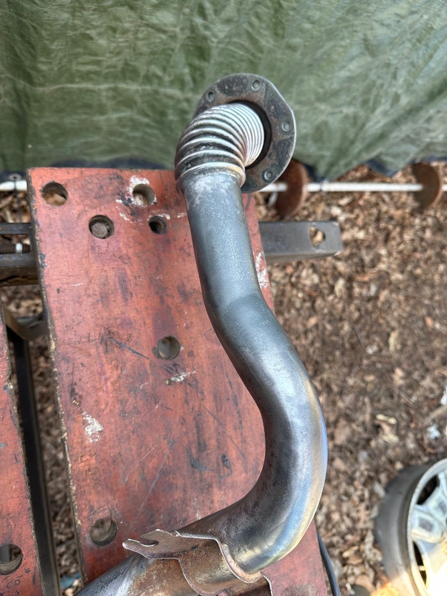

Hi all not had a chance to do much recently, today I removed the brake lines and the fuel lines, question is shall I clean treat and paint the fuel lines or replace them, they are pitted in places.
IMG_3157.jpeg.9f14af27e46a562d8ae0f4e5c6a90b73.jpegIMG_3158.jpeg.1d4de430a659765a7be4bc2e1112fa6f.jpegIMG_3160.jpeg.39a9089a1aba3b49e04d83e53c93fdb0.jpegIMG_3161.jpeg.b88c0b9fc1e1b0a31ced5c23f1ce29b0.jpegIMG_3162.jpeg.be0bd19b43387d41e5687bcfeb6352f2.jpeg
2004 BMW Z4 30i
1991 Nissan 300zx TT Project
1997 Jaguar XK8 Scraped ☹️
NEW !
Definitely go for new ones. Not worth the risk on brake and fuel lines IMO. When the corrosion returns, which it inevitably will, even when using ‘rust converters’, the paint you apply will probs hide the corrosion until it’s too late and ready to burst.
3 hours ago, AndrewG said:
As you have gone to the not inconsiderable effort of getting access to them replacing them with new would be worthwhile insurance. You don't want a failure once everything is back in place.
Yup - what Andrew and everyone else says..... New new and new 😉
I will make some new ones then, shall be making all the brake pipes as well.

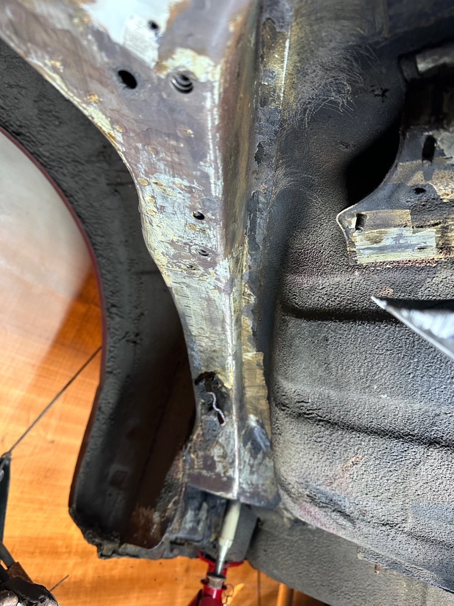

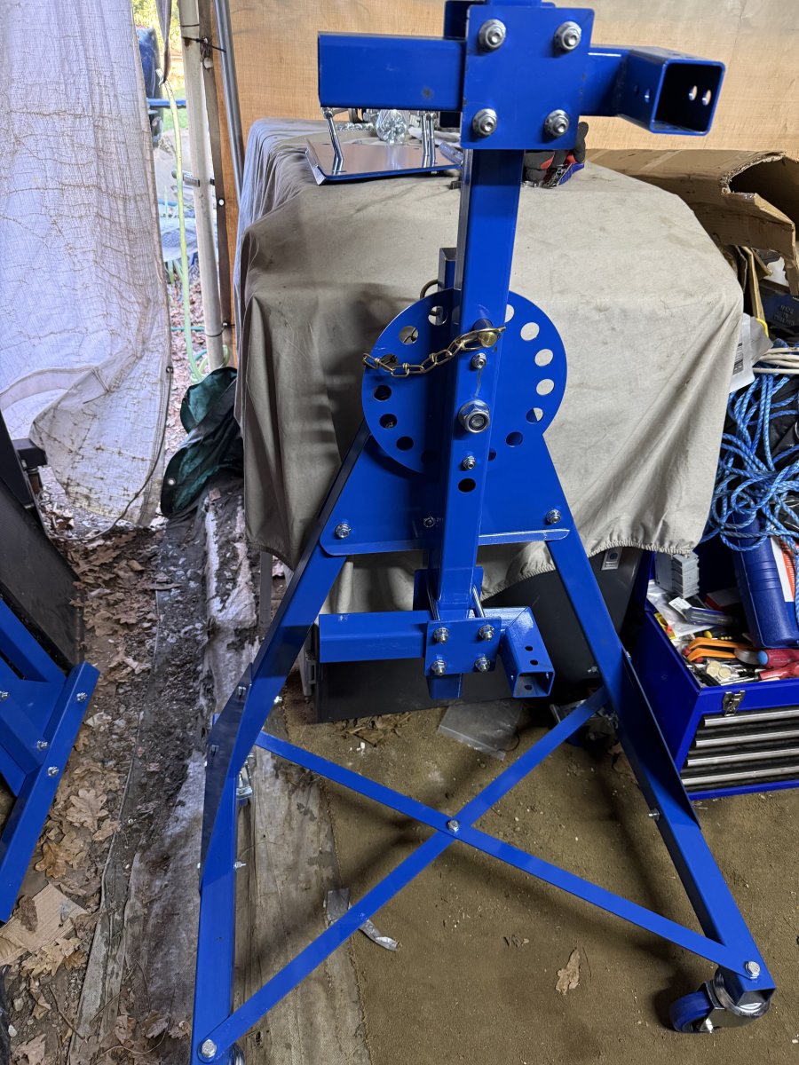

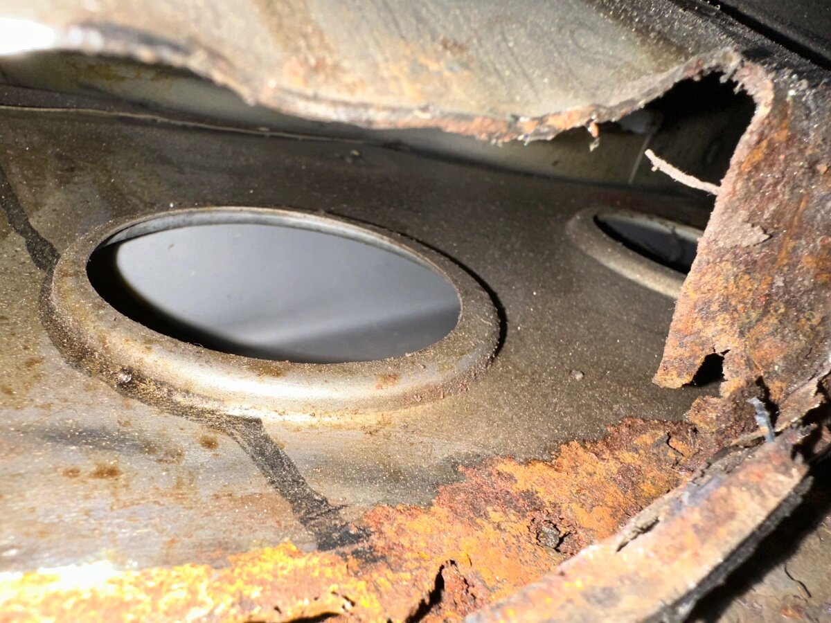

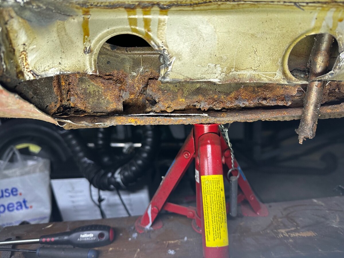

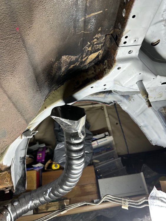

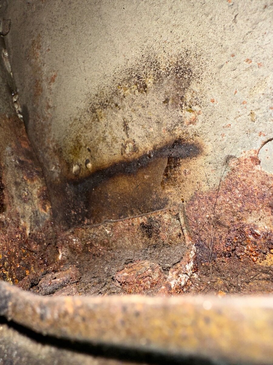

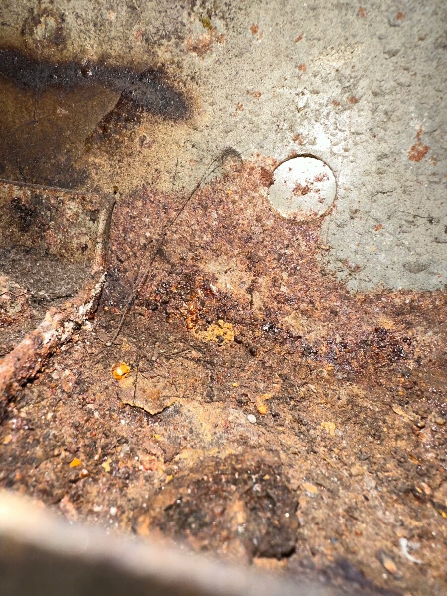

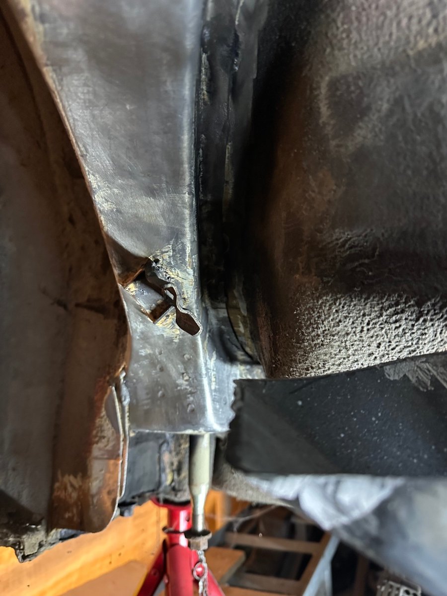

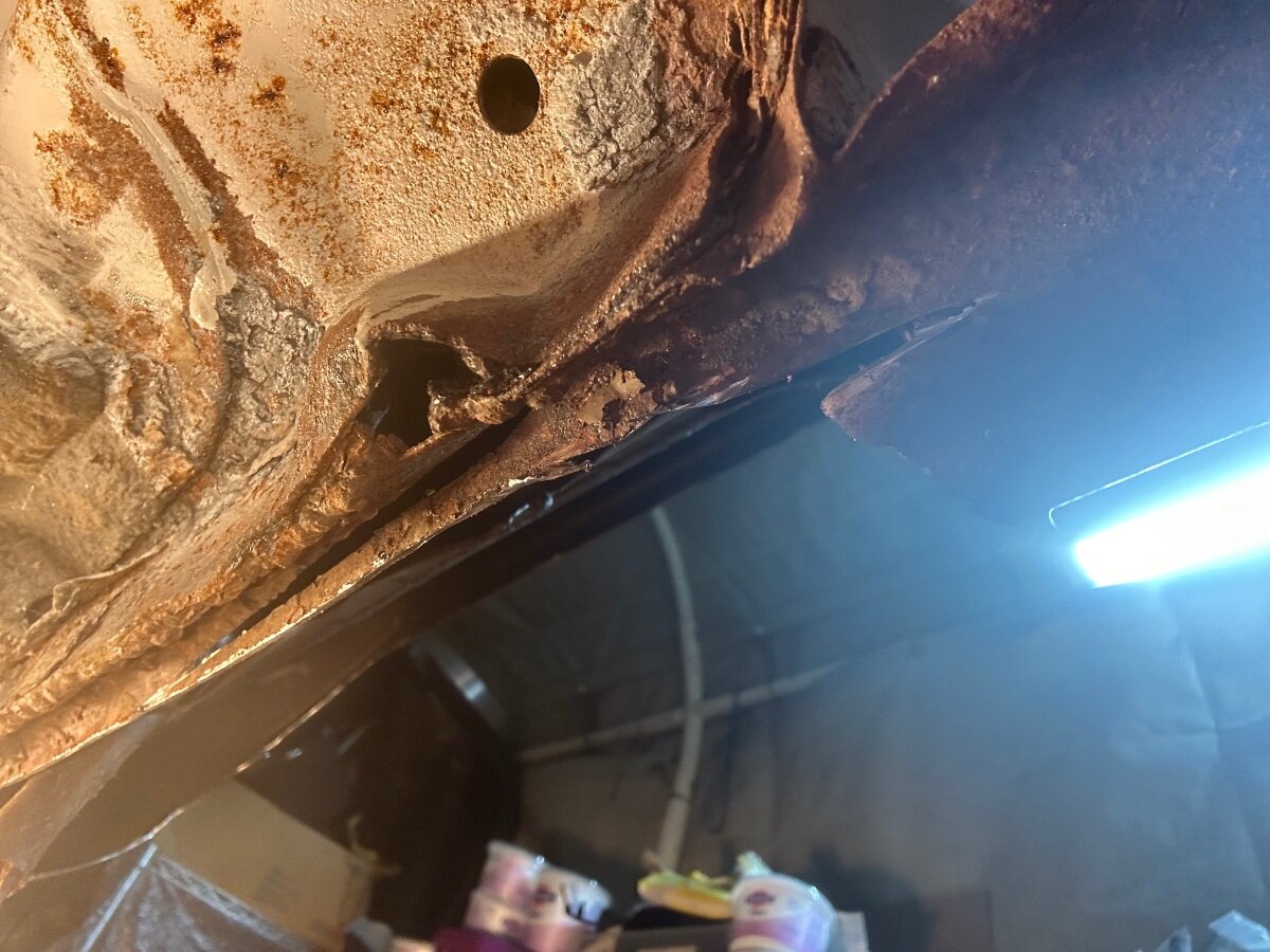

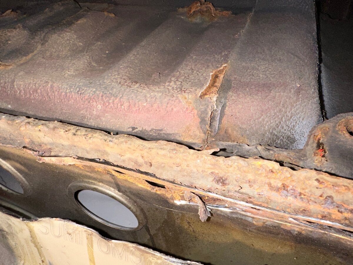

Almost finished my axel stands, cut outer sill on drivers side to see how bad the rust is, not as bad as I thought, parts coming back from powder coating so better get a move on.
IMG_4484.jpeg.2e5306ed7a17a34e17bd5aa91cf5beac.jpegIMG_4482.jpeg.da4d1eb4c24ddfef463addafe81b5620.jpegIMG_4483.jpeg.4937874d4b72d69532cd16935a1c82c7.jpegIMG_4487.jpeg.feafb0f4c28ce3c61306752cac229206.jpegIMG_4485.jpeg.d39b9c27d3f117418f80b081fdb4aaf2.jpegIMG_4490.jpeg.c3be702d4a2a074eb3b54ae195987f67.jpegIMG_4493.jpeg.8efa6852eff9c273812df6afb267373d.jpeg
there is some rust along the very bottom edge of sill and near the front wing, I have the rear panel and whole sill so might just replace the whole thing, not sure yet need to get the front wing off and asses.

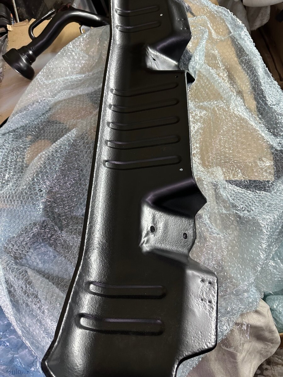

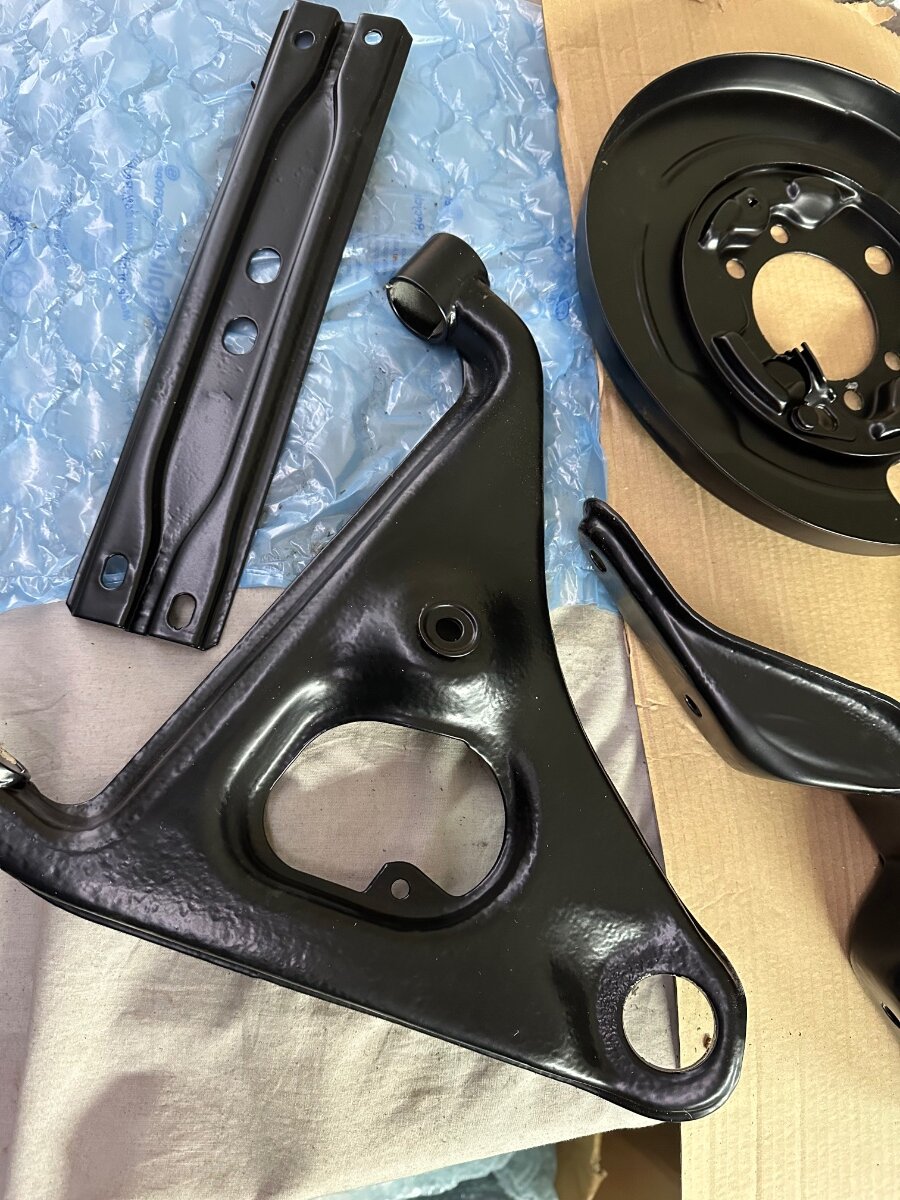

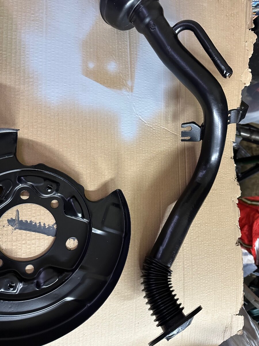

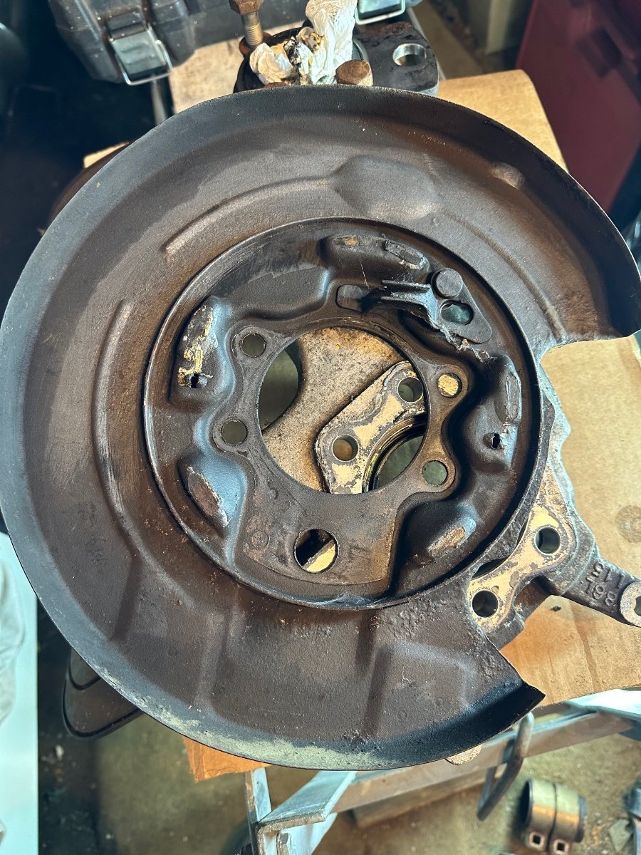

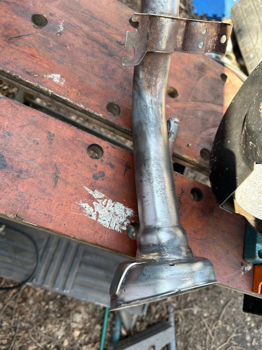

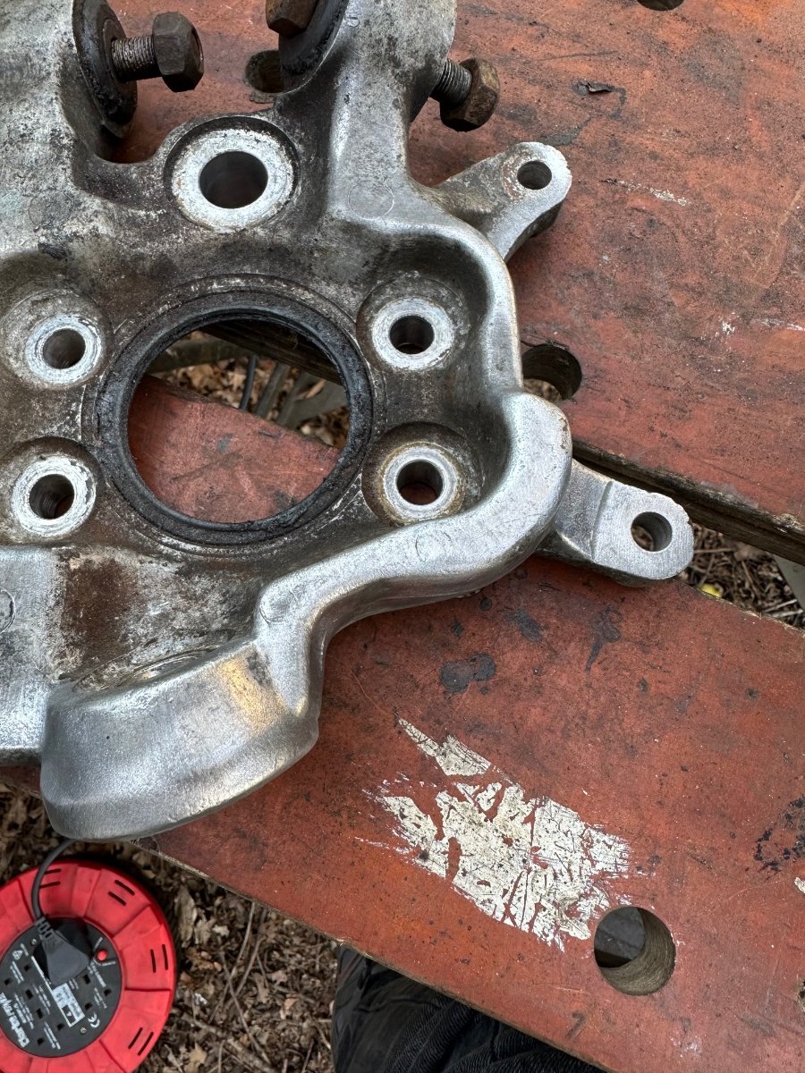

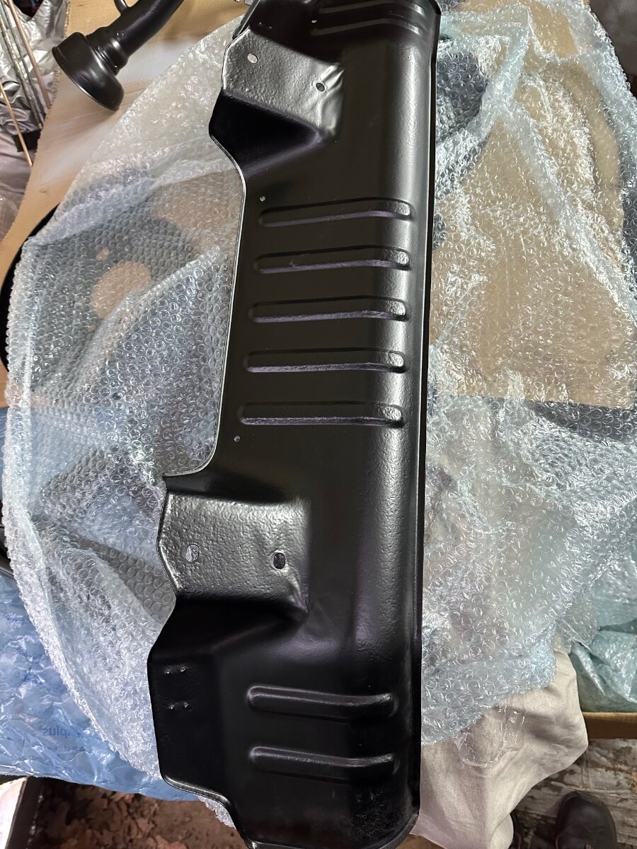

Got my suspension, fuel filler pipe, fuel tank shield & straps and many more parts back from being blasted coated in Zinga then powder coated.
IMG_4658.jpeg.646f69aea8341cebddacf1ff29b6422c.jpegIMG_4657.jpeg.e050dd23370fcb7d9da5e9b5aa6f63c6.jpegIMG_4653.jpeg.0afb7a2139475cdcbbd7dfbb4f3578f7.jpegIMG_4654.jpeg.e10a07157b13ee82d2dc21824ae6ec70.jpegIMG_4655.jpeg.3d12ddbaf38fda19f727d6890ee02274.jpeg
subframe is being painted soon. I had better get a move on.

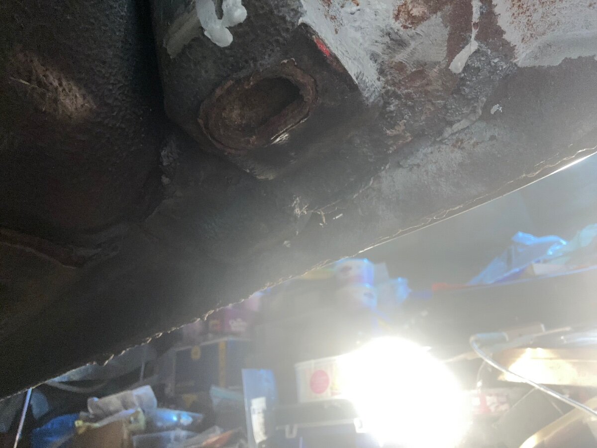

Decided to test the Laser on the sill to see how it comes up.

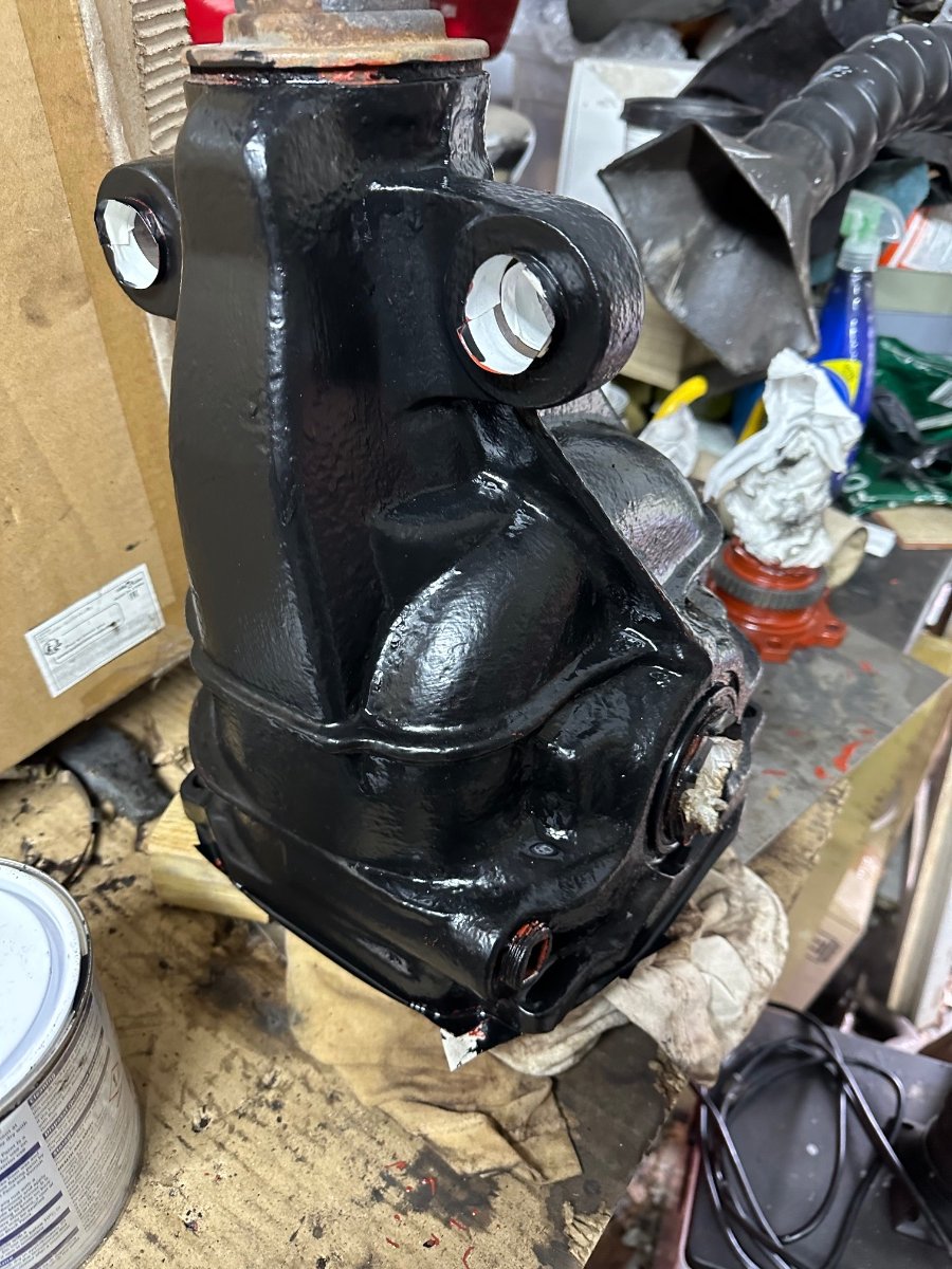

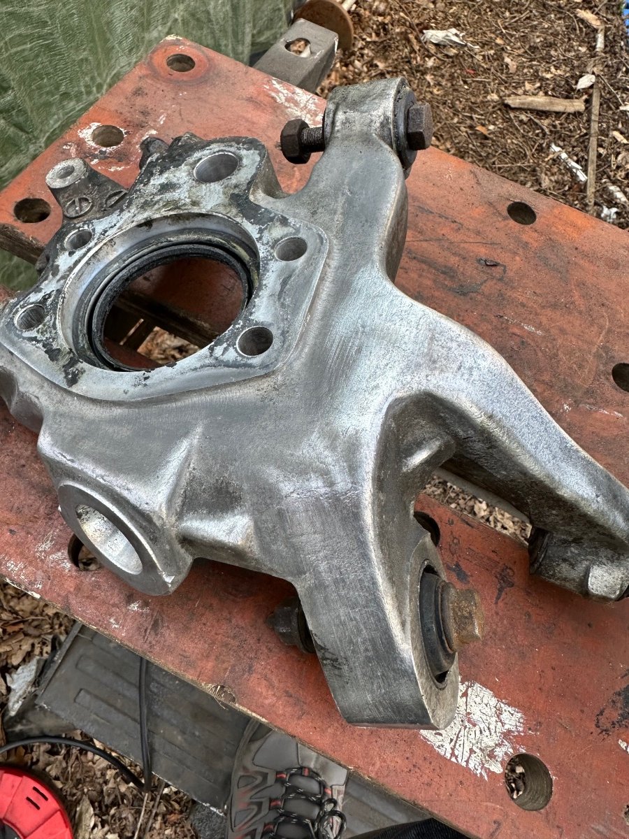

Decided to clean and prime my diff and some brackets today.

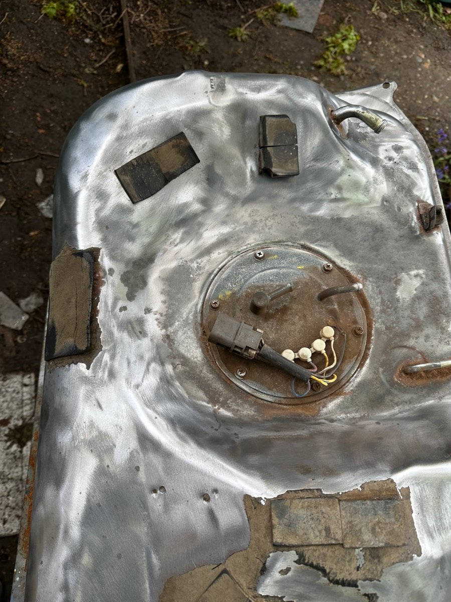

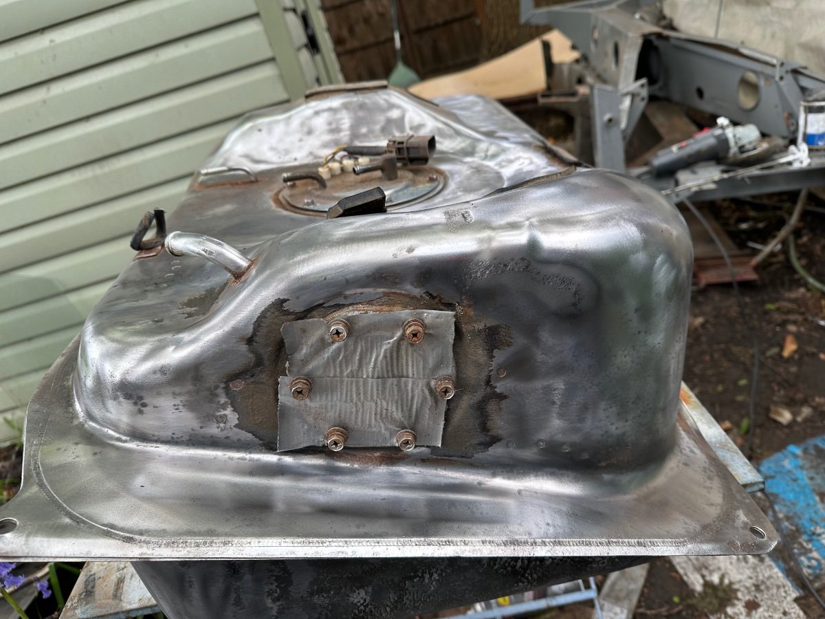

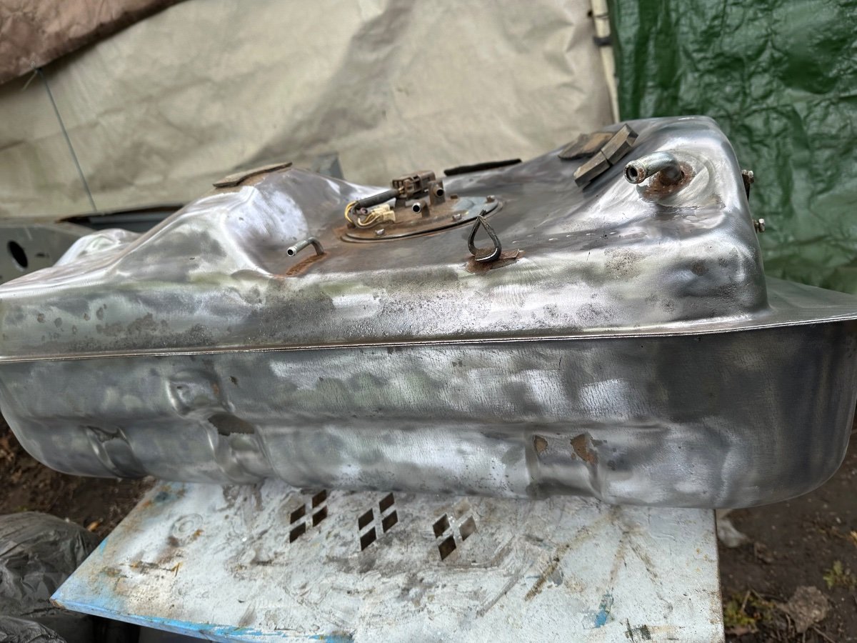

Started cleaning my petrol tank.
IMG_5026.jpeg.5760c1a1250157687177adb41a56c58e.jpegIMG_5023.jpeg.f904e7f8770ca6cd915da0953a55029c.jpegIMG_5024.jpeg.239d906cc6f98b3f1918a467d715d591.jpegIMG_5025.jpeg.22e56b903244ca456a3fbd16c0161494.jpegIMG_5027.jpeg.df54aece67fa865143e542decda49786.jpegIMG_5022.jpeg.ed7c7b0ffe1d5ba7b8b66140d5bf136c.jpeg

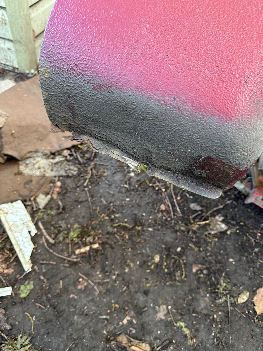

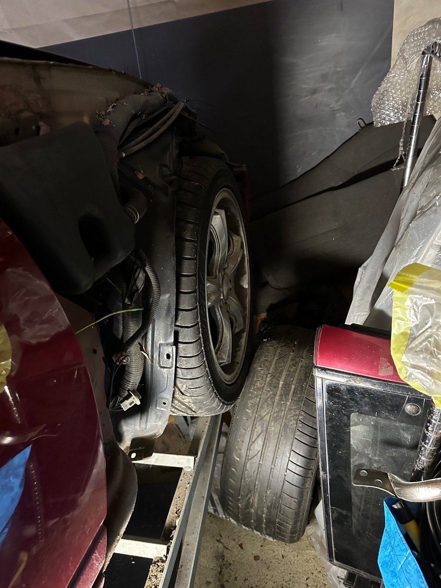

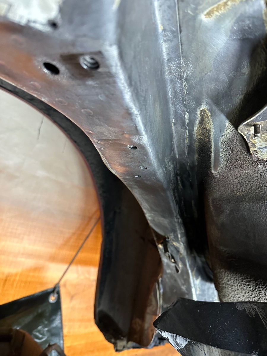

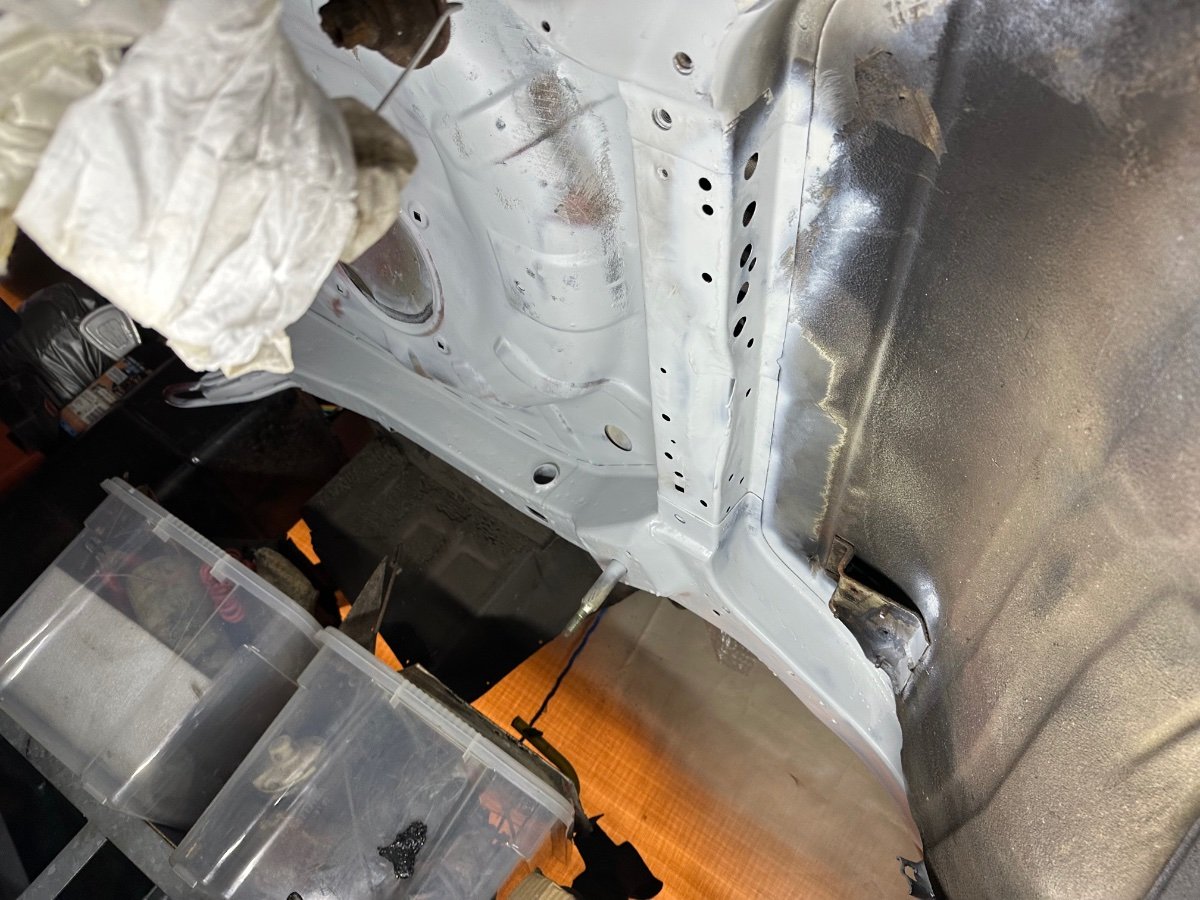

I can’t believe I managed to get the front wing off was a real squeeze with the space I have.
IMG_5041.jpeg.c9a5ad770246bda368289f22a4ca656b.jpegIMG_5035.jpeg.30deead7d9074e42de073a0b33043778.jpegIMG_5036.jpeg.81669562590bc6ecd9b32d1780c663dd.jpegIMG_5042.jpeg.6d3df64c2f907ae6743b4935e24a2f34.jpegIMG_5043.jpeg.35b28ba17c8e8b07e041a523d50d5dba.jpegIMG_5044.jpeg.629c81a7db34f94a026fc3376afb028f.jpeg

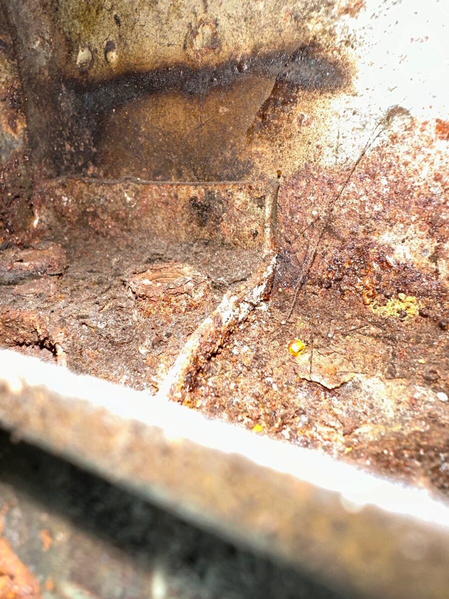

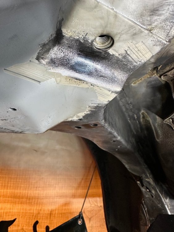

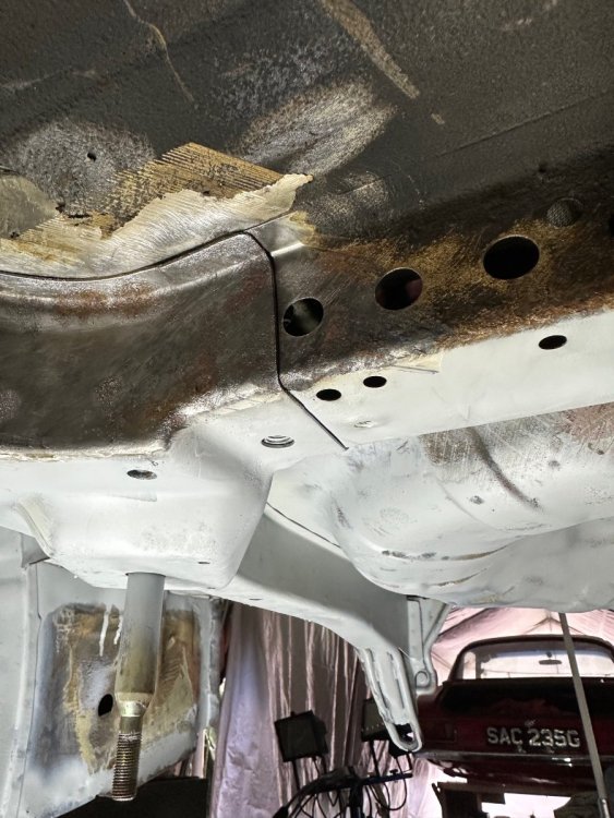

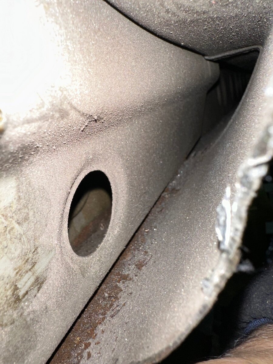

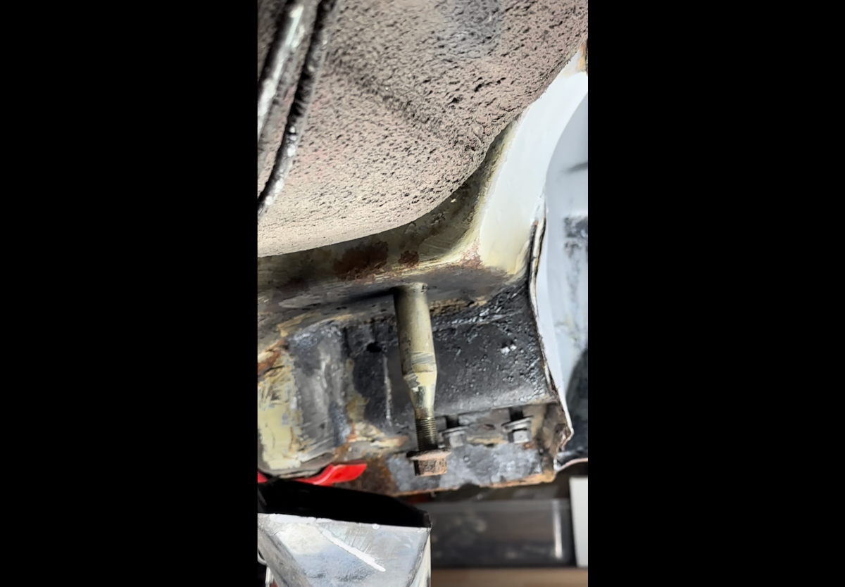

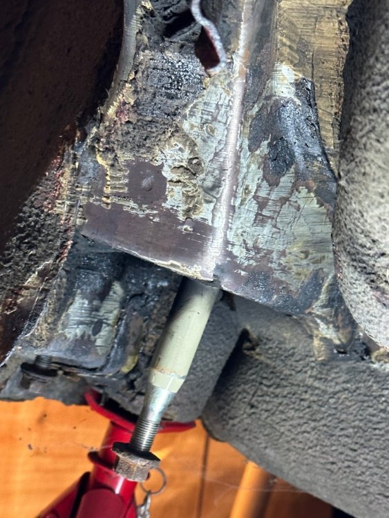

Underside of the front sill area.
IMG_5037.jpeg.01347a531d26aababef871398696ee78.jpegIMG_5038.jpeg.f07b18695bbe1ed795ed7ec4019121f8.jpegIMG_5039.jpeg.2d60b71541841e0956ecb77d54d77c21.jpegIMG_5040.jpeg.8f975b19203918078c2d53292c714252.jpeg

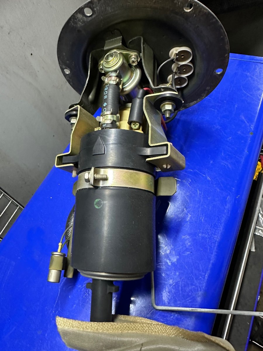

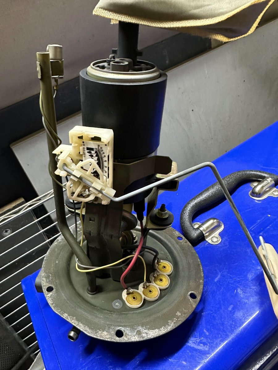

Fuel pump looks in good condition.

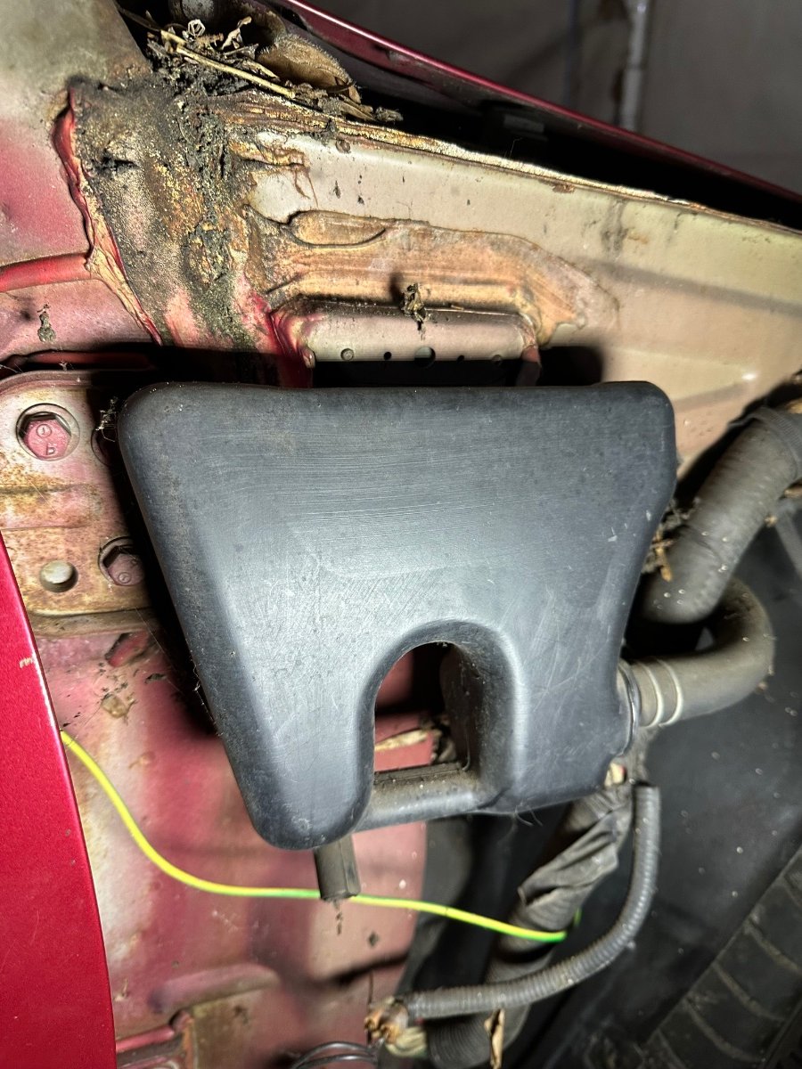

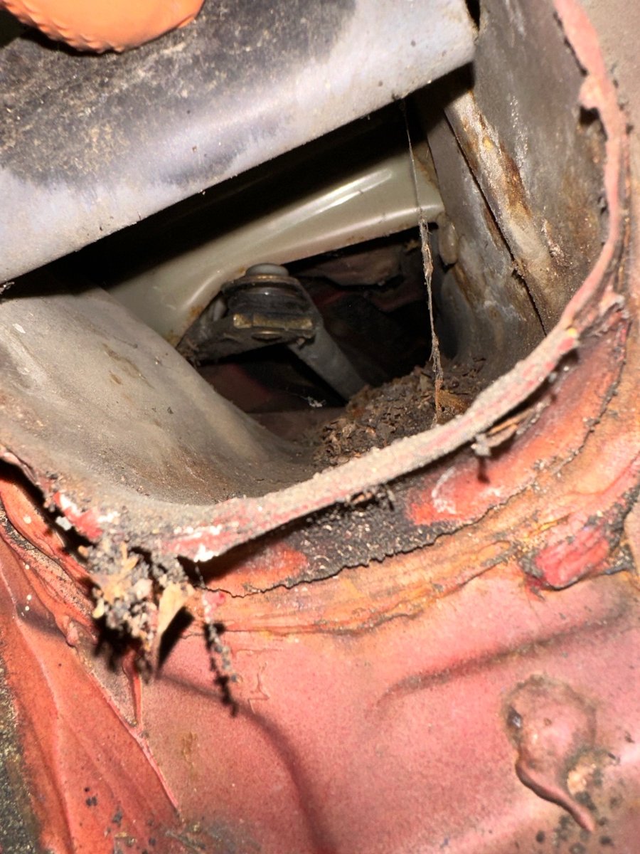

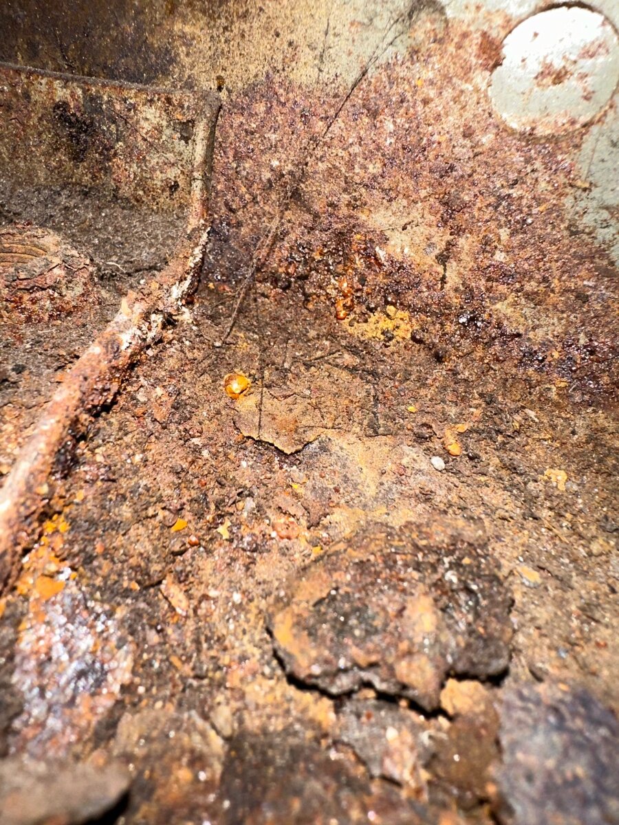

Hi so today I removed the AIV tank from behind the front wing.
and found this rubber flap, lifted it up and it was full of crap, so might drain the water from under the scuttle panel but having the AIV tank in front front of it cannot do it’s job properly.
IMG_5147.jpeg.7cc6abc924966705b533b8e63a31fd6c.jpegIMG_5149.jpeg.bab5c7307a8e33d149e397d779e2a110.jpeg
It was full but cleared it out before I took the photo.

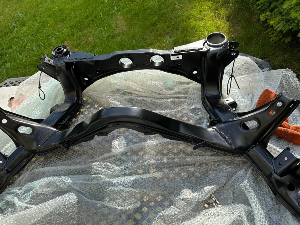

Just picked up my subframe from the powder coaters and dropped of my petrol Tank.
IMG_5153.jpeg.4ba4fc3767eff544575bb274fc7edcf9.jpegIMG_5154.jpeg.7dc898c8f887eb0644bbd288b29cc013.jpeg
Edited by Bones28
