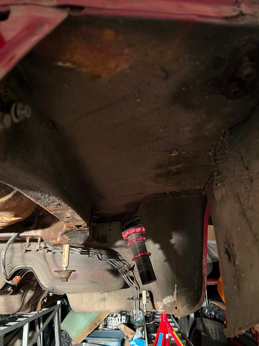

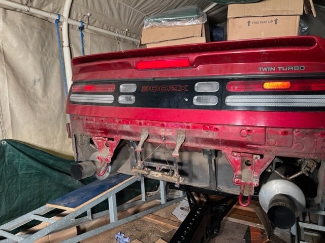

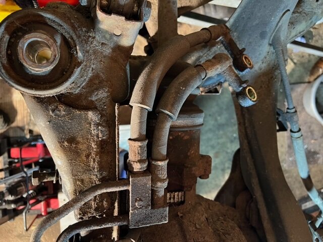

I am looking to refurb the front and rear subframes, the whole underside, brake lines, PS lines & Fuel lines. Big Job.
Started by removing the rear bumper, looks like it has never been off before, then draining the petrol (still in the process).
Took some underside pictures of the task in hand, it’s not bad mostly surface rust. I will be cutting all rust out and welding it my
self, if I can build a complex Porsche engine and it hasn’t exploded after 300 miles, anything is worth a try.

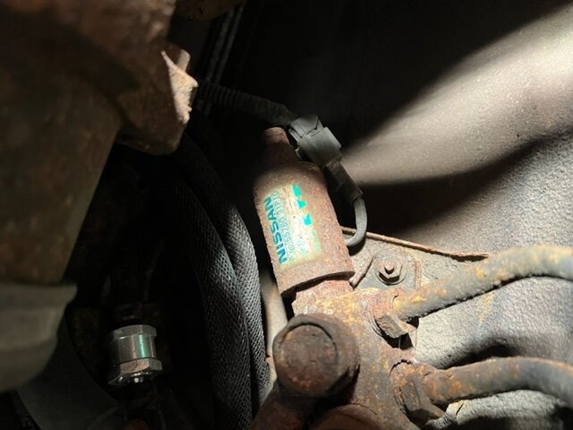

  • I have started on stripping out the subframe today, most nuts have been loosened but the half shaft bolts will need some heat persuasion tomorrow.

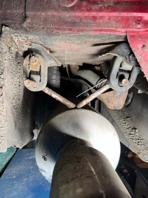

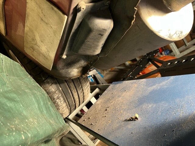

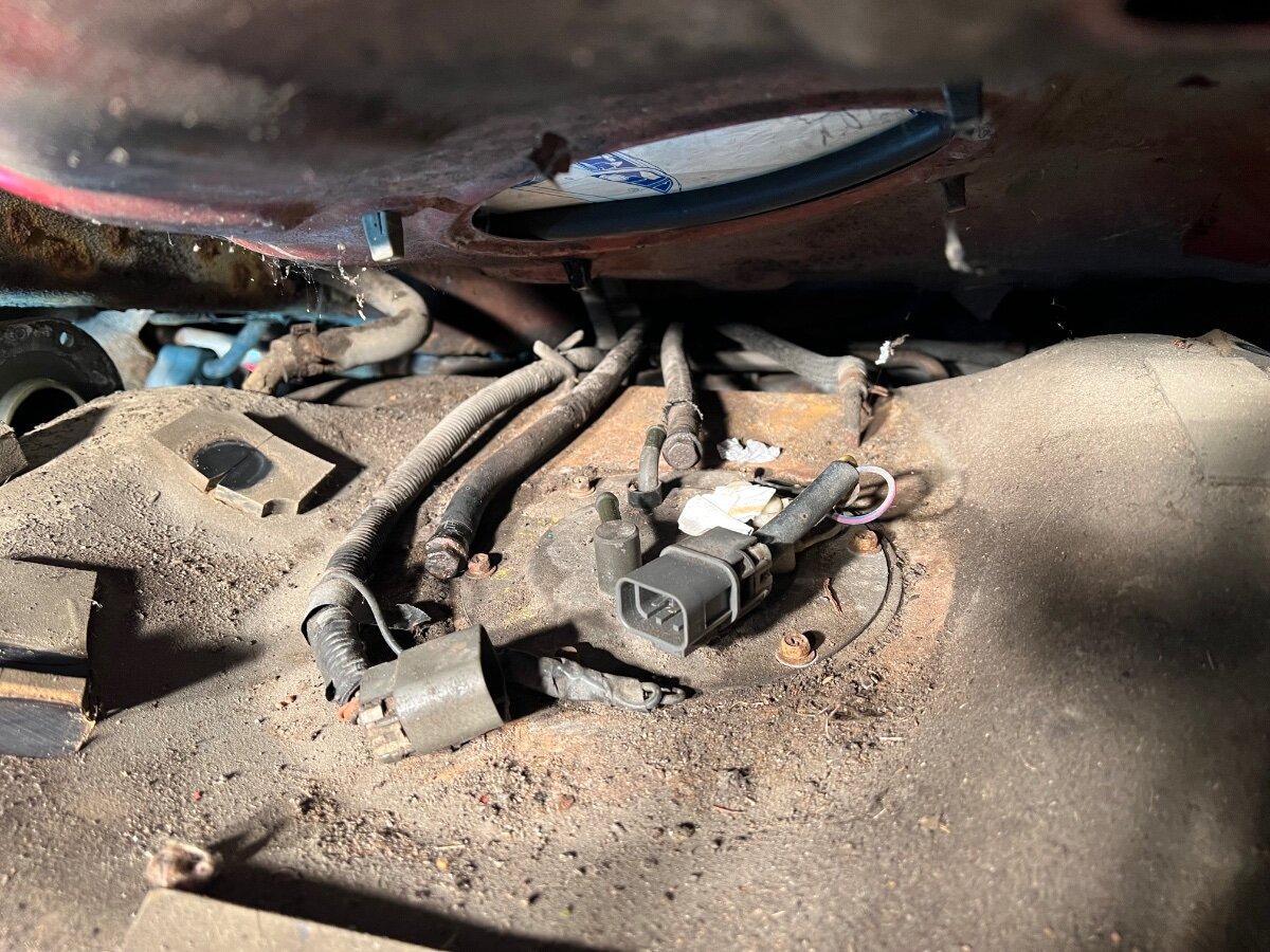

Exhaust off and petrol tank out, those breather pipe were hard to reach ended up balancing the tank on axel stands and a piece of wood.

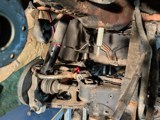

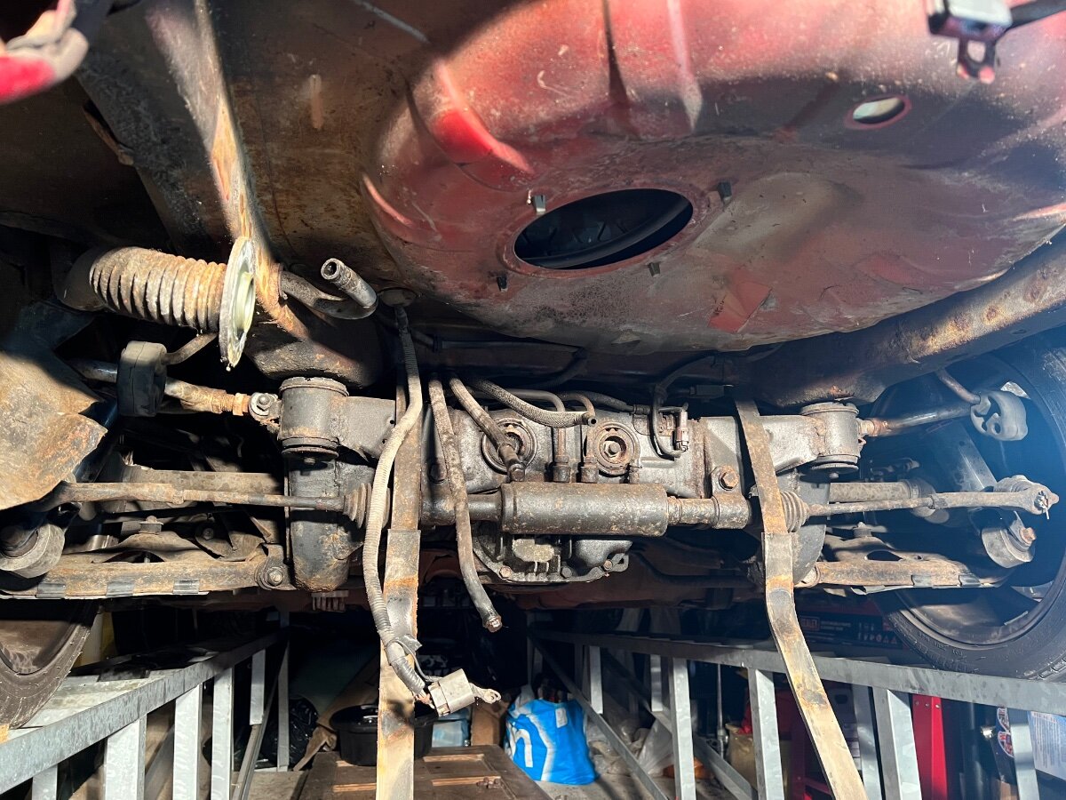

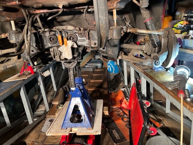

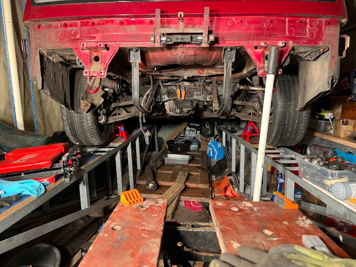

Managed to remove the Hicas & propshaft, I will be putting a one piece prop back in. I have axel stands under the car now was very hard to do on the ramps, now I can remove the rear subframe. Had to use plenty of WD on the bolts, undo and tighten a few times. Does help to have a large breaker bar and a impact gun.

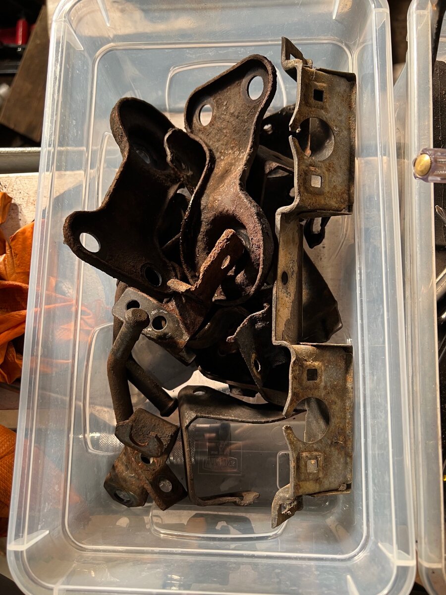

All stripped down apart from the bushes, will try and get the press out tomorrow.

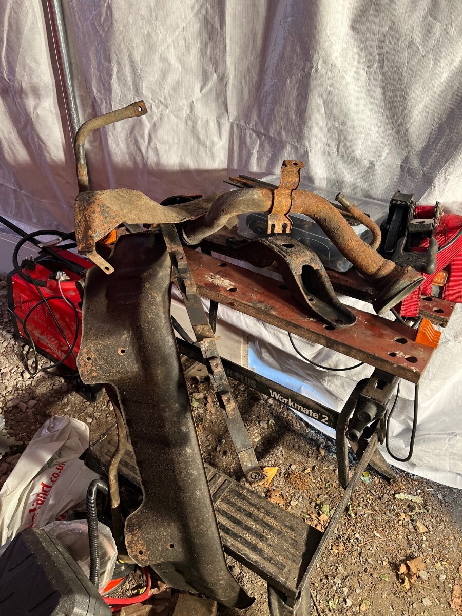

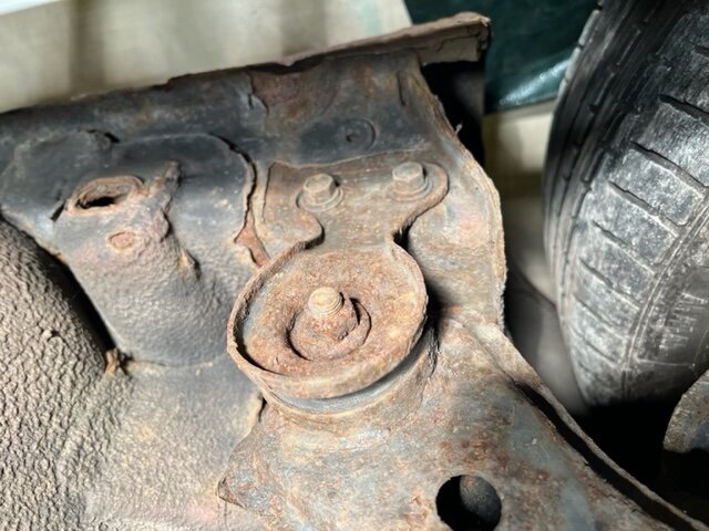

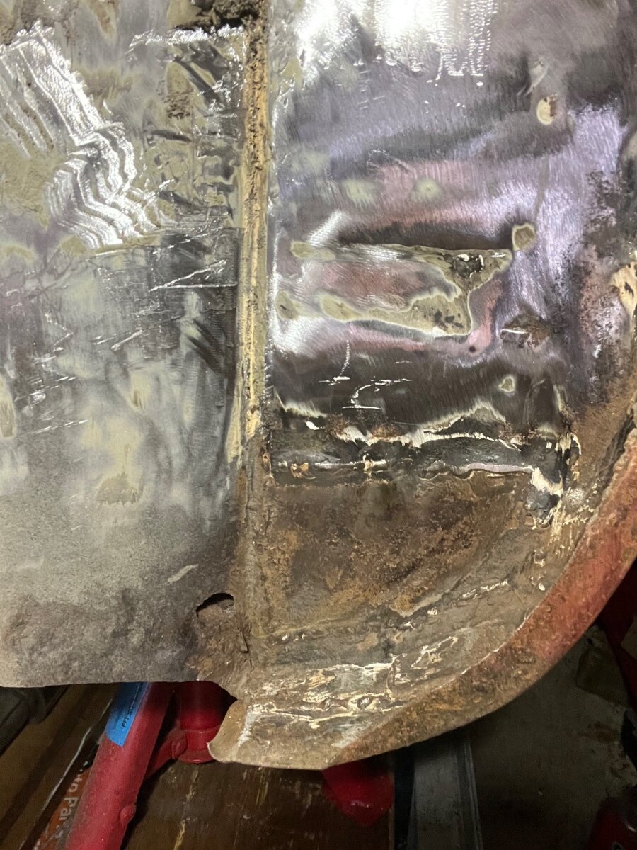

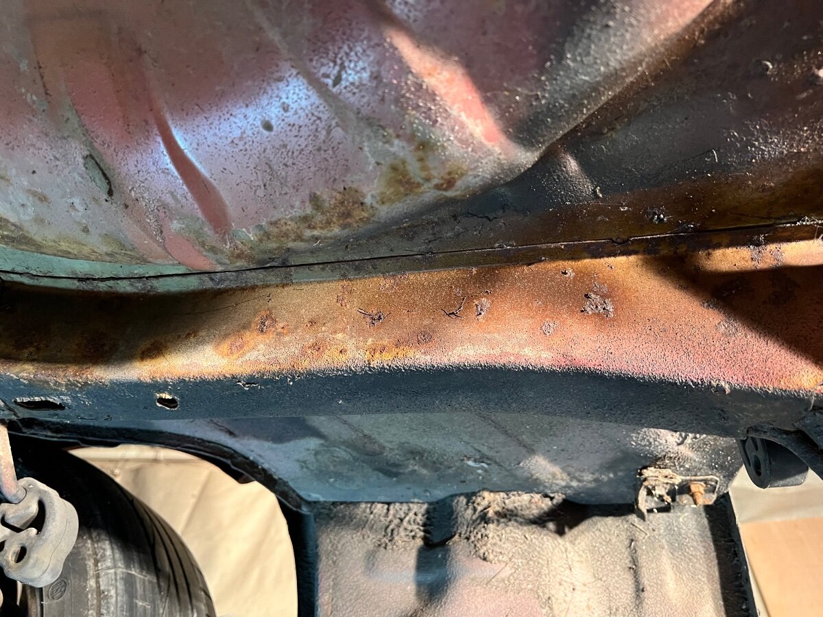

Bit more done today, some parts ready for shotblasting and powder coating.
Rust isn’t to bad have seen much worse, I will get on grinding next week.

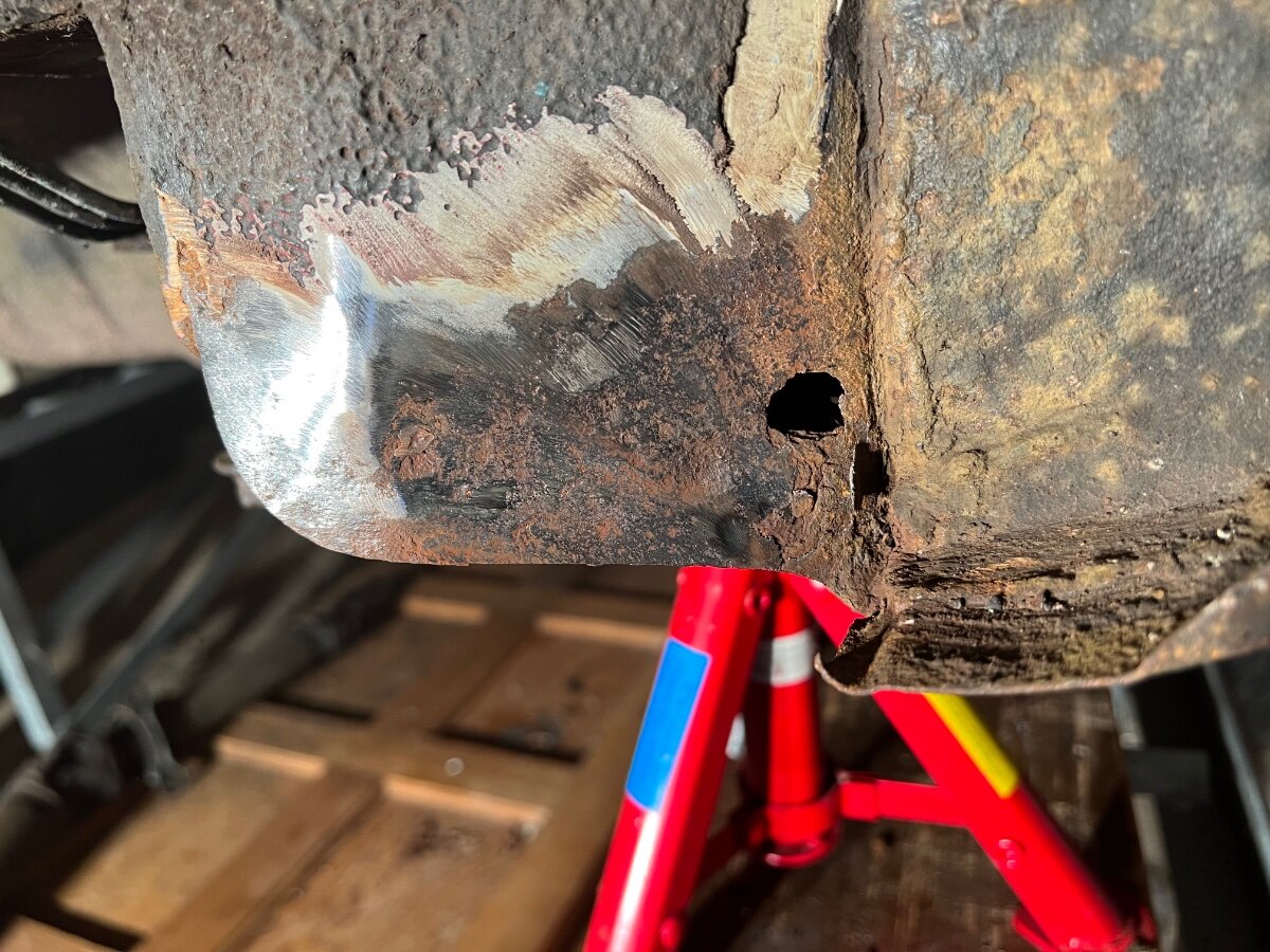

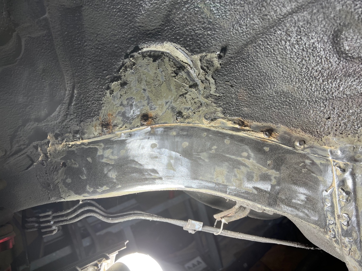

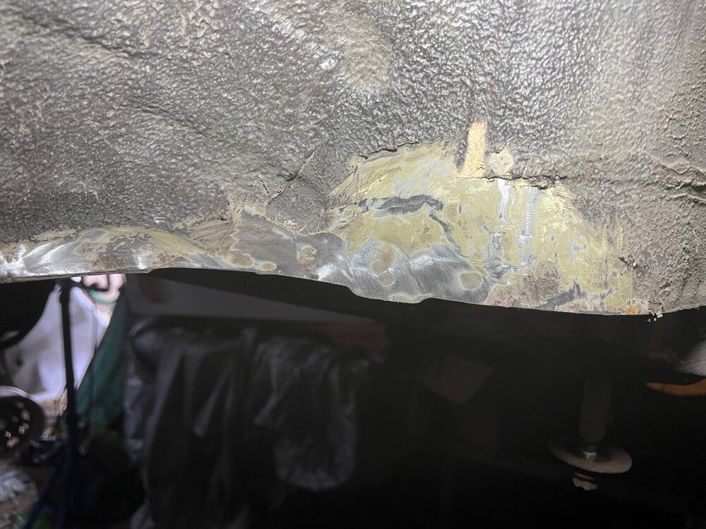

Finally I have found some time to start stripping the underseal off.
B92DAB27-9CB2-4C68-8080-4D05B25BFF2C.thumb.jpeg.af106cfc5565d427a4f1fcc4a52b15ed.jpegAB79848B-CB38-4C91-8F39-0C22500D6CA9.thumb.jpeg.193772b7e7f69999f40bbb47609715e3.jpegE810B6E2-848B-4AF5-9E47-579E140811D9.thumb.jpeg.b63407a2bde27873b2b774366c6d575b.jpeg2274E66C-A472-4330-B3CA-19F801DF649C.thumb.jpeg.ac690122ac4874c33c645dcc01a273c3.jpeg997ECAC9-5B4F-4594-AB30-A212B7567748.thumb.jpeg.74f3fef540e084fa63a23b0bad390395.jpeg
2004 BMW Z4 30i
1991 Nissan 300zx TT Project
1997 Jaguar XK8 Scraped ☹️
6 hours ago, TheRealNips said:
That must be a horrible job, taking that stuff off ?
It is messy, I’m using a variety of tools, a fen, angle grinder with flap disk and a poly abrasive wheel.
2004 BMW Z4 30i
1 hour ago, Peage said:
Can it be chemically stripped at all?
It can be but makes a horrid mess and the fumes are dangerous.

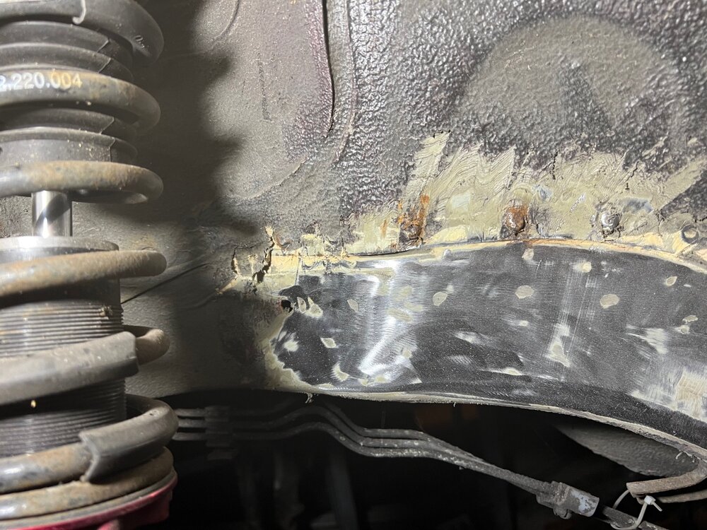

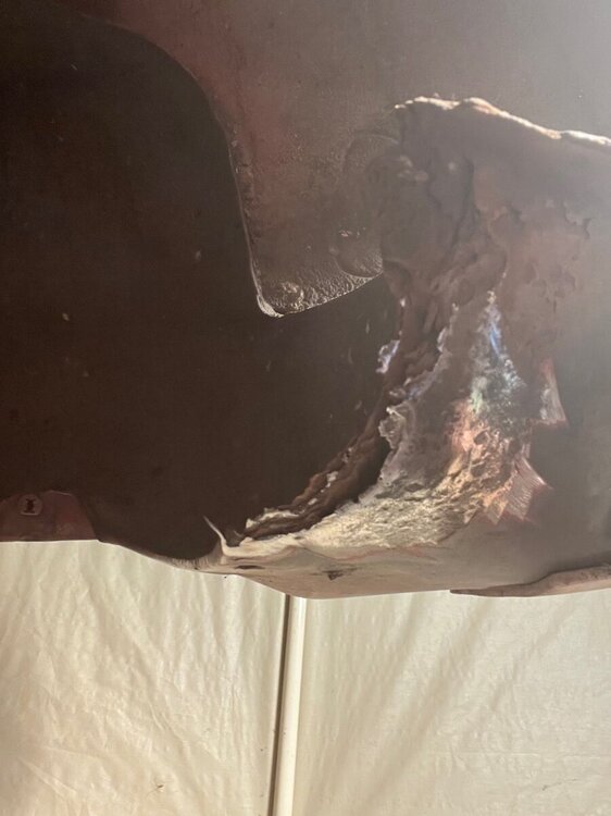

Hi I did a bit more today, you would have never known these spot welds were rusting under the pristine undercoating.
2004 BMW Z4 30i
Can be quite worrying when you see things like that. Turns out on one of my doors under where the pin striping usually goes, it was rusting. Had no sign at all from above the paint though.

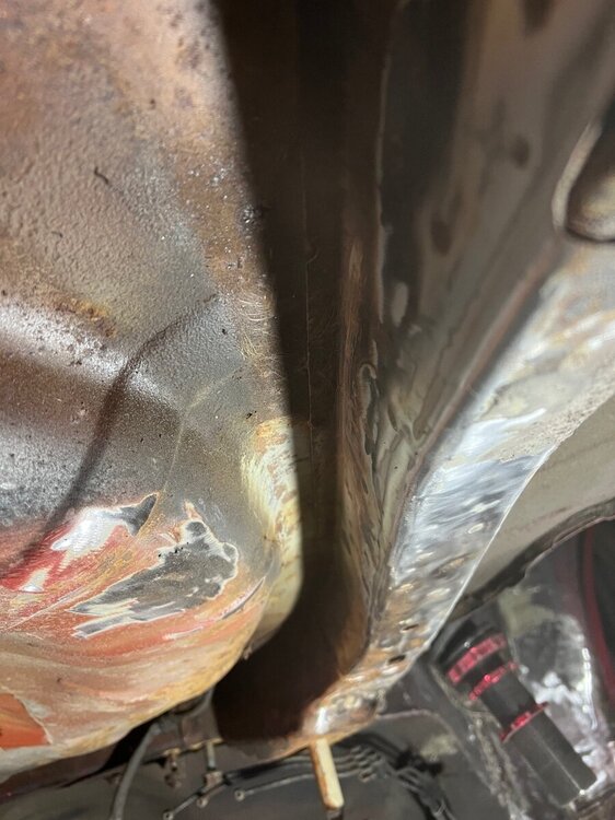

Hi I haven’t done a lot recently, been looking after my mum who has Alzheimer’s, so car is at the back of the queue.
I did manage to do a little bit more, purchased some protective equipment.
The mess it makes is so bad.
