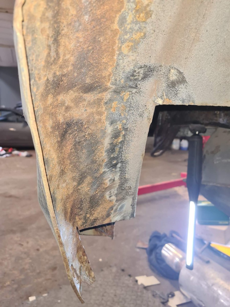

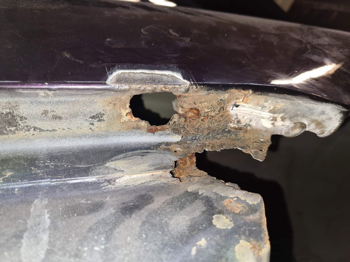

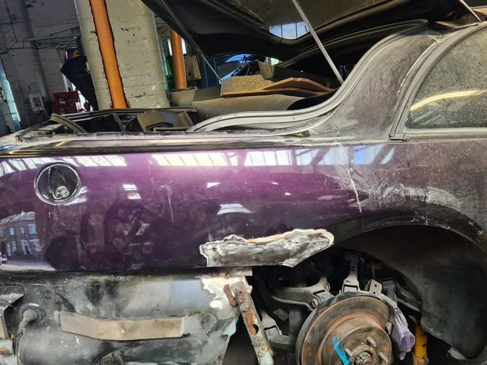

Both sills are done and now in primer. Drivers side was worse, and had had a very crude repair done to it in the past on the outer sill without tackling the inner sill issues.

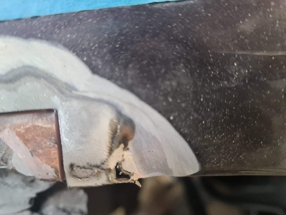

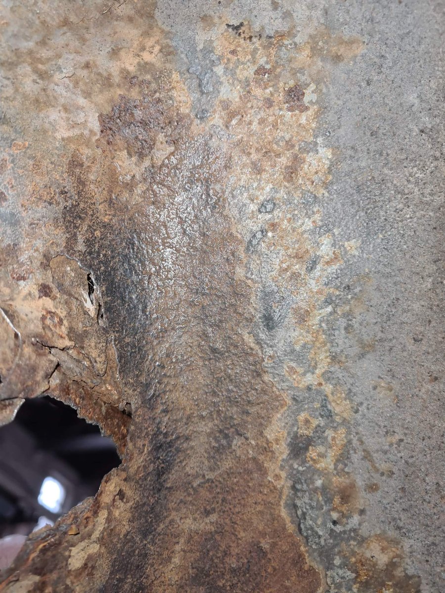

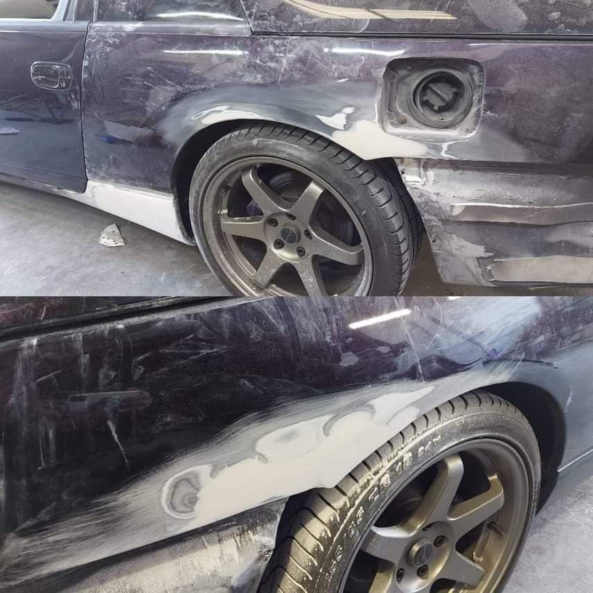

More pictures of rust and then not rust.
Ali is making steady progress with the welding.

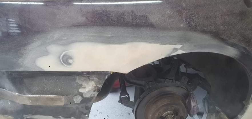

Going to get both wings sprayed after this as there's a few micro blisters I've decided to get sorted now rather than wait.
Edited by Lexx
Rust was quite extensive hey - guess previous owners must have used through winter?

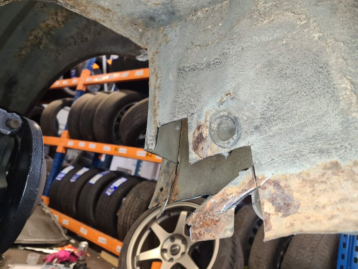

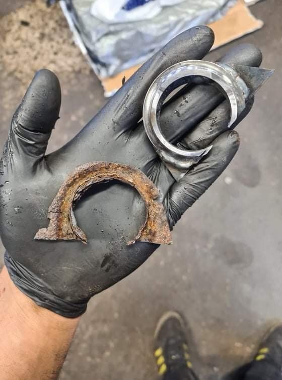

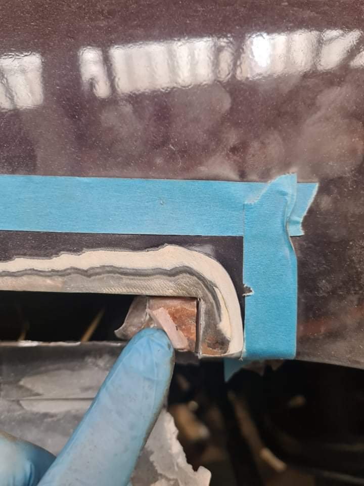

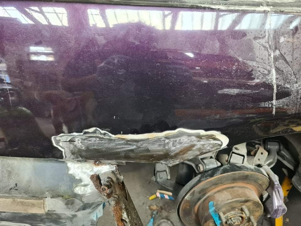

The bodges keep on coming.

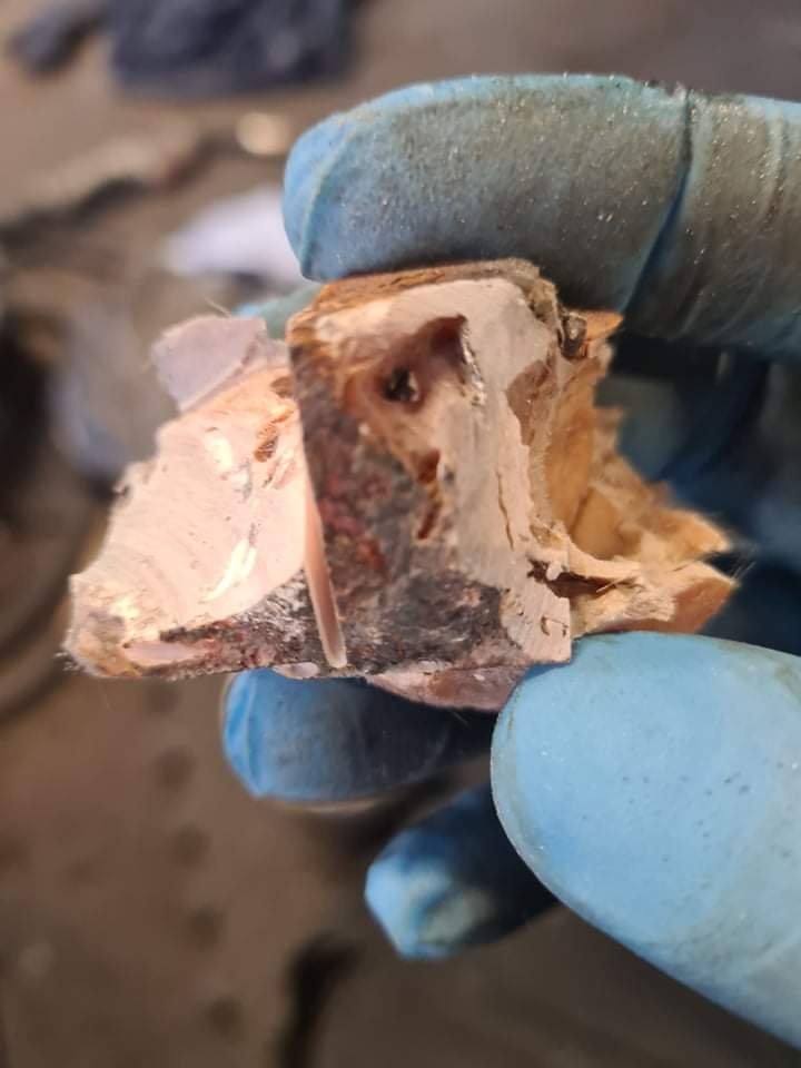

Massive wads of fibreglass and bondo used to hold a previous arch repair in place rather than repair the rusted inner arch and welding to that.
Glad this Zed is in good hands and getting things done properly ?

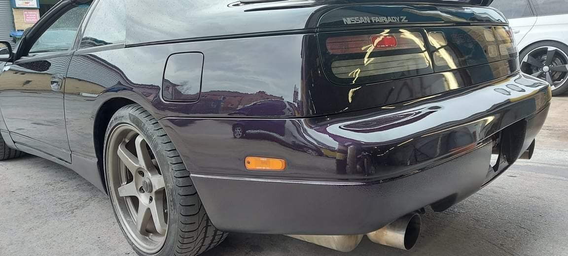

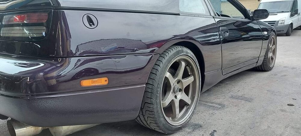

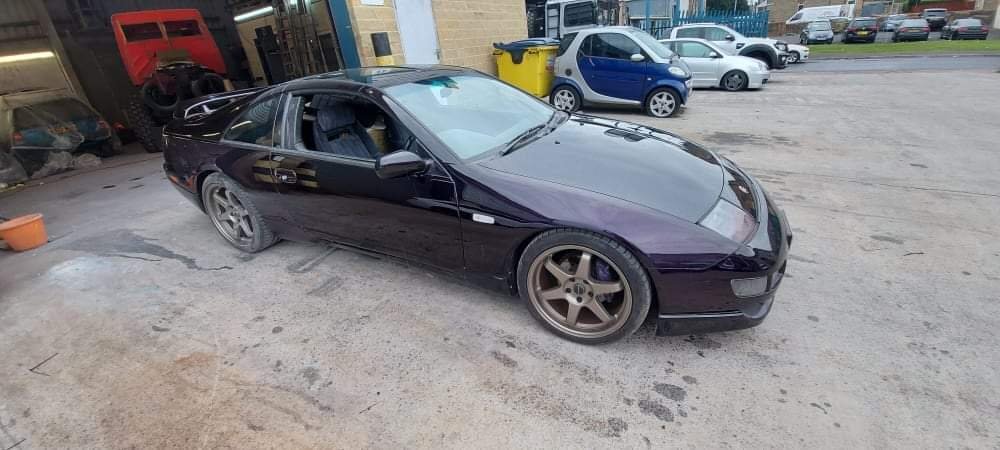

Not the best quality pics, but look - no rust!
Huge thanks to Ali for his time and effort on getting the car to this stage.
Really need to get the bonnet sprayed the correct paint code soon. These pics really make it stand out.
Alignment booked for Thursday.
Then MOT on Friday.

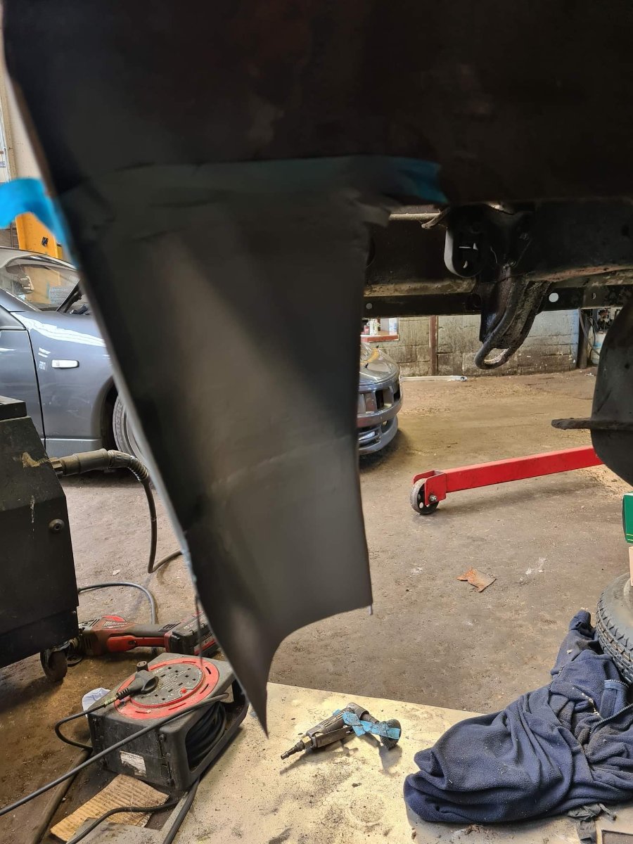

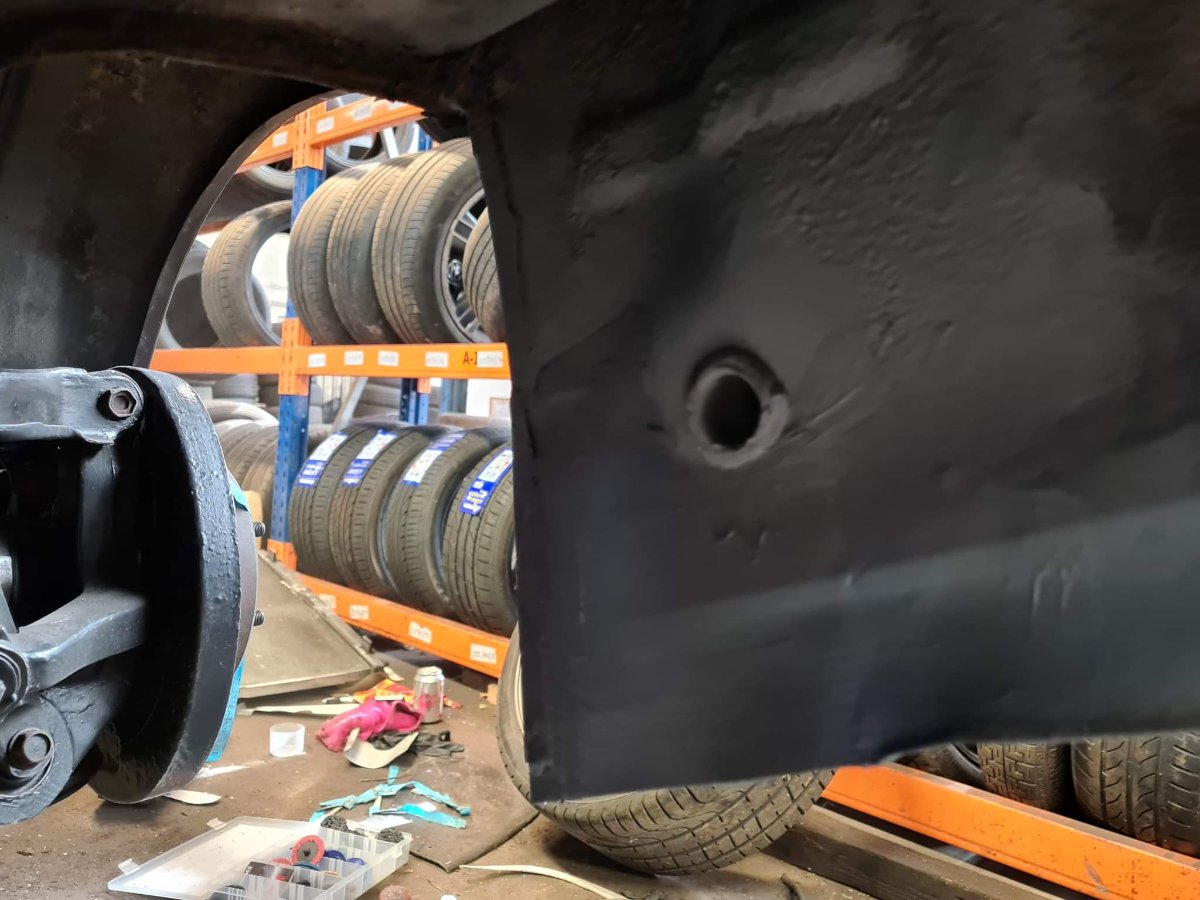

Lasts bits done.
Lower rad bracket fabbed and fitted. Seam sealer and underseal applied to newly welded areas and wheel arches in general.
Ready for her MOT ?
Again, my thanks to Ali and AB Autoworx for his time and patience with my car. Counting down until Tuesday when I pick her up (assuming she passes the MOT this week obviously!)

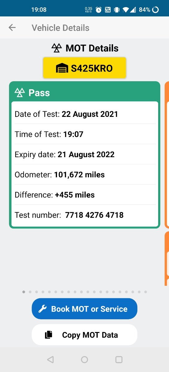

LOTS more still to do. But so pleased to have a clean MOT. First time it's had one with no advisories since 2013. And precisely 365 days since I picked her up.
Collecting it tomorrow, enjoying it for a few weeks or so, and then I'll start dismantling it again to move the project on.

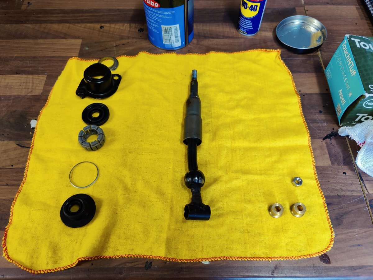

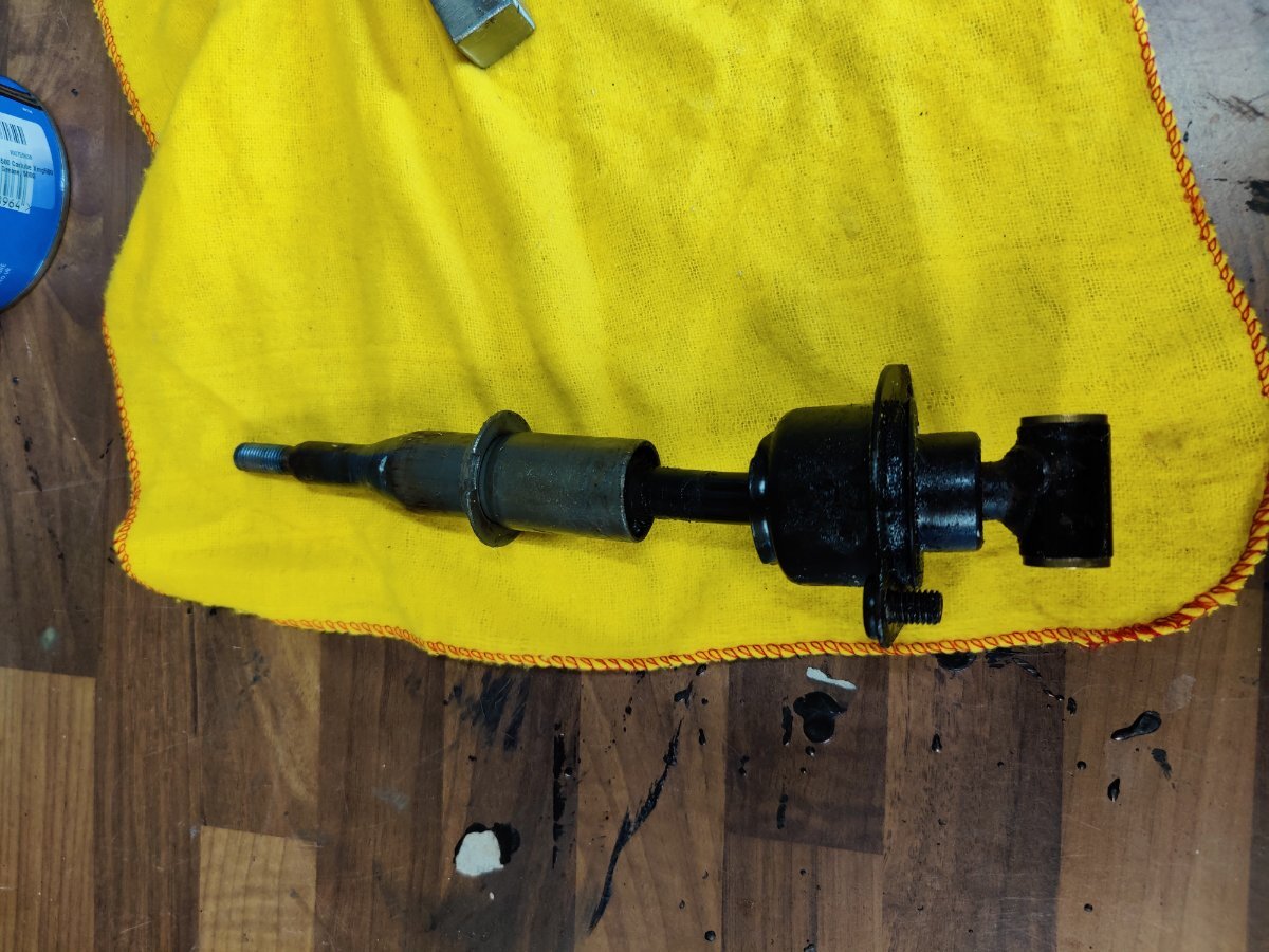

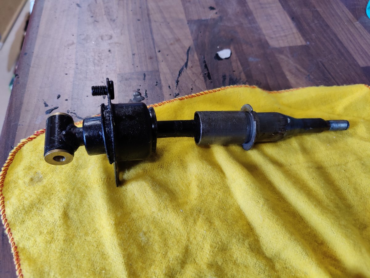

Quick job this morning. OEM shifter rebuilt with OEM kit and Z1 bushings and ready for install. It's currently hammering down here so install is on hold until that stops.
