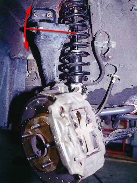

Unknown brand crappy adjustable FUCAs removed. Finished painting up my spare set of OEM upper arms, and will install the Whiteline adjustable bushes in tomorrow and refit to the car.
New Moog drop links in. And I've cleaned and painted the front ARB and have new bushes and brackets ready to go on with it. Weirdly this is a 28mm ARB so either a previous owner uprated it, or Nissan gave up on the crappy thin ones that usually came with NAs by time they got round to the 99 specs.
44 minutes ago, AndrewG said:
That "silver" bolt is just temporary?
It's what comes with the Whiteline kit. There's a bolt either side into a threaded tube instead of a through bolt. The one on the other side is longer and has a locking nut to assist with camber adjustment.
It's missing it's split washer in that image, but I've since found it and fitted it.
The split washer is about the size of the OEM flange. And whilst it won't distribute in the same way, 100s of people run this system so I'm not worried.
Just so you know the arc that the outer joint of the FUCA travels in two planes as the vertical link travels up and down. This is not
commonly understood even by aftermarket parts manufacturers. It is one of the reasons that Nissan used compliant bushes to
allow for the twisting of the link as it moves up and down and the reason for the flanged nuts and bolts.
Fully aware but thanks for pointing it out.
The Whiteline bushes are compliant and have a significant lip to allow movement.

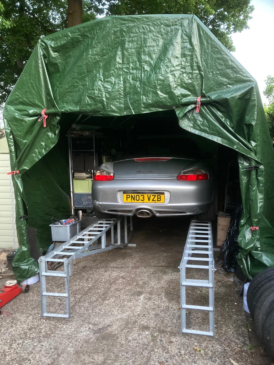

Great work, your opinion for getting the car higher was a lot cheaper than ours, my brother and I went half’s on a set of car display ramps. As soon as my Porsche is on the road, i will be doing the sills and undersealing on my 300. Good luck.
A pick of my brother testing them.
Edited by Bones28
2004 BMW Z4 30i
1991 Nissan 300zx TT Project
1997 Jaguar XK8 Scraped ☹️
Display ramps where an option I considered. Bit too big for my purposes unfortunately.
Totally understand they are huge and very long, but having had a jack slip before and survived, I’m getting to old for this.
