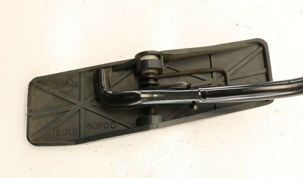

The brake and clutch rubbers are now on (what a fart on), now I need to figure out how the accelerator pedal pad itself comes off. I have a new one to replace it, but for the life of me I can't see how to get the other one off in situ without removing the entire pedal assembly. Any pointers?

Doing the same job Alex. Accelerator pedal has a hinge mechanism with return spring. The white bush needs to be pushed out to allow the metal
bar carrying the spring to slide out and be removed. I can't see how that can be easily done and reassembled without removing the pedal assembly
(just two bolts and the cable end fitting though).
The foot rest is part# 67848-40P00 and super expensive new!

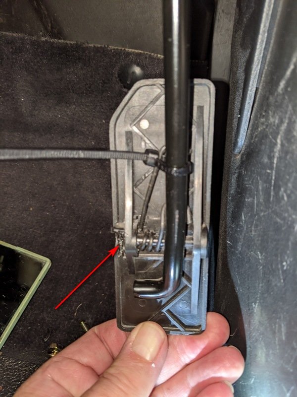

Just finished the job. Brake and Clutch pads go on a lot easier if they are heated up first and go soft and malleable. Only needed
to remove the two bolts and turn the pedal assembly around. The only way I got locking bush out was to cut away the outer part of
the old pad moulding where it is secured (arrowed). This enabled the bush to be pushed out with the hinge bar. To relieve the tension
on the spring I cable tied it as shown until the new pad was in place. Rest the pedal against the floor stop and drive the new locking
bush into place with a small round bar.  You can correctly position the upper return spring by hand once the mounting bolts are back in.

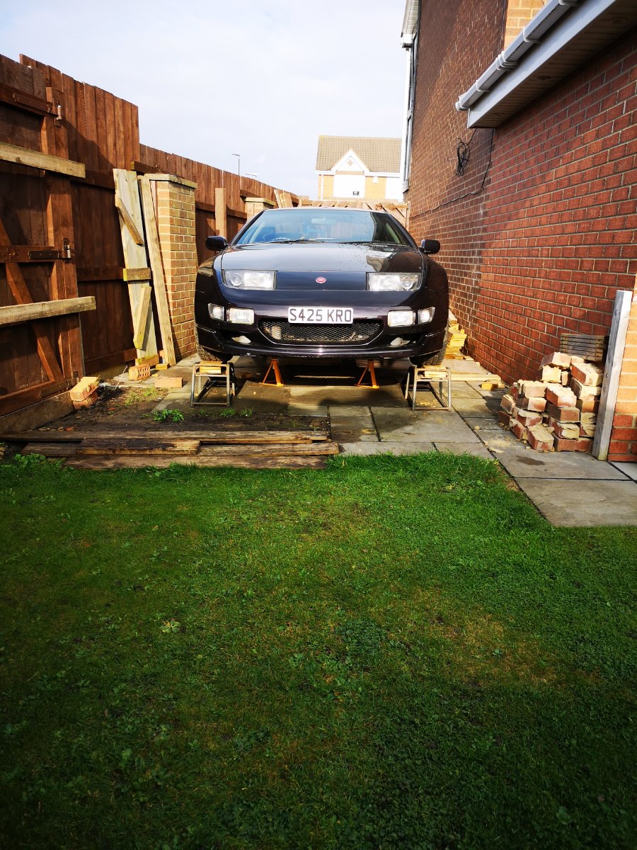

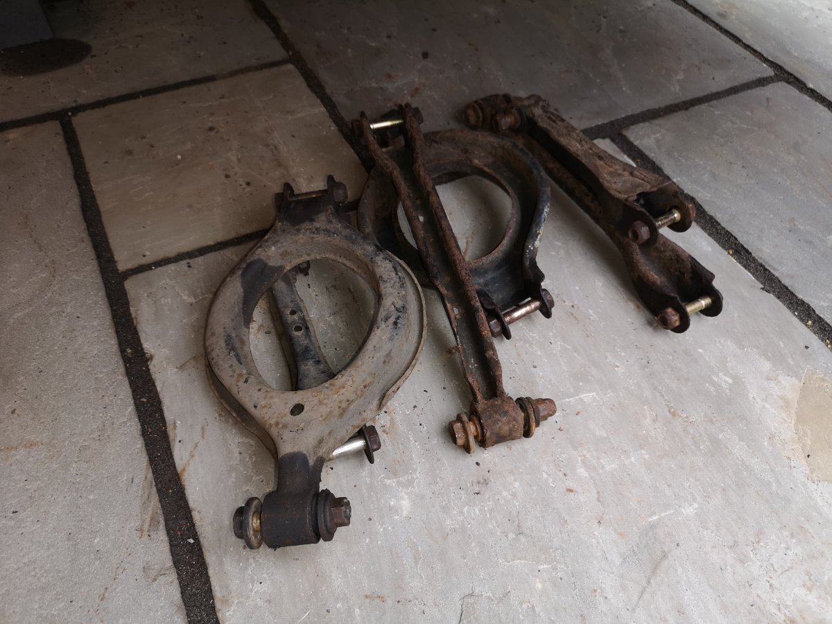

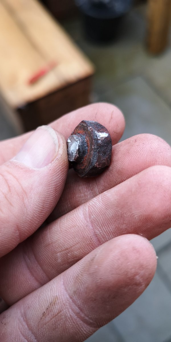

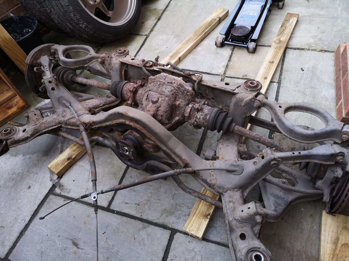

Made a start on dropping the subframe this morning. So far I'm about 3 hours behind schedule!

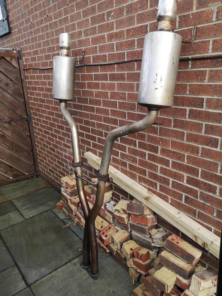

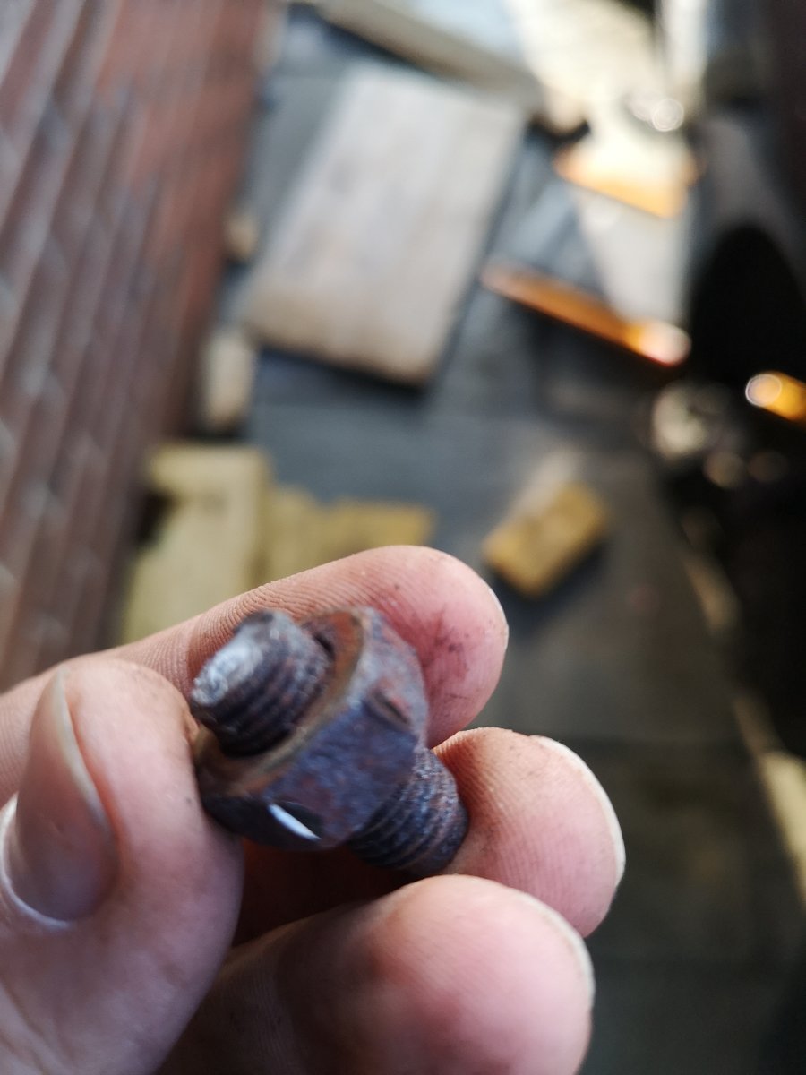

2 snapped bolts and a feck ton of swearing and I finally got the JapSpeed exhaust off after 3 hours of trying not to snap any bolts.
Hopefully have the subframe down by this time tomorrow.

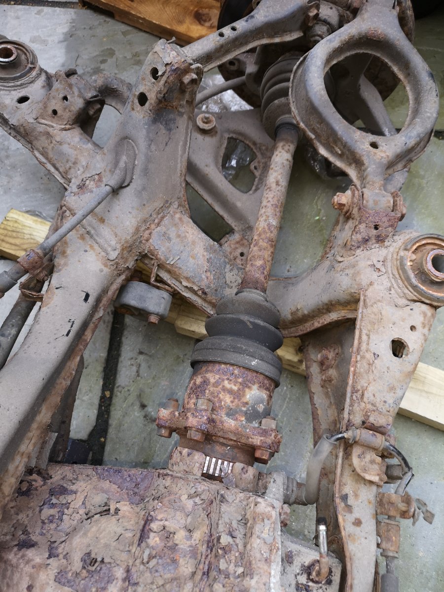

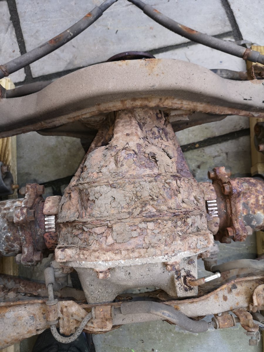

Bit of a boring update.
Subframe is out and almost fully stripped down.
Diff looks bad, but it's just years of underseal on top of surface corrosion creating an onion effect. It should clean up fine.
Bushes are in surprisingly OK shape for the most part. But I'll be replacing them all anyway.
