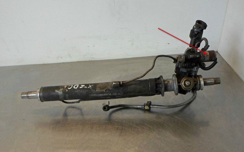

Are you sure it’s the pump? I’m sure your aware but there’s an actuator in the rack that applies resistance based on an ECU signal, this is speed based. If there is a fault with this system, the steering goes intermittently heavy. Typically if your Speedo dies it will do this, it’s bloody annoying.

1 hour ago, JaiKai said:
I had similar issue on my last zed and i also thought it was the pump, after checking out the small actuator on the steering rack it turns out to be a broken wire.
The part itself is on the drivers side of the rack.
I will have a good look, thanks for the tip!
Just a quick update, jumped in the car the other day to go to work and the power steering is back, its fine. If anything its better than before (it was heavy most of the time and sometimes light, but always working) now it is light most of the time and occasionally heavy. Im thinking that loose cable you guys mentioned is to blame, but has somehow re-connected?
