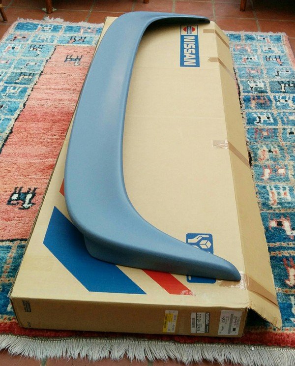

I like the OEM spoiler too - however I would have the Type 1 over the fibre-glass replica-OEM spoiler.
I have the replica myself and having seen the real OEM version on Simon's, Andrew's and Gary's (GSC's) cars, it just accentuates how poorly the fibre-glass version sits on the tailgate.
So my tuppence worth, ditch the replica and try to buy a real OEM spoiler (about £700 from Nissan) - or go with the Type 1. I should have done that myself back in 2018, so I'm not ruling it out for 2021...........?
I mirror Richard’s sentiments. The OEM spoiler does definitely give the rear end a slightly more “beefy” look but the TwinZ is a bit more sleek. You can’t beat the finish of an undamaged OEM version but a TwinZ product is probably the best finish/quality you’ll find outside the OEM option. For me, you can’t really go wrong with either of your options and if your OEM spoiler isn’t water damaged then you could save yourself a nice wedge of cash. Otherwise, it could well come down to the availability of an OEM one that could swing your decision!
AFAIK new OEM '89 spec spoilers are NLA (at least in Europe). I was lucky enought to get a new one from Nissan's European stock and at least two other members managed to do the same shortly afterwards. They may still be available from Japan (try jp-carparts.com). Don't give up on getting a s/h spoiler in undamaged condition as I have seen OEM '89 specs spoilers off old wrecks that are in A1 condition. How or why they have remained that way I have no idea, but they do survive. It all depends on how long you are prepared to wait. If you do manage to get one then I can show you how to mount it on the tailgate with the maximum protection to avoid the water damage which kills them.
Part# J6030-42P25
Edited by AndrewG

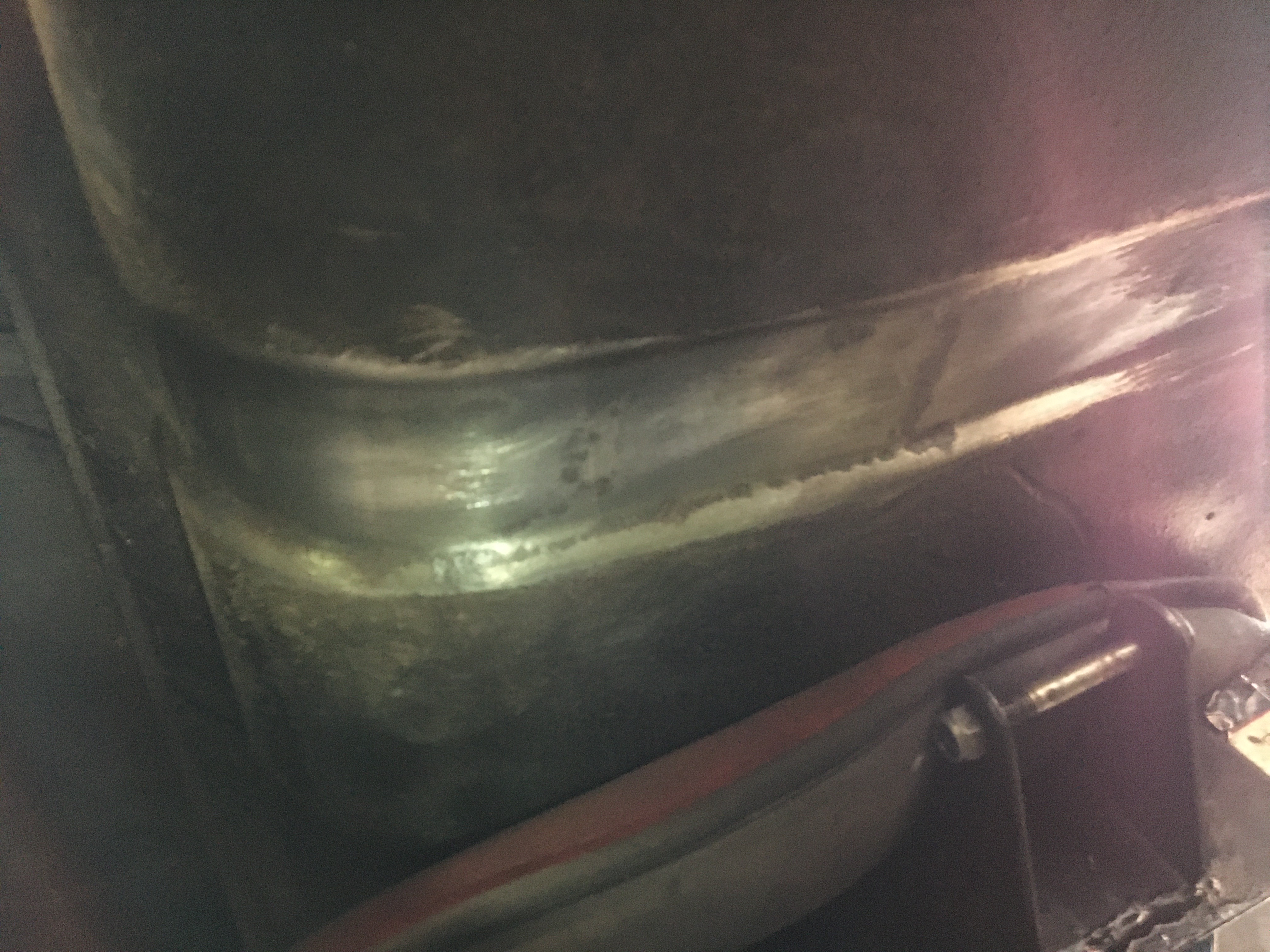

Last month I took the zed for an oil change and also to take the fuel tank straps off, as I noticed a tiny bit of rust under the tank straps. When I had the suspension bits blasted and painted, I specifically told them to check the tank under the straps, as I’d seen on the forum someone mention they had rust creep up there out of nowhere, which made me a bit paranoid. They blasted and painted the tank straps but didn’t tell me about this rust, which has peed me off [emoji2363][emoji35].
Anyway, I got a wire brush on one of those mechanics air compressor fed drills, and blasted the rust away, as per pics. I think these pics were taken part way through the sanding. The rest of the tank is mint as it’s been undersealed very throughly by previous owners thankfully.
There’s a fair amount of pitting in the metal. I covered this area with rustbuster epoxy EM121 to keep it going for now, and left it to harden. I’ve dealt with rust before but never with the metal this pitted.
Do you think with this pitting that the tank will be ok? Or will the rust restart eating away again? Would appreciate your thoughts guys [emoji1417]
In the areas I've highlighted there is still rust. It may look shiny but that is still corrosion in the pitting.
Ideally you'd need to soda blast those bits to get it fully out and then paint with a proper paint scheme (don't bother with rustbusters - their epoxy paints are just rebranded Jotun marine paints. Available cheaper from SML paints or other marine suppliers).
If you've already epoxied over it, then you'll have stopped the worst of it and slowed it significantly as you've done good prep. However a coat of a rust inhibitor would have been better before the epoxy (I use neutrarust, but they all do the same job chemically).
For the size area it is, and the pits are particularly deep, you'll be fine to leave as is imo. Particularly if you are only using your car on summer dry days.
