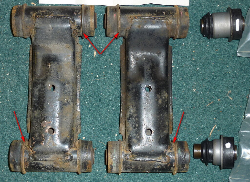

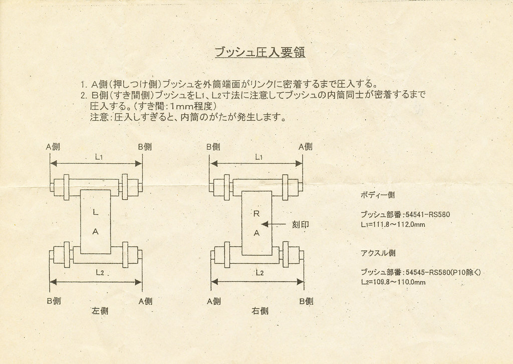

Just in case it gets missed the bushes for the FUCA (54541-RS580 and 54545-RS580) have specific fitment instructions (in Japanese).
Make sure the 1mm gaps indicated and arrowed are achieved rather than simply pressing those four bushes all the way in.
Hi Andrew,
Wise advice as always - many thanks, it's appreciated.

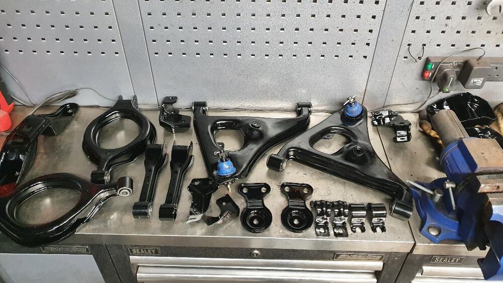

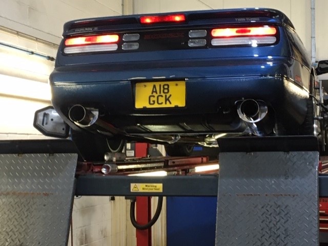

Some before and after shots. I'll get better pictures when its at the garage again in a few weeks.

Very nice [emoji106] Do you know exactly what they used to paint the control arms?
Thanks mate [emoji3]
Not too sure actually - all I know is it’s what they use on all their cars they do including the drift/track cars. I can ask them if you want to know for your zed?
They subbed the sandblast/painting to another shop in their little business park, which is filled with jap performance or motorsports shops.

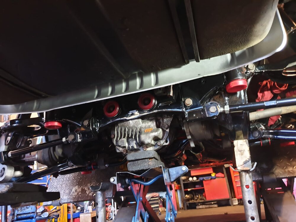

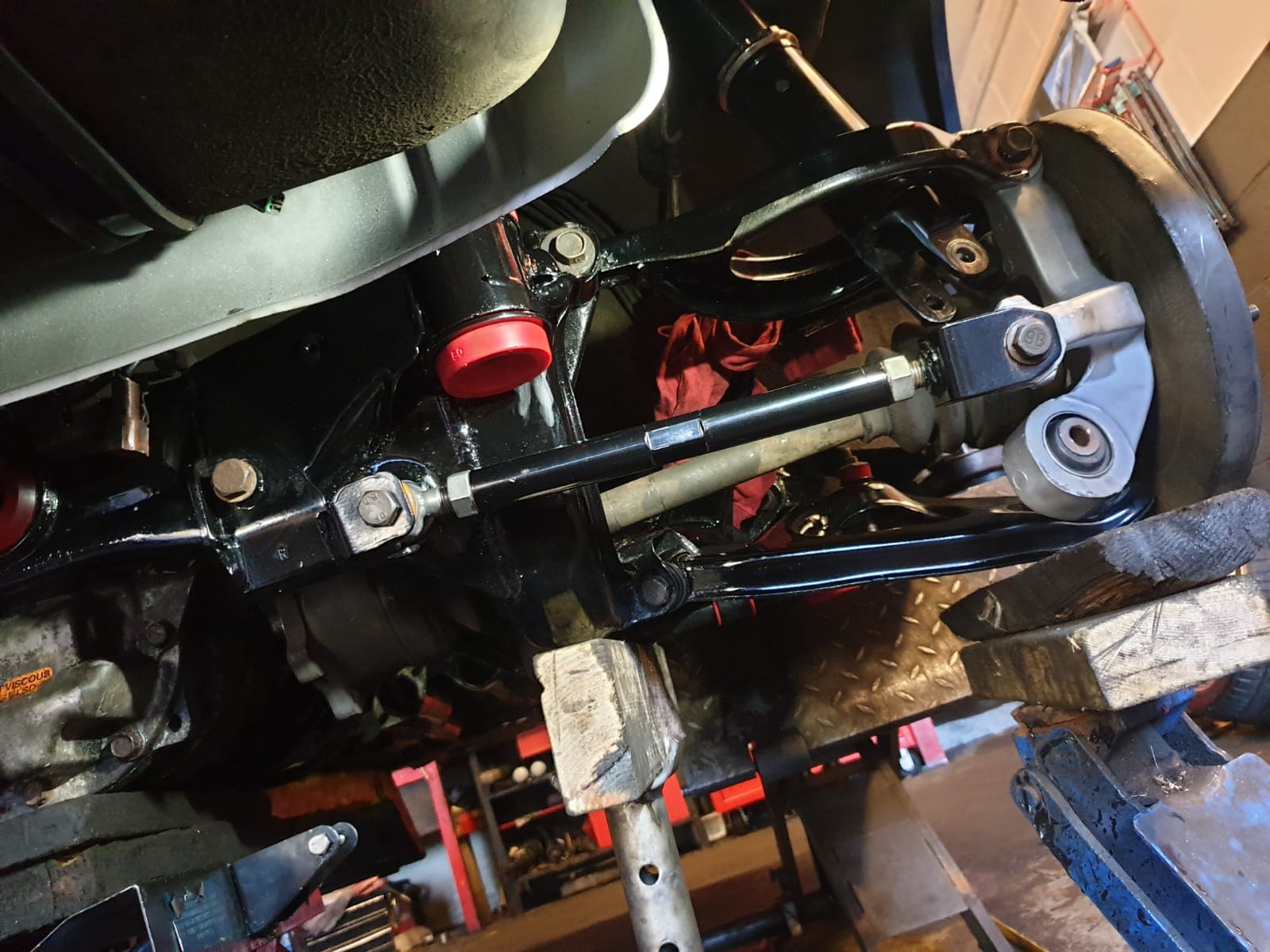

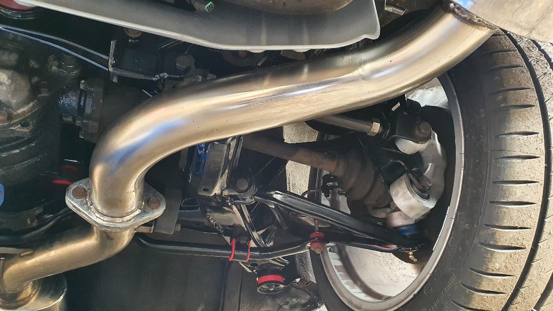

As planned, went to my local garage yesterday and worked with the guy on the zed as his assistant trainee mechanic haha, to drop the rear subframe and replace the subframe bushes. Went for strongflex ones as recommended by the original jap performance garage I used - they said they’re better quality than energy suspension and they weren’t wrong. These bushes didn’t need the metal subframe sleeves or the washers - they were just two solid pieces. Material and finish felt higher quality too, which was reassuring.
Armed with a guide from czp and FSM torque specs, we managed to finish it after a long long day. Went for a drive after and all seems to be perfect, thank god!
Whilst I was there, me being me, I cleaned up the exhaust and wiped down the newly painted suspension parts.
Some pics of old vs new bushes and of the subframe.

Looks smart mate. Glad you got it all sorted.
Also I'm pleased to see the pics as I was having a head scratch on which way up to install the lower shock Bush. That pic shows it perfectly!
Give me a few more months and I'll catch up to you! ?
That subframe looks well sorted and super clean Naz [emoji106]
Thanks mate that’s appreciated. Only trying to make it as clean a car like yours! One day, one day...

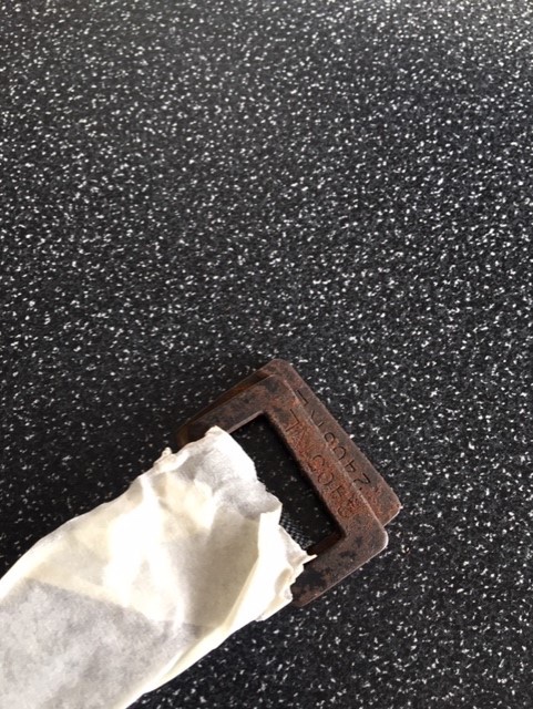

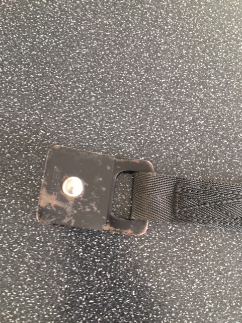

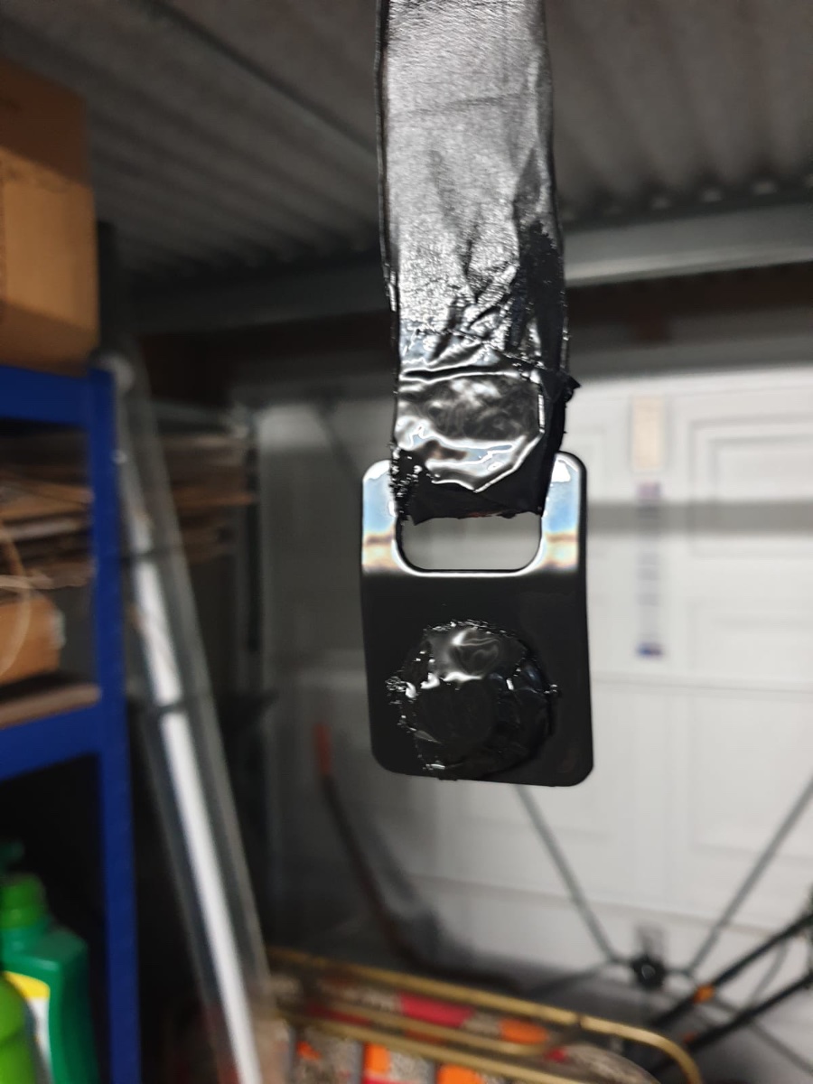

My Zed didn't come with a complete set of targa hold down straps for the boot; the long section was missing. This wasn't the end of the world, but was a bit annoying, as I had to wedge my picnic matt and sun shade around the targa panels, to prevent them scraping the boot plastic trim sections. After looking through eBay and messaging various breakers, I finally found a complete set, and bought them early this month.
Ended up sanding them down to bare metal, as they had a fair amount of surface rust. Painted them in the freezing cold in my garage which wasn't the best idea, as the paint found it difficult to cure to a decent finish. Used a hair dryer which seemed to help them cure and then brought then indoors for a couple days to get nice and solid. Got them fitted in the car today - I think that's the right way to put them in; never seen any fitted in person!
