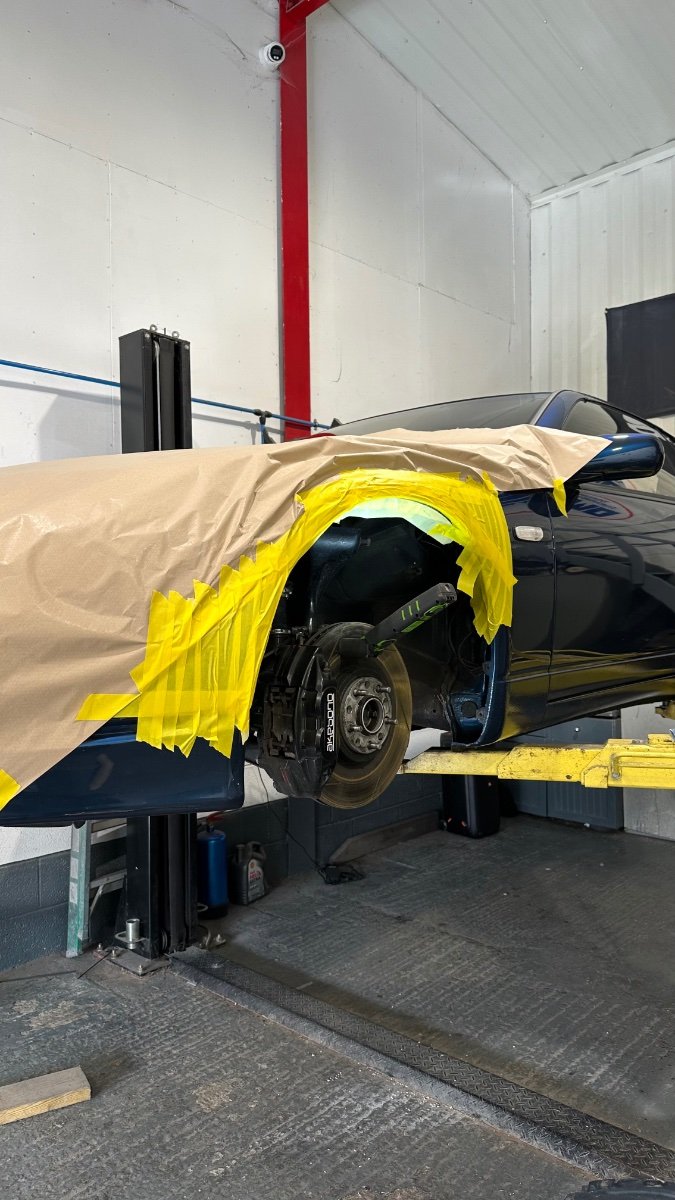

The Zed was booked into the bodyshop 23rd March but sadly due to the coronavirus lockdown, these works are now postponed. The works were to fit;
- 99 spec front bumper
- Respray to bonnet, both front arches to get rid of peeling lacquer, drivers door, rear bumper and getting rid of surface rust to around rear lights/boot

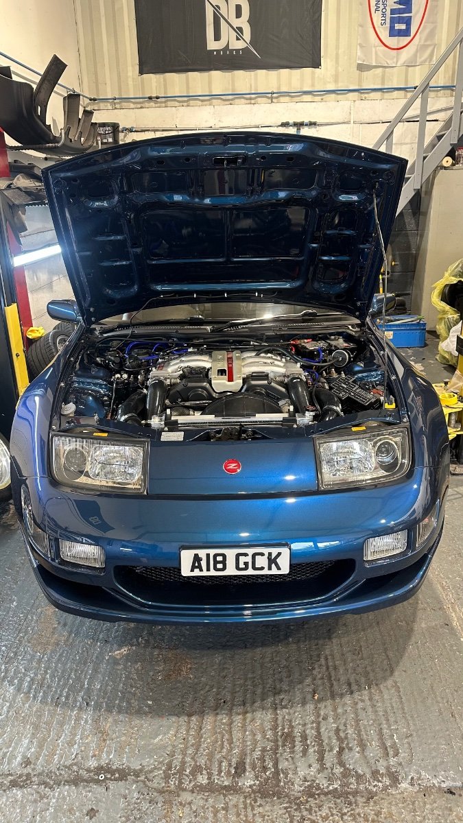

  • Finished putting the engine bay back together this morning and got out on the road. Went straight to Shell and filled up with V power and pumped tyres up. Bought one of those fancy Ctek battery charge

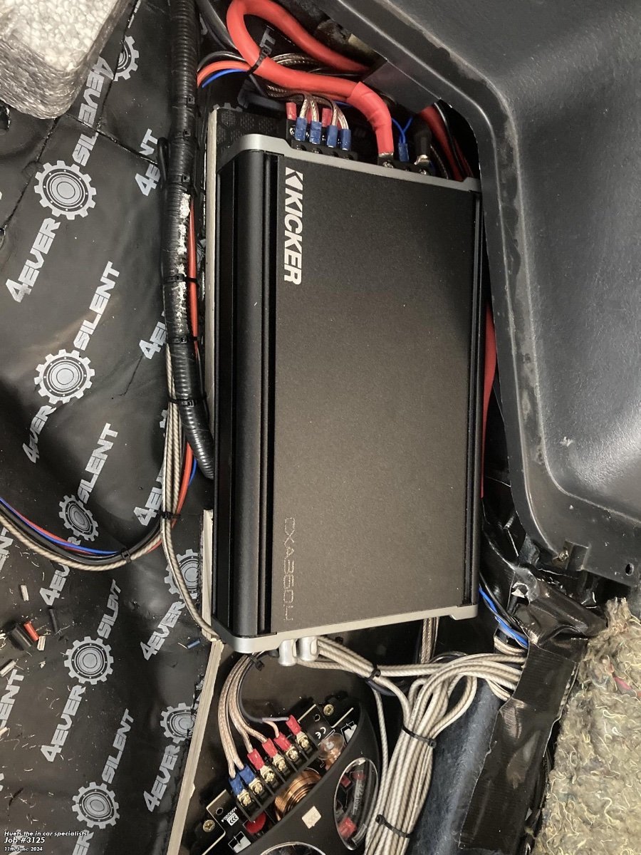

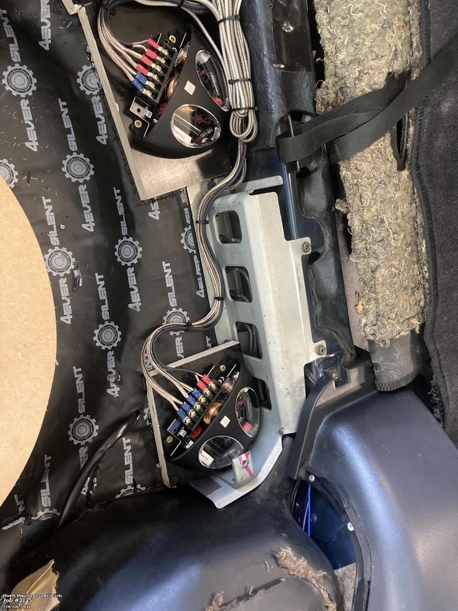

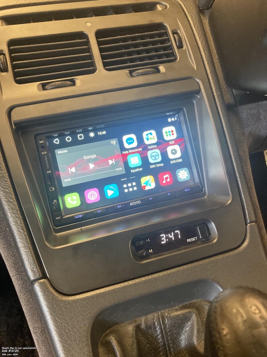

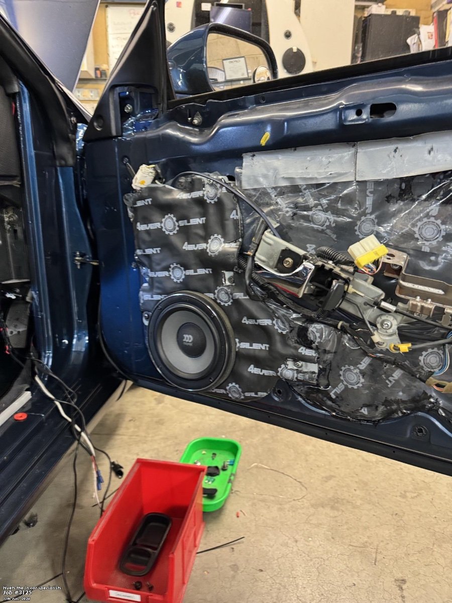

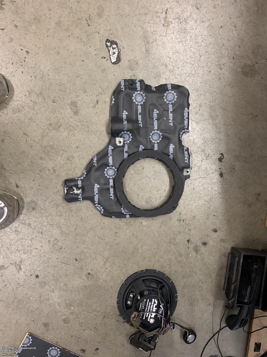

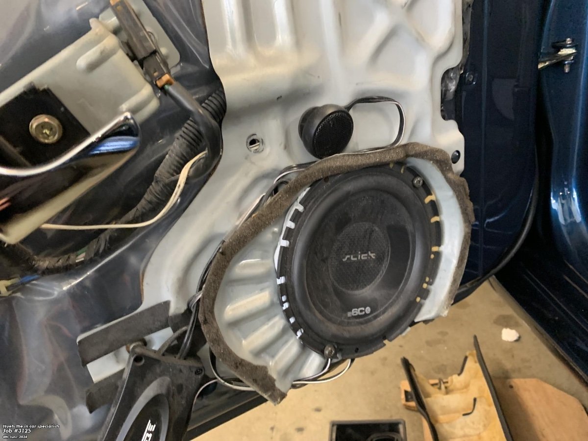

After 4 years of only half the speakers working and an outdated alarm system with only one working fob, the new audio/security installation has all been completed hurrah! Good timing for the security system as the day I went to drop the car off to the audio shop, some thieving bastards took an angle grinder to my garage defender lock/brace, but thankfully neighbours raised the alarm after seeing the sparks flying and hearing the noise, at 2am, and they left before attempting to break the locks. Funny as I'd been thinking about beefing up security on the garage a month before this happened... The wife and I think this is a sign from the Z Gods to give me a boot up the backside to get the security in order pronto!
Edited by Raja93
The sound system is now night and day, compared to the previous system where only half the speakers just about worked (with lots of crackling and jack all sound). With the windows up and A/C blasting, the new sound insulation and speaker quality is brilliant, makes the Z much more usable.

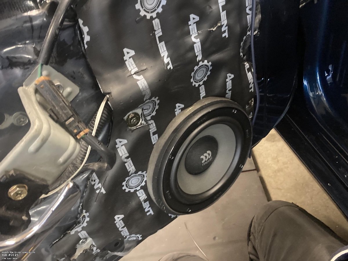

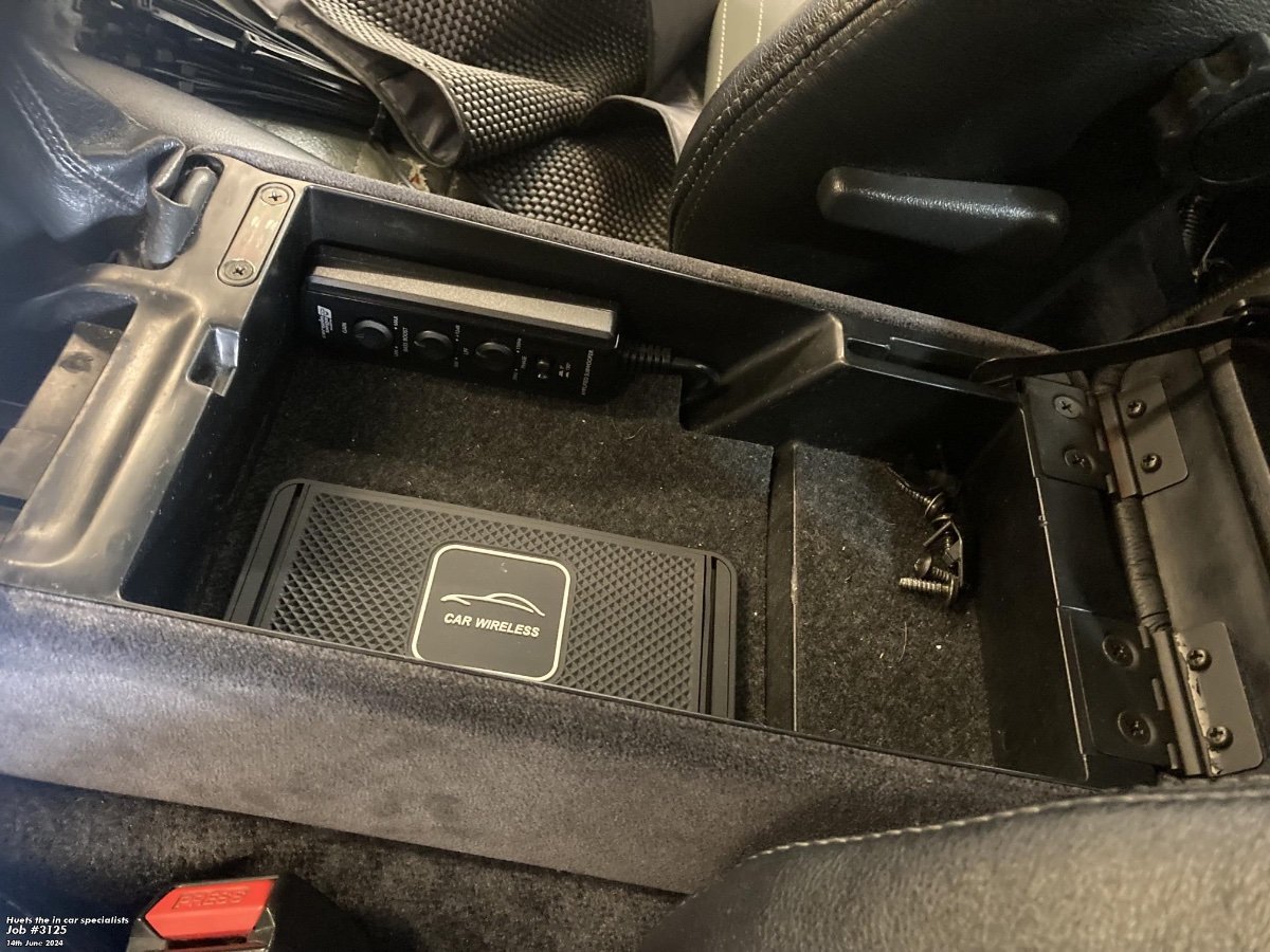

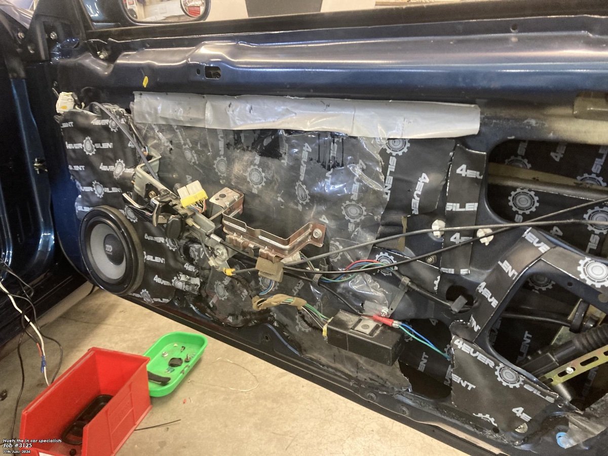

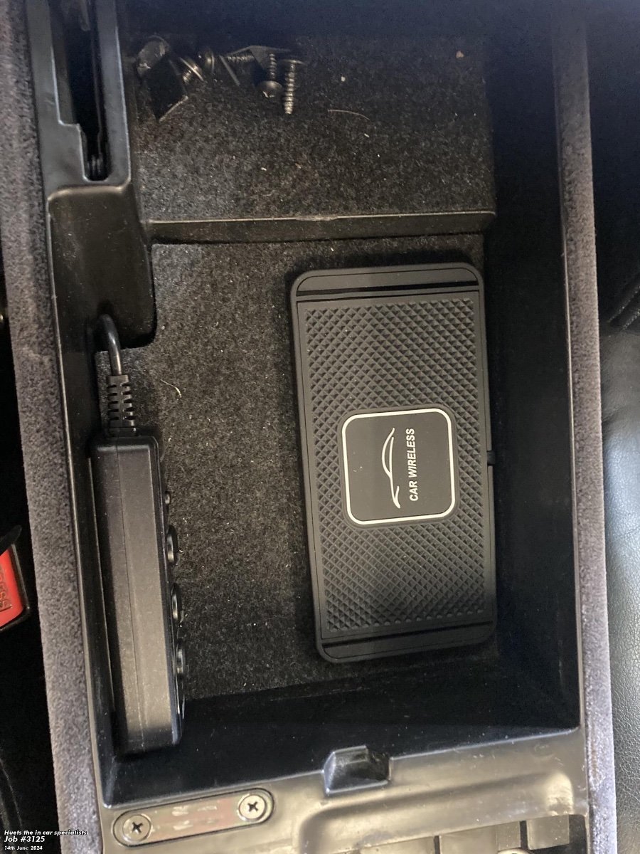

Over and above the works list mentioned in previous posts, inspired by Vigs install, I added a wireless phone charger and reverse camera which have both been fantastic additions.

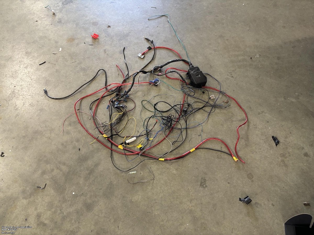

Upon strip out, the typical JDM car mess of dodgy wiring was found and stripped out, made safe and thoroughly cleaned up. All new wiring has been done very cleanly, new sound deadening to the doors and boot, foam to seal up the doors to ensure sound quality, a pair of Andrew G tweeter housings which is my favourite part! Broken brackets to the head unit mounting points were found, from previous owners - all has now been repaired. Sadly as they encountered a lot more extra work than anticipated due to how tight the Z is, the wiring routes and the repairs/wiring tidying, they rushed the tweeter housings and fitted before the paint had fully cured - I had been rushing to get the car back when the sunny weather arrived. They'll however take it back and refinish them to get a nice smooth finish, in a few weeks time, so all will be well. I appreciated their clean work e.g. placement of the alarm LED perfectly centre in the bezel trim. Lots of photos were sent and updates every few days, which is always a good gauge of a quality company. Talking of photos, here's plenty they sent me;
Spaghetti wiring:
Shocking old speakers and interesting tweeter location.....:
Centre console brackets broken:

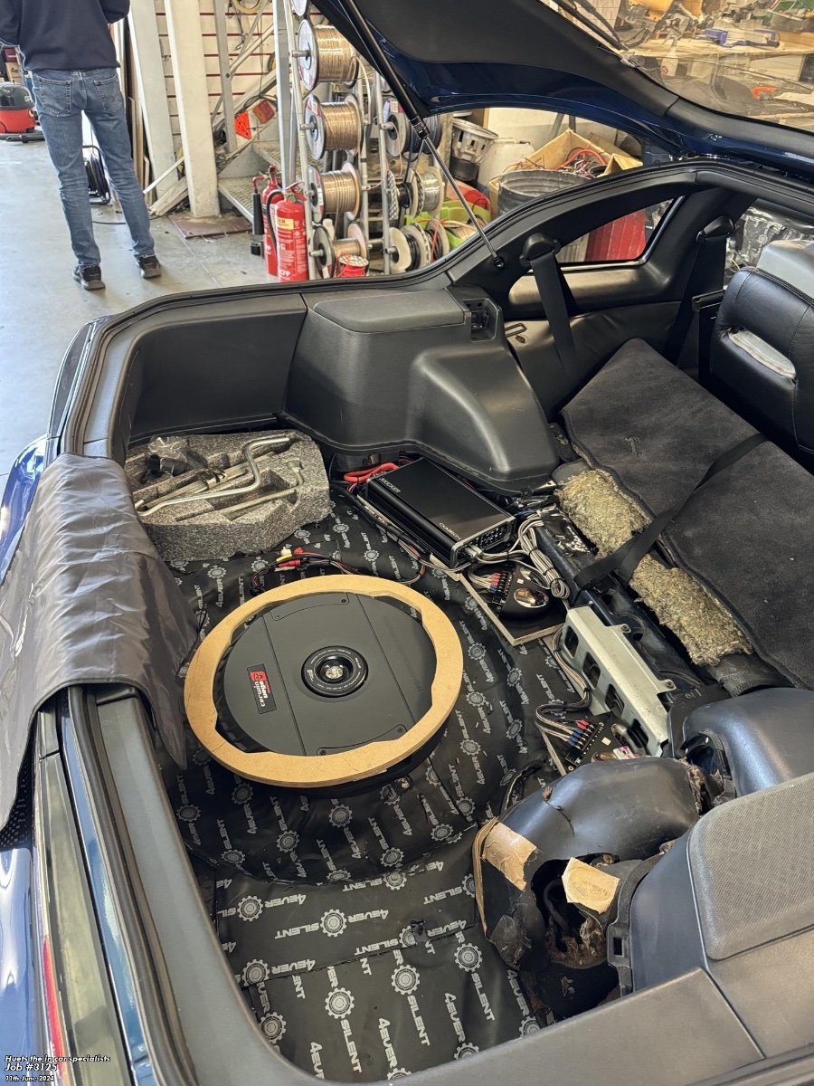

Various installation pics of the new goodies and sound deadening:
Edited by Raja93
Did they raise the boot floor to be level with the sub? Or do you have it sitting a little higher? Mine sits higher - not a big issue but would be great to have a flat boot floor. I've been meaning to add legs to the boot floor panels to bring them up a touch but it's been low on the priority list.
No it sits a little higher. With the other added work (wiring mess sorting and additional security than planned) and overrunning time, I left it as wasn't that bothered by it being a little higher. I only ever use the boot to store targas - probably will add some legs to rest of the boot floor panels in future so is more level. Let me know if you come up with a good way to raise it.

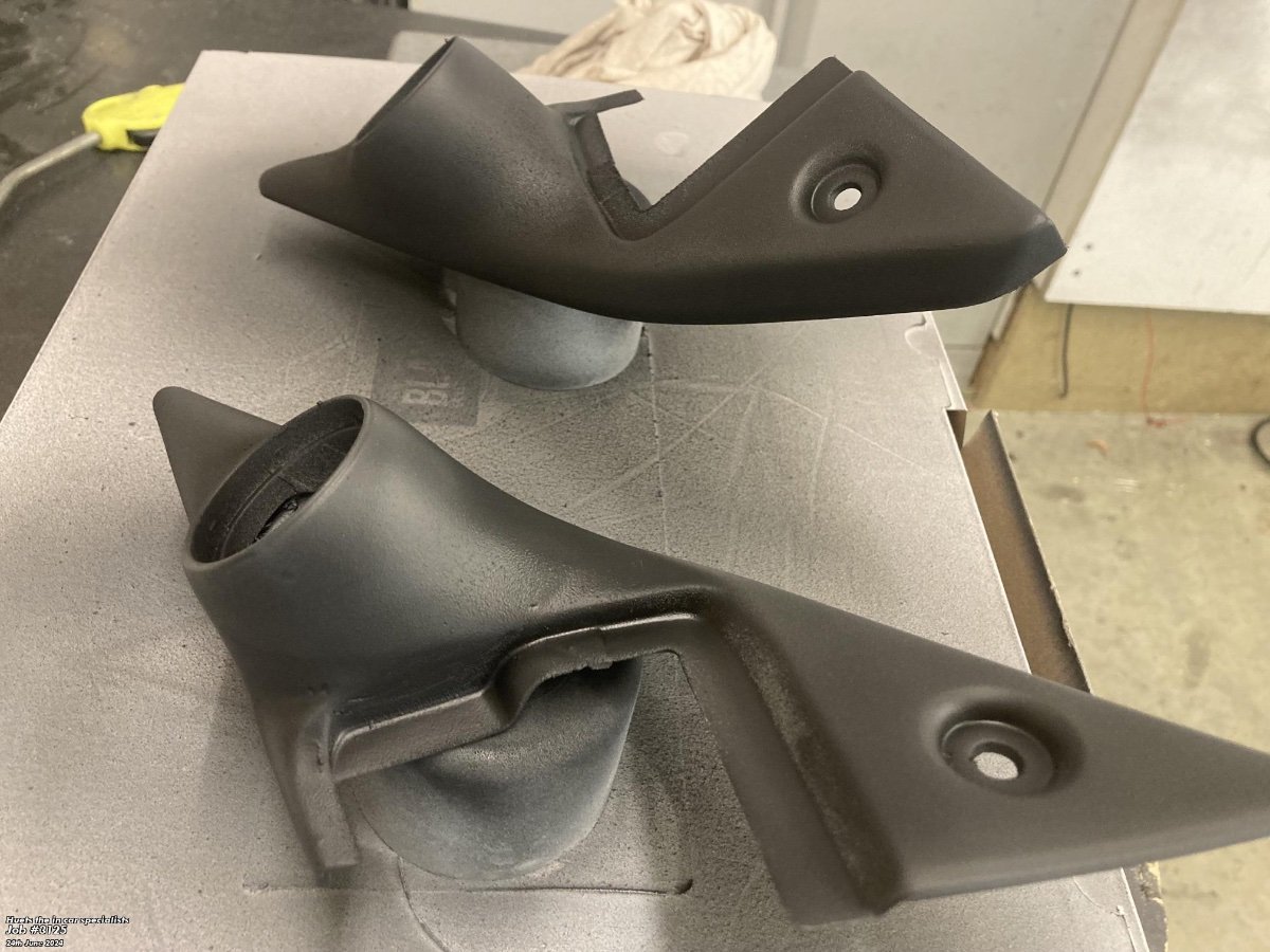

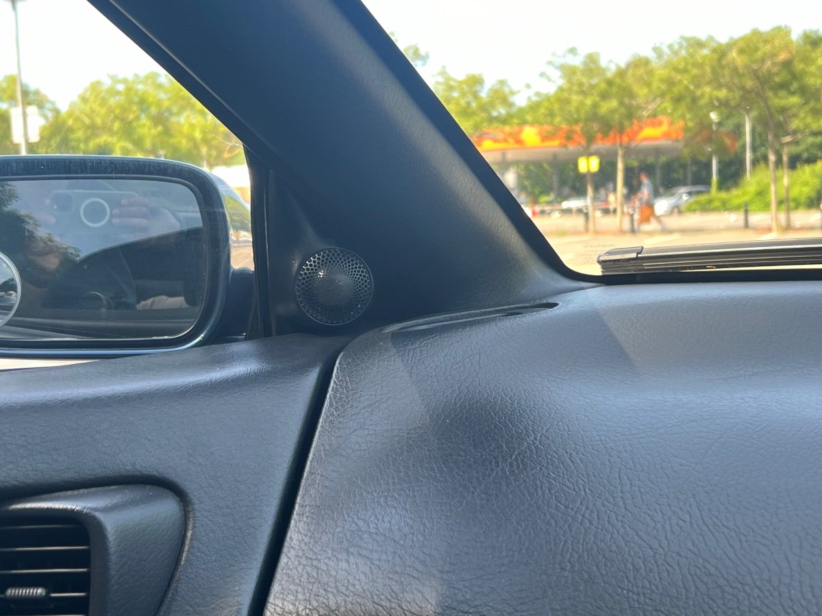

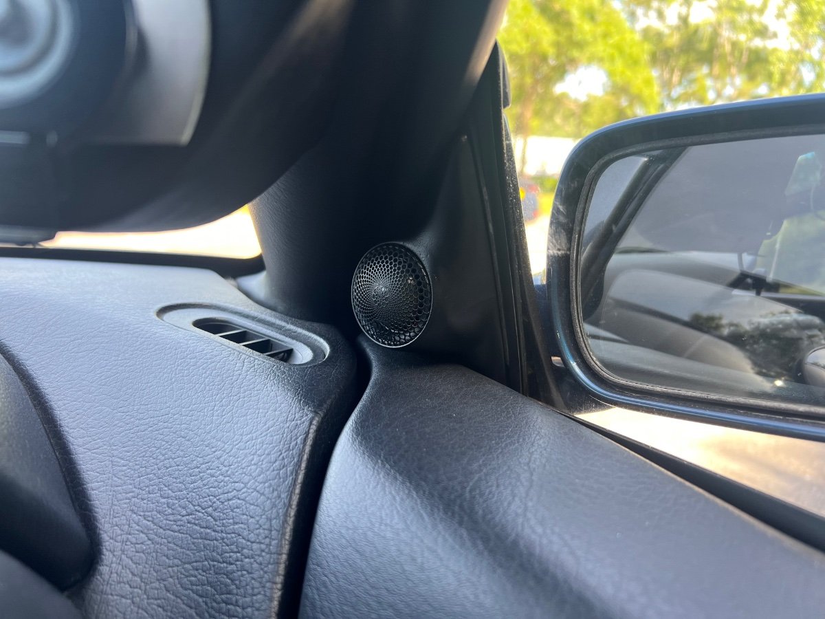

My favourite bits of the install are the tweeter housings, reverse camera which has relieved my parking paranoia and the google maps on screen 😃
These look great!! Where are they from?
Mine were custom made by my audio shop.
If you look up AndrewG’s profile, or search tweeter housings, you’ll find his how to guide which is very thorough. I showed this guide to my audio shop and they said it’s a well known old school method they’ve been using for 30+ years.
If you find a good audio shop who do fabrication, they should be able to make them. Will need your car on site to measure it up though, so make sure they’re local enough.

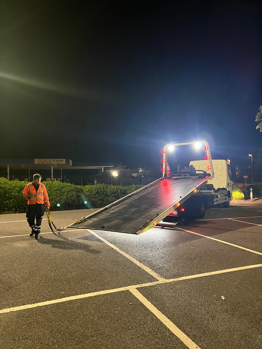

After I had the sound system and alarm replaced, a month later I had gone to see a friend and popped to the supermarket car park, which wasn’t in the nicest of areas. When I went to lock the car, the alarm kept going off. Not wanting to leave it unlocked, I stayed in the car and tried to start it, which is where the evening went pear shaped! It wouldn’t fire up, then would start but only at 400 rpm or so then die. Tried to fire back up and the dash lights were flickering like they do when your battery is dying. 5 hours later a low loader turned up and took us home.
Had a few friends come down whilst we were waiting for the transporter and we found no fuel pressure. This therefore pointed to the fuel system. I took the fuel pump ECU out to test it and all came back clear. Next was to test the fuel pump and found power was reaching the pump plug so concluded the fuel pump had died. A replacement was ordered straight away and replaced by a mate. Had almost 2 weeks downtime which was annoying as the weather was good but not the end of the world.
I got to inspect the inside of the fuel tank which is absolutely mint, not any signs of any corrosion or dirt, so that’s a bonus. Just need to strip the outside and repaint it next year.
Now onto establishing the cause of the pump failure, starting and alarm issues. Having researched a lot, I found my phone that I left in the centre compartment with the wifi hotspot on (for the head unit) can cause interference with this model of alarm and cause it to go off. The issue almost reoccurred when I was at a petrol station with my phones hotspot on but thankfully started up.
About a month later, I found my battery wouldn’t hold charge so had to put on trickle charger a lot - ended up replacing it whilst it was at the bodyshop. The battery can also be a cause of the alarm issues.
I was still confused as to why the 2 year old Walbro fuel pump died but have put it down to a combination of the above points. Since changing the battery, no further issues have occurred so touch wood, all ok.
