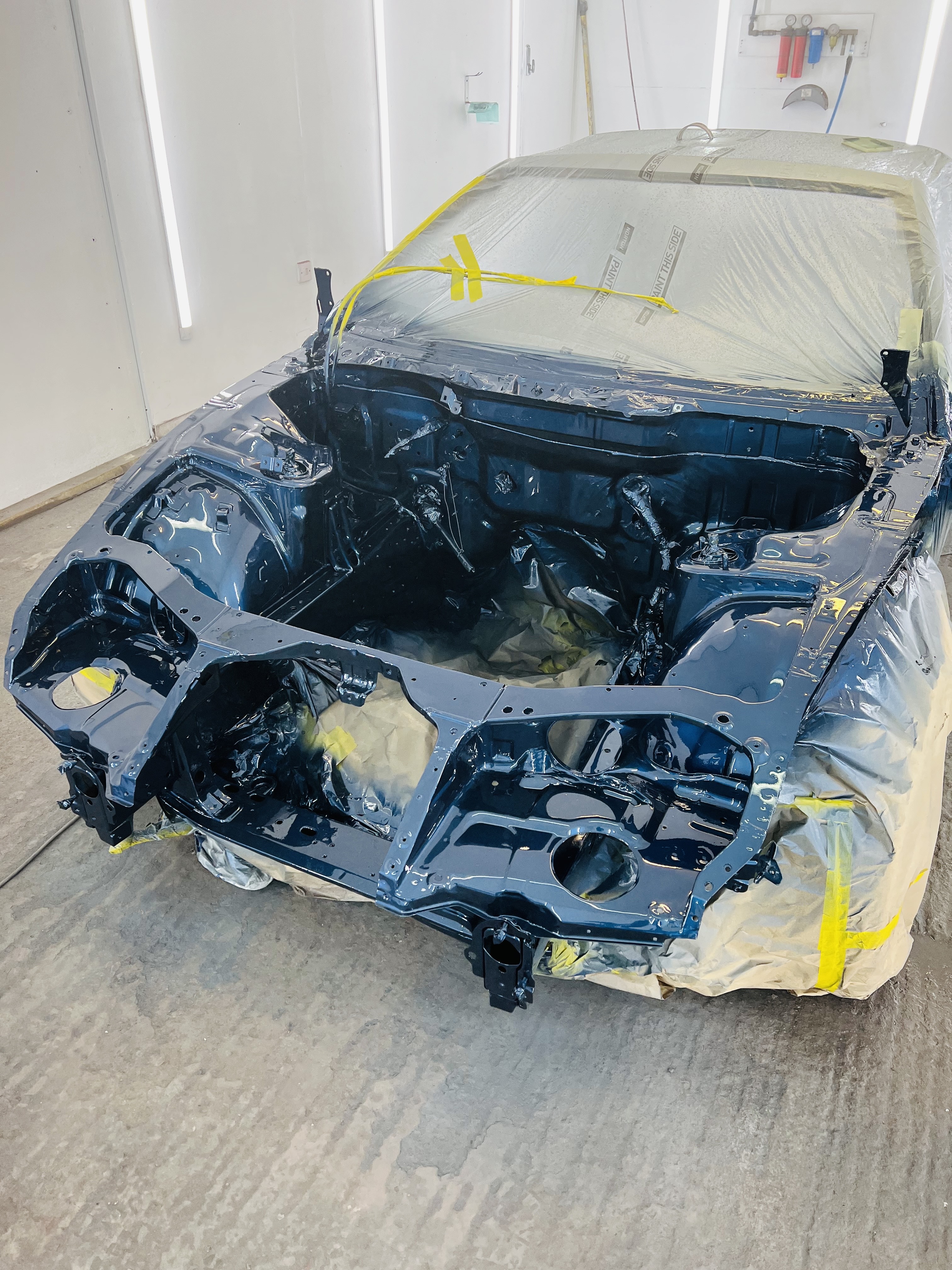

I know it’s just an empty engine bay so not much to see, but you gotta love the prep work... ?

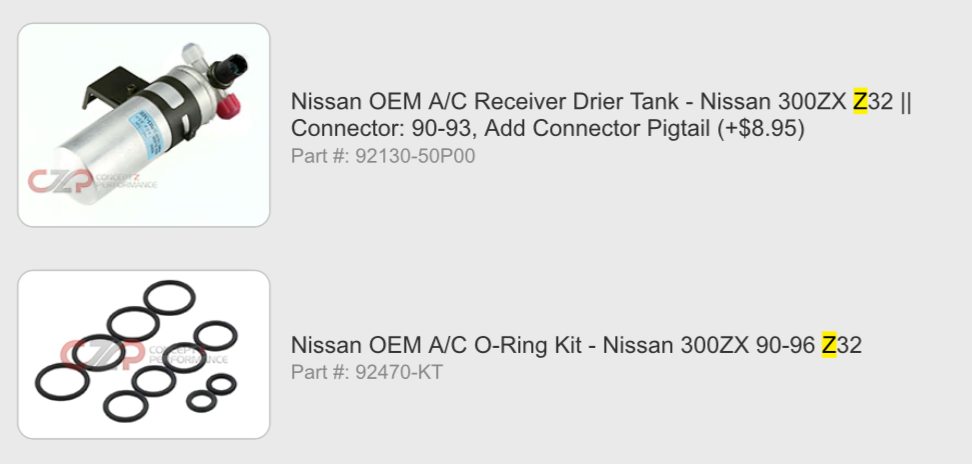

I ordered a shiny new AC Drier and OEM O-rings and away we go. Jim had a refurbished compressor already at his place. He mentioned the previous owner thought it was the suction valve which may be at fault. The previous owner told me he thought the AC compressor had blown! Either way, he will get the system up and running and then diagnose. I've read the Z32 Wiki for the AC System and the suction valve - seems like a pretty serious issue if that fails and you can't buy new replacements. Not sure how that will work out if that really is the fault - fingers crossed, Jim works his magic...

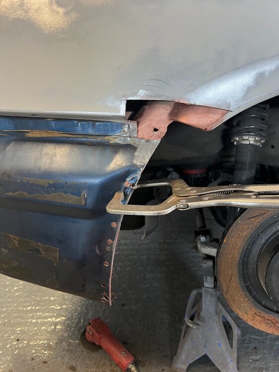

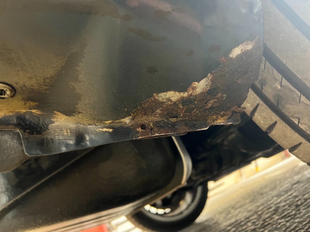

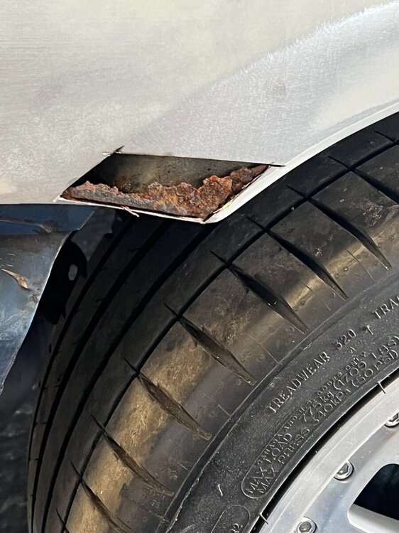

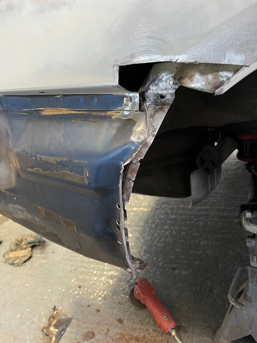

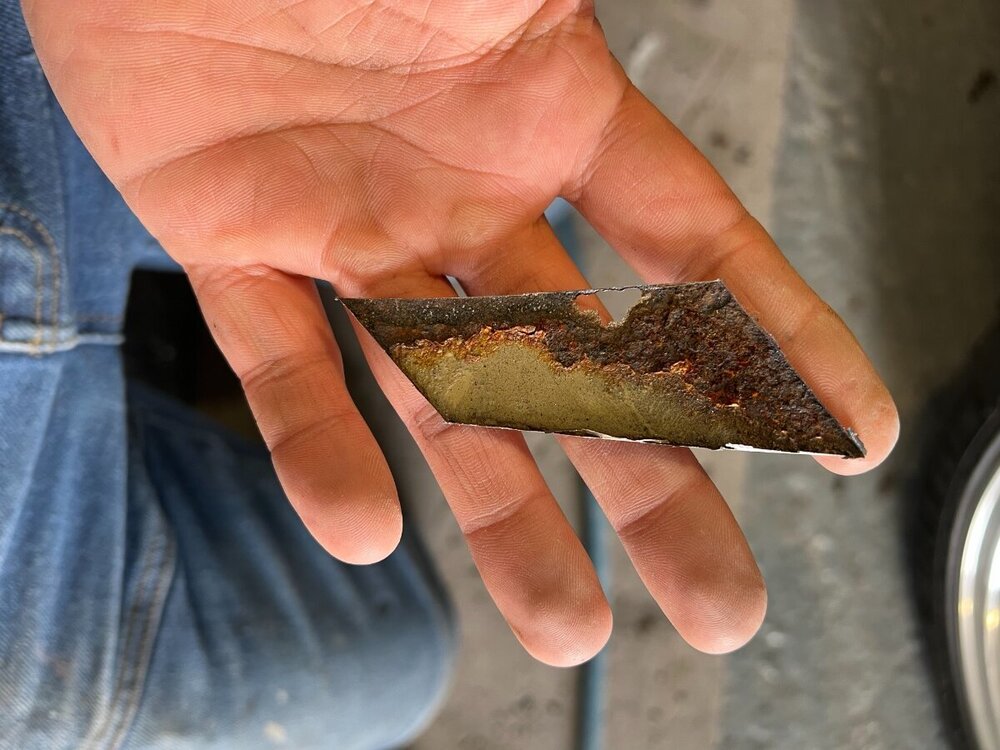

They found some rust lurking inside the drivers inner arch. How it started in there, I have absolutely no idea!
At one stage, they will fill all the inner wings and cavities with cavity wax, to help prevent hidden rust like this from cropping up. It had been on my to do list, since I bought her, but never got around to it. Glad they offered to do it without me even asking.

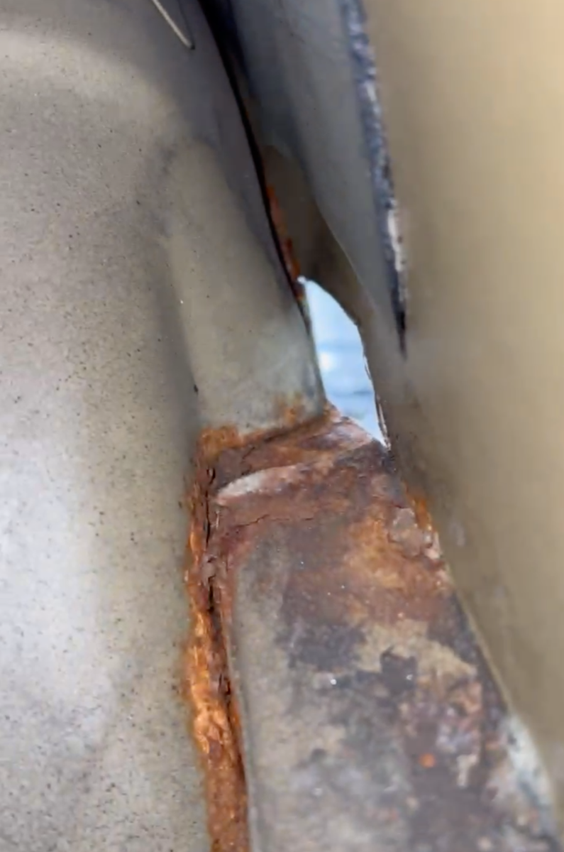

View from inside the arch - camera threaded in via the boot:

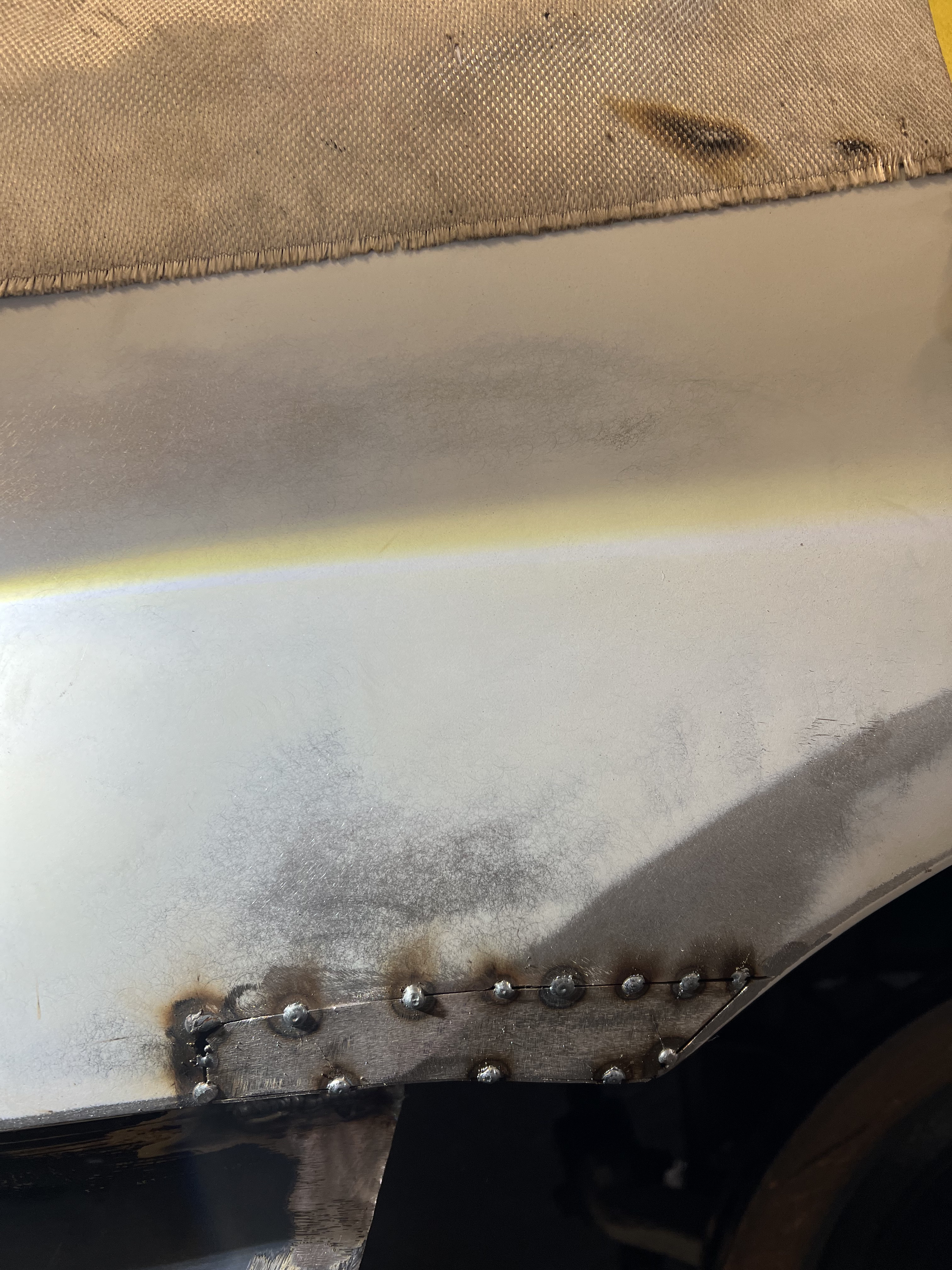

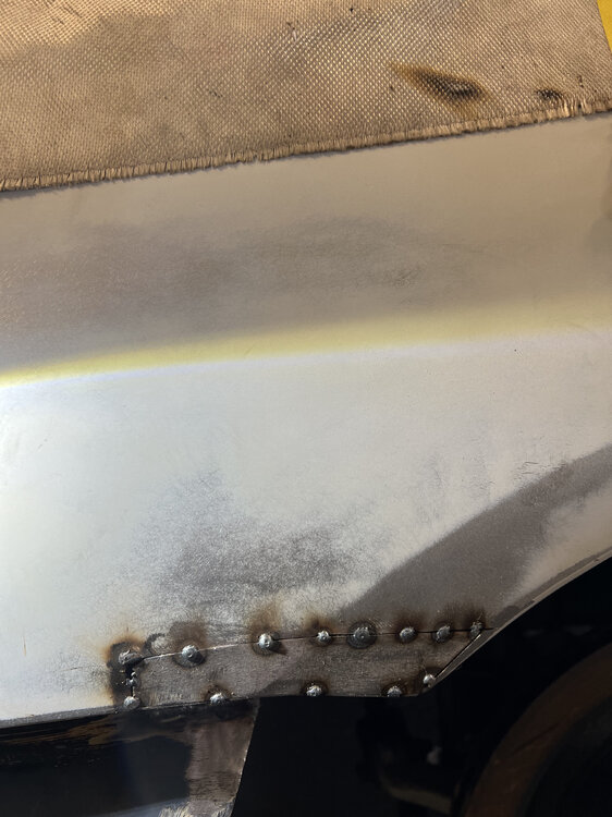

Some more photos of the drivers rear arch and also of the drivers side rear bumper bracket area, where we expected to find rust anyway, due to bubbling on the back of the inner arch.
Edited by Raja93

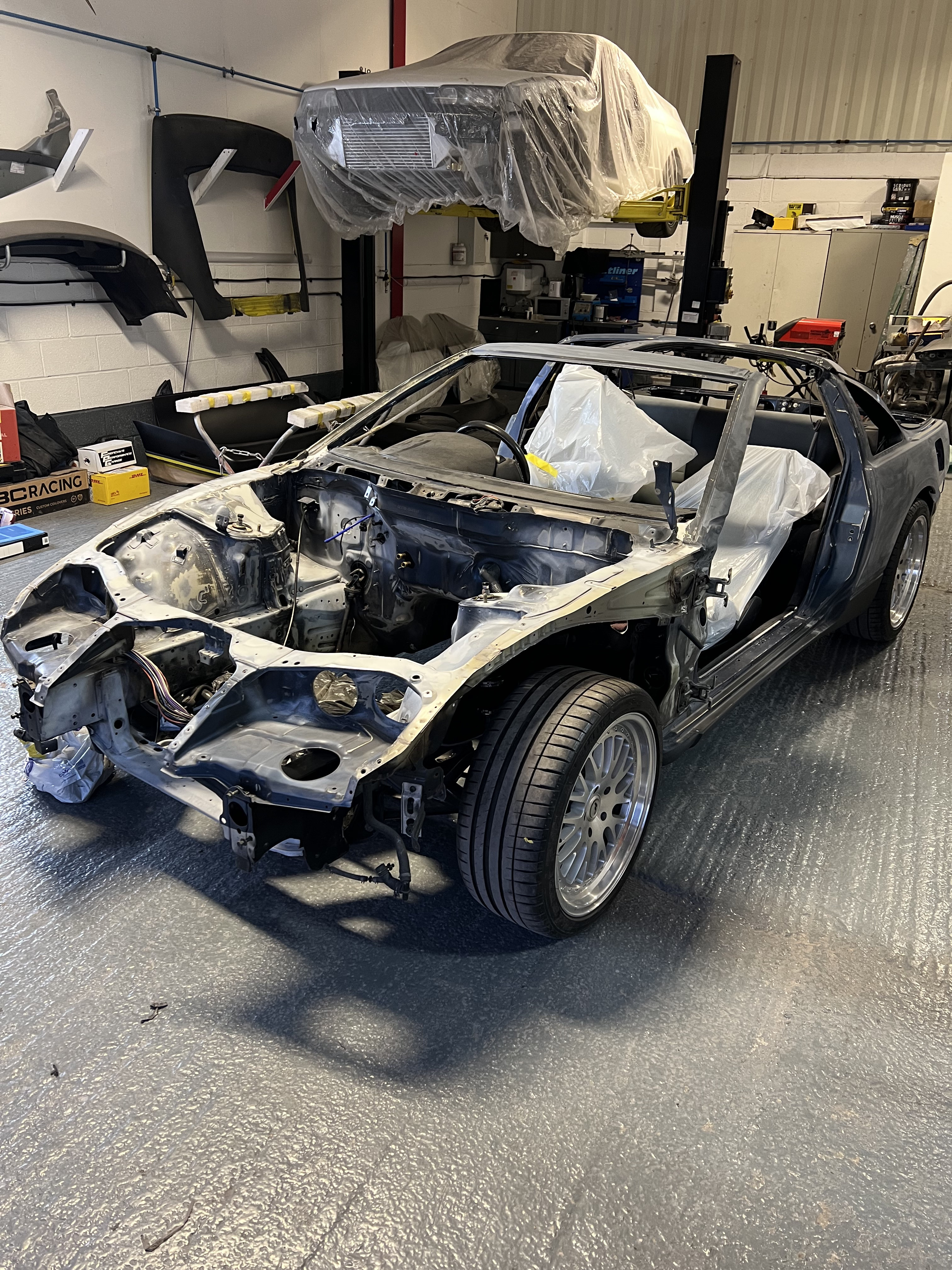

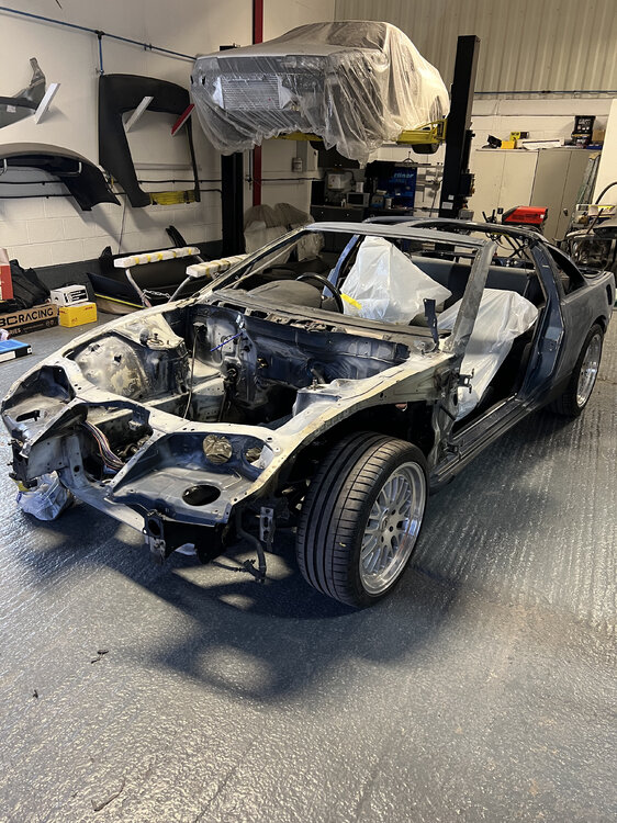

They're hoping to be complete by the end of May, possibly few weeks earlier, but end of May at the latest. Time to now work out how long the engine install will take, so I can get her booked in at Protuner, since they need you to book 3 months in advance as they're so busy. They were equally busy when I took her up there last summer.
Just had more repair pics sent through [emoji16]...
Good find that, would have ruined all the hard work when it rusted through!

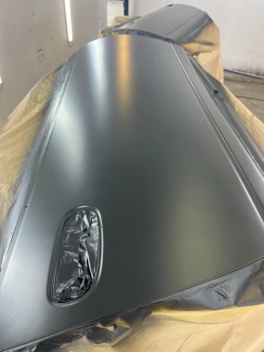

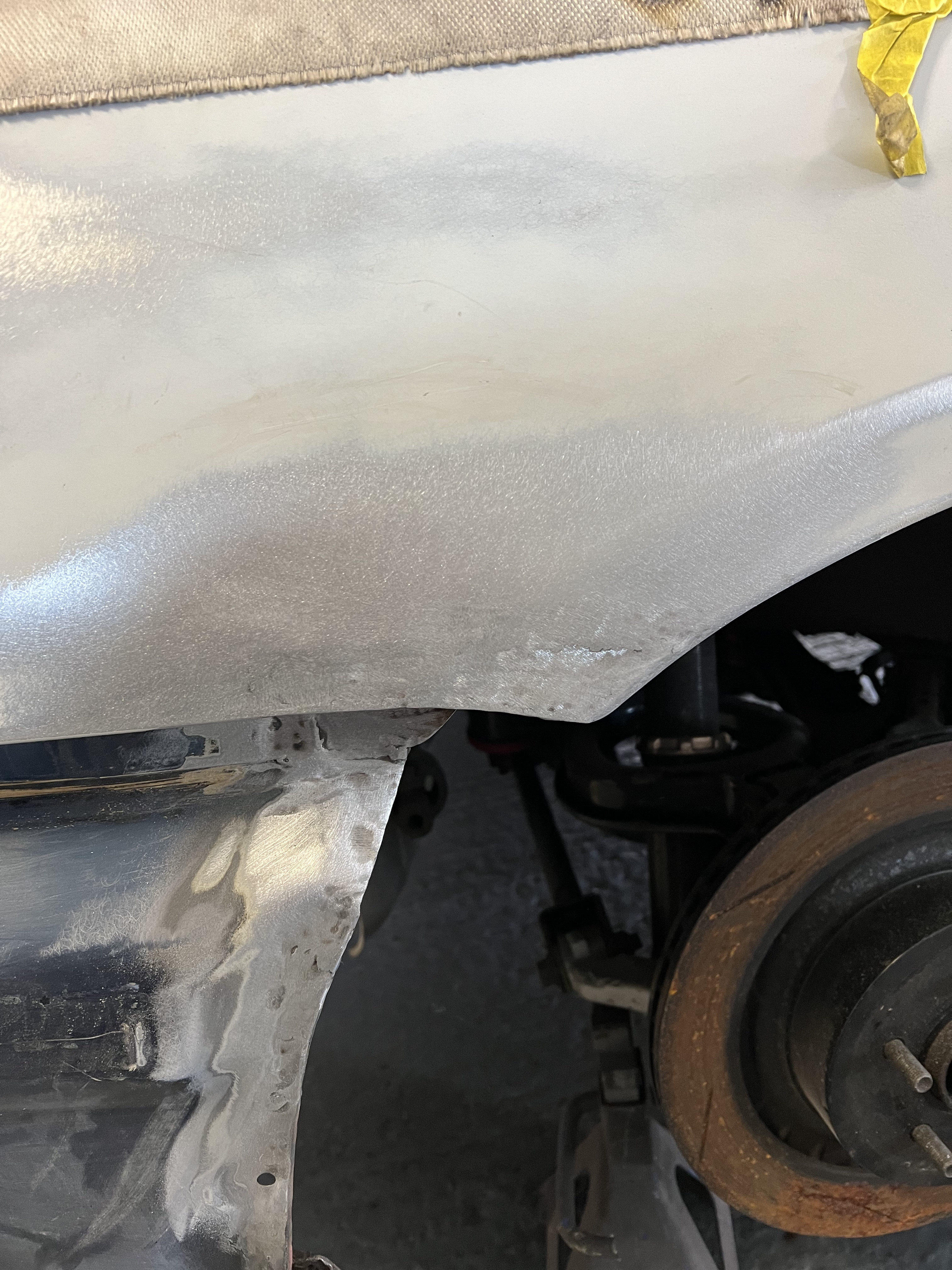

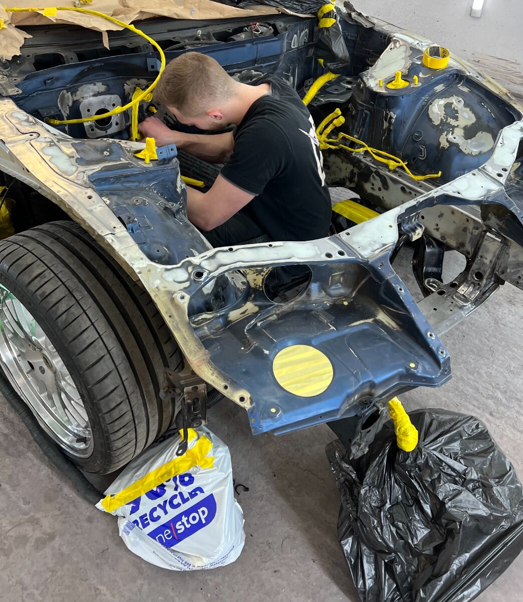

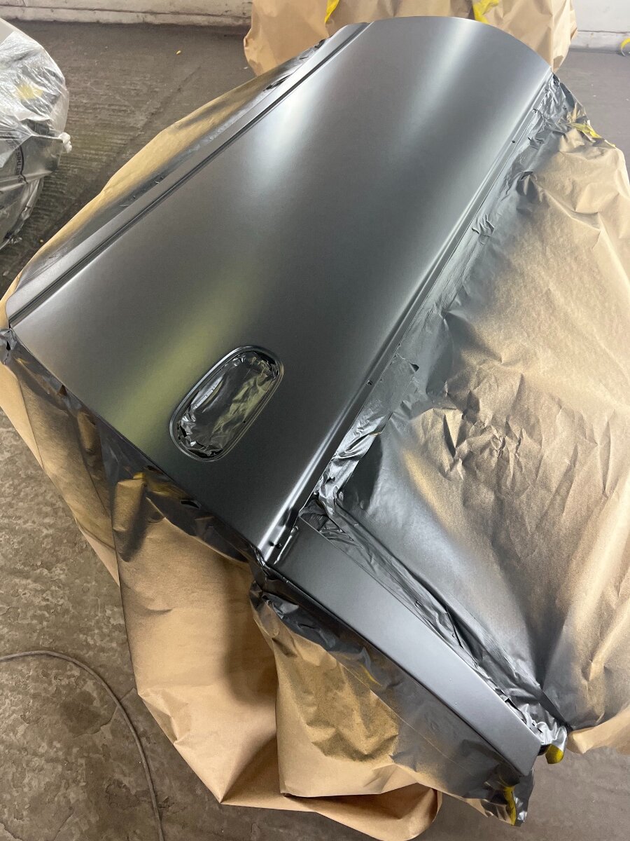

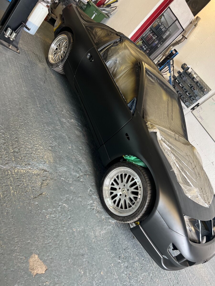

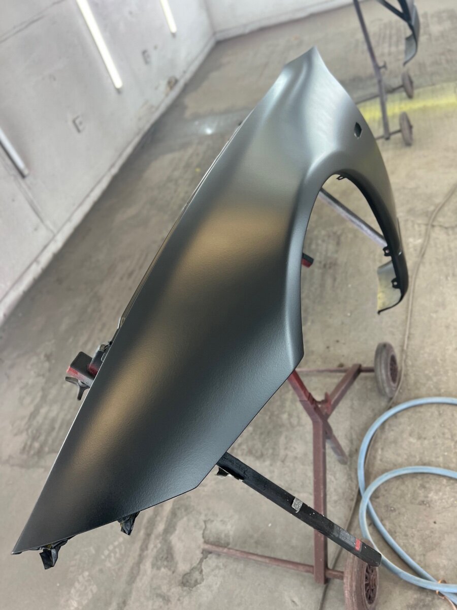

She is now in primer! Quite a thorough process they take, just to get to primer stage.
1. Bare metal
2. Epoxy prime
3. Pin pull dents
4. Any welding and repairs
5. Blocking off the entire body to make straight
6. High build primer x3 heavy coats followed by more blocking to get closer to perfection.
They put the panels back on for the sake of a photo!

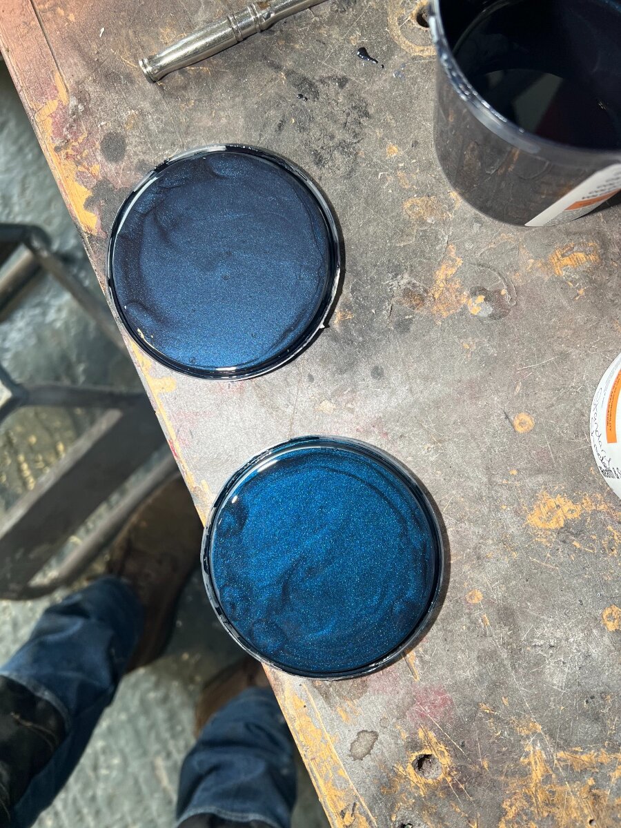

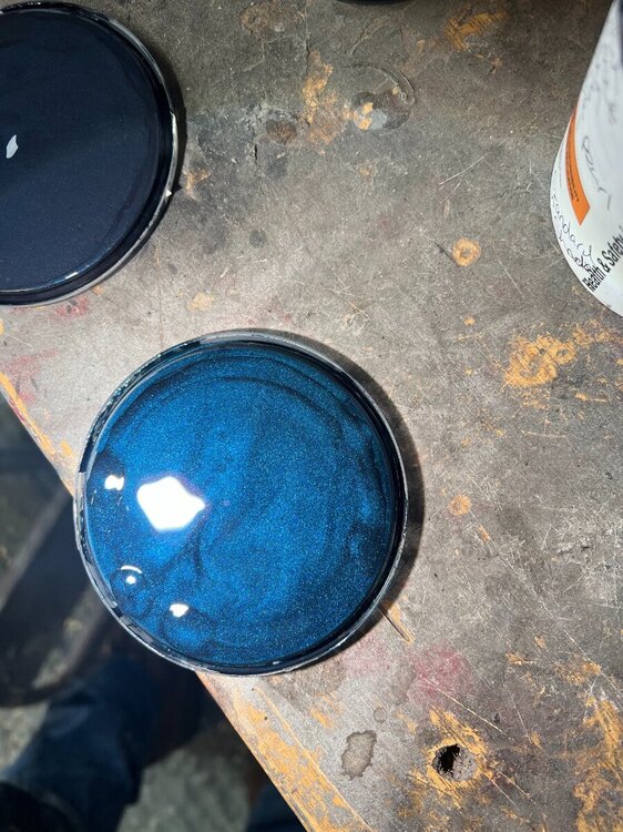

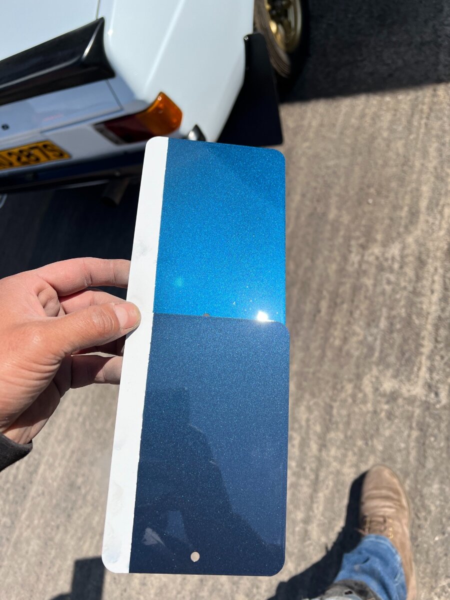

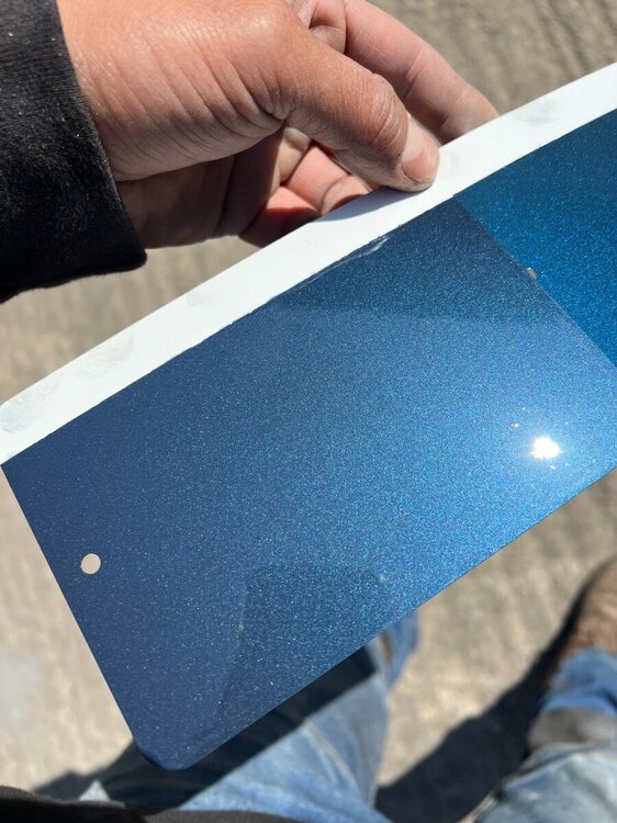

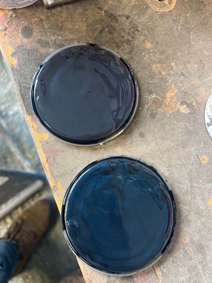

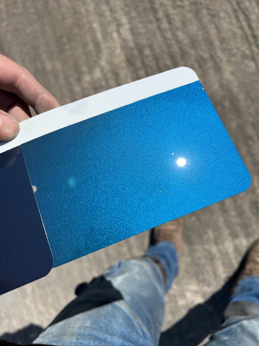

Some initial paint samples. One obviously much richer than the other! ? They'll be spraying samples tomorrow in various shades of light including daylight. They have this torch with something like 10 different output's of light level in K's e.g. 3000k or 6000k light, so you can get a pretty good idea of how the paint will look in all lights!
Will get some more pics up after I've got those samples.
Oh a random point to note is we decided to keep the stone chip! They'll be reinstating it on the side and rear bumper, which thankfully they're bloody good at doing. Initially was going to smooth the body but have been swayed the other way.
I kind of like the brighter blue, even though TK3 blue is darker on mot cars I've seen.
Stonechip is something badly missed on modern cars, so much rust and damage is caused lower down on cars due to no stone chip and no mud / splash guards, used to be common place!
Yep same here! The bodyshop also prefer the lighter blue. They showed me some more samples today and said the lighter one looks sooo much better in both sunlight and in dark areas.
I hadn't initially noticed the darker one is more true to the original TK3 until you mentioned it - having looked at it a couple more times, you're definitely right.
It was a close call between smooth or stone chip, as cars like AndrewG's swayed me to go smooth originally. I like the beefiness/character it adds to the body TBH and also the obvious protection to the body - both these points as well as the bodyshops persuasion is what swayed me back!
Sounds like I'll be in the minority but I actually prefer the look of the darker shade when in the sun.
Both are very nice though and as always you should go for what you love.
