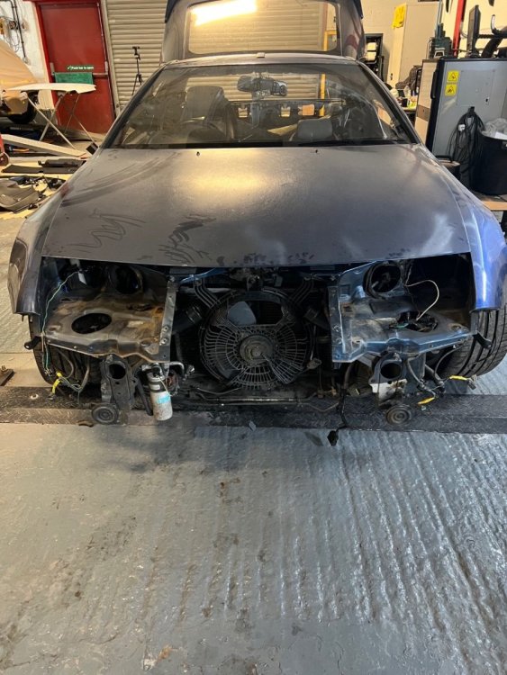

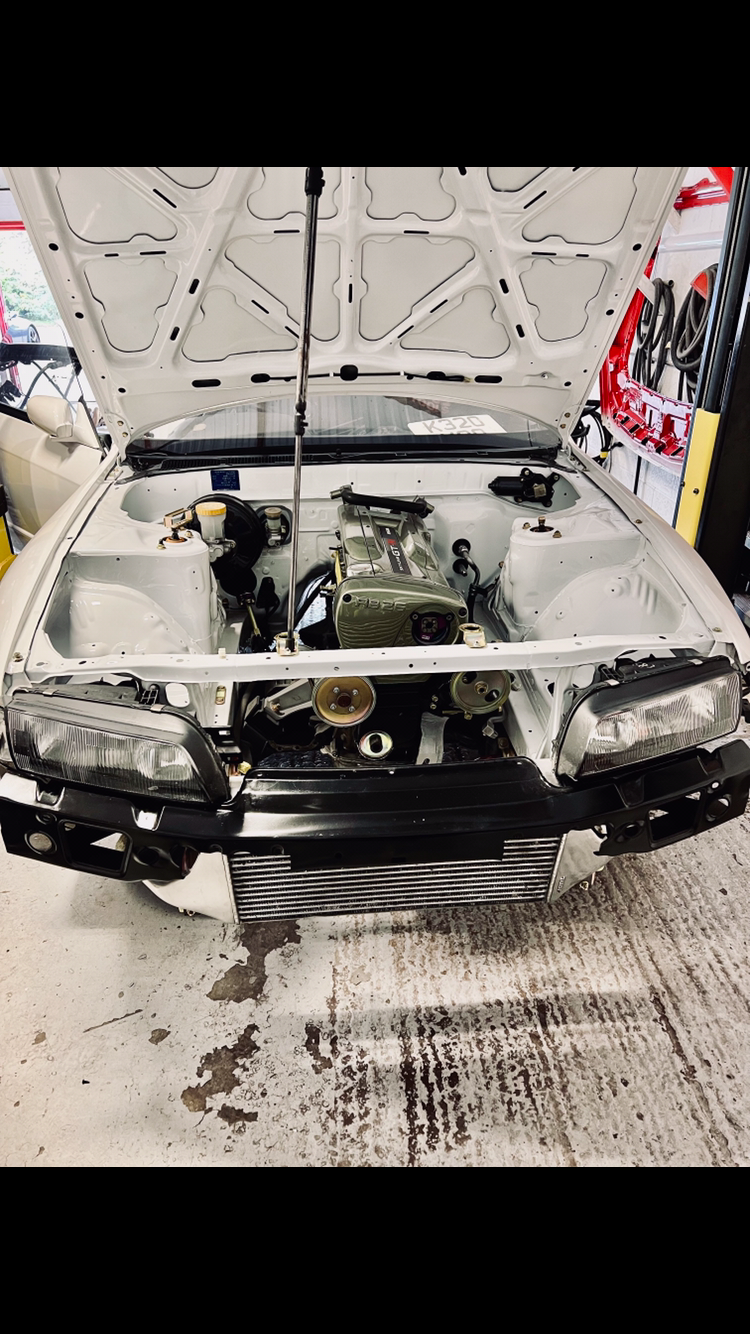

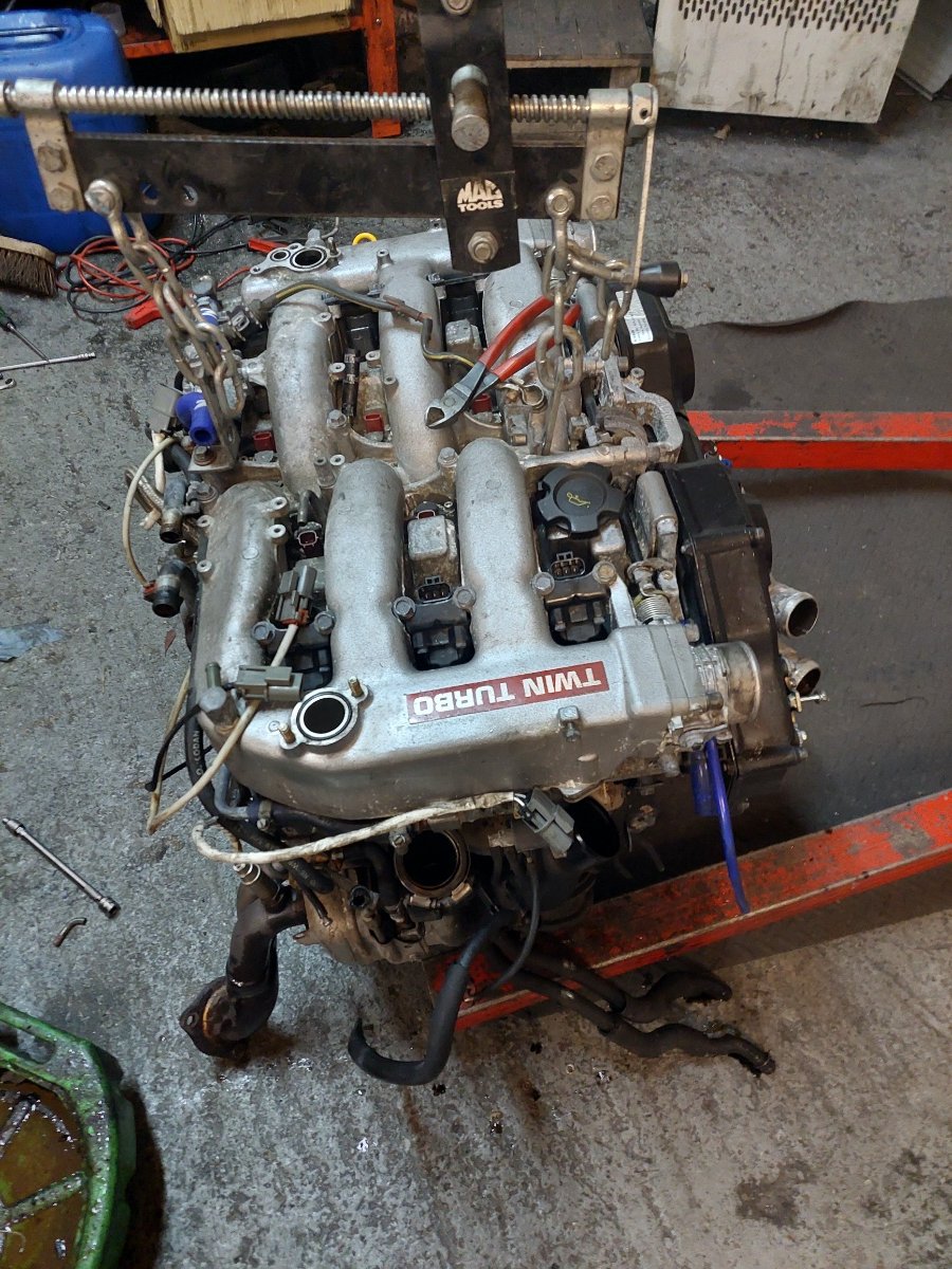

The heart has been ripped out!
Parts are arriving and we're moving forward. Hopefully Anil at the bodyshop can collect her in the next week or two.
Updates to follow, as we crack on  ?.

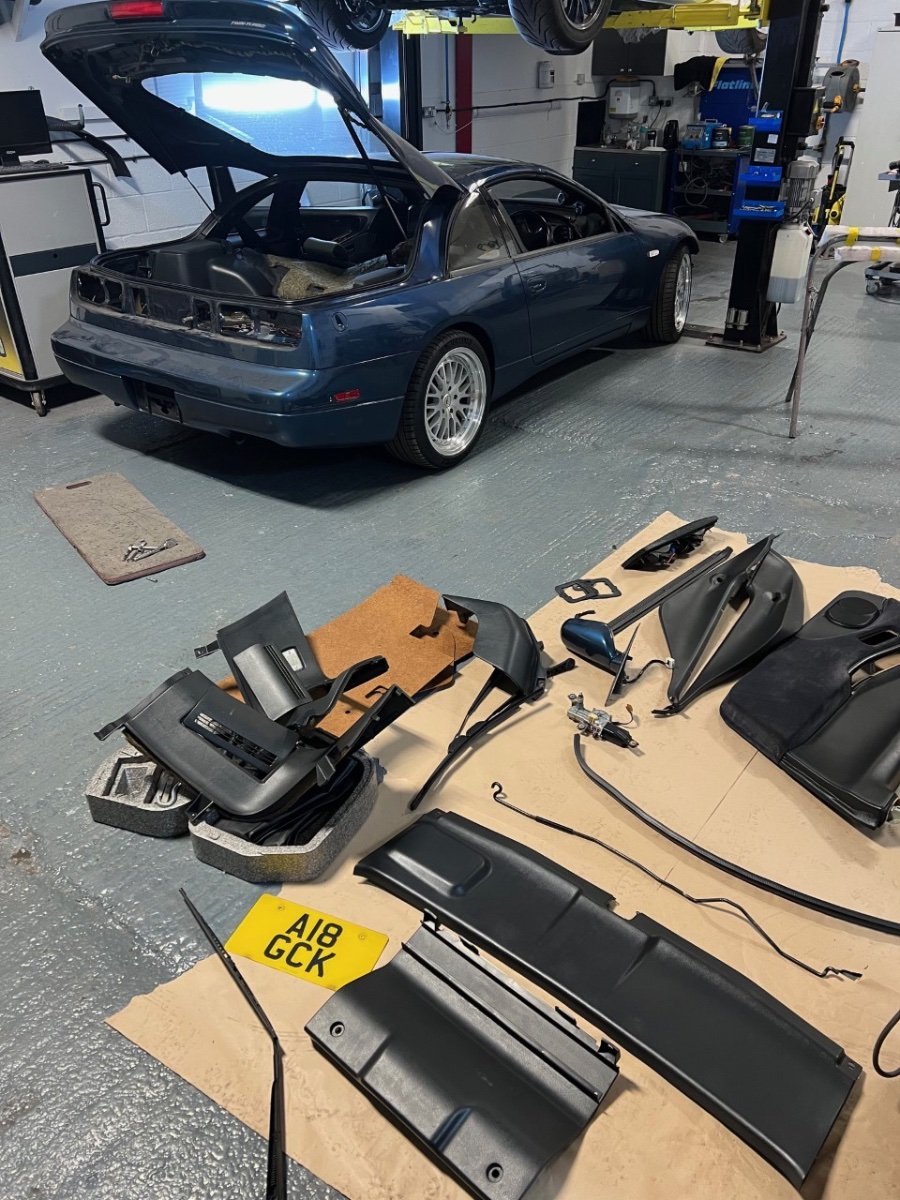

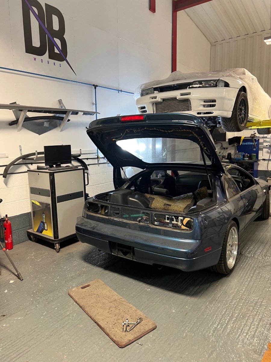

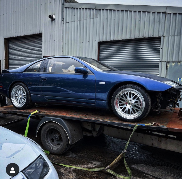

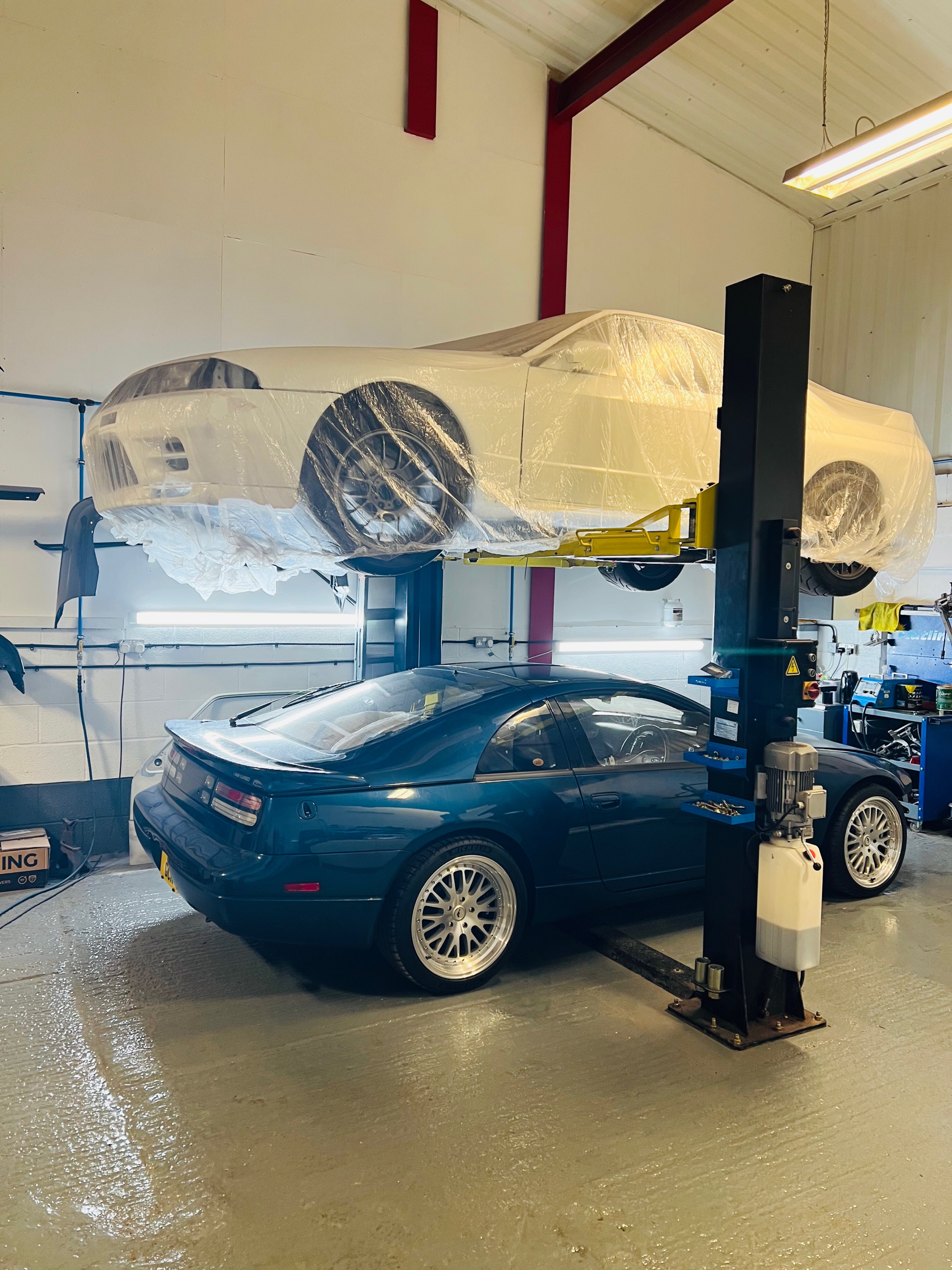

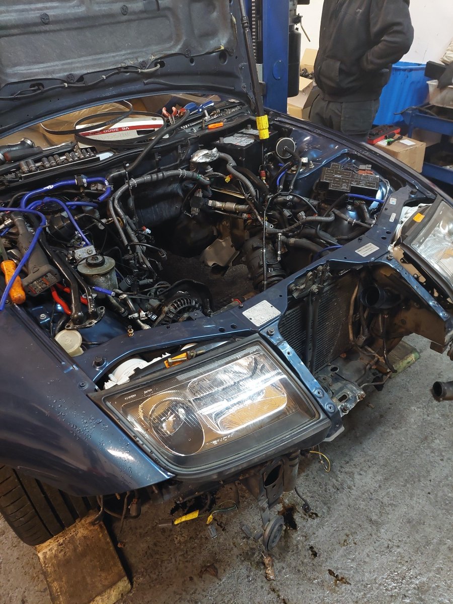

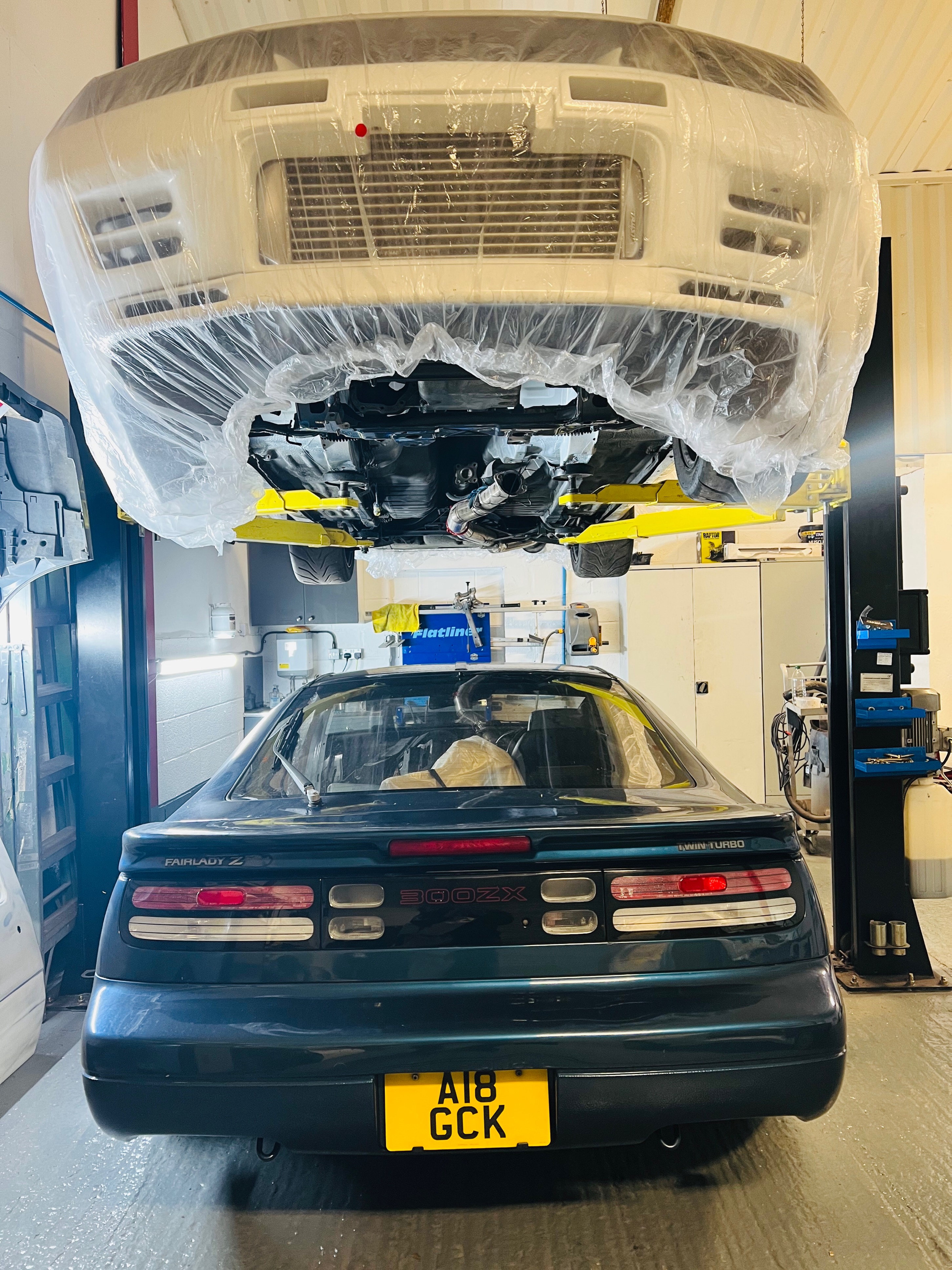

She has arrived at the bodyshop a few days ago. Ignore the Instagram filter of the zed on the trailer - definitely doesn’t look that good! Take a look at the owners R32 GTR, which is one of his many brilliant cars. Then there’s the engine bay... That engine bay itself tells you that you’ve come to the right place [emoji7].

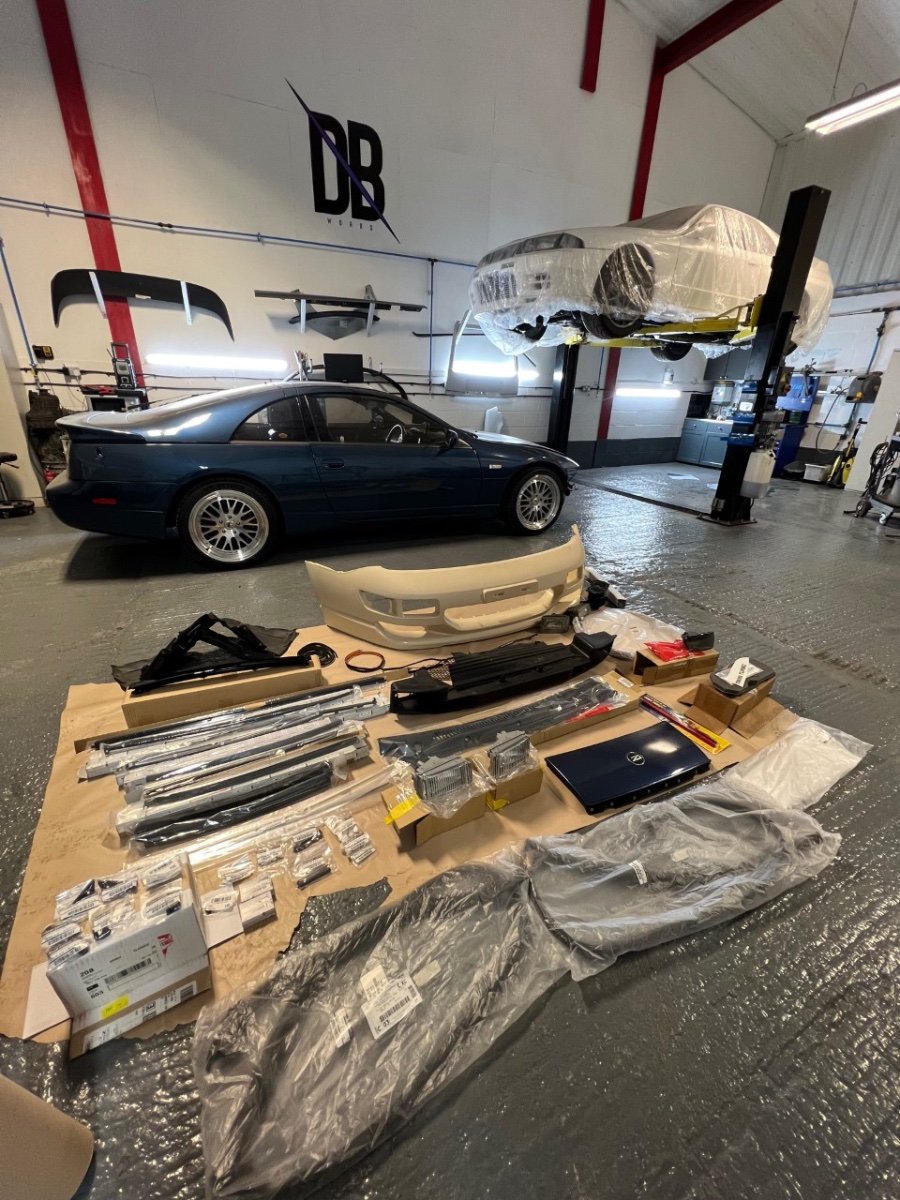

You never realise just how many parts you have until they're all laid out. Rear spoiler not in the pic and some old parts like the nose panel is in there. I have an excel document with a breakdown of all the parts and different part numbers, just to keep a track of it all, which I gave to the bodyshop. Took a fair amount of research to compile all that info and find the best prices etc.

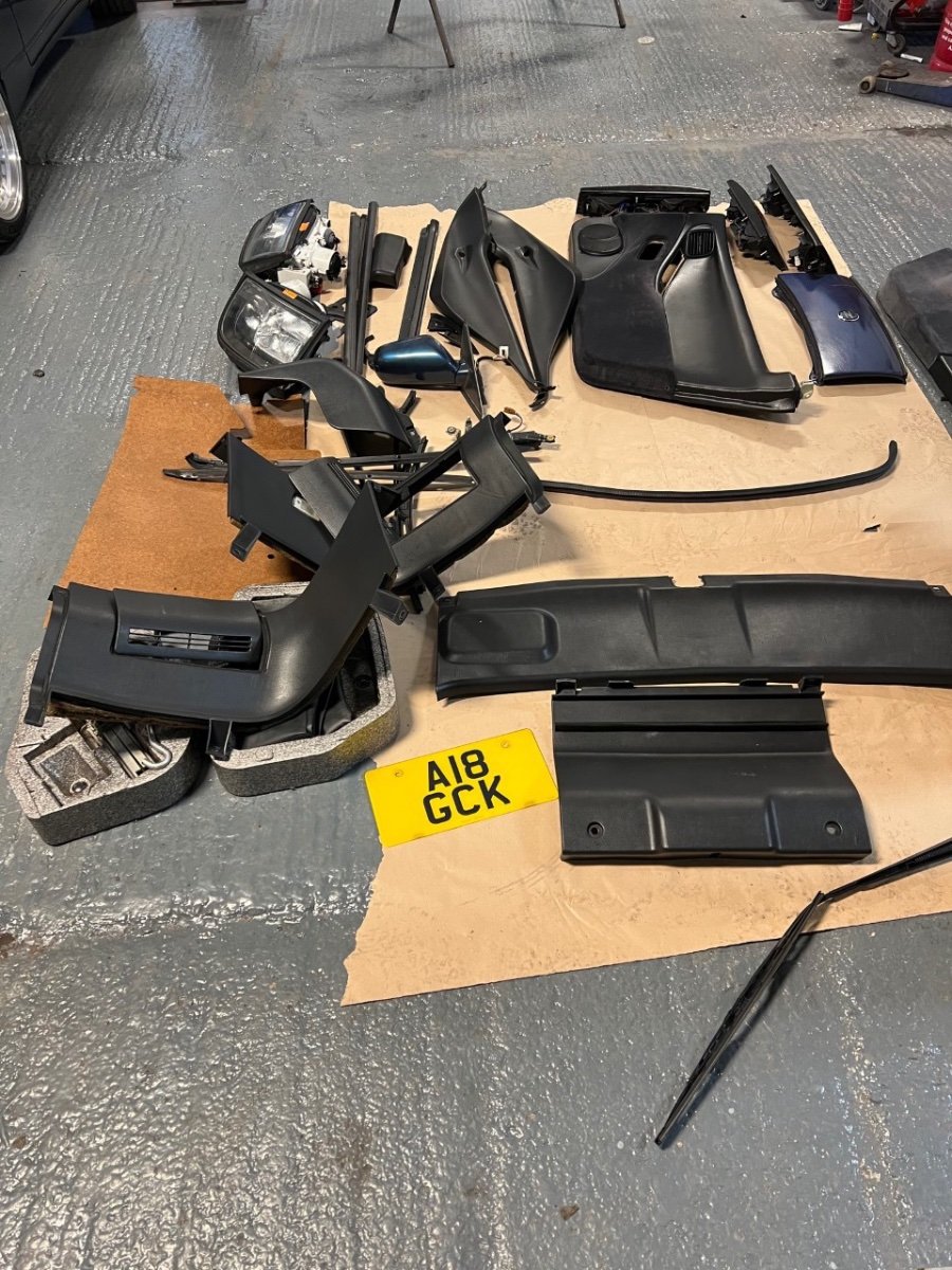

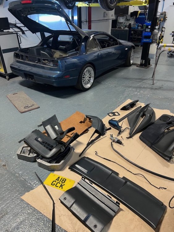

Strip down has commenced - hurrah. Funny as I was typing this update saying strip down is due to commence now, and the bodyshop sent through the below pictures! Excellent timing ?. All getting very real now...

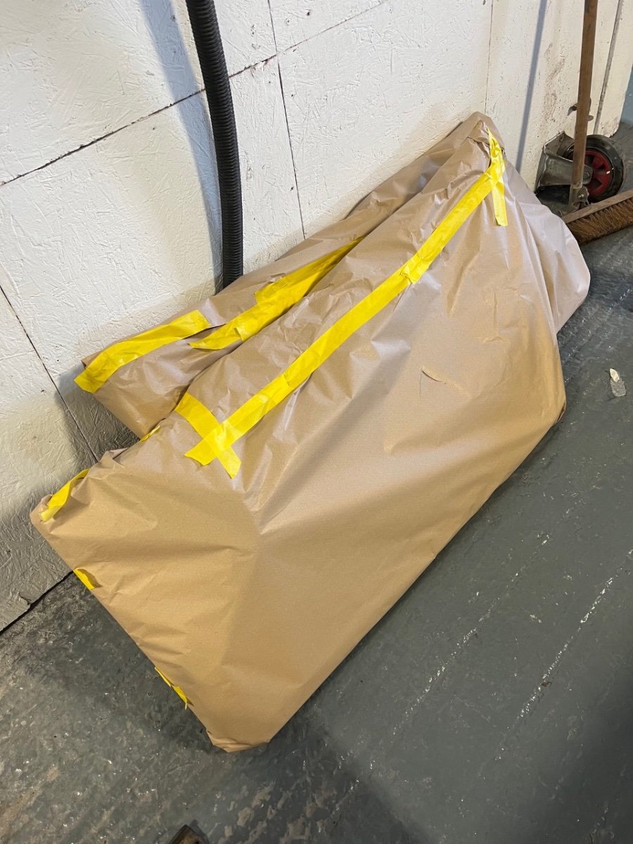

They care for their customers cars like their own. Interior panels all being packaged up to protect them during the works, which I very much appreciate since my interior is in great condition. Upon completion, they'll fully clean the interior and engine bay to leave spotless, as I left her before the works started.
Edited by Raja93

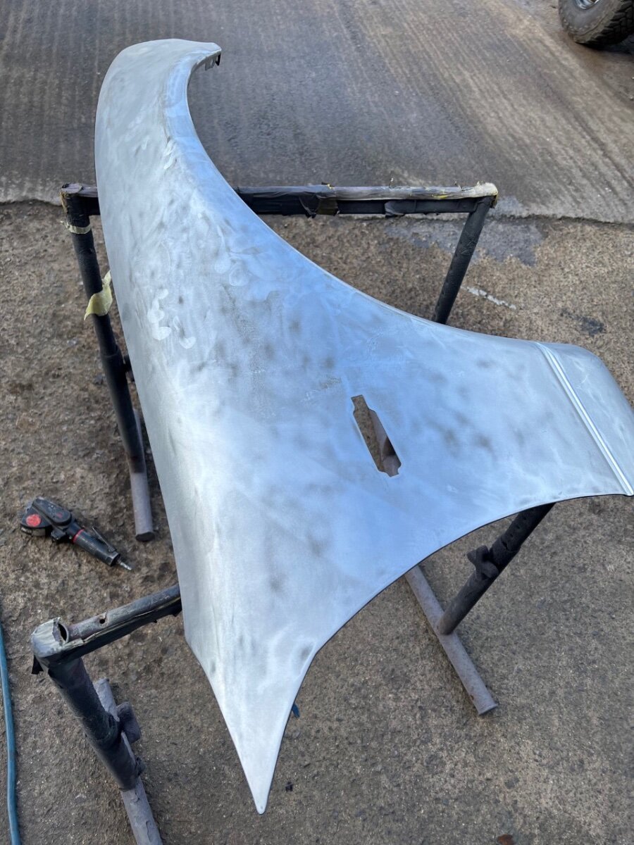

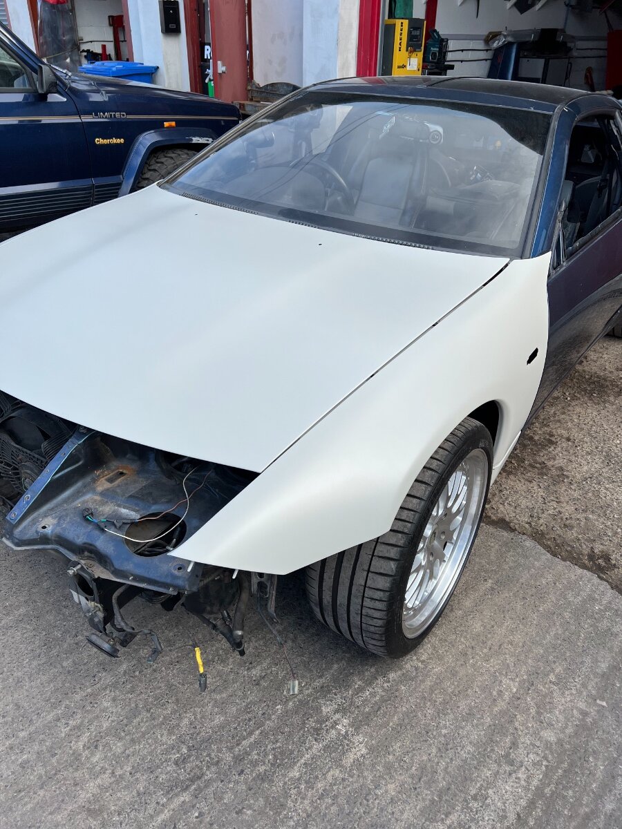

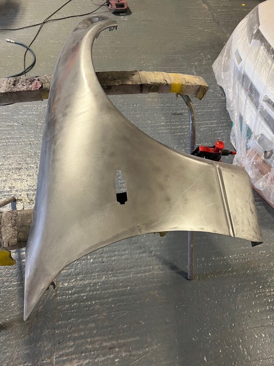

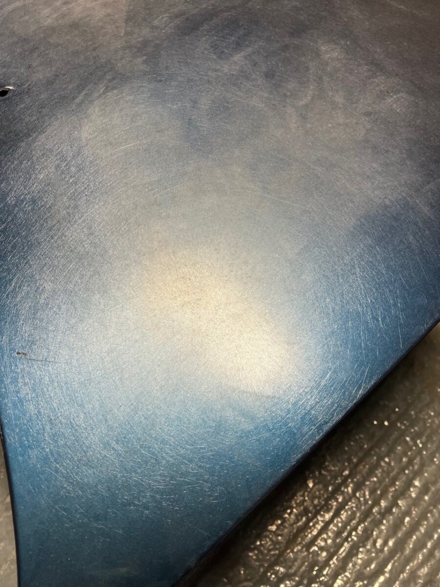

Progress has really started now, super exciting times woohoo ? Front end is being stripped and bare metalled, then covered in an epoxy primer immediately before corrosion starts.
I can't help thinking it looks like a DeLorean now!!

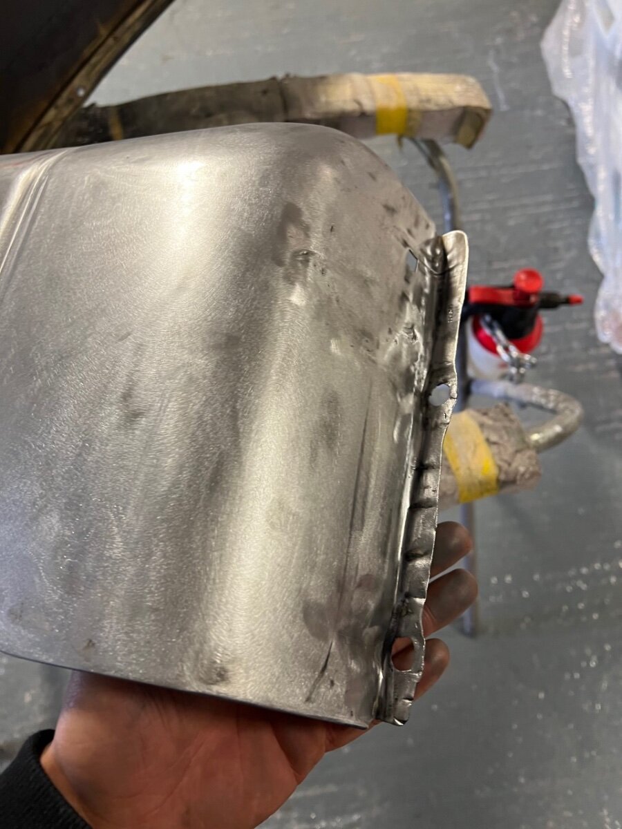

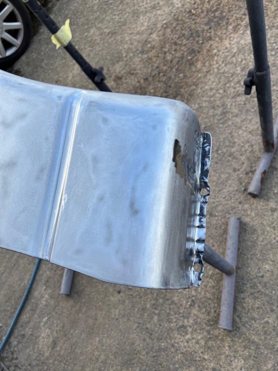

A bit of rust was found under the stone chip on one arch but was repaired and cleaned up.

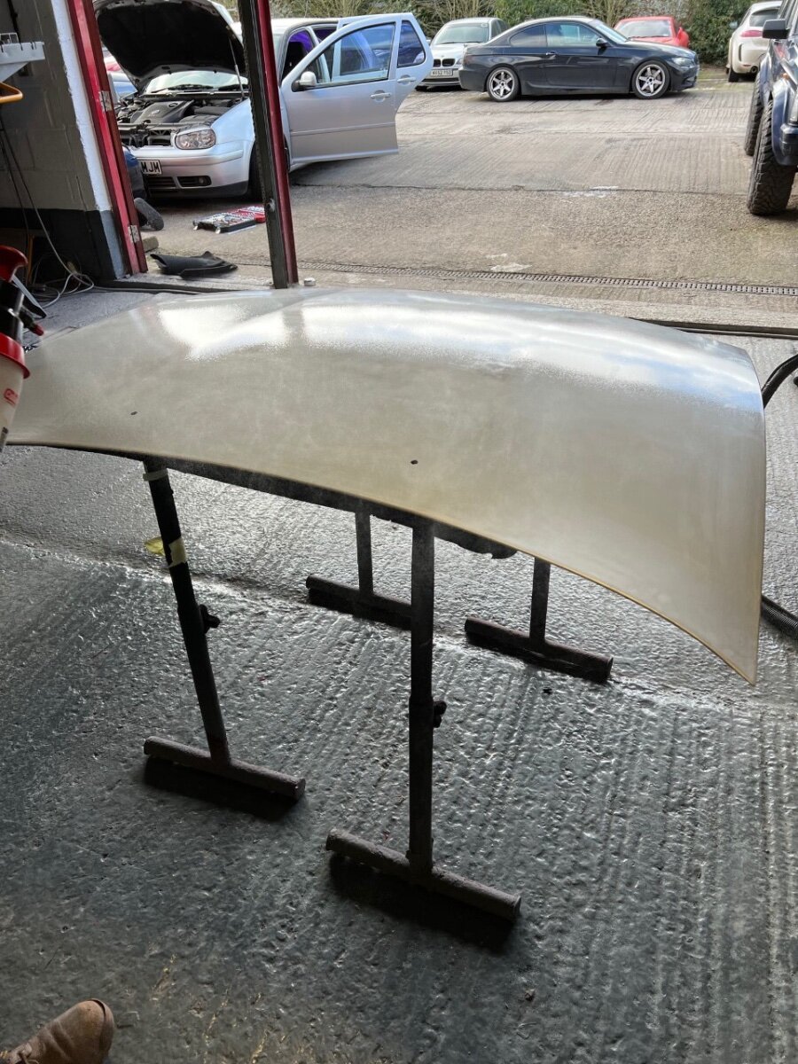

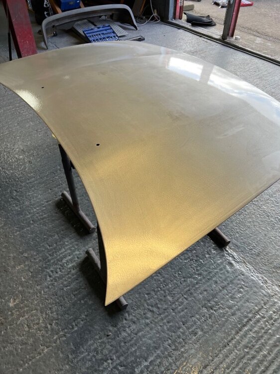

Look at the state of my bonnet - that's how it's been since last summer. He said when the lacquer has completely gone, it looks exactly like that. I've been covering it in layers and layers of wax to keep it just about presentable.
Epoxy applied to the front end panels ready for repairs I.e ensuring everything is perfectly straight and any pin dents etc pulled. They also block and rework the metal in the doors (and generally the whole body), which if you look at an angle, you can see all the ripples in the door metal on most Zeds.
This is to be followed by another primer named Sikkens colour build. Sikkens is the brand of primer/build up and lacquer that Anil (the owner) raves about, and is part of his magical recipe for perfection.

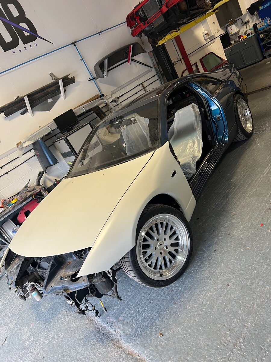

Panels have just been placed in their positions to keep them safe. Next doors are on the hit list and windows out.

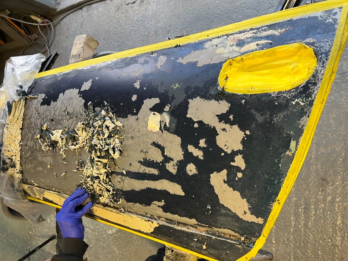

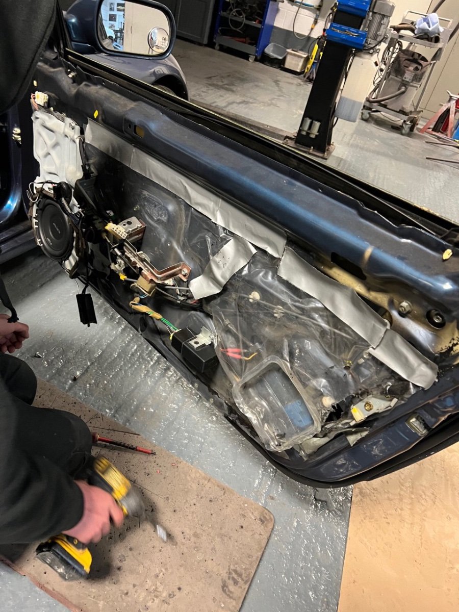

They started on the doors and found some rust under where the pin strip usually goes. It’s all salvageable though - phew! They’ve sent me various videos showing how quick the lacquer is stripping off, which indicates the cheap respray job it had before - had a £1500 full respray in 2007/08. If I had painted over this paint, it would have looked terrible in sunlight etc. I had a feeling that painting over this naff paint job would never produce a high quality finish, so I’m glad I stuck to my gut feel.

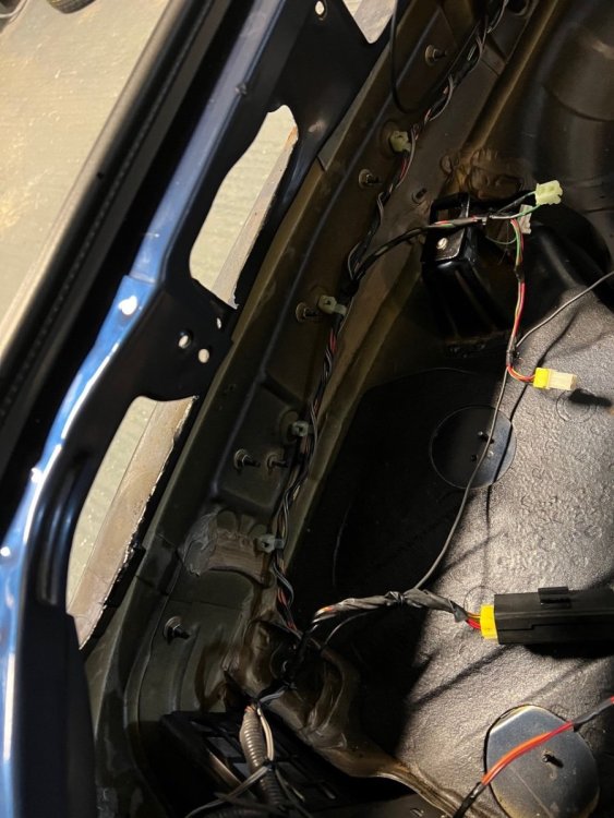

Rear quarter windows have been removed. Front and rear windscreens being removed this weekend - was due to be completed last weekend but the glass remover ran out of time! As you can see, rear quarter panels now stripped right down.
Small bit of surface rust on the sills, the drivers side rear bumper support panel and two small sections in the engine bay which will all be sorted. All areas that I was aware of rust presence, so no surprises thankfully. Overall they said the shell is very clean, which I expected to be honest, due to the previous owners.
