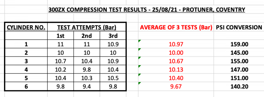

I took her upto Protuner in Coventry on Friday 20th August to fit the Link G4X ECU, partly to solve the minor running issues the car has and also as preparation for the forged engine rebuild and big power, which I had planned for the next 2-3 years. The running issues were minor and very random/infrequent, of which I ruled as being caused by a dodgy Nistune chip or the butchering of the chip by Turbonoz - forum posts the previous owner (Ollie) made, findings with Protuner when Ollie had the 740cc's fitted/mapped and general research brought me to this conclusion. I set off early at 5:30am with a stop off to fill up with Shell's finest V-Power. Unlike @TheRealNips's beauty that manages over 300 miles (jealous!!), mine only manages 220-230 miles on a run, driving at or around the speed limit. Second photo is just after I arrived at Protuner, with an array of 90's Jap cars.
The following week, Greg and the guys carried out their thorough pre-dyno checks including boost leak tests, compression tests etc. They found the turbo actuator pipework was loose and hanging off one bank, of which was the reason to the occasional over boosting (hitting a wall feeling around 4-5k revs). This has been happening for the last half a year really randomly, and on some journeys not happening at all. I haven’t been driving the car in any anger due to other issues/worn clutch and flywheel and new clutch being bedded in etc. We had thought this was due to the ecu/nistune issues. Unfortunately, this has led to the opposite bank turbo being overworked, and as a result is now leaking some oil.
They carried out the compression tests and found more bad news – 3 tests were completed and are summarised in the below photo. None of the cylinders are optimal so say the least (circa 175psi ideal??), but cylinder 2 and 6 are in technical terms, fu**ed!
When the engine is cold, Greg found the hydraulic lifter is collapsed and when the engine warms up after a few minutes and the oil begins flowing well to the head, they release. This explains the cold start idling issues that I’ve always had in the year and 6 months I’ve had her.
Edited by naz27
I asked Greg to forward the above findings to Jim @ PowerZed, as I knew with the mountain of bad news, I’d probably forget some of the bits he told me! I can drive it around for the last of the summer he advised, which is the saving grace, otherwise I’d be seriously peed off if she was sat on the driveway for the last of the half decent weather.
I’ve asked Jim for a quote for a full rebuild and a target of 600bhp, with reliability and response a key, so I’m flexible on power targets for the sake of those two objectives. I’m hoping to get the rebuild done at the same time as the full respray in January, as the bodyshop is Jim’s recommended one in the Bristol area. This will make things much easier logistically and be two birds with one stone timings wise (respray is circa 3 months).
On the plus side, the Link G4 has seriously improved the driveability of the Zed, with simple things like revs after gear changes being so, so much smoother and just the overall behaviour of the car being much better, despite the terminal problems!! She no longer runs super rich on start up which is good. Strangely, since mid-last year, I’ve gone through a year old refurbished starter motor and onto another. Earlier this year, the starter motor I fitted, began requiring two attempts to start her. Now she starts on one turn.
Another plus is she is now running on a MAP sensor, so the dual MAF’s and the Selin Translator are redundant – they’ll be put onto ebay soonish when I get around to it.
It's not the end of the world, as I had planned to do the rebuild in the next few years as mentioned above, but it definitely wasn't expected to be needed right now. The next step is to plan the rebuild with Jim depending on his diary, sell some organs to free up some funds and set up a Gofundme page!
Edited by naz27
Sorry to hear the slightly bad news, hopefully the engine holds up while you plan the big build as you have certainly put a tremendous effort into yo getting your Zed to this stage!
It goes without saying but the more your tune the Zed then compression issues will show up, the results do point towards worn piston rings and as Greg mentioned you should be able to use it for the last of the summer.
Hope to join you in the 600bhp club!!

I can still mind the figures when I had it compression tested in 2013, lowest was 162 and highest 166, pretty solid at the time.
Jimmer will have it all sorted out for you, his rep is superb as you will know, and low comp can be caused by various things, so not always that bad....but if you want big power, would need to rebuild in any case.
