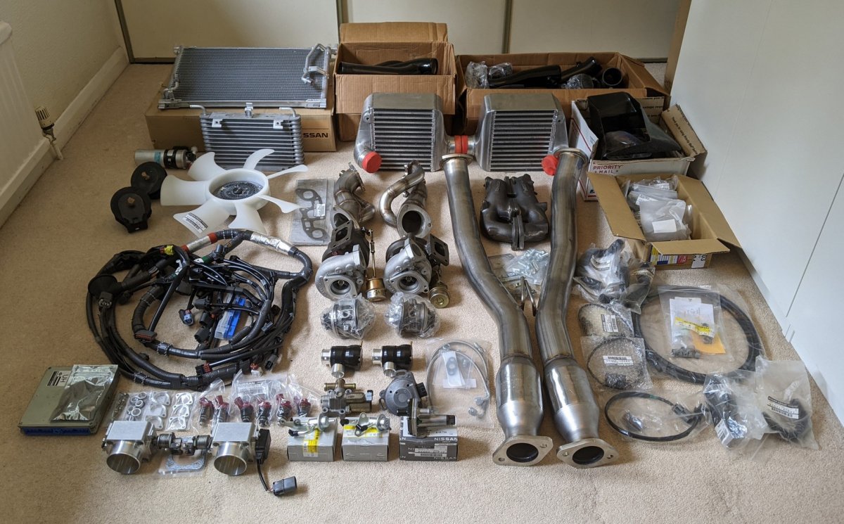

5 minutes ago, Peage said:
What a collection! What turbos are those?
They are JWT 530BB's. They will be fitted with new CHRA's from Turbos Direct. Basically this kit:
https://conceptzperformance.com/czp-zero-g5-garrett-billet-ball-bearing-twin-turbo-kit-550hp-nissan-300zx-z32-00-14411-g5-kt_p_37568.php
Nice! I have the Z1 535 kit, so same turbo but no fancy billet wheel. Interested to see what yours makes (if you dyno run it once complete) and how it spools! Your mods are very similar to mine and I am also on an SZ chip... I think the only differences are I don't have a Selin or the throttle bodies.
Do you happen to have a link to the CHRAs you ordered?
Sure:
https://conceptzperformance.com/garrett-chra-center-housing-rotating-assembly-gt2554r-replacement-for-jwt-530bb-czp-vanilla-zero-g5-835995-5001s_p_10912.php
The machined billet compressors really are a work of art.

Collected the car from PowerZed yesterday. Jim has spent many hours putting all the parts in the first two photos below onto the car and removing as much of the superfluous guff as possible. The car passed its MOT with flying colours and with the emissions well with limits. Jim emailed me after he took her for the MOT and to quote him "it behaved very well during the journey. It is very quick on boost even at wastegate pressure. You will be impressed I am sure" I'm a very happy bunny!

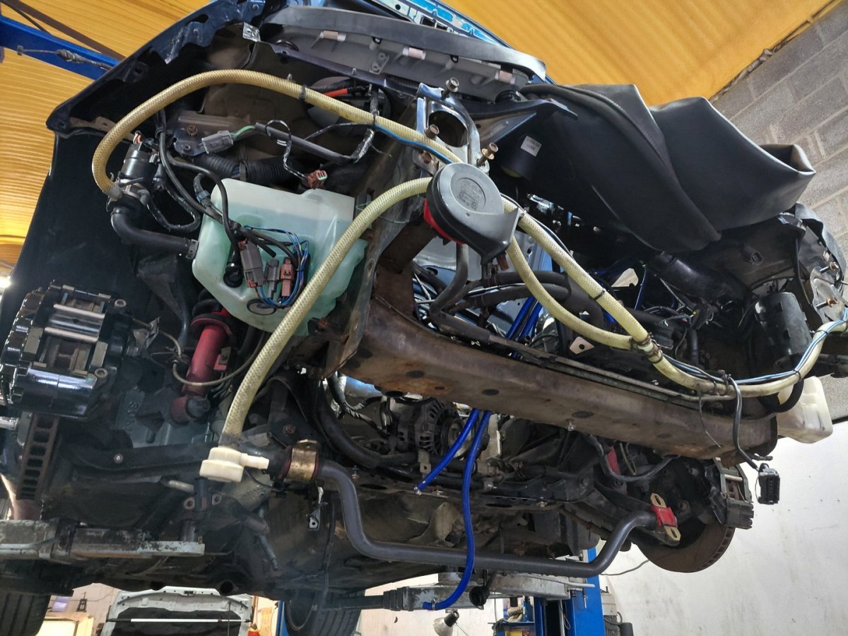

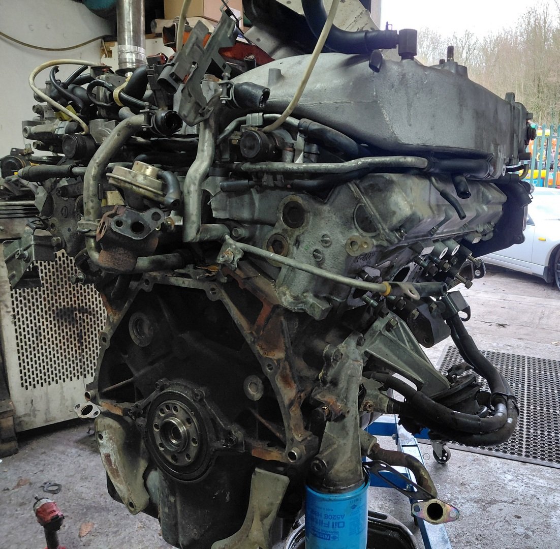

Engine out and all the emissions guff, manifolds and old turbos coming off. Compression tests well within specs for a 90K miles engine.
Front of the car stripped down, old HKS SMICs, Recircs and pipe work removed.

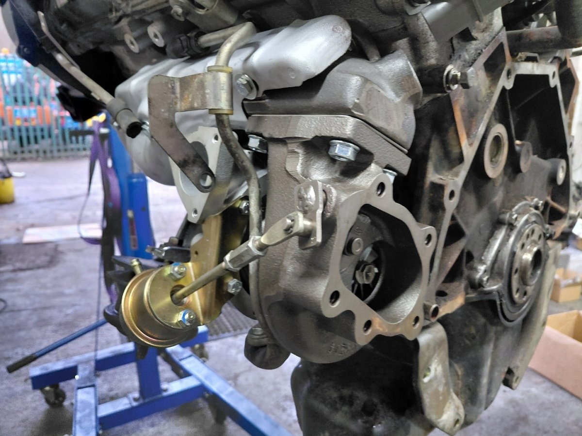

New CHRA's with billet compressors installed into JWT 530BB turbos.

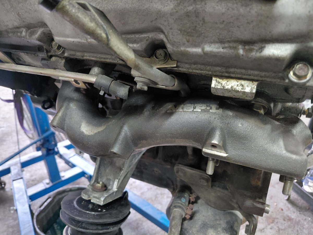

MSP exhaust manifolds installed with new engine mounts and modified brackets to clear AshSpec pipework.
JWT 530BB turbos mounted.
