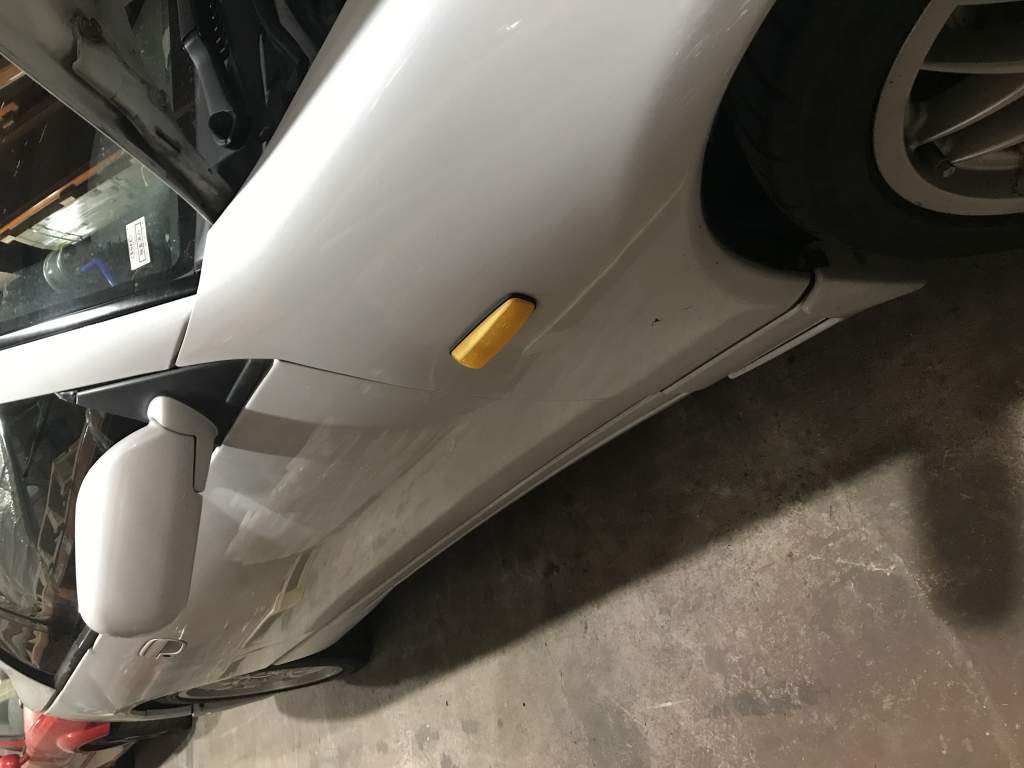

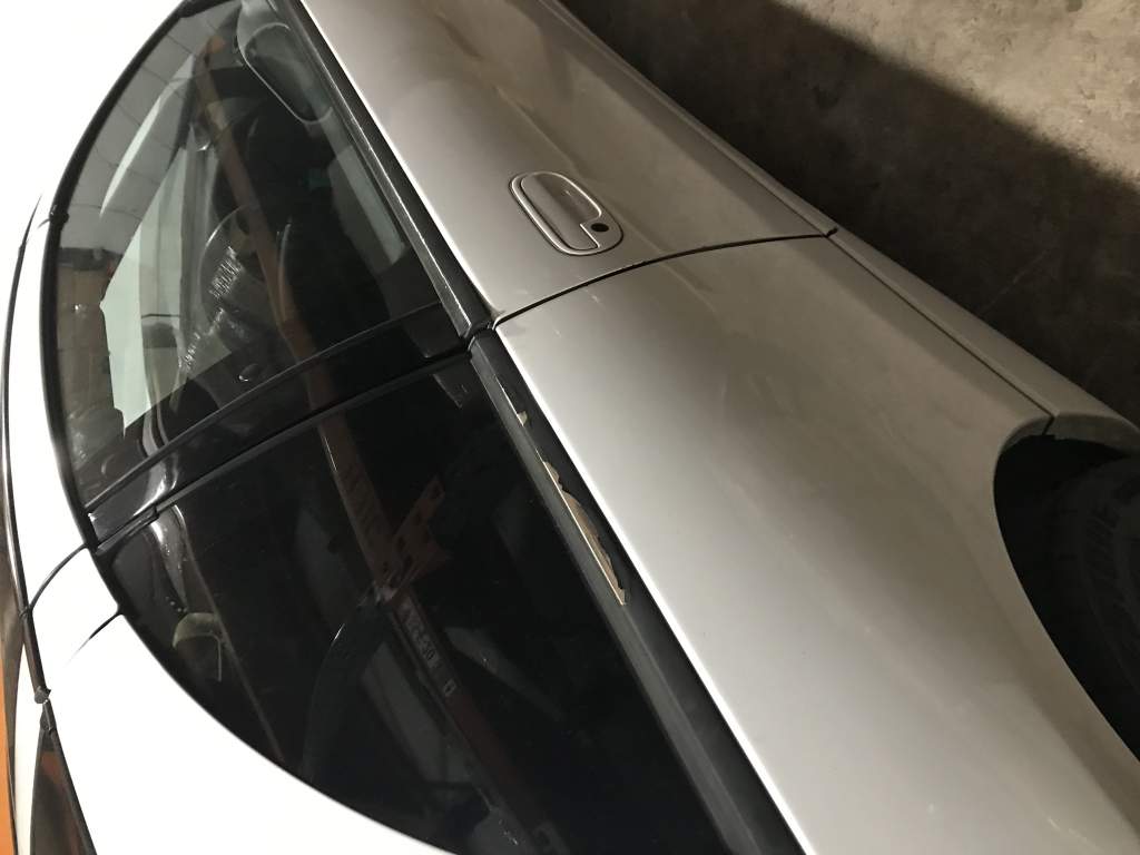

I’ve already ordered new side window trim from the USA.
Does anyone know if you can order new clear indicators from Nissan?
Also the car occasionally idles at 2k. No doubt it been asked many times but where’s best to start looking?
The clear indicators were never sold by Nissan, there are some “Nismo” branded ones around but they’re generally the same product as the eBay jobbies.
