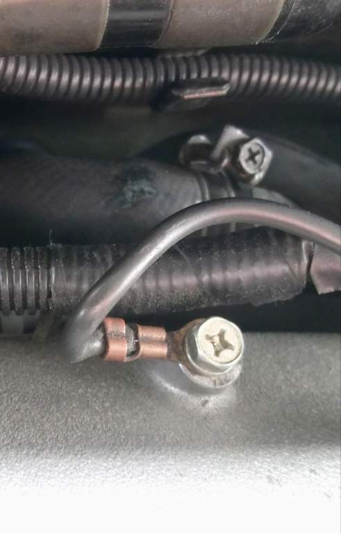

Looks like one of my heater matrix hoses has started to let go.

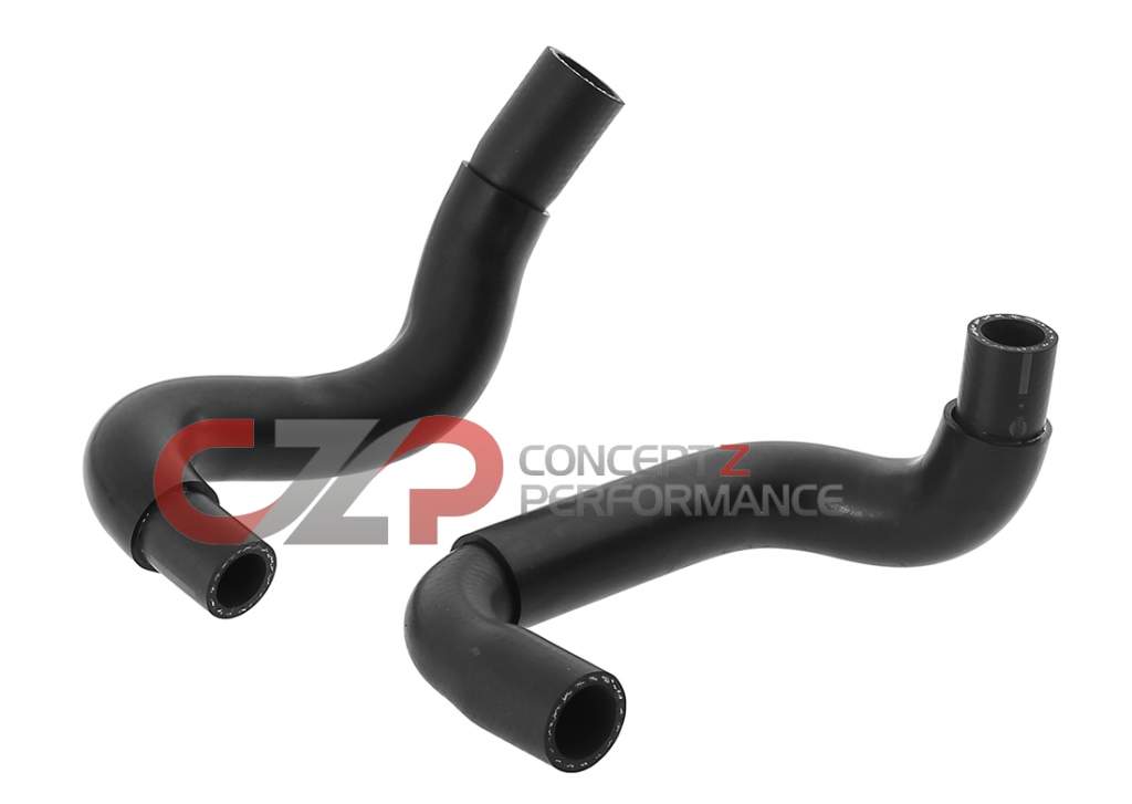

I can't seem to locate the part number on nissan4u and the part code on CZP is for a twin pack (both hoses included) which doesn't appear on allcarpartsfast. They look almost the same from images I've seen, but sometimes that can be deceiving, so just want to double check before I press the button.
https://conceptzperformance.com/nissan-infiniti-nissan-oem-heater-core-coolant-hose-set-nissan-300zx-z32-92400-30pkt_p_959.php
i think they are too, it's only the pipework on the actual matrix which is different.
Think I'll order them. :)

Outlet - 9241030P00 - https://www.allcarpartsfast.co.uk/nissan/nissan-9240030p00-hose-water/
Inlet - 9240030P00 - https://www.allcarpartsfast.co.uk/nissan/nissan-9241030p00-hose-water/
