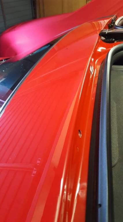

  • Off  work for two weeks with this new lock down so I got myself a DA polisher and very pleased with the results.
  • Used Meguiar's ultimate polish with the DA Andrew.  I watched some utube videos on how to use a da polisher and it was so quick and easy to do. I find doing it by hand at my age with arthritis is gett

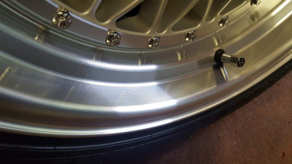

I bought some new car polish and wheel polish from a trade stand at the car show I was at. The car polish Soft 99 went on very easy and came of easy also with no white scum so very pleased with it as it was only around £20. The wheel polish I was very pleased with Max Guard from Chemical Guys give an Awsome shine. It was like a green past that you put on and left for 15 min. Then wipe of. The car polish was on my son's silver Seat Ibiza. The wheel polish was also put on my 6 year old alloys.20180723_184743.jpg
I bought some new car polish and wheel polish from a trade stand at the car show I was at. The car polish Soft 99 went on very easy and came of easy also with no white scum so very pleased with it as it was only around £20. The wheel polish I was very pleased with Max Guard from Chemical Guys give an Awsome shine. It was like a green past that you put on and left for 15 min. Then wipe of. The car polish was on my son's silver Seat Ibiza. The wheel polish was also put on my 6 year old alloys.[ATTACH=CONFIG]113566[/ATTACH]
[ATTACH=CONFIG]113567[/ATTACH]
[ATTACH=CONFIG]113568[/ATTACH]
[ATTACH=CONFIG]113569[/ATTACH]
[ATTACH=CONFIG]113570[/ATTACH]
The wheel polish is actually wax not polish. ;)
