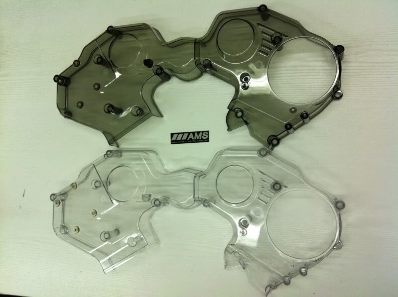

So today I purchased a set of the Smoked version of these:
Shock Horror..... AMS parts! Yes yes I know however, they are an AMS original part that they haven’t copied off another manufacturer, so there’s no guilt here.
There are 2 reasons why I have gone with these over just OE covers, one aesthetic and one mechanical
Aesthetic is that I have a bloody expensive valve train with the BDE cam pulleys and the PE Kevlar belt. Seems silly to hide that lovely engineering away
The other reason is I run the EPR manual tensioner, so makes it easy to keep an eye on both my belt tension and timing marks without having to remove the covers.
My OE fasteners are a bit of the tatty side nowadays, so I’ll see if I can purchase some through ZSpec while they have a sale on
You going to keep the AMS logos on them?
Ill have to have a look what they’re like when they turn up. I suspect that there’s not going to be enough material there for me to sand it back to remove the emblems.

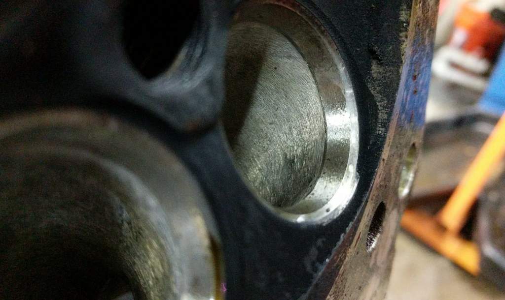

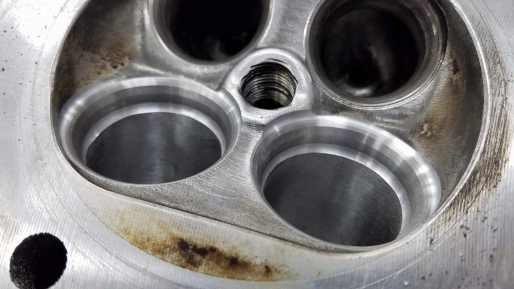

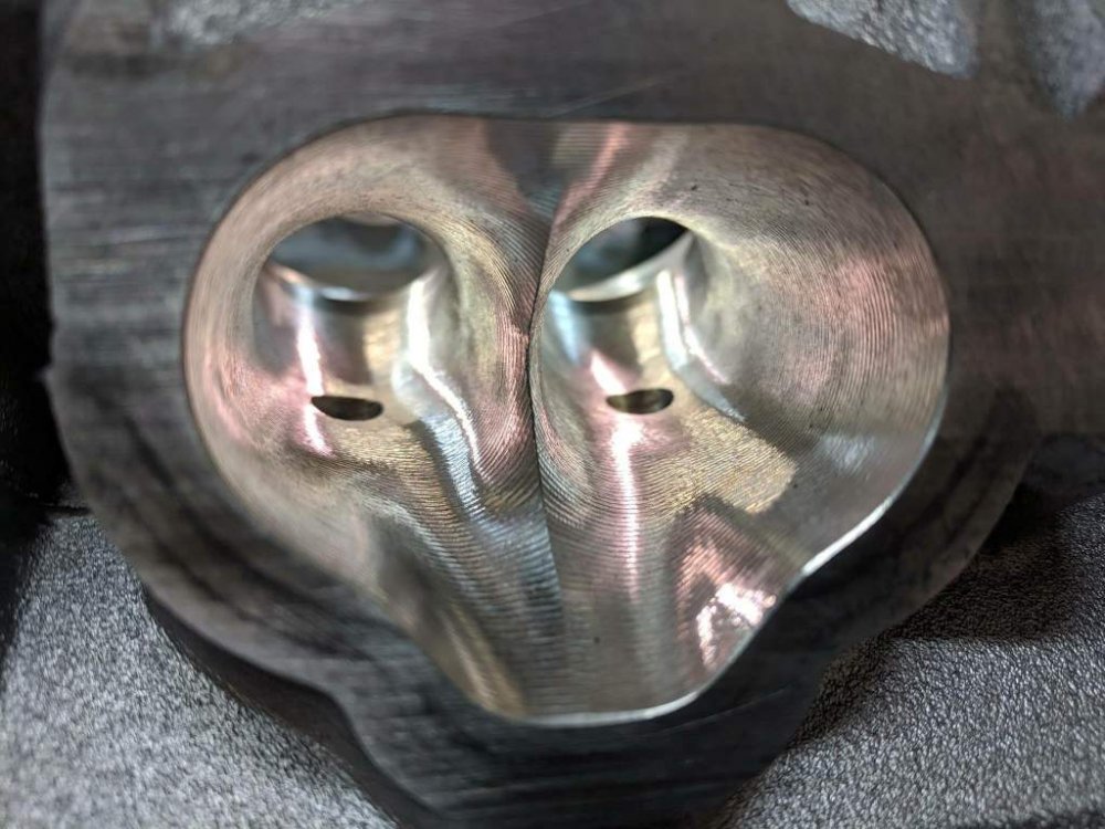

Mitch had started stripping my heads down for them to have the valve guides on the intake side changed and CNC ported. I’d told Mitch that I’d previously had a CNC multi profile valve seat and throat machined when I changed to the SuoerTech valvetrain. For those who have heard of 3 angle and 5 angle valve seats cuts, a multi profile cut is a step above a 5 angle cut.
when he removed my valves he was presented with this
That is a 2 angle valve seat that’s been stone cut.... not CNC cut. To put some more meat on the bones, an standard stone valve seat cut costs roughly £85..... i was charged for my CNC valve seats £400.

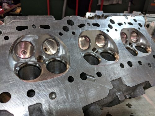

So, Mitch will be CNC cutting my valve seats when the CNC porting takes place, and should look like this
I’ll be speaking to the machine shop that carried out my head work later this week to express my displeasure!
Yes, the boss comes off when the bowls are machined

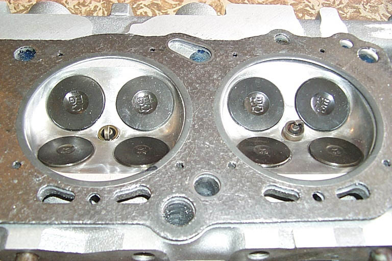

That will give you a much larger range of spark plugs to work with (NA type on left, TT on right):

Hmm. Interesting. Spark plug placement in the combustion chamber is quite a critical thing for flame fronts, so by pulling the plug further out of the combustion chamber you’re changing where the initial flame front is in the combustion process. I’m guessing there’s a reason why Nissan specified the plug protrudes that much more for the TT engine than the NA... From what I understood, you want the source of ignition to be as central in the combustion chamber as possible, so as protruding into the combustion chamber as possible without causing interference with the piston or valves

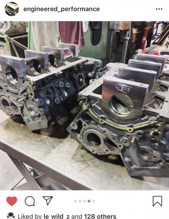

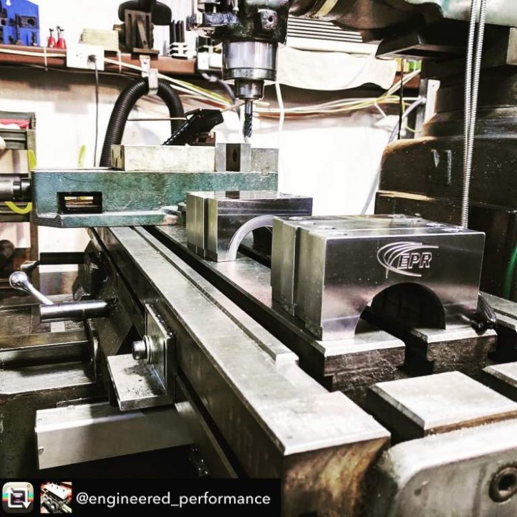

On a positive note, my Billet main caps are due to be machined today...
I saw a video of the guys machining out a set today, must be yours:thumbup1:
I think that was a block belonging to le_wild_z on Instagram... but here’s my block with his
