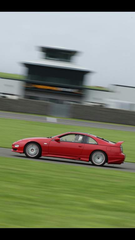

I think my meisters are at max extension and it clears all speed bumps, it looks like this...
I know it's moving, but it's accelerating in 4th or 5th there so not really under any load. In my other pics I have 100s of Kgs of tools in the boot!
[ATTACH=CONFIG]109906[/ATTACH]

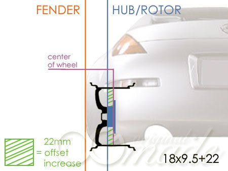

The wheel offset calculator will give you the position of the new wheel's inner and outer rims relative to the old wheel.
So in effect you can tell how the wheel will look in the wheel arch and whether it will clear suspension components.
Wheel spacers can be used to make adjustments to the total offset (and look) when the exact wheel offset required
is not available.

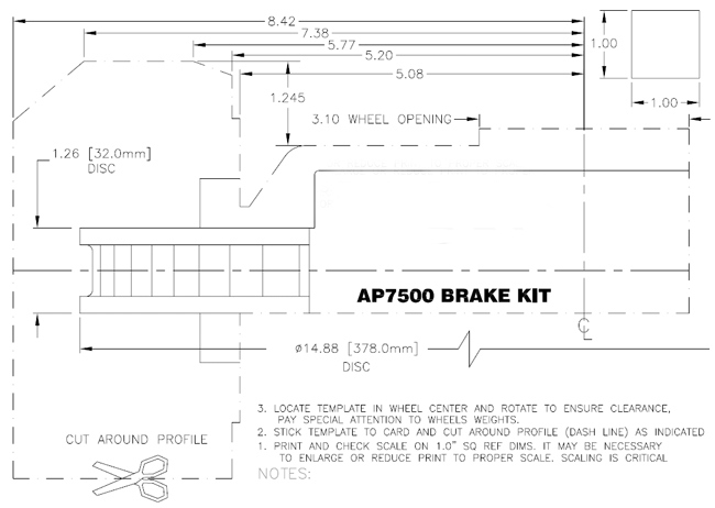

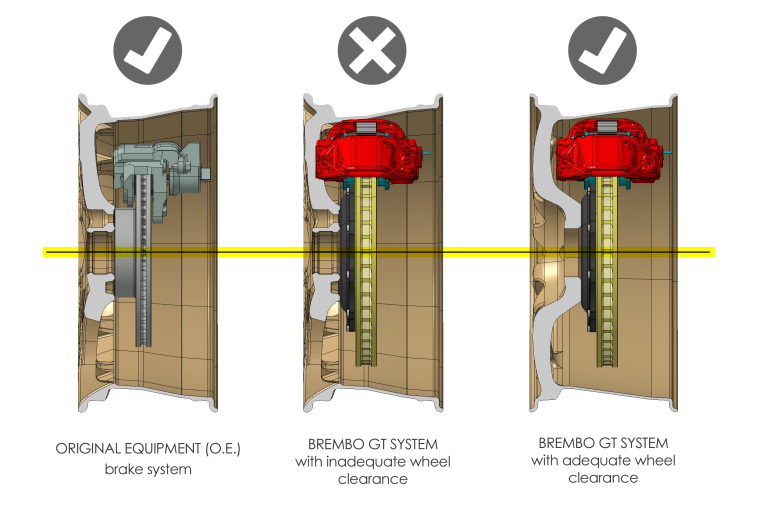

The profile of the new wheel's spokes and inner rim will determine if the wheel will fit over the brake caliper. The diagram
below is for aftermarket BBK's, but the same applies for stock calipers. Again wheel spacers can be used to clear a caliper
if required but may push the wheel too far out (see above).
Usually aftermarket BBK manufacturers provide caliper profile templates so that you can see if a wheel will fit over the
caliper's profile. The example below is for an AP Racing AP7500 caliper:
