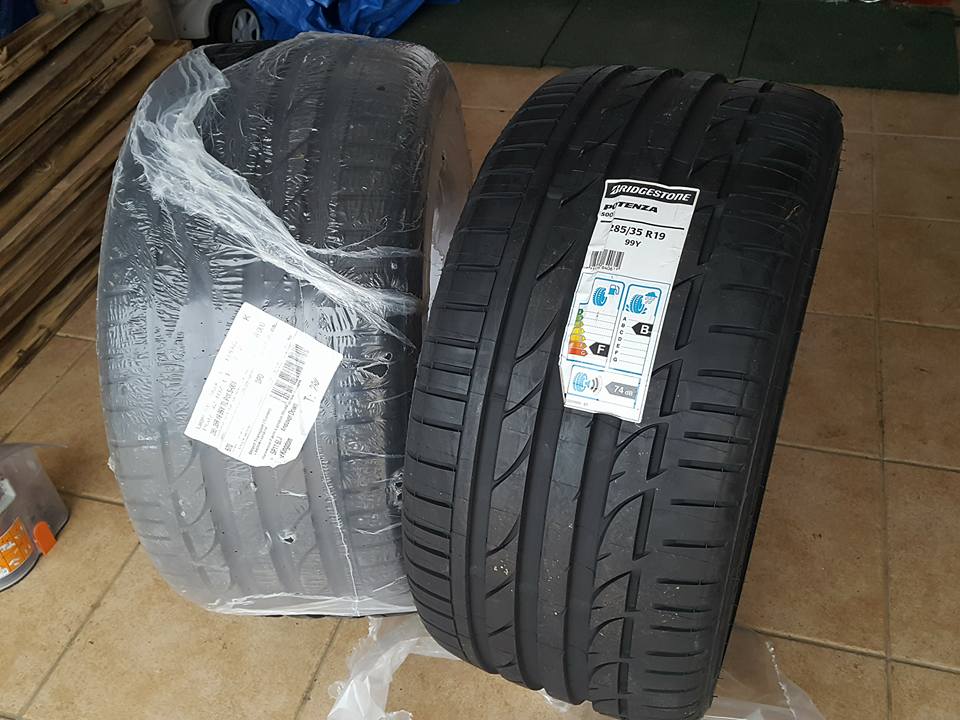

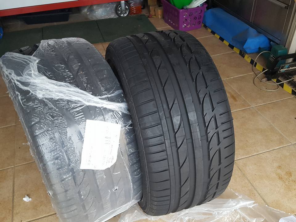

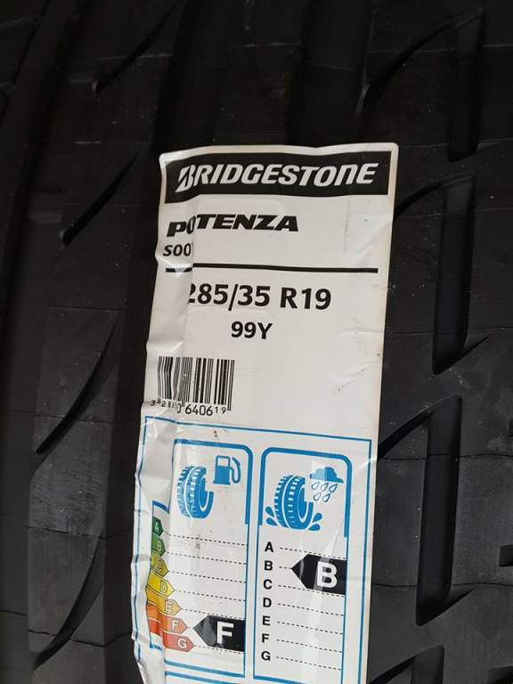

Just bought two new Bridgestone Potenzas rear tyres to match my new fronts and paid £450 for both delivered, German supplier but no issue with prompt delivery to the UK, of course I then had to get them to Portugal but that is actually easy, not sure of your tyre size but these are not skinny one`s by any measure !

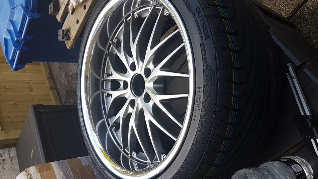

Ive found some alloys with some tyres which if I can agree a price with the seller i'll be picking up soon. Still got lots of other things to address though.

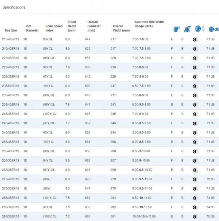

The problem is that although they are 8j front and 9j rear. The fronts are 245/40 18's and the 9j rears have 265/35 18's but the fronts have over 5mm of tread and the rears need replacing, but the rolling radius would differ due to the width of the fronts being 245 instead of 235.
Would it be ok to run 245/40 on the front with the 265/35 rears, or would I need to change them for 235/40.
The car doesn't have traction control, and I dont know anything about the diff, but would there be much of a negative impact on the car just running the 245's on the front until they have worn down to the point where they need replacing?
Would there be much difference if put 225/40 instead of 235/40 on the front and 255/35 instead of 265/35 on the rear. Would it affect the Speedo much because I can save £80 by going for 10mm narrower tyres
I wouldn't worry about it. You're talking mm on the differences, I bet it will be the width of a speedo needle.
With regard to handling and stuff, you don't hoon about do you, the small difference in width is less of a factor than tyre brand and rubber and indeed old and new tyres. I personally think It'll be fine.
