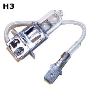

H3 Bulb as fitted to UK spec zed is a single wired connection that is eathed through the base plate

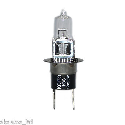

H3C bulbs as fitted to import zeds is a twin spade connection bulb with no fly wire and requires both the live and earth to be directly connected.

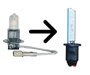

The two bulbs share the same base plate and the dimension from the base plate forward.
When fitting HID bulb, the base plate size and shape is what determines the fitting application and in the case H3 is correct, additional cable and connections are included to make this all work.
