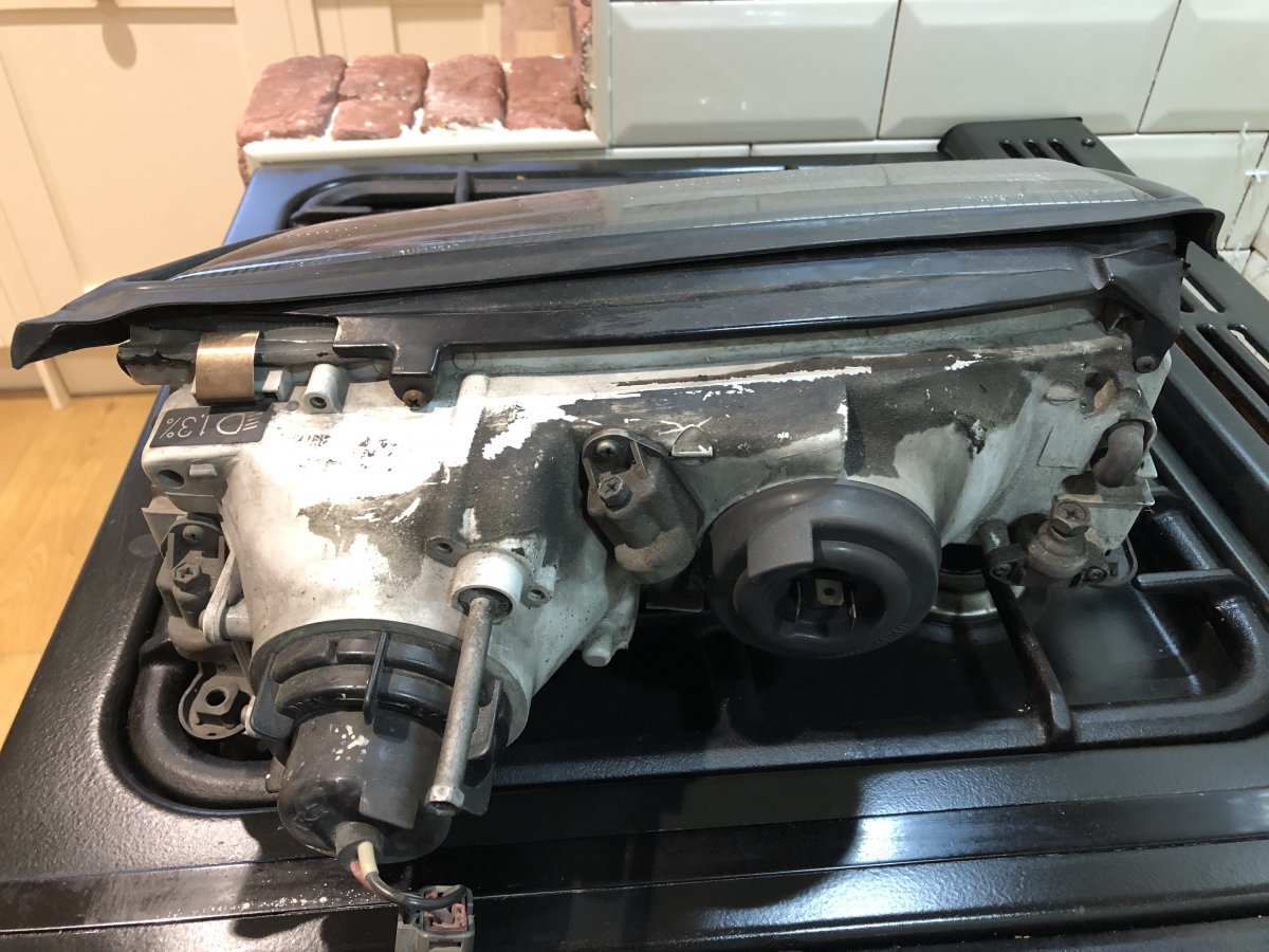

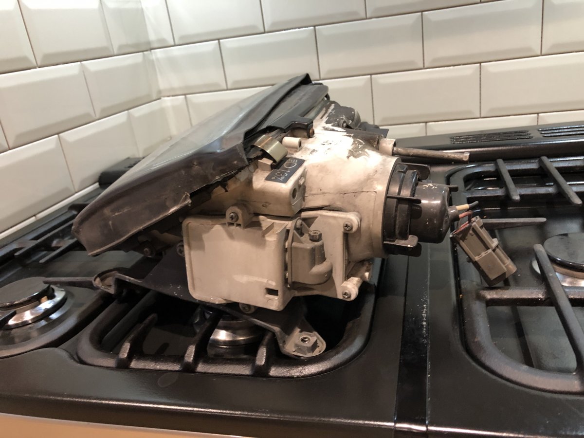

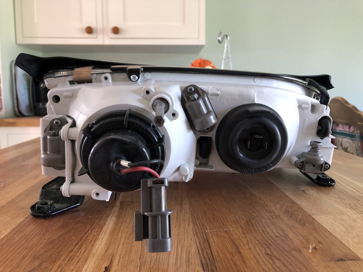

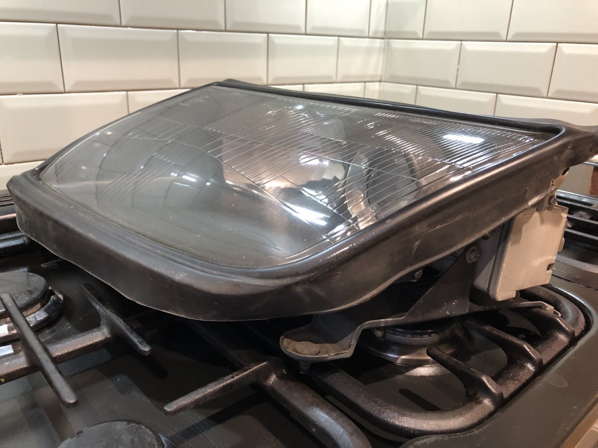

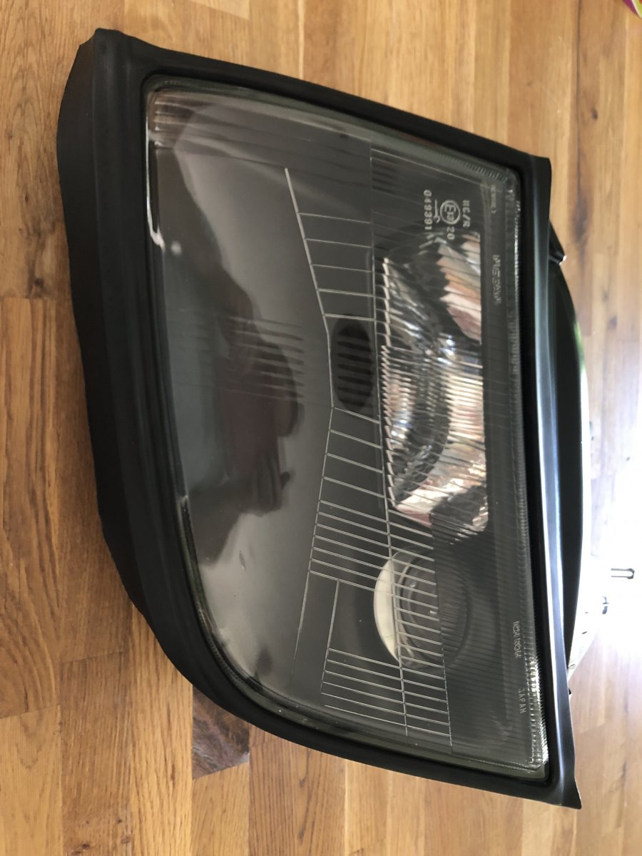

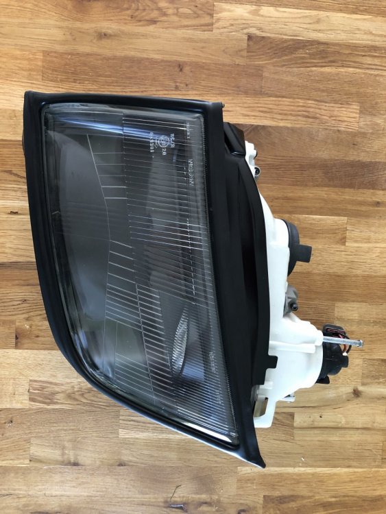

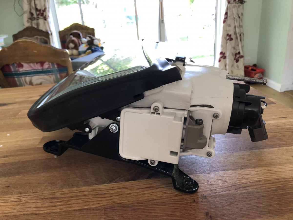

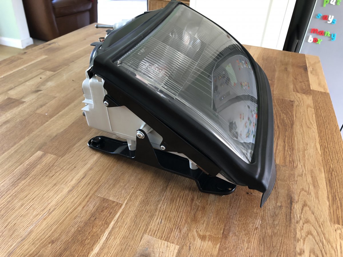

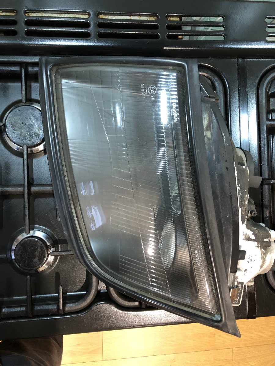

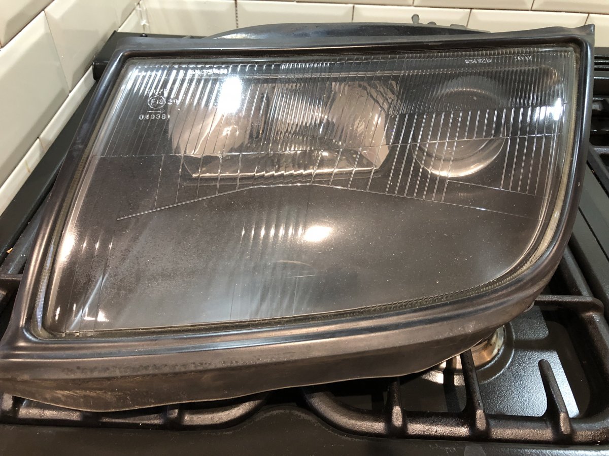

I finished of the light refurb today and bolted on the newly powder coated tin work and plated screws. They’re not perfect, I would like to have split them and rechromed the internals but that will have to wait.
Hope you like the before and after pics...
B1BD5E94-B127-48E5-868D-5BFA64840F48.thumb.jpeg.466b153f9482b2d53e76a91dceaa4beb.jpegFF668375-2736-4C70-B0CA-02FA8FD8103D.thumb.jpeg.bc20e6f2aa6fd16085ca668d335010c1.jpeg
They look brand new so well done! Great job! I’ve gotten inspired by this thread where you’ve refurbed the nuts and bolts in the engine bay - want to start this soon. Will make a huge difference.

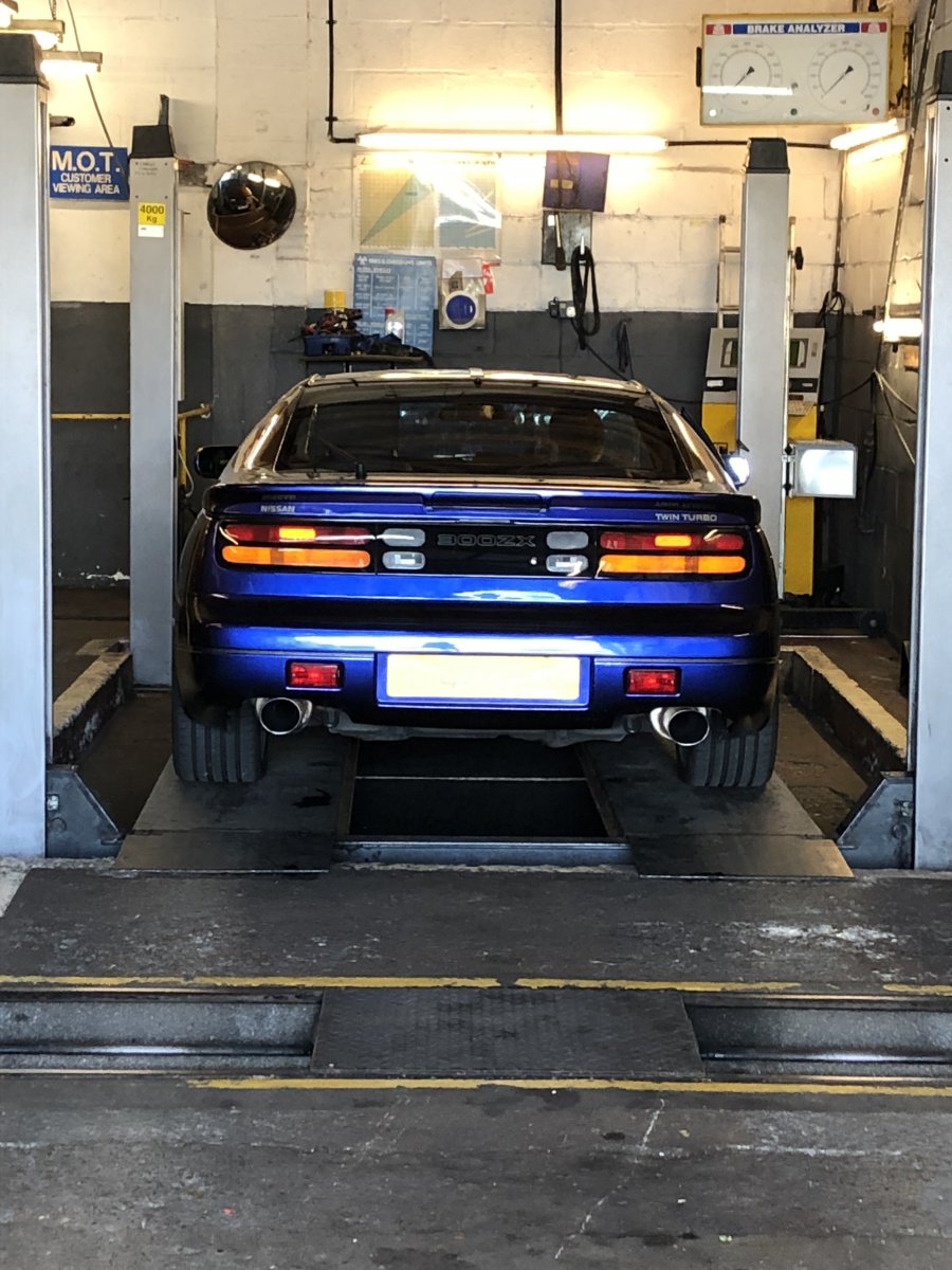

Just bolting the chameleon back together for it MOT on Tuesday. ?
Here are a few pictures of the before and after for you amusement...
Anyway, back to today...
Car passed. A few issues raised...
Near and offside anti roll bar links corroded but not serious.

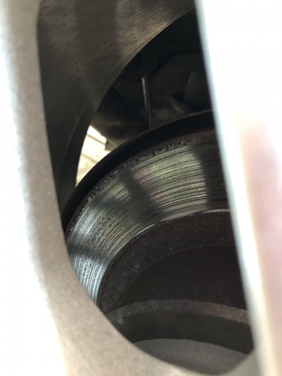

Read disc worn, pitted or scored but not serious.
Im a little gutted with this one as the discs aren’t bad at all, they’ve just got a little surface rust due to be left in the air for 9 moths while I worked on the front and I didn’t clean them off on the way to the test as it’s just a two mile drive to the test centre. Never mind, will change these too.

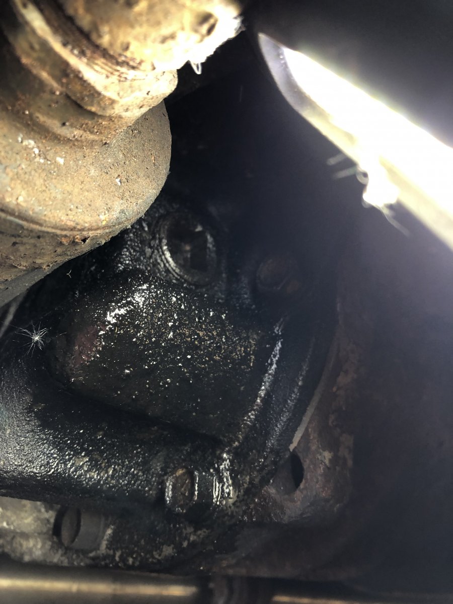

It was also also noted that there was a little oil coming from the diff plug. Again will get this sorted.
All in all I’m very happy to have the car back on the road after 9 months tidying her up.

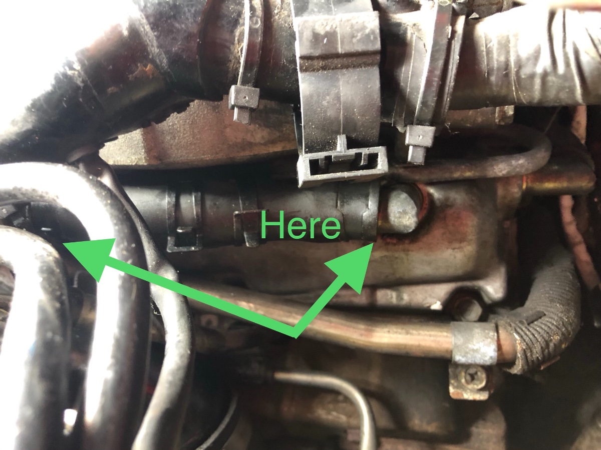

So I gave it as good a clean as I could with the injectors in place but unfortunately I couldn’t get to the contacts on injector 4 well enough to give them a good enough clean, there’s what looks like part of the fuel system above it. Any ideas if this is simple enough to remove?
Results from the clean were from 1230 ohms down to 23 ohms on injector 2 and an open circuit to 12M ohms on injector 4. I believe my target is 10-14 ohms. I’m not convinced that I could have cleaned injector 2 any better, it’s gleaming now.

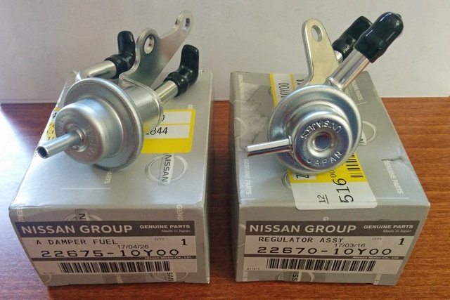

Anyway today I started to remove the plenum to get to the injectors. I’m going to be carrying on with my restoration project as I go. I was wondering is it worth replacing the fuel damper and pressure regulator while I’m there or just refit what I have?
Replace:
http://www.twinturbo.net/nissan/300zx/forums/general/view/2610744/Here-is-how-it-works.html

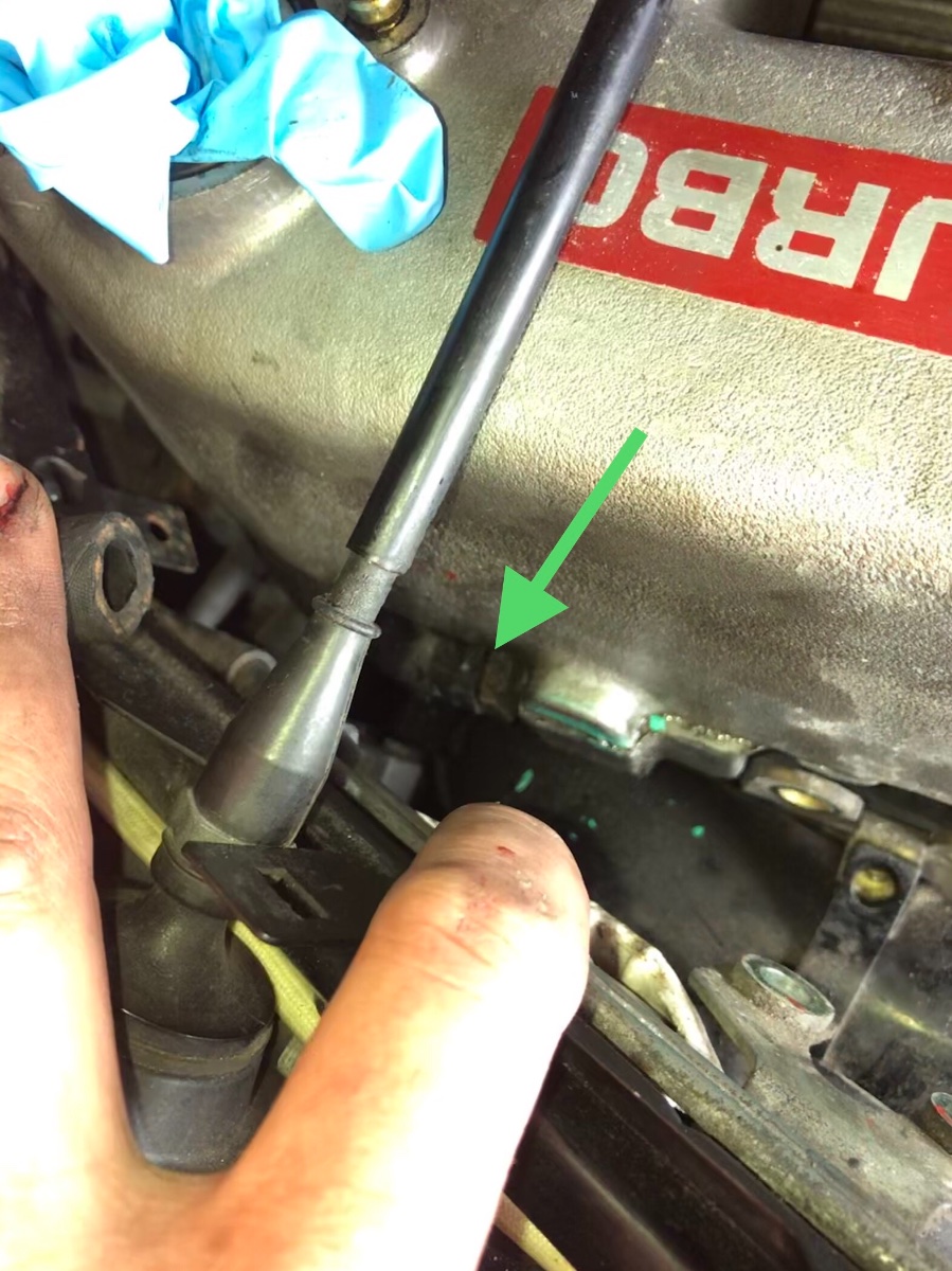

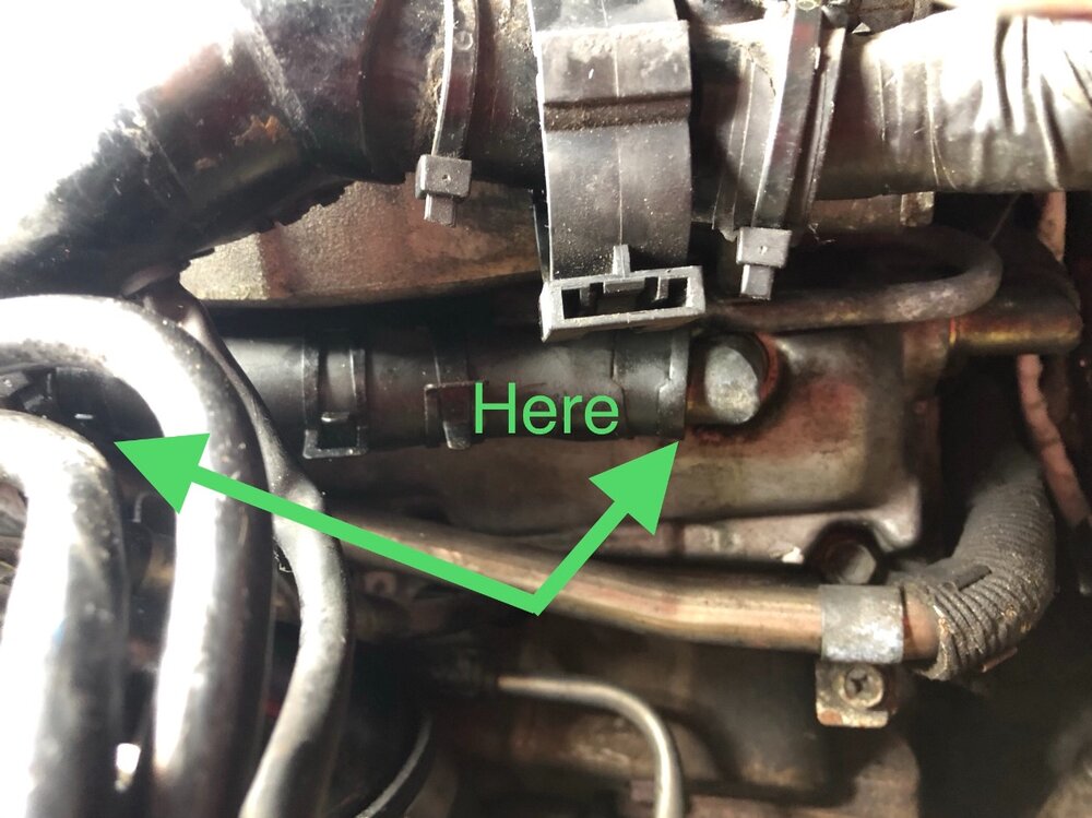

I’m nearly there I think with removing the Plenum. I struggling  with two pipes that run along either side of the plenum though.
On the near side is a hard plastic pipe that runs from the lower middle edge to the cam cover.
On the off side the hard plastic pipe runs from the lower middle edge and goes down low.
What are these pipes for and how do I get them off?
Cheers,
Chris.
Those are your PCV valve hoses. Originally they are pliable rubber but go hard with age and are renewed when replacing the PCVs. This guide gives a couple
of hose removal tips.
http://www.ttzd.com/tech/pcvtech.html
These photos will give you a better idea of what you are dealing with.
https://www.pexcom.com.au/z32cms/e107_images/1994_engine_pics.pdf
