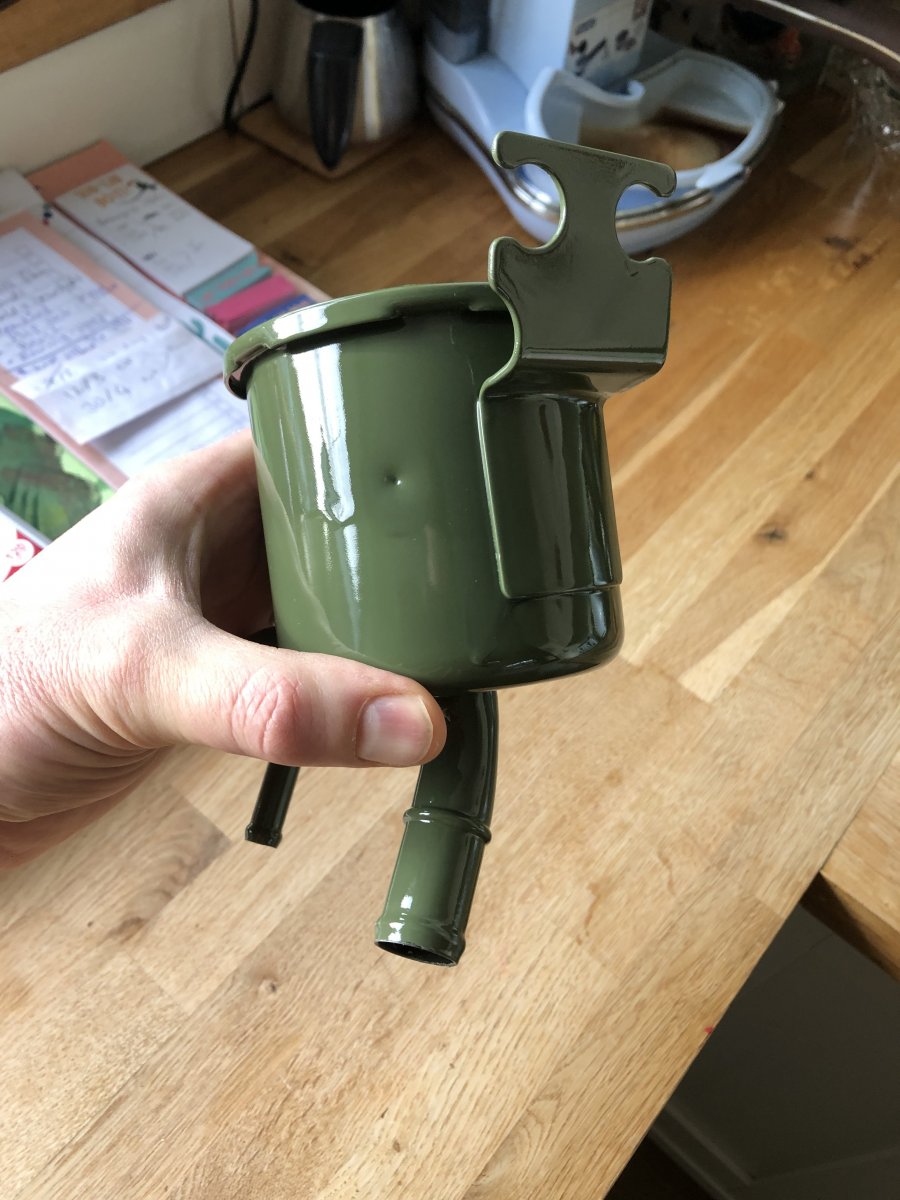

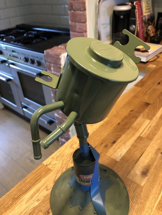

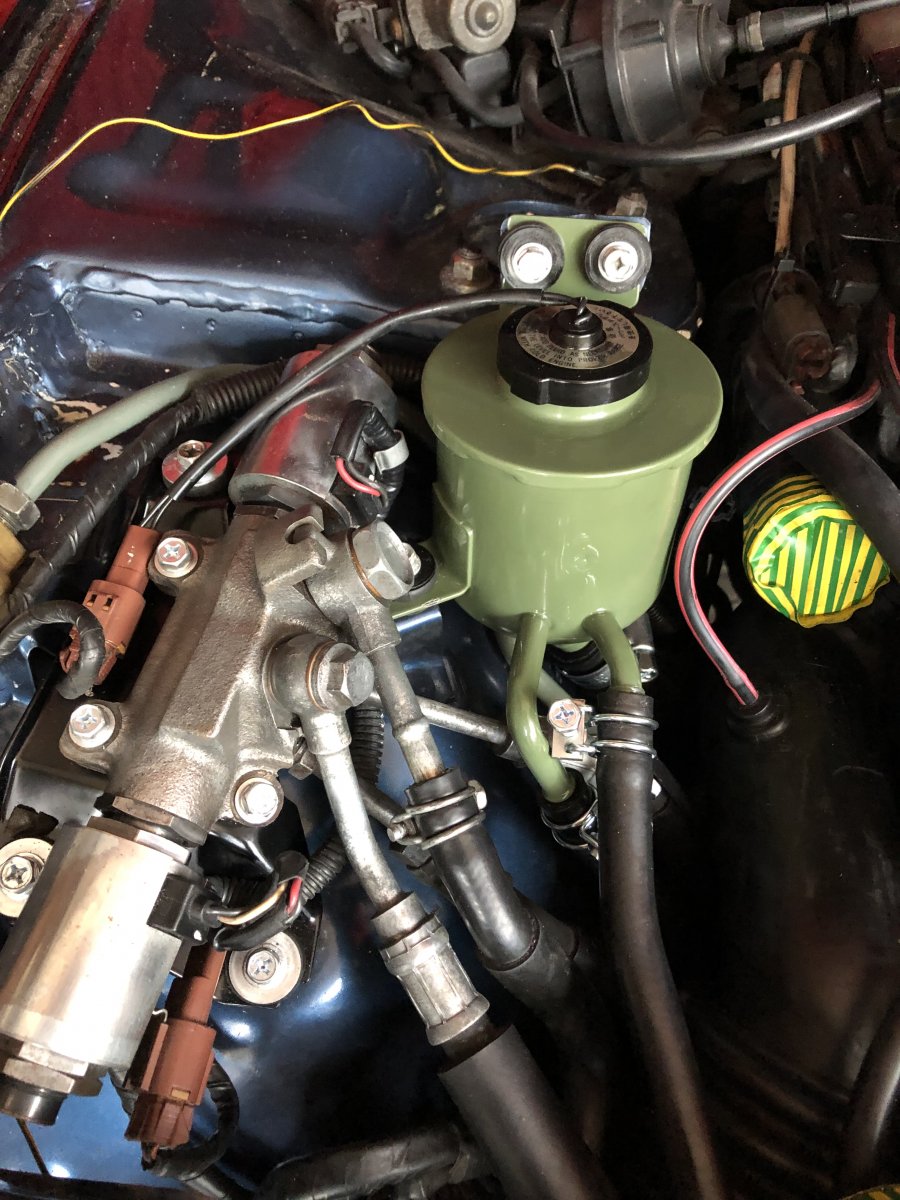

Yesterday I gave the PS pot a good rub down with some 1200 grit paper and applied the lacquer.
Without question this was the hardest paint to apply and unfortunately I have created a few runs. It’s nothing that I can’t fix but I’m a little frustrated with myself that I was so heavy handed with this coat. ?‍♂️
I’ve now got to wait a week for the lacquer to really go off before I can start the shave, rub down and  buff. ?
On the plus side the lacquer has mad the pot look a lot darker, it’s still not as dark as OEM but I’m sure only a few would notice the difference when fitted. ?
20 minutes ago, Gaz 300 said:
Thats an awesome turnaround ?

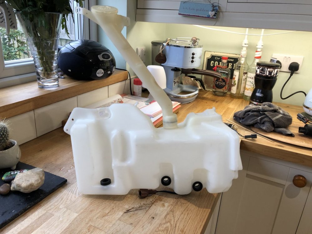

Thanks mate. Next is to fit my cleaned washer tank.

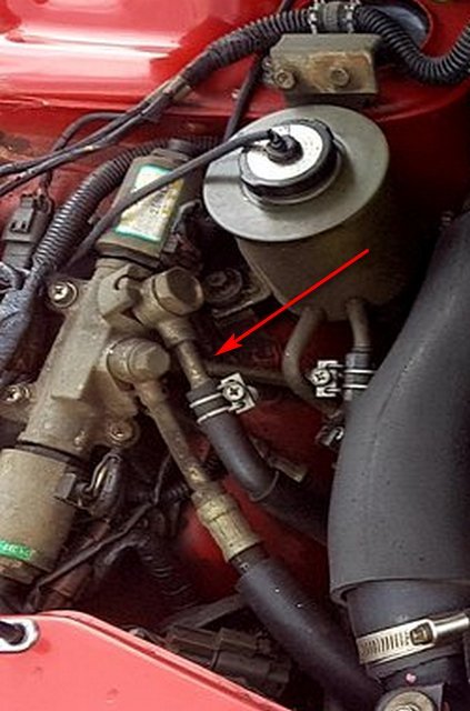

1 minute ago, AndrewG said:
Nice job Chris. BTW, the HICAS rubber pipe is not fully seated:
Thanks Andrew. ? It’s not been clamped up yet (as you see) as I want to give it a flush after I put the cooler rad back on.

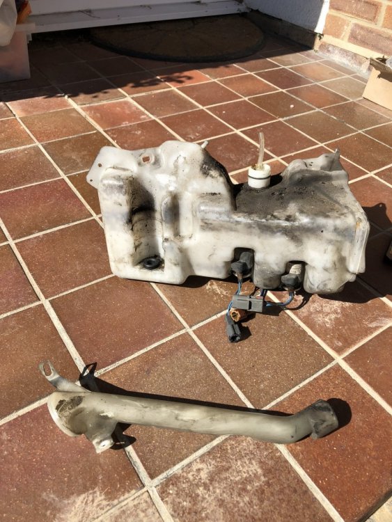

I haven't been following this but it popped up in my email for some reason tonight and I must say it's very interesting. How did you clean that washer tank?
Hi Jeff
I left it soaking in a few different products (bleach, bicarbonate soda, vanish etc...). Vanish gave the best result.
I also filled the tank half way with cold water and added a fist full of chickpeas to dislodge all the gunk from the inside.
Interesting, thanks for the update. Good luck with your project, mine is laid up rotting away nicely, awaiting a rebuild like you're doing. Got the time now, but no money! All the best.
A lot of the work I’m doing at the moment isn’t very expensive, just time consuming. But in fairness my car was perfectly serviceable to start with, just not been as loved over the later years by the previous owner. Pick a small area to work on mate, start a “project thread” and get to work. ?

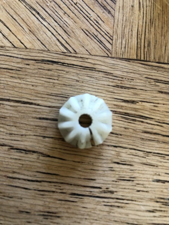

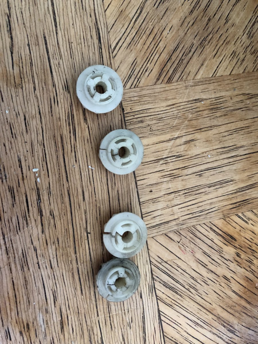

  • 4 weeks later...

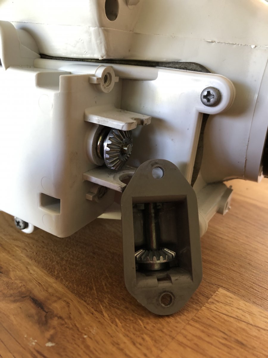

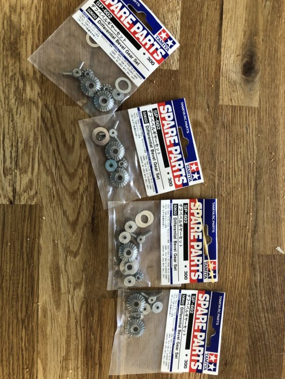

Be careful when you tap the cogs ‘home’, the plastic carcass could be brittle and may crack if you’re heavy handed.
Using a long reach socket helps, plenty of grease is good also once installed.

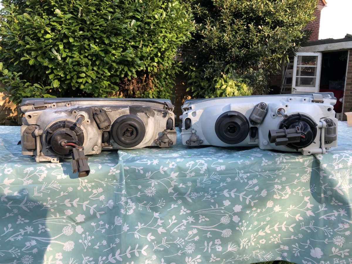

So that was easier than I thought it was going to be.
I also tried cleaning the inside of the glass but I’m unhappy with the results. However it will do for now as I want to rebuild the front end ready for an MOT later in May.
