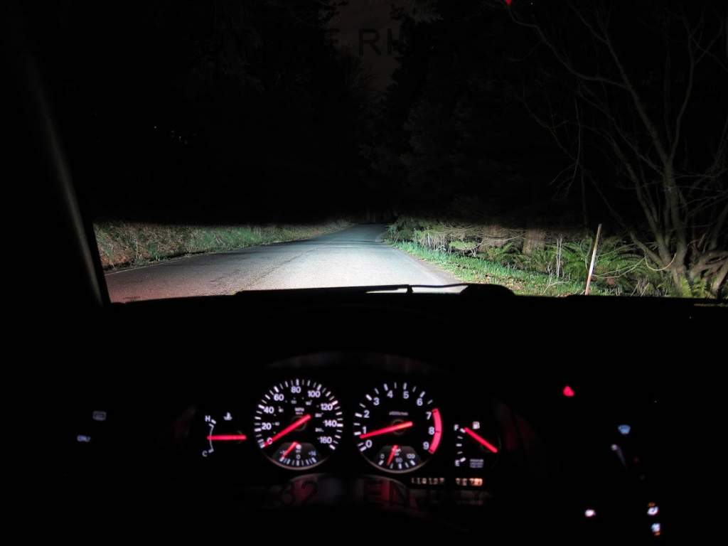

I was out in my Z last night and honestly the stock xenons are great. The cutoff is so crisp it doesn't compare to any halogen or other lights, it's like a solid border.
I have never seen a fuel tank needle so high in the gauge before Andrew.
I have, 7 times earlier in the month! :lol:
