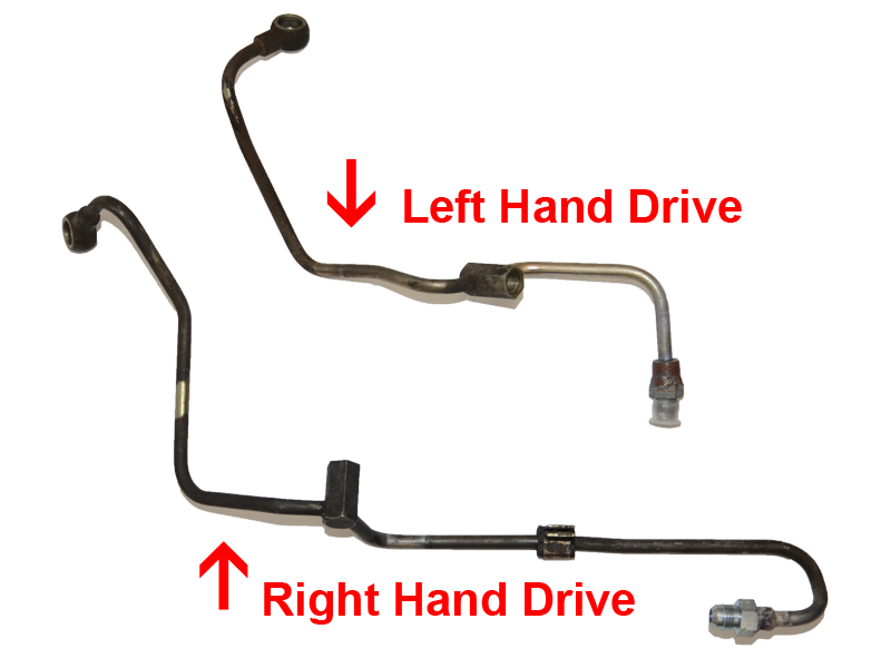

I have a 1990 300zx ..Z32-A Import. I have had a Po:punk::punk:wer steering hose leak have had it repaired by Bonafide hose repair but still leaking . New hose purchased on Ebay from America but not the type on the vehicle any help would be most appreciated
You have likely bought a left hand drive version.
ย
[ATTACH=CONFIG]108163[/ATTACH]

Spot on !!!
There the metal pipes.
Isn't it the flexible high pressure one that normally fails?
I think every z going has or will have a pas leak because it seems Nissan decided to make the hoses from several different other vehicles out of their parts bin tbh.
ย
If you've got a Hydroscand near you they'll make you one up as long as you have one for reference and it will last as long as your car.
