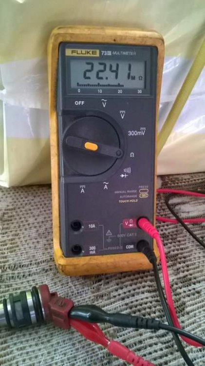

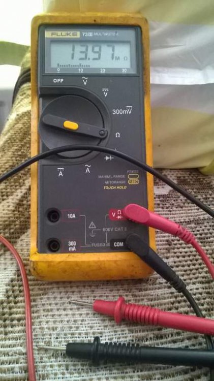

Check the resistance of the injectors, should be between... 10 - 14 kOhms
I used a spare connector with tails, but you can get the meter probes in with a bit of care, albeit a bit of a fiddle.

Hi Guys, Well its bad news, its the injector, checked both pack/plug assemblies of a good cyl against the bad one, the misfiring cylinder has sparks a plenty also when swapped to the good cylinder, so the sparks okay, which would mean the PTU is giving it, which means its okay (dam), which only leaves the injector, Did the screwdriver test and the good ones really did click but the bad cyl was just not there, probably heard the good injectors firing. So i've changed an injector before which included drilling away the plenum. Wouldn't wish this job on anyone...its a beatch.

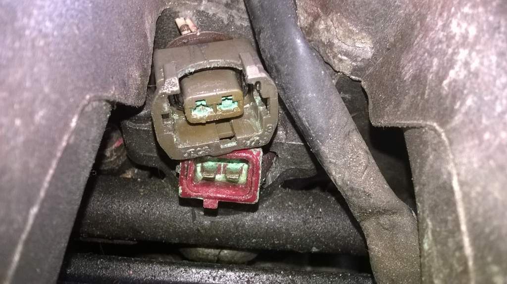

I was just wondering, could this be the cause of the misfire.....
100%
I'm surprised you haven't checked it yet.
Have you tested the connection to the injectior yet, these fail quite readily.
Also did you chop that injector plug off?
We've diagnosed your problem sir, your arm appears to have fallen off. :lol:
Ok, i've put my arm back on and the state of play now is:
put a new tail on, sprayed the injector side with that special spray, cleaned the contacts really well, put it all together and fired her up. Then kicked the gate, fence and then the cat,!!! Bugger, no difference. After going to my shed and having a good cry, i sort myself out and think what else can i try before grinding the plenum away......
