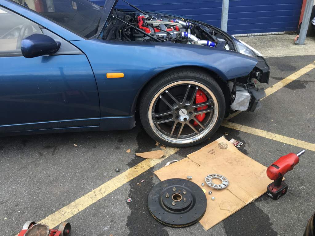

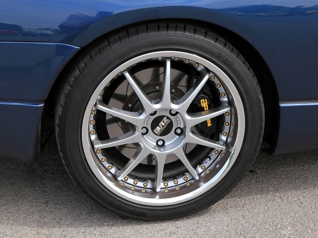

Rather depends on your budget. I went from R33 GTR Brembos to AP Racing off the shelf fronts and bespoke
AP Racing rears. Pricey but the mutt's nuts.

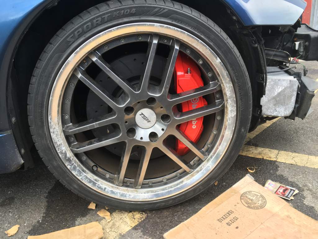

Never had any issues with r33 gtr brembos with decent fluid and pads when I had mine, and that was back in the day when I uses to do some silly high speed runs in the Z.

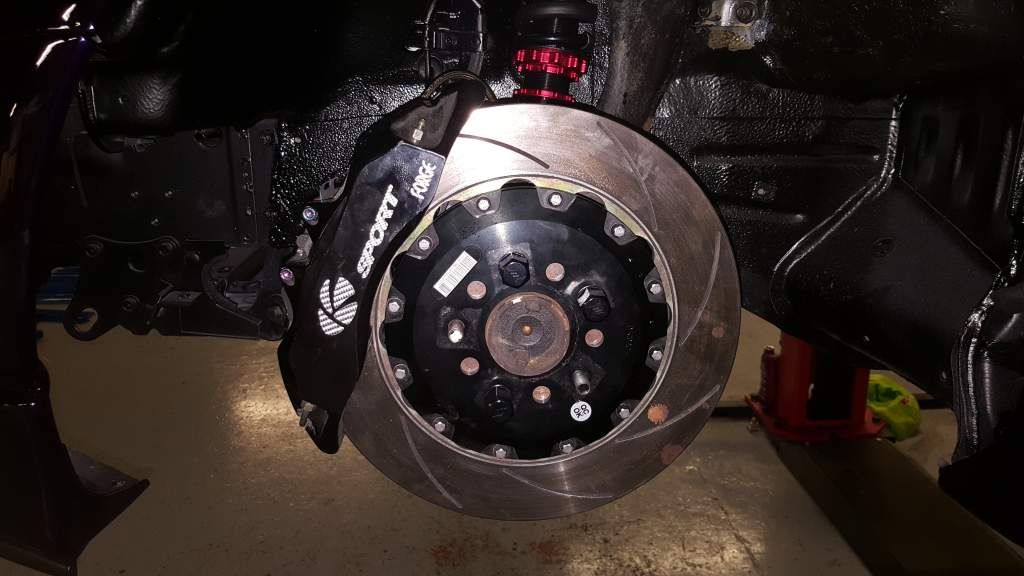

I went with K Sports F &R and EBC NDX Blue pads. Very happy with the setup
