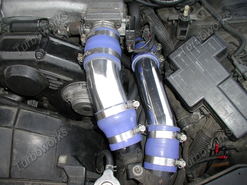

The stock intercooler piping flares out to the throttle body. More noticeable on aftermarket hard pipes. Dunno what the actual size is though. IMG_0923.JPG
I'm sure in reality they will be fine. They seem to be very similar to the japspeed items that many people over here run including me.
