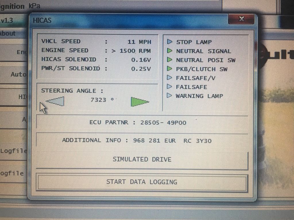

So since putting my Z in for its MOT its developed the usual heavy steering at low speed/intermittent speedo drop out fault. My first thought was speed sensor as it's a fault I've had on my previous Z.
I decided to investigate further by hooking up to ConZult (cheers BigH) and conduct a HICAS diagnostic (can't do an Engine diagnostic via Conzult as I'm on a Haltech). This is a shot of what it was displaying. Diagnostics was done with the vehicle stationary and idling with the front wheels pointing straight ahead. Car is fitted with a HKB steering boss and after market wheel (has been fitted for 5 years with no previous issues)
A couple of things are apparent that I'm looking to figure out why I'm getting such readings.
1) vehicle speed showing as 11mph whilst vehicle is stationary
2) engine rpm shows as greater than 1500rpm whist car is idling at 750rpm
3) steering angle showing as 7323 degrees to the right, yet it's detecting the steering angle sensor is in the neutral dead ahead position
4) if I accelerate, the speedo responds as expected and is bang on when compared to GPS, yet Conzult detects no change in speed, nor does it detect any movement if I turn the wheel left to right
FunkySi has already suggested that I look for dry solders on the speedo, which I will investigate/resolve.
However, the other issues currently have me baffled.
Any ideas?

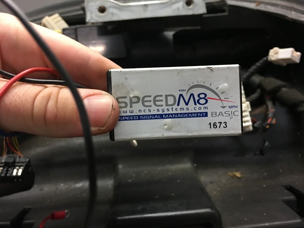

Well I removed the speedo this arvo. This is the converter I have fitted

To clarify, I haven't fitted that converter, I mean that's the one that was fitted to the car when it was imported
Ok, well this is interesting.
So it appears that with speedo converters, while they correct the speed signal going to the actual dial, they don't correct the signal going to the HICAS ecu.

not sure what that steering angle is about...I have never seen it that high.
Almost looks like the angle sensor has failed or something..or maybe a faulty HICAS ECU (because of the vhcl speed issue)
Does the value change when you turn the wheel ? ...or maybe try a different HICAS ECU

No, the value doesn't change at all. I am wondering if the Haltech is causing an issue with the readings the Conzult is producing. I would have expected that with them being so far out it would have triggered "fail safe" mode and thrown up the HICAS light, which it has never done. It's things likely saying the parking brake was engaged when it wasn't, nor any change when I engage/disengage the clutch or brake pedal.

Well the official word from Haltech is that their ecu should have zero influence on the rest of the Conzult systems diagnostic capability and the Platinum Pro plug in is calibrated to read the vehicle speed sender via one of the options within the ecu manager.
I think I'll try and plug my original ecu back in and see if it makes any difference to the Conzult and the diagnostic results, otherwise I'm going to have to do as I mentioned above and manually check each component with a multi meter and cross reference with the WSM

I have put and new speedo converter in. This one corrects the speedo but sends and uncorrected speed signal to the ECU.

Conzult still shows the same readings as per the first post.
