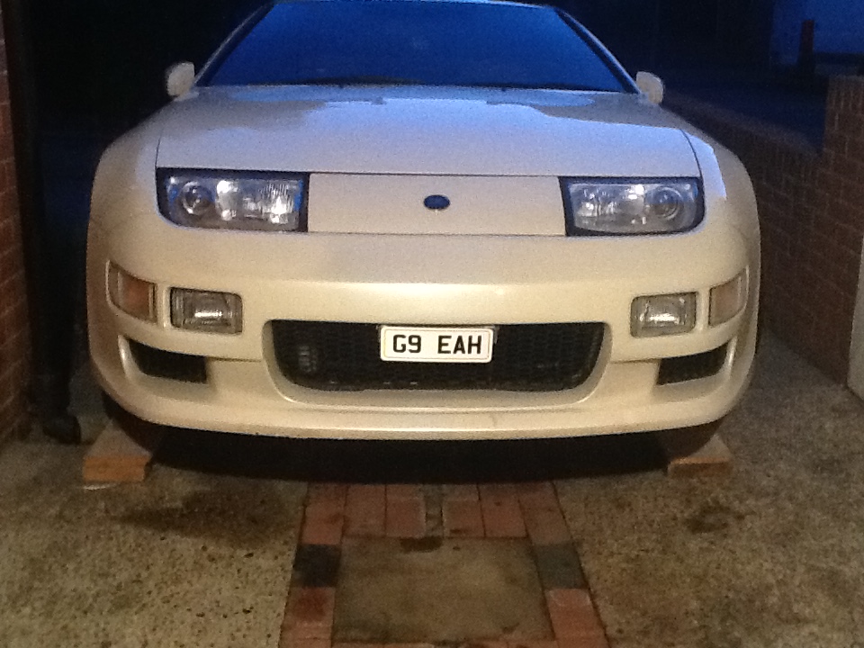

What a lovely looking little red shorty!
Indeed.....:thumbup:
'Plates look fine to me too, Chris....:cool:

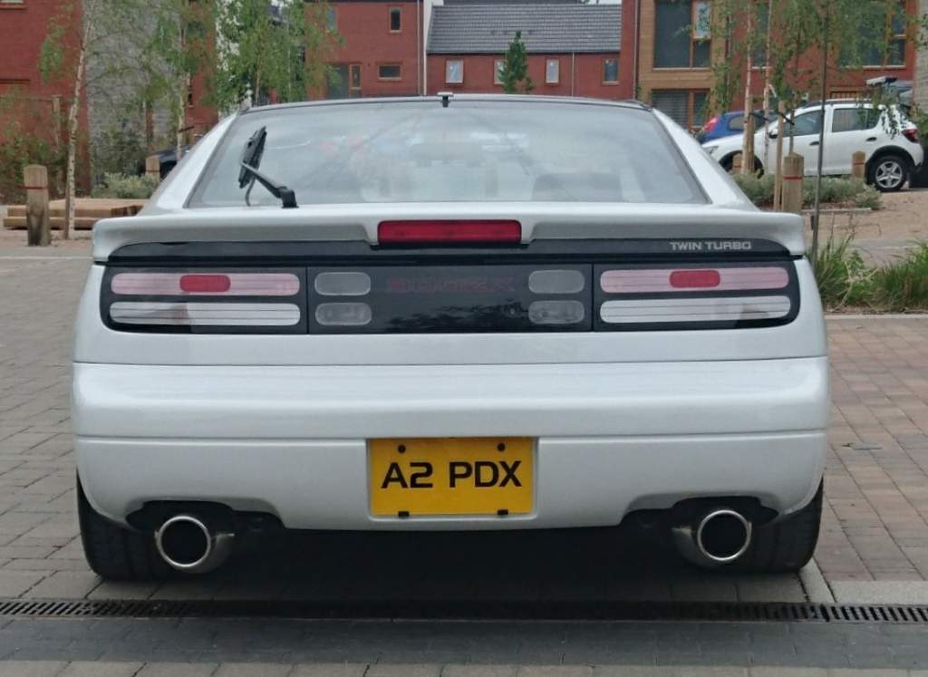

...Front is certainly bob-on!! I'd probably have gone for a rear 'plate that pretty much filled the aperture in the bumper, but it's still good!!
I must admit, I should have gone cut to size on the rear and fill in. It does look better.
Go on to http://www.fancyplates.com. I can give you the measurement if you want to get another rear plate made up. It's not expensive, I think under £20 delivered. Used these guys for years and they're very good.
Thanks Si, I purchased these two from fancy plates as it happens. I actually made the rear plate smaller as I thought it would look better.....not. no worries, I will order a replacement now. Cheers Mate.
