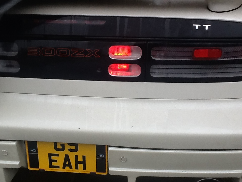

Then you can use that switch & run a feed wire to the back & convert one side or your reverse lights as a rear fog.

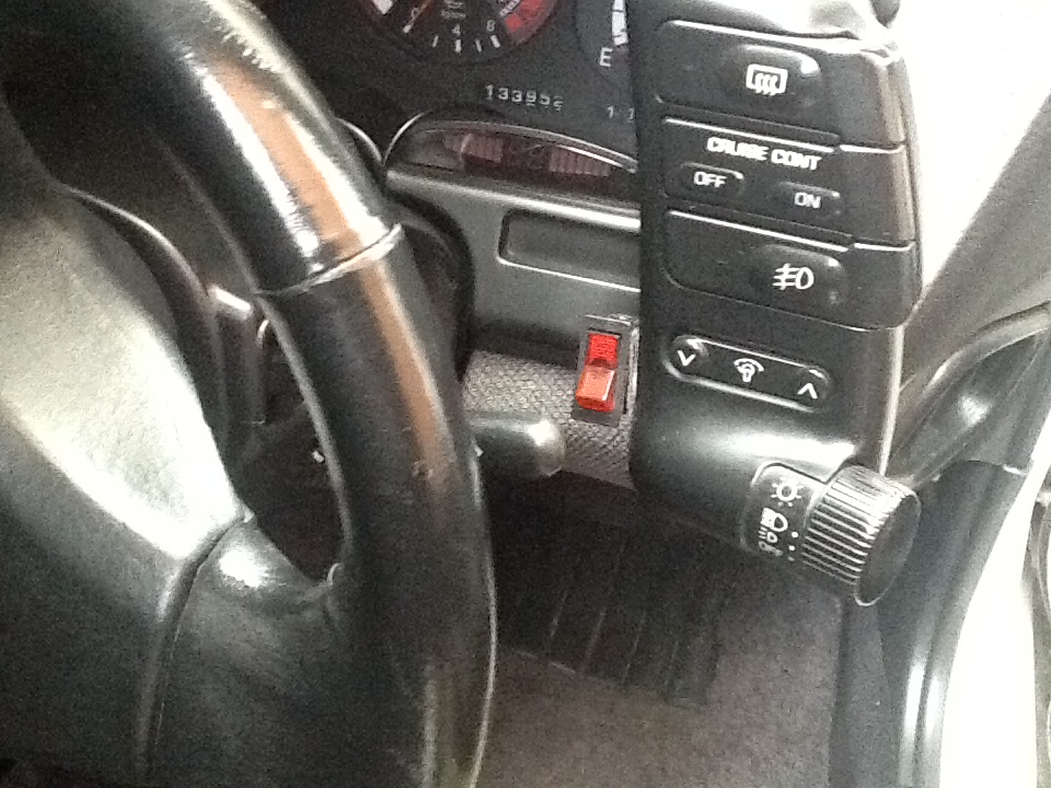

I have a separate switch located here
And here are the rear fogs?
You can get the red bulbs on eBay
Hope this helps?
There are several other ways to do it!
The switch has to be illuminated and the easiest way is to tap into the side lights power feed on the right pod.
Run a live wire to the rear and up to the right side reverse light as above, use a separate bulb hold or cut off the
one that's there and ground one side to the chassis.
Get a fog switch like below and you need connect the live from the side light to one prong, a feed to the actual bulb
and ground the last; that way when the switch is on the light illuminates too.

Personally I prefer a separate switch and the small round ones shown above can be put on the inside of the pod and is fairly hidden.
The switch can be hidden out of site as long as at test time you inform the tester where it is and that its is still illuminated.
