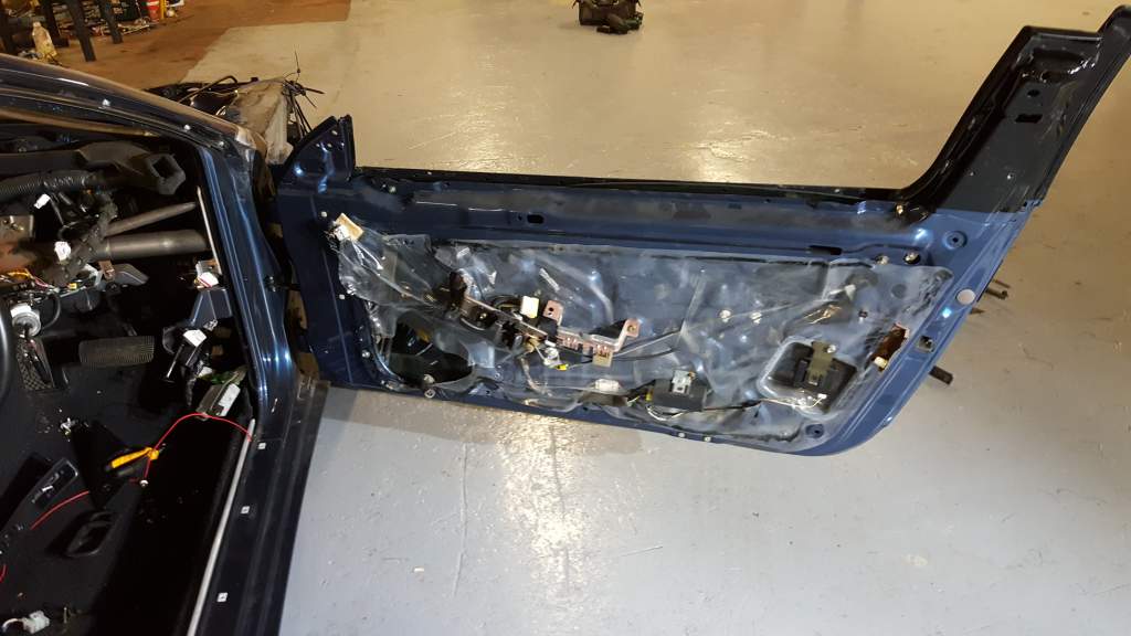

I thought it was to do with the series 4 or likely the fitted alarm.
My previous zed had the hole for it but no cable or module.
The cable going to it are just a pair so not enough to actually do much, like a signal wire.
I've got the threaded hole for it and the recess but that's it Lee.

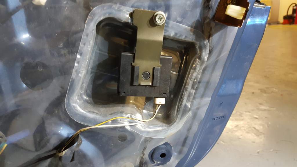

The recess and the threaded hole was originally where the early import seat belt reel fitted, the plastic going into the recess was there to keep the belt dry, the control unit you have there I am sure is part of the alarm, have seen Nissan sirens in the door also, it has just been fitted there as the place was available.

haven't opened it either.
I have one of these in my '99. No idea what it is so I'd like to know too.
I opened it, it has some sort of flat, concentric metallic discs inside, but I've never seen one like it before so I put it back and moved on.
Sounds like piezo buzzer, it likely is the part that makes the alarm noises.
Yes, this is what it looks like, I hadn't considered anything like that.
