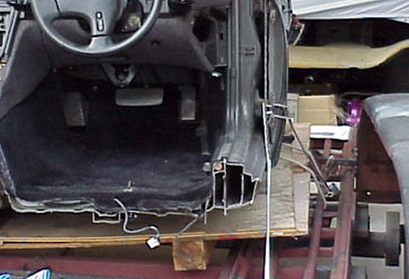

This morning I was up and in London for breakfast time so I arrived back to a very sunny afternoon and took the opportunity to use the Builthamber stuff. At £20 a can (tax and post accounted for) it's not cheap. However I had a few questions about the product and I have to say the response from Mr Hamber himself was prompt and informative. I was impressed with the swift delivery and the fact it comes with an accompanying sheet all about the product. So onto the product, a 750ml can was enough to do both front rails, rad support member and front subframe, so I recon to do all your cavities you'd need about 6 cans, they do do a liquid for compression application. Looking down the rails it spread well and dribbled out here and there so I think it's safe to say cover and penetration. Highly recommend and il be using more for all the remaining cavities. Anyone got drawing that shows them?
Did my sills yesterday with Dinitrol ML but slightly easier for me since I have holes them from side skirts fitment. a 500ml can (£10) was enough for each sill, probably excess since a lot of it drips out the bottom.
Literally a cross sectional view:

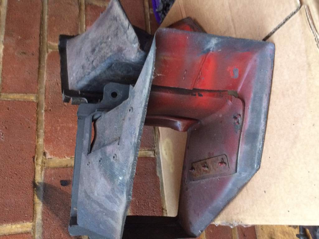

Is this normal? Can't see a purpose for it and can't recall seeing it on others cars.
