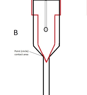

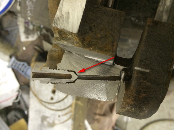

Basically one of the bleed nipples sheared off on the caliper. Common issue with these by the sounds of it. So I pain staking lay drilled out the thread half a mm at a time. Sadly it appears I've nicked the caliper body and the nipple no longer seals properly. That's my leak. Gaz popped over this evening and we tried to rectify the spongey brakes, at which point he noticed this fault. Any ideas greatly recived.

That's the exact conclusion we came to. It's a serious buisness stopping, not much room for error. So in a way I'm glad we found it and we found it before it caused a problem beyond a spongey peddle.
Drivers side brembo front. The last one to bleed which helps with the illusion that it's working to start with.
