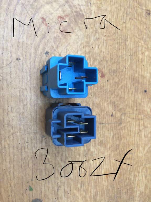

Annoyingly my little relay treasures didn’t work out.
[ATTACH=CONFIG]112392[/ATTACH]
Do you need one like the pic "300ZX"???
I do indeed Pete. Mines worn out, it clicks about 30 times before either latching in or just not.
I can send you one/two.
Where do they live and what are they for??
I can check them out on my car maybe before sending.
PM me.
liked the battery terminal solution :cool:
shame about the micra relays, i had visions of zed owners all visiting their local breakers to raid the micra electrics :lol:
Something will share them. Primera is a good bet.
I've got two cars worth of relays, probably best to ask around than raid disimelar cars
That's not a given by any means.
There are still plenty of 300ZX small parts littered about among the existing community.
Do you really want to spend your limited free time hawking about sleazy scrapyards??
I was just responding to what Craig said, for me personally the issue looks like it’s resolved thanks to Pete (gotta PM him and finalise it) however in reference to pirateering from other models, it’s always worth knowing. These cars are vastly less common than some others of the same marquee and obviously some items are common. For example there’s no need to hunt for a good set of rear plate lamps as there’s millions of them on micras. It’s a convenience thing, as well as a longer term thing.

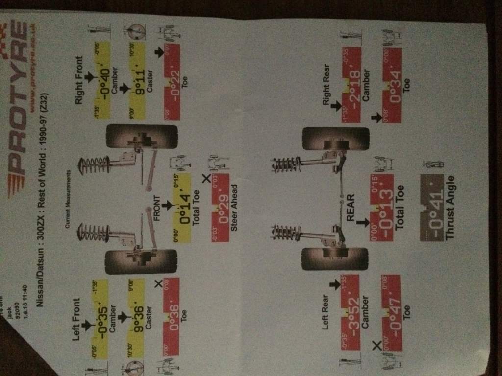

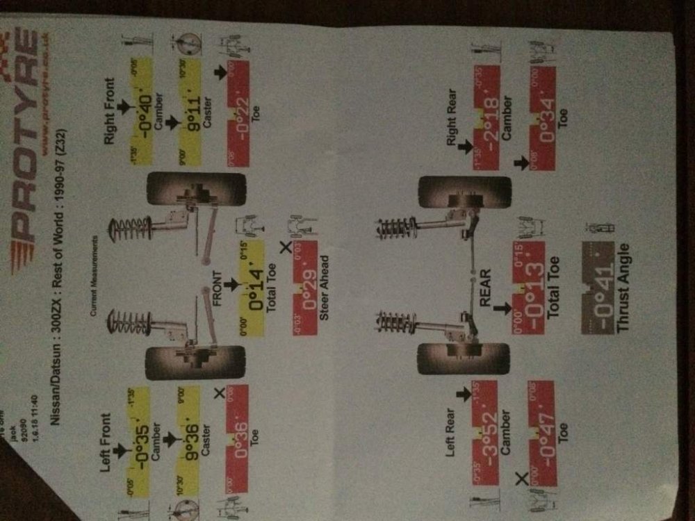

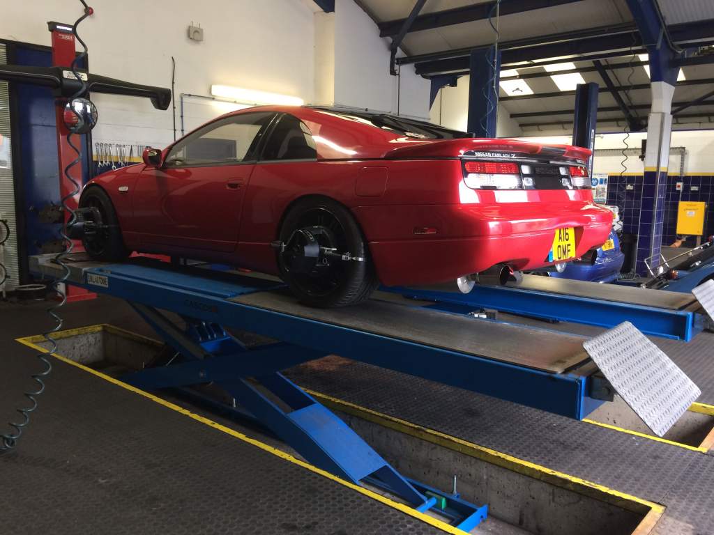

Some dicking about today around this Caster problem. Hub centre to hub centre there was a descrepancy of 10mm. I removed the rear wheels and checked traction arms, both flat out closed. This is what I feared. The alignment guy can’t make it smaller than smallest. So I took the passenger one (problem side) off for further inspection, this revealed it to be 5mm longer than the stock arm. Took it all apart and noticed one end was a thread out of sink with the other and some paint runs where preventing the nut sitting home. Cleaned up and all reassembled. Took it for a quick spin round the block to settle it all out, hooray it’s now much closer and once the toe is correct I recon it will come together, at least the drivers side can be lengthened if required to make things bang on symmetrical. Still waiting for a response for a local specialist as the normal places either haven’t got the facilities to do Caster or they won’t touch modified cars.
Found the previous alignment sheet; the rear is worthless information and it’s a for a Z31 (won’t make that mistake again) but it shows the front camber was 0.2, I’ve raised the front 5mm or so in anticipation that it drop a little with a degree of camber extra.
Can’t wait to get it done properly next week, already it’s so much better to drive.

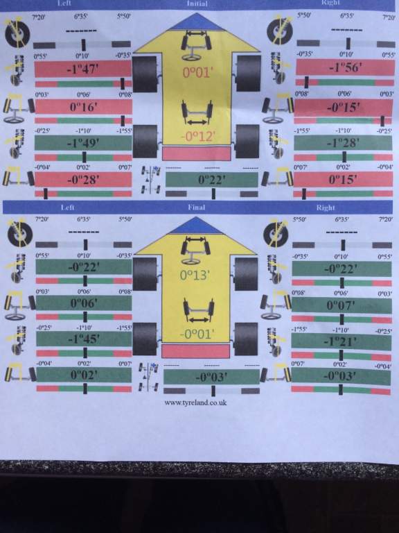

Il upload them in a bit. Significant improvement. Sadly they couldn’t complete the front end as they couldnt get at the front camber arms, I have the powertrixs arms, I think they are just a bit stiff.

So I went with essentially stock settings, adding an additional roughly minutes over stock maximum. This was based around an average of many different people’s alignment settings.
In respect to the front camber, I think your right Pete, just need freeing up. Once I’ve done that I can go back and get things perfect.
Before;
After;
I bet it feels better already. You "before" settings were pretty dire.
Night and day bud. I knew the passenger rear was bad you could see it was wrong, this I know is because I’d been dicking about back there. The front toe though was also dreadful and I’ve no idea how changing the front springs caused such an unequal reaction, makes you wonder but never mind.
Regardless of the alignment, the car is really moving forward. The skipping front end and miles of ABS are gone, the big holes in road aren’t hatch back smooth but they are much better and the small ones are fine. It feels firm but complient, as apposed to harsh. The Brakes, I’m still bedding them in but I can pull up pretty hard from 40 and not get ABS interfering, the bias is far better.
