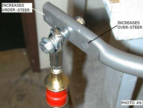

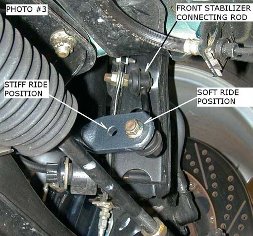

Regarding the setup of the Stillen ARB's these pictures from the installation guide explain the settings
and their effect on the car's handling.
Front:
[ATTACH=CONFIG]106189[/ATTACH]
Rear:
[ATTACH=CONFIG]106190[/ATTACH]
The effect is also relative to the rest of the suspension setup, with the springs rated at 5tonne/mm(!) you will likely feel no difference between the positions. The softer the springs, the harder they work.
Stating the obvious I guess but I've been in cars with uprated ARBs and ridiculously stiff suspension, in those cases you may aswell remove the ARBs and bin them as they're doing nothing!!

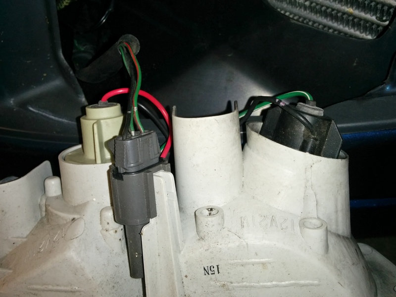

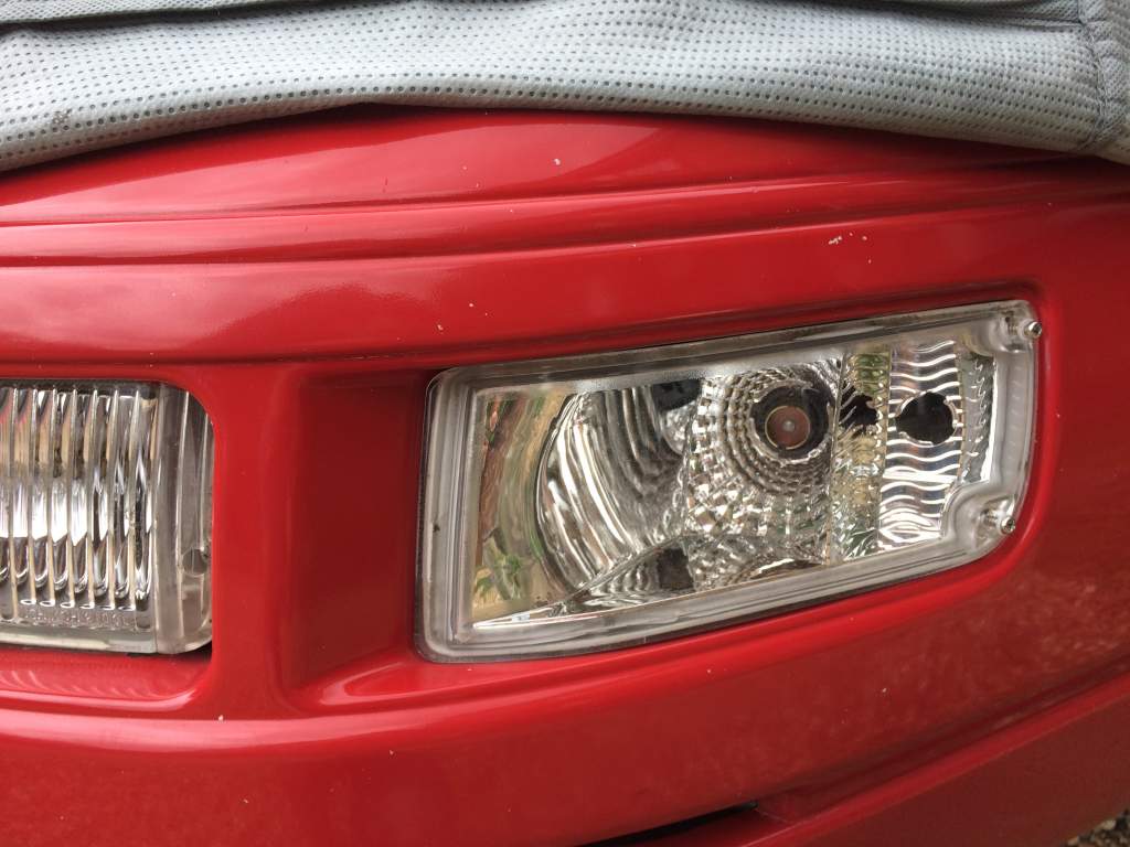

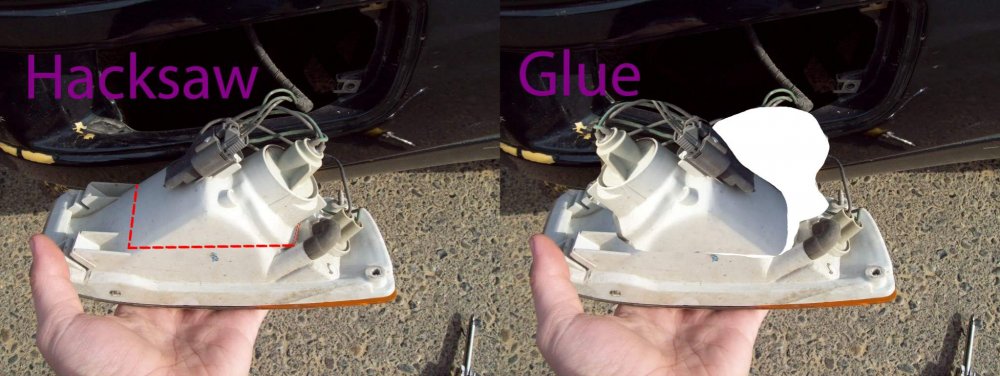

Uncovered a small issue though, in that the intercooler is sitting a few mm too far forward to allow the indication housing to fit them back on. Anyone encountered this? Hopefully I can tweak something without removing the front bumper again. :taz:
The newly assembled front struts are in and nipped up just need torquing up as I ran out of time.

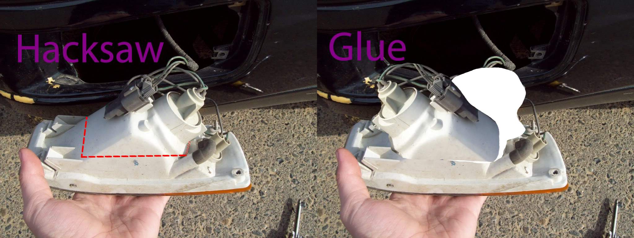

Have you fitted the large aluminium intercoolers?
In which case the indicator housing needs modification O.o
This is the solution I was advised to do and works faultlessly.
Plastic weld would be better than glue but it hold fine and I dont have water in it
Makes perfect sense I spose. Seems a bit brutal to gain a few mm I may pop the arch lining out and see if I can "encourage" a rake on the intercooler, as I say I only need a few mm.
True, my intercoolers were as far as i could force back and still in the way. Probably got a little more room after a CC delete
Alteratively you can modify a rear lights bulb holder (black type) to replace the standard one and gain some clearance.
This worked when I fitted HKS SMICs.
[ATTACH=CONFIG]106259[/ATTACH]
Thanks Andrew. Yes! Like it. Got a few kicking about. That looks like the precious few mm I need.

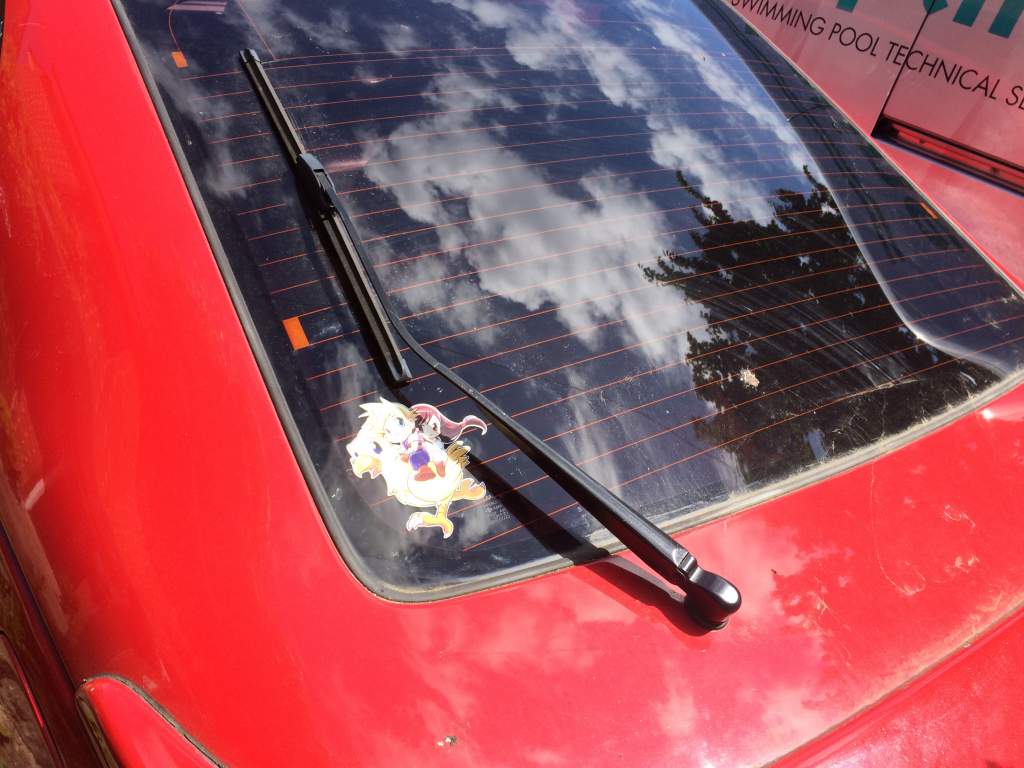

Probably the most important part turned up today after weeks of waiting, 4" square but worth about 1000 retro points.
Erm, Stephen... what are you doing with that young man?...
It has a special place on the bottom left of my rear window. Got to have some fun.

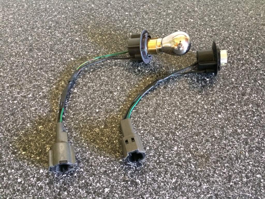

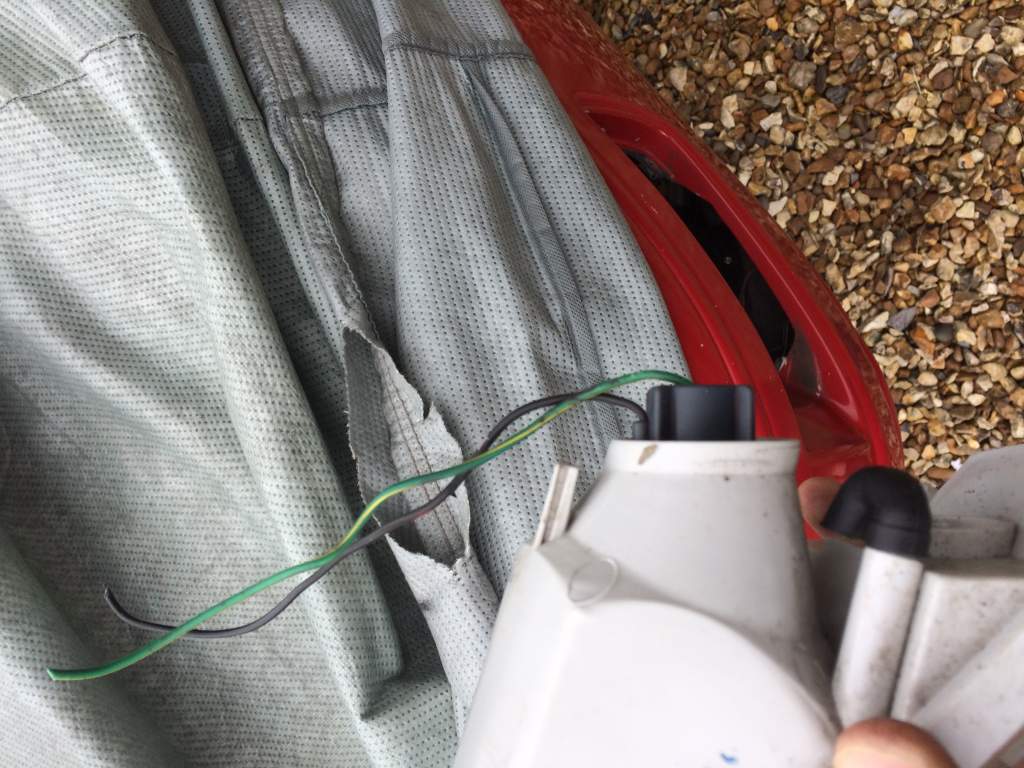

Following Andrews advice I went for a dig in the shed and found an old rear light harness. Just one sadly, cut the indicatior off as a pig tail and test fitted. Ok it wasn't a perfect fit on the plug but it worked and more importantly the indicator now fits.
You only gain a few MM but it's enough, as you can see it's a shallower fitting.
To get round the lack of indicator lamp holders I disassembled a brake/tail light one and switched the original single pole internals. So all that was left to do was solder the bulb holder to the plugs. I opted to solder as apposed to crimp to allow some flexibility to be retained. Some heat shrink to insulate and black tape for belt and braces later were done.
Fitted in the indicators this morning, however the side lights are damaged by the fitting and I need some need bulb holders. 501s I think it is I need. I also cut out my arch liner mounts as they were running on big bumps anyway, this means I've got more importance on those little arch liner plugs, eBay I assume? Got the rear bumper tabs to er, massage :lol: That pesky bolt on the ARB is now hopefully rectified.

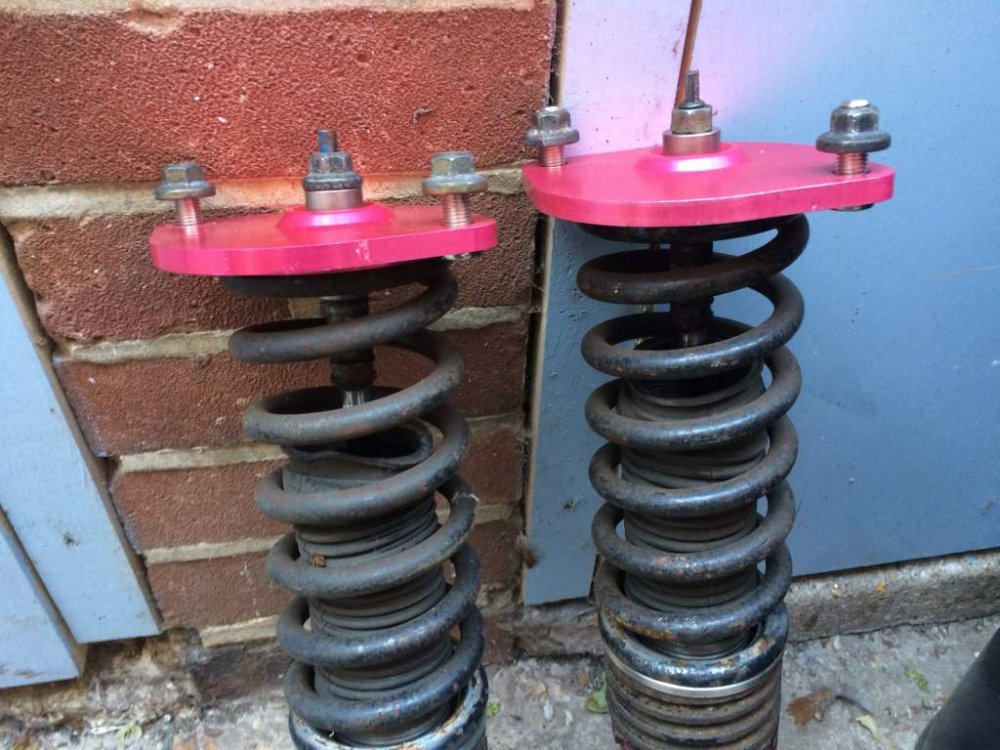

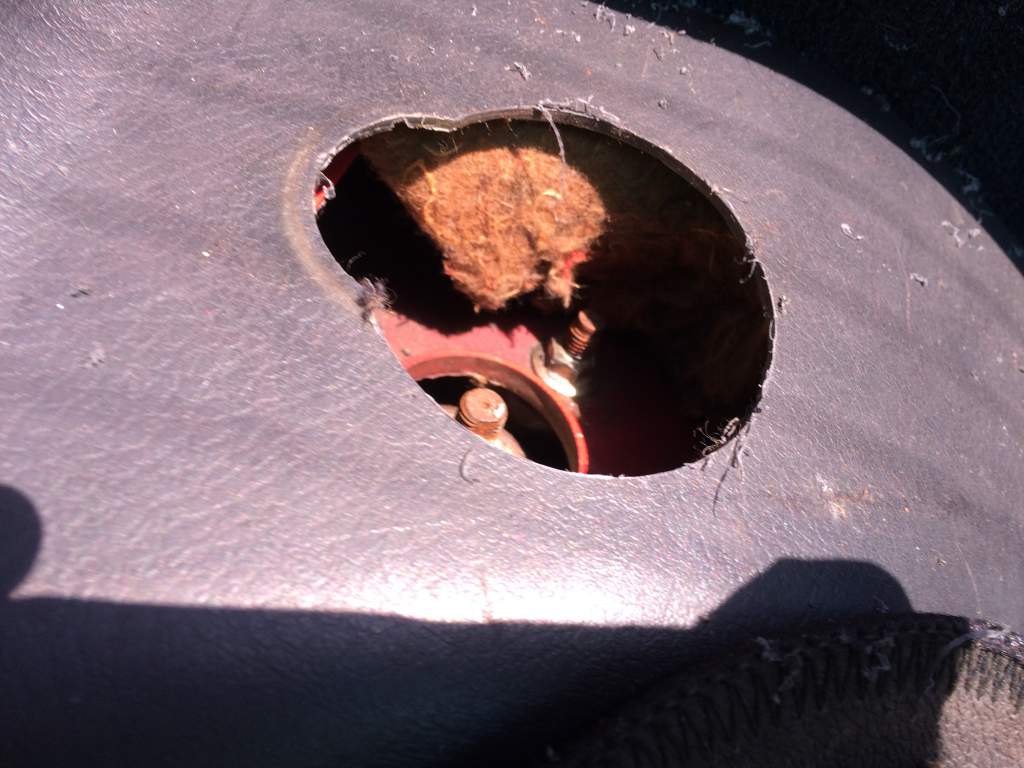

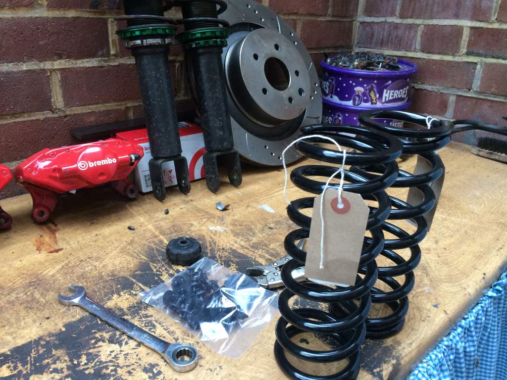

Rear shocks are now out ready for the 4kg springs.

Some bits turned up today. The new rear springs and some arch clips. Just got to find time to install now. IMG_0882.jpg
Nice Stephen, .......... do you have a sweet tooth?
