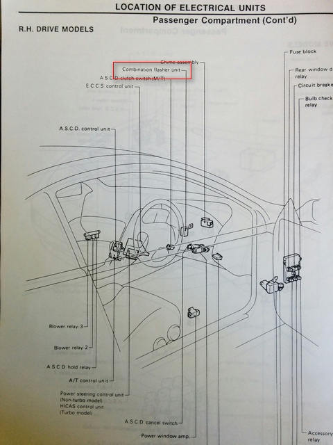

Can anyone confirm, is the indicator relay on the accelerator pedal on a series one J spec?
Can’t be that then, I’ve not been near that. Grr. Cheers again Andrew.

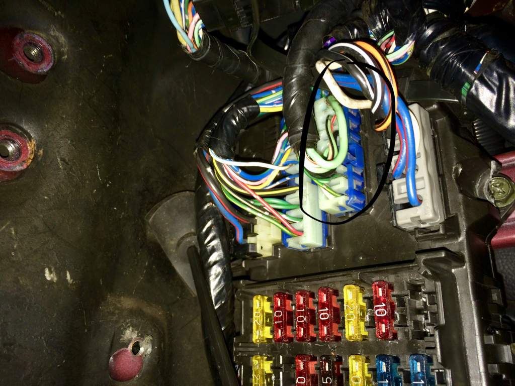

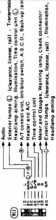

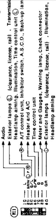

With some faffing about a pile of blown fuses, I’ve worked out that if I remove the plug marked M11 on the fuse board not only does the indicator switch off but the fuse doesn’t blow. Still no engine lights etc. This is the plug;

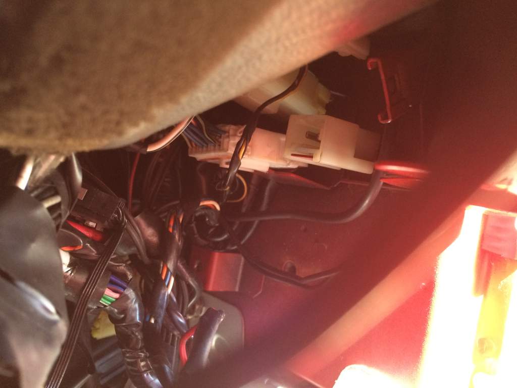

Also what’s this that’s unplugged?
There was a spade connector with red cable and an inline fuse going to the centre consol, chased that down to a dead end, bin. 1g saved :D

A bit of a long shot, but I would check some of the internals of those connectors pictured next to the fuses.
The reason I say this is that there is a possibility of some of them getting wet at some point in their lives due to faulty targa drains.
It took me the best part of 2 years to discover one of mine had green corrosion on the inside of the connector itself!
I dismantled mine to find the green verdigre had spread across several internal wires.
ps, may be worth checking some of the other connectors further down also.

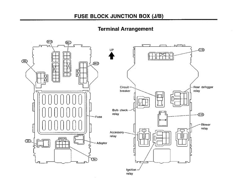

I’ve really got to sit down and work out where each of those pins goes. Ones for the stereo which stopped working ages ago, then power antenna which isn’t in use and the blower, which is what really started things.
A mate popped round today after work and we went through mapping the 12v signals from fuse box female connection M11. Then the same with the harness male. After discovering a 12v supply to earth, dead short with my new tool we then applied live to each 12v connection to see what lit up, in short (no pun intended) none of it. Odd. What we’d found frustrating is that the colour codes on the manual and the fuse box don’t match up. A cup of tea later and he was musing about connecting blocks, I explained that they are all different configurations and can’t be crossed over, so we decided just in case to inspect the fuse box. At this point something became clear terminal block M11 and E106 ARE the same shape. Not getting ahead of ourselves we applied 12v to the pins that correspond and the dash lit up where it should. Putting my big boys pants on and proceeding with caution with this new found evidence I reassembled it all and powered up.
And.....drum roll,
SORTED!
So the original fault was quite rightly the aftermarket relay failed and then I assembled the fuse box with two terminals mixed, ones on the front and one on the rear so it’s not a glance the solution issue. Thank Christ for that!
