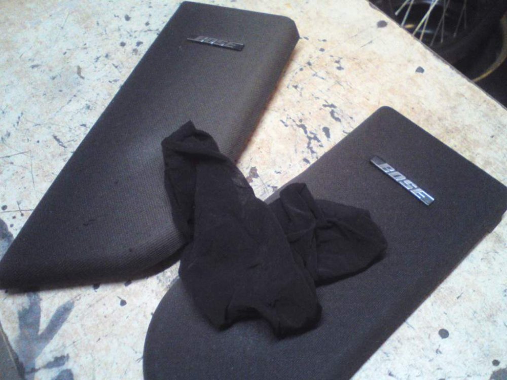

This below is a picture of my Bose rear speaker covers, not sure if it's specific to the Bose ones but the part number is 28190-30P00 and they're discontinued.
I have put the new fabric on top to show how faded mine were.
Now i'm going to keep the fabric i am using a secret for now but below you can see the darker area that was protected from the elements by the Bose 'badge' on the original 20 odd year old covers.

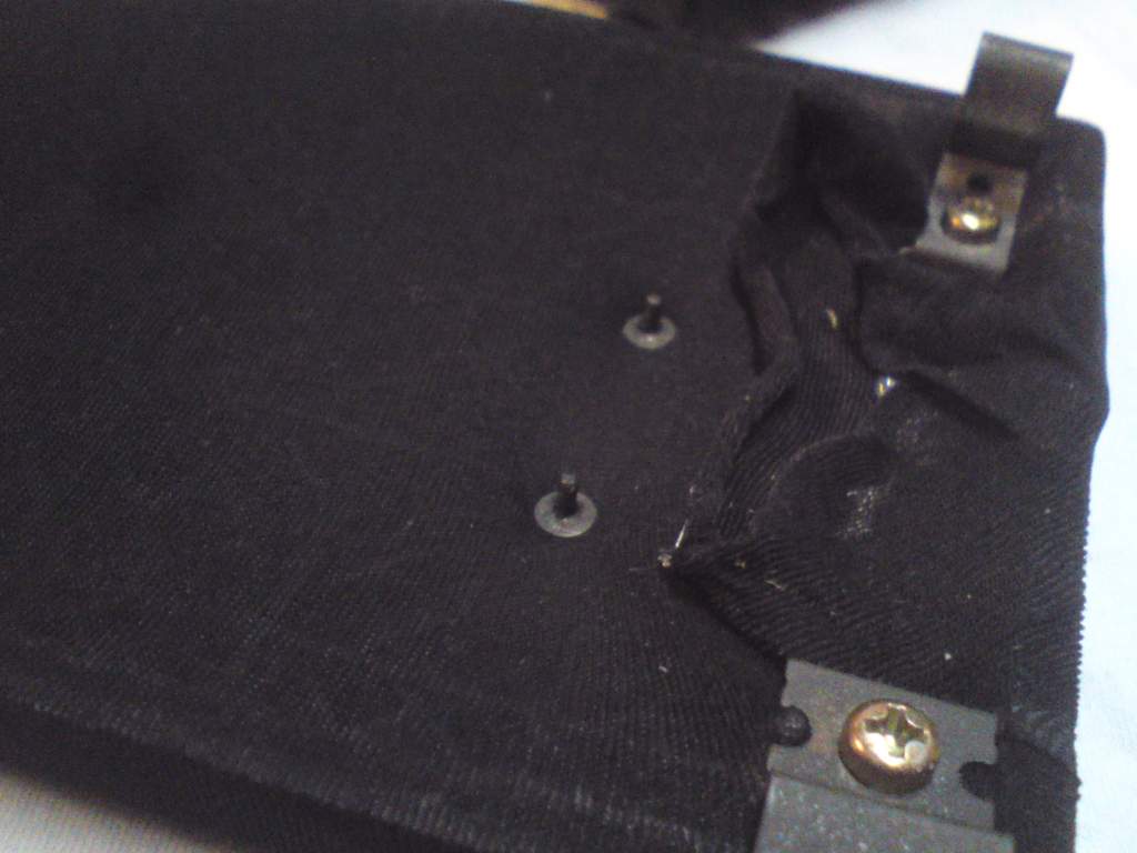

The badge is held on with these, i thought they may be difficult to remove but it was easy, it's a combination of teasing up the retainer ring and pushing down on the proud prong, then put somewhere safe as they're tiny.

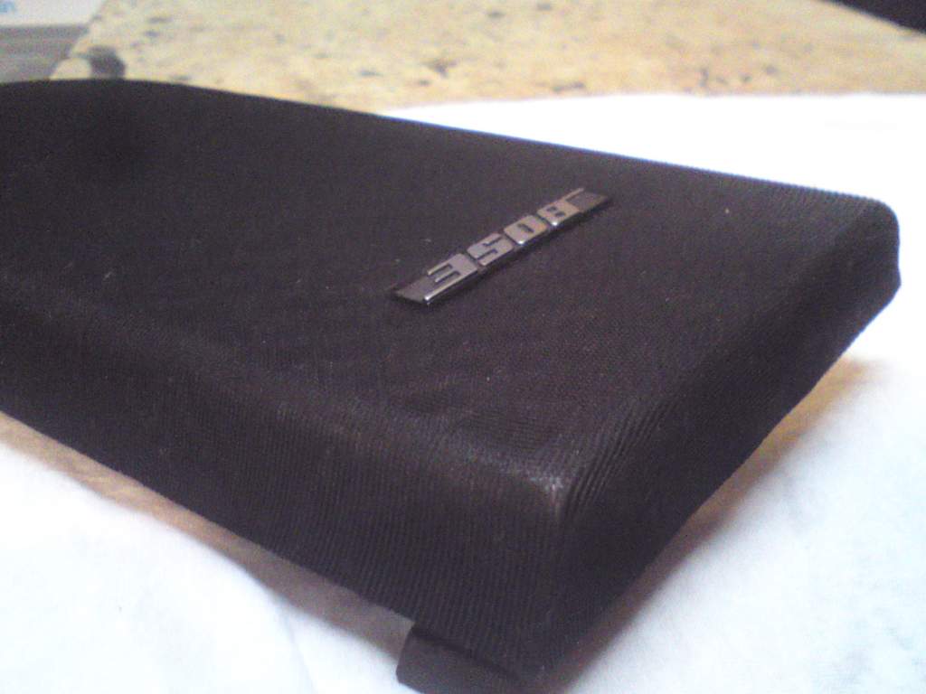

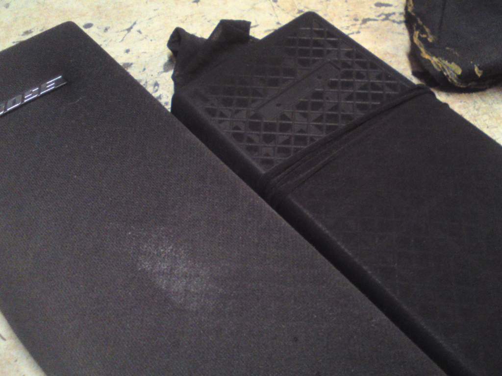

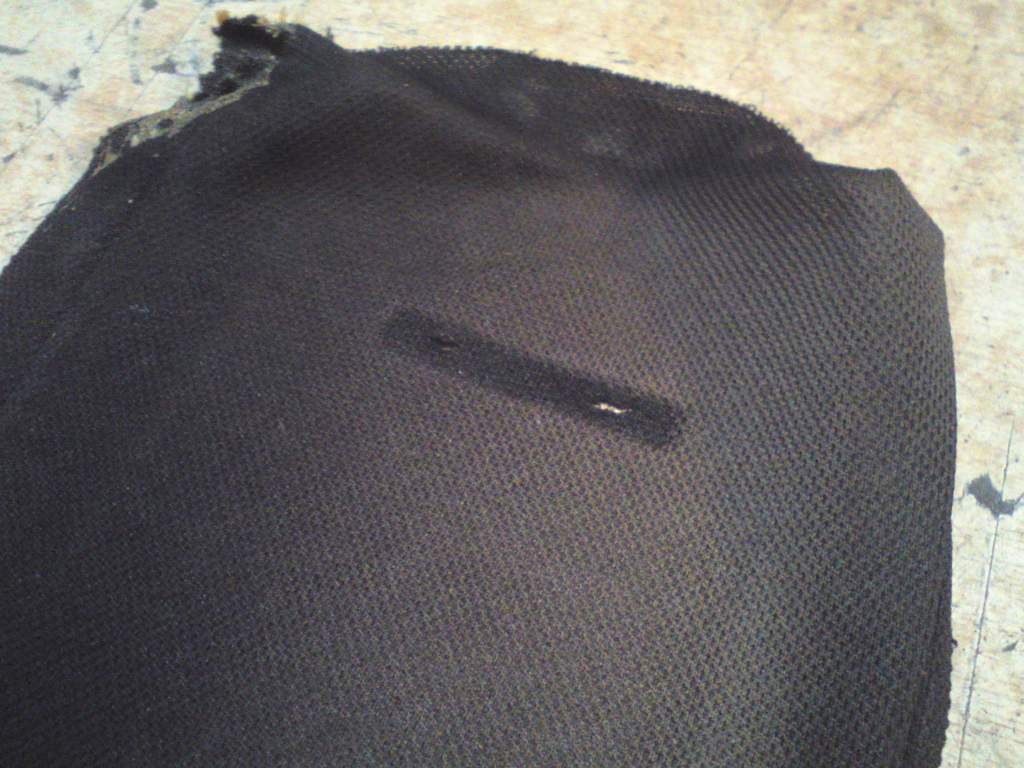

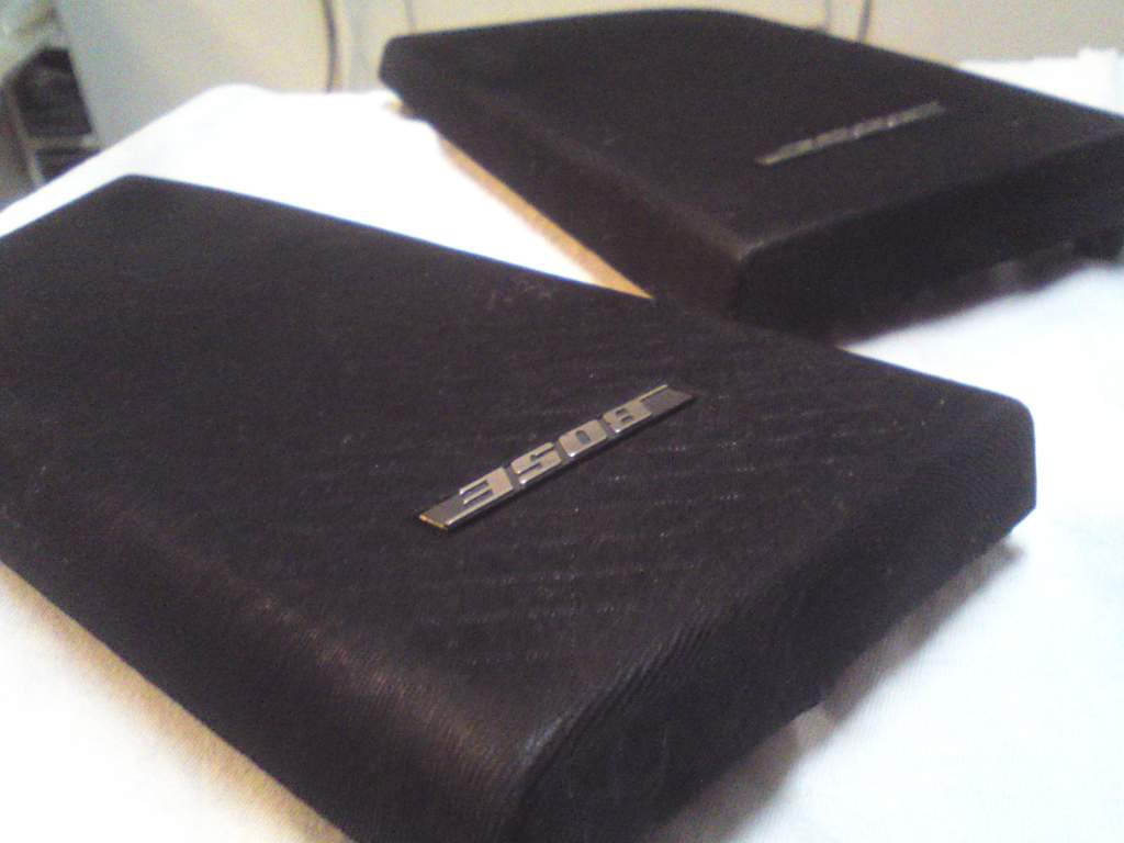

She tells me they were never worn !! After cutting off the lacy tops :blush:, i slid over and you can see below at the top it's on once and hardly covering the lattice plastic work but the lower part it's doubled up, these may look good stretched and thin on soft shaved long legs but for this job doubling up is a must.
Some of you fellas may have your own stash for those special evenings but these really do work well and took me no time at all to cover.
There's not a great deal to pin down on the underside because of their naturally clingyness and a drop of hot glue works a treat in the odd place or two.
The prongs of the Bose badge are just pushed through and the retainers do there job......

In my own little world i am happy, longevity i'm not so sure but i believe i have the correct denier on them....

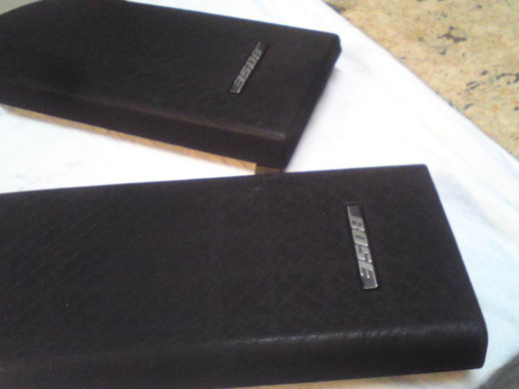

Final pic in the car, you can see the blackness achieved, contrasting against some of the plastic boot trim pieces......
