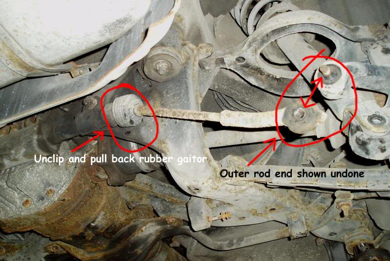

The problem here is that it is unlikely the tester could determine for sure if it was the outer or inner bush where the wear was, this requires two people one to shake the wheel and one to hold the two bushes separately and see which needs doing. A vast amount of the time its is the inner unit, this is so much easier to change.
If this is the case I made a tech thread a few years ago about changing the arms, see link below with pictures. Note though it is for earlier non electric hicas, the only difference when changing is the later electric ones are easier to change as they do not need to be locked off on the opposite sides, and for your info the later electric ones do use different arms to the early type, easy to find though.
Link >>>> http://www.300zx.co.uk/forums/showthread.php?147816-Hicas-arm-replacement-tech&highlight=hicas+tech

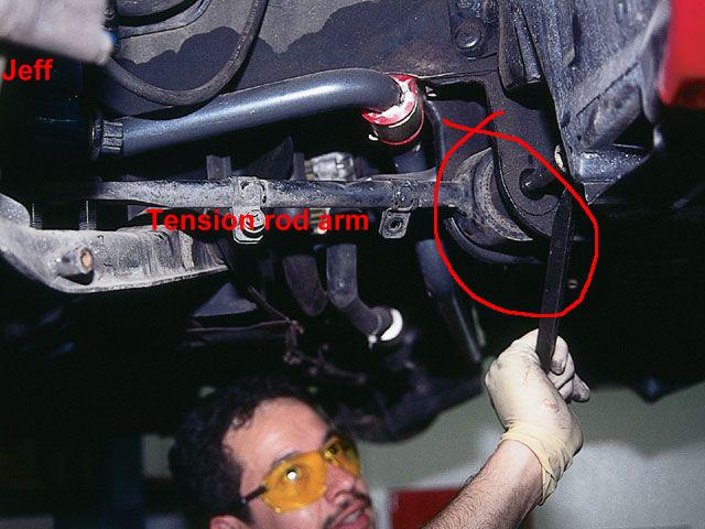

These aren't too serious. but could this cause the movement I feed when I hit the brakes? Feels like there is a slight forwards/backwards movement when the brakes initially engage. really annoying but I have not been able to pin it down yet.
So it is possible the lower ball joints are worn, however if your getting slight forwards/backwards movement when braking it is more likely the tension road bushes, these locate the front arm position ( see picture ) for these you will need a press to change the bushes, but quite easy to remove and drop in at a local garage to swap the bushes for you and then you can refit them to the car.
