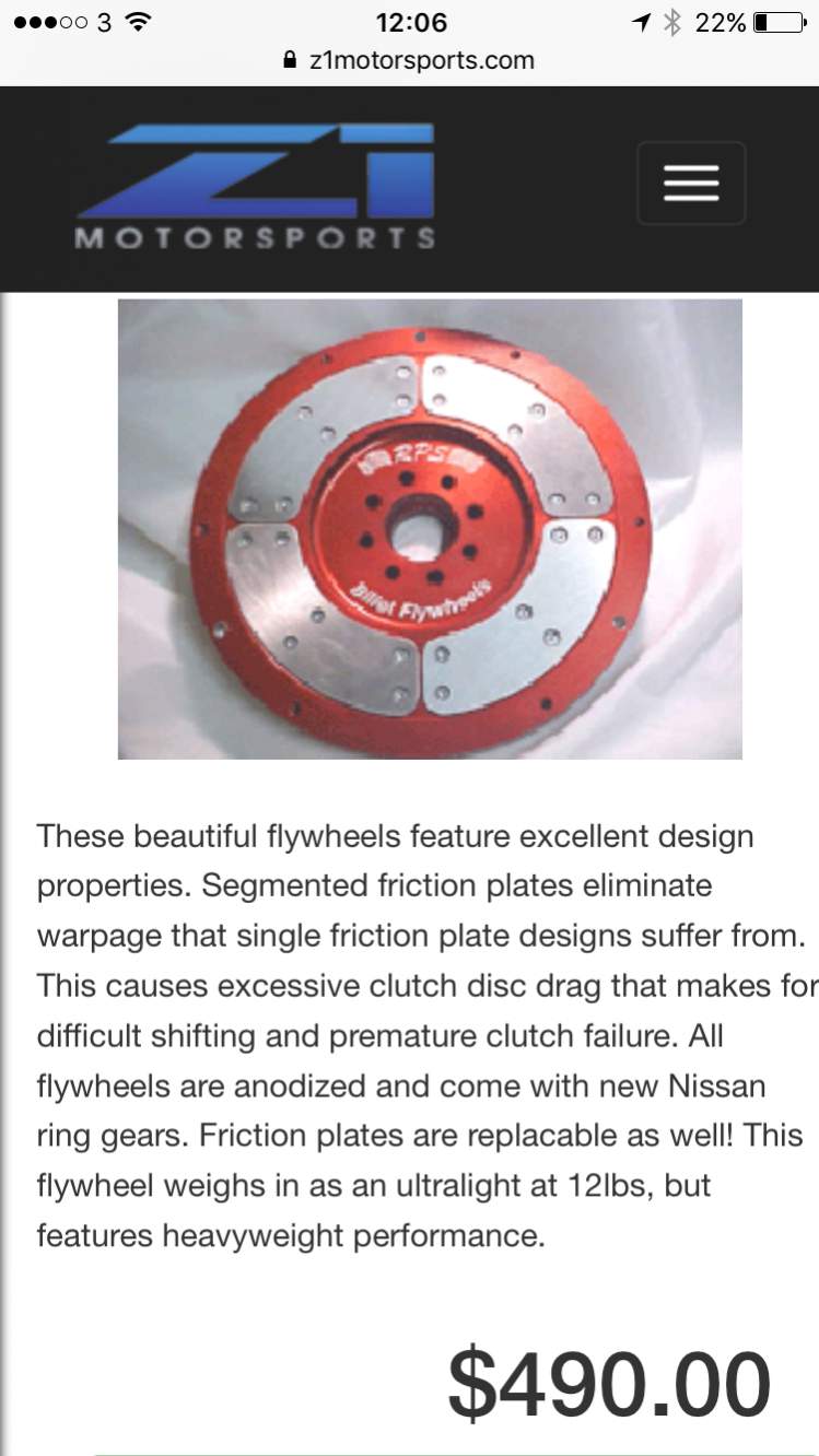

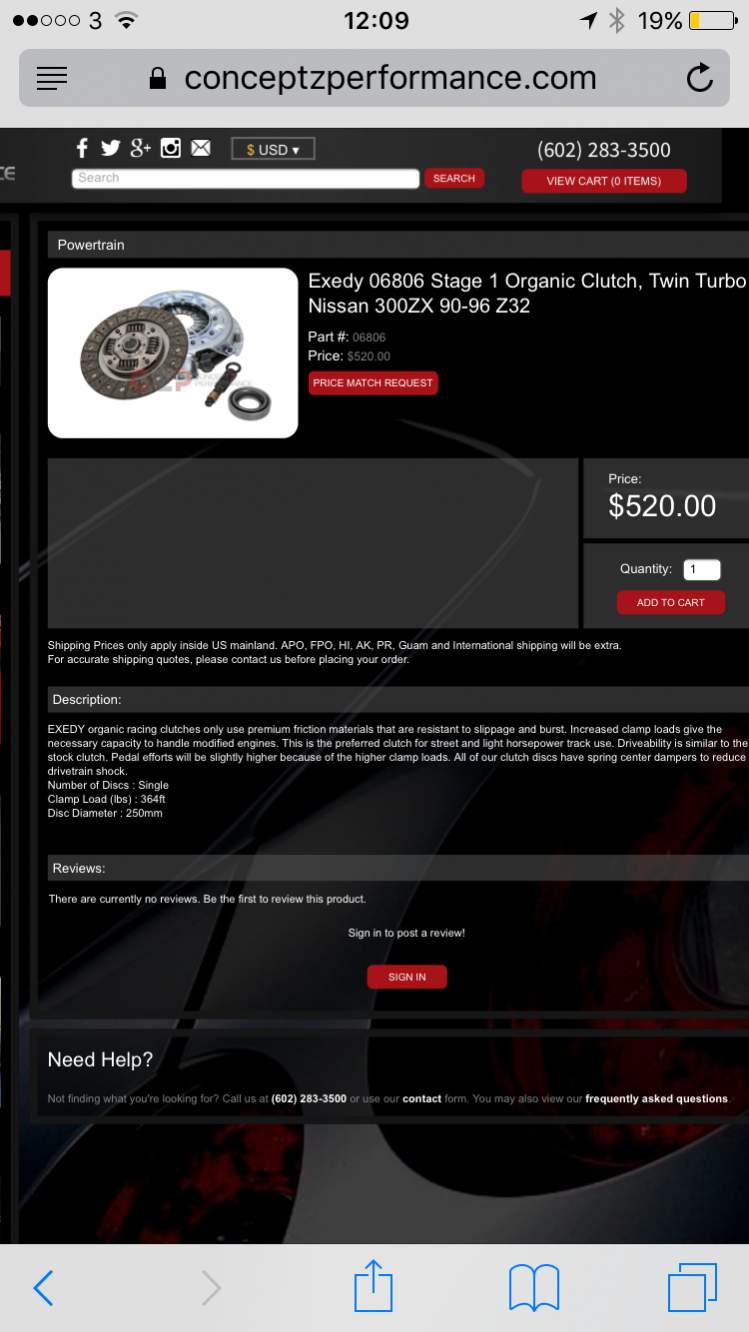

I've got the RPS Lightweight Segmented Flywheel from Z1 back in '09, I've an Exedy Stage 1 Organic clutch mated to it, haven't done any more than 3-500 miles on them though:no::no: i'll be swapping out the Exedy for an XTD Stage 3 over the next week if it's any use to you Si:thumbup1:

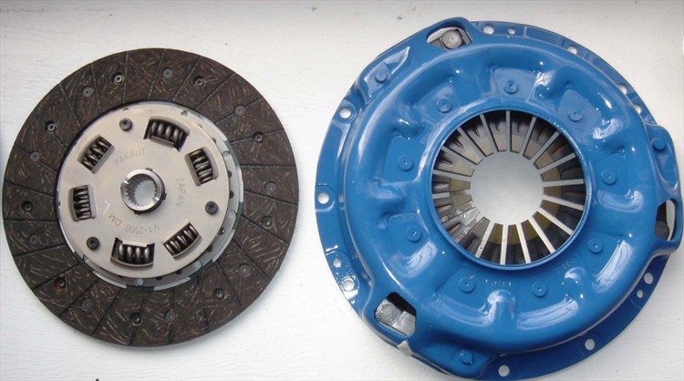

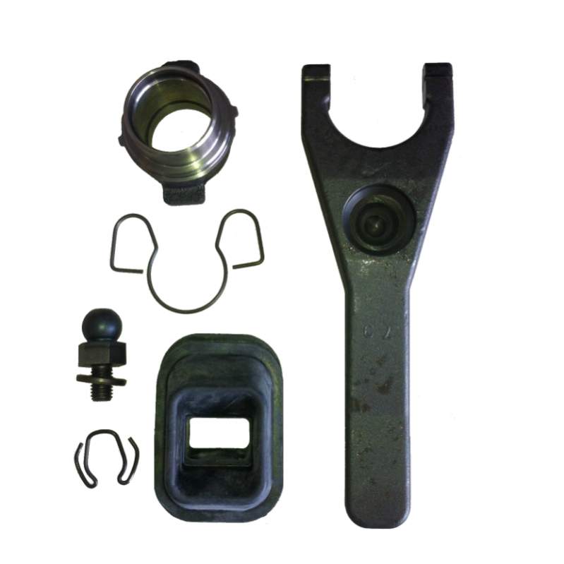

The RPS from SZ, with the redesigned fulcrum (silver casing), is as light or arguably lighter than a stock clutch, its lighter than my daily drive! It has a proven track record for quality and reliability and will handle buckets of torque. Just make sure you pair it up with the uprated fork kit.

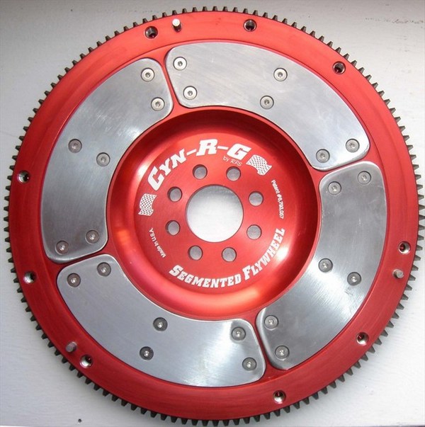

I have the RPS MK1 clutch and segmented RPS flywheel. Heavier than stock (but not by much). MK2 is lighter.
Uses the stock friction plate and has smooth takeup. Very tough and reliable. While you have the gearbox off
worth fitting a 350Z cast iron fork kit.
And the bonus is the rps flywheel can be repaired,new faces are available as a kit around 100 dollars,tbh i dont like Fidanza the faces warp as its a solid bolt on plate that cant expand and contract like the segmented RPS,And you dont need a puck clutch Si a full face will cope fine with your power levels.
Heavy duty clutch fork, pivot ball, throw out bearing are all jobs you must do while changing the clutch.

The RPS Flywheel is one of the best flywheels available to the Z32, Specialty Z are so happy with the RPS that they're now working together with the SZ-RPS clutches, they even state on their own site that the flywheel was so good they couldn't improve upon them:thumbup:
