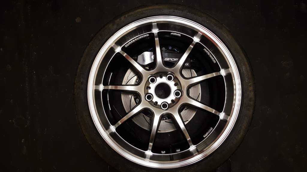

  • And they have arrived !

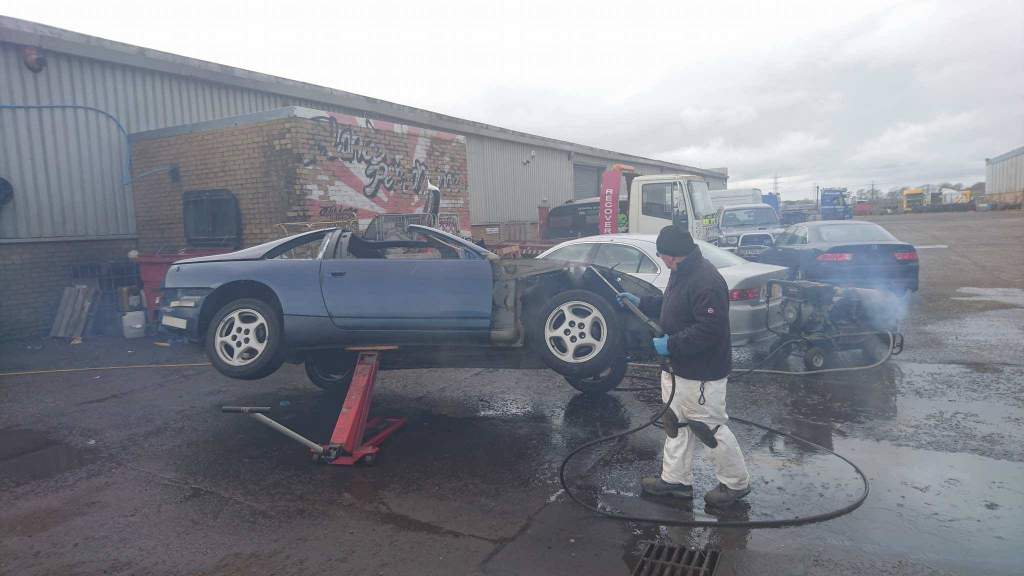

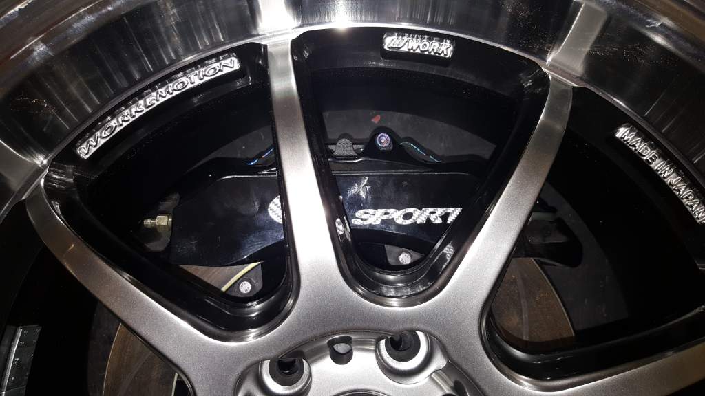

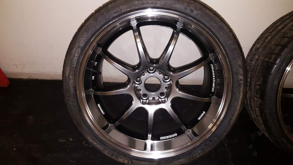

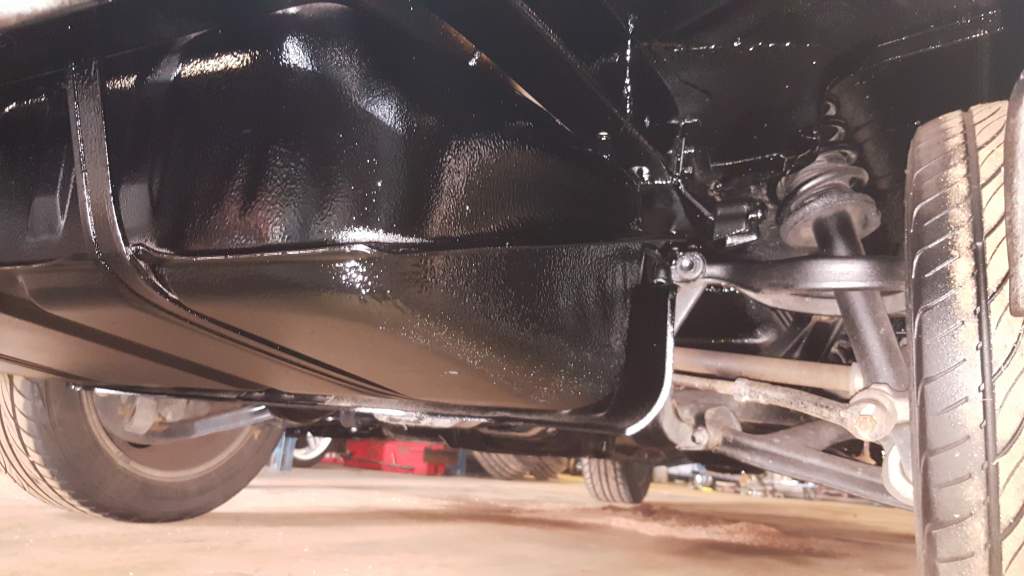

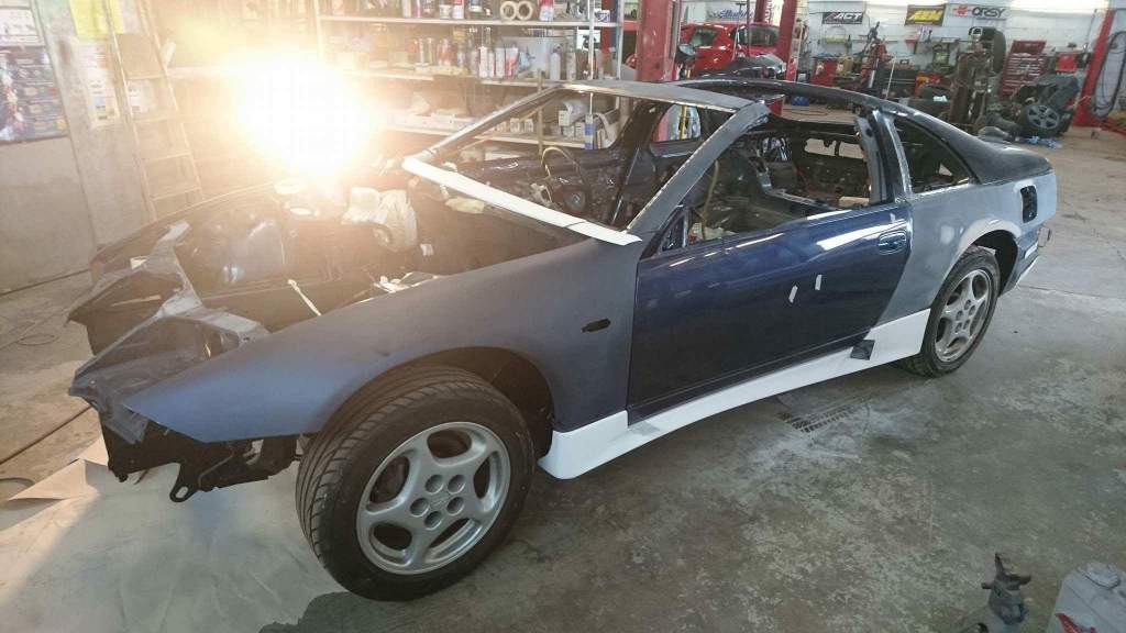

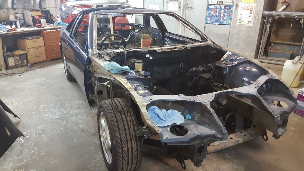

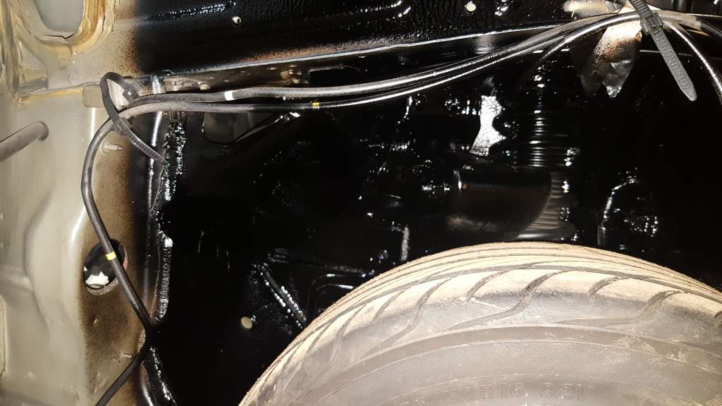

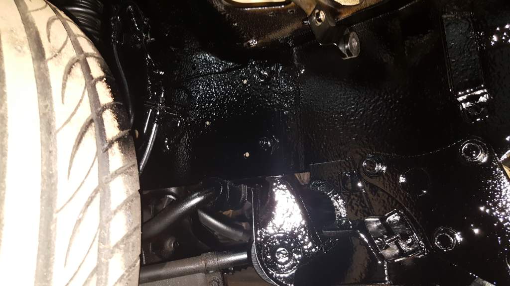

Short visit to see the zed today and shes looking bare again with everything now removed.
Few areas looked as if they have been treated well and they have started to sort out the surface rust
near the battery area.

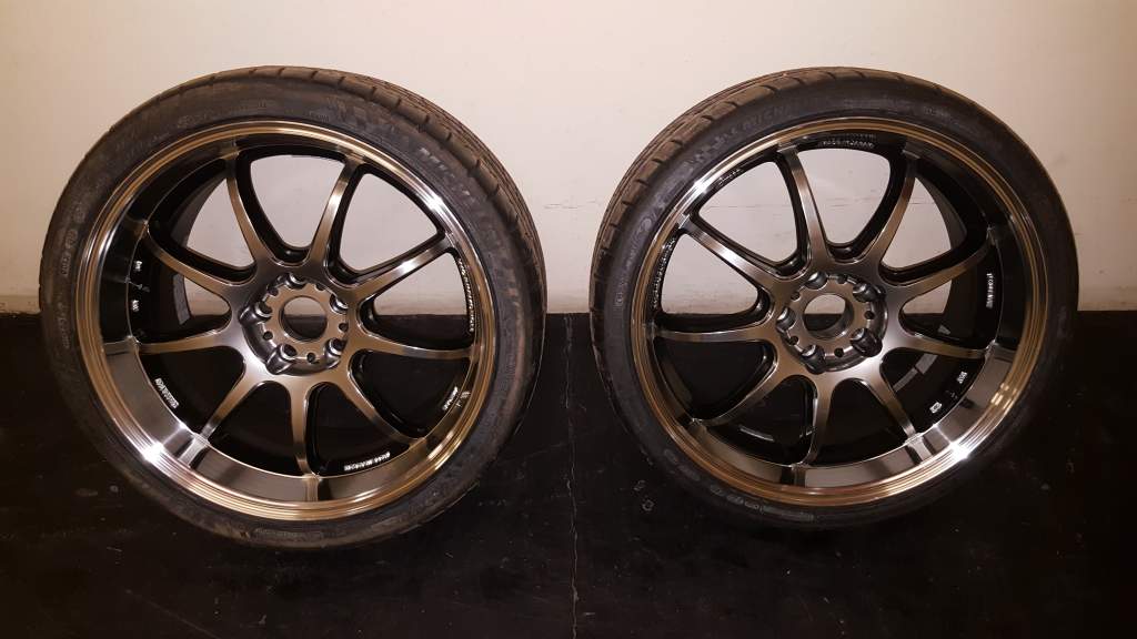

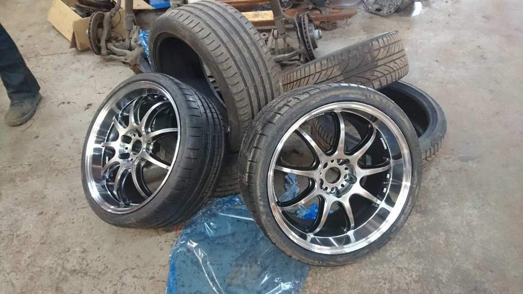

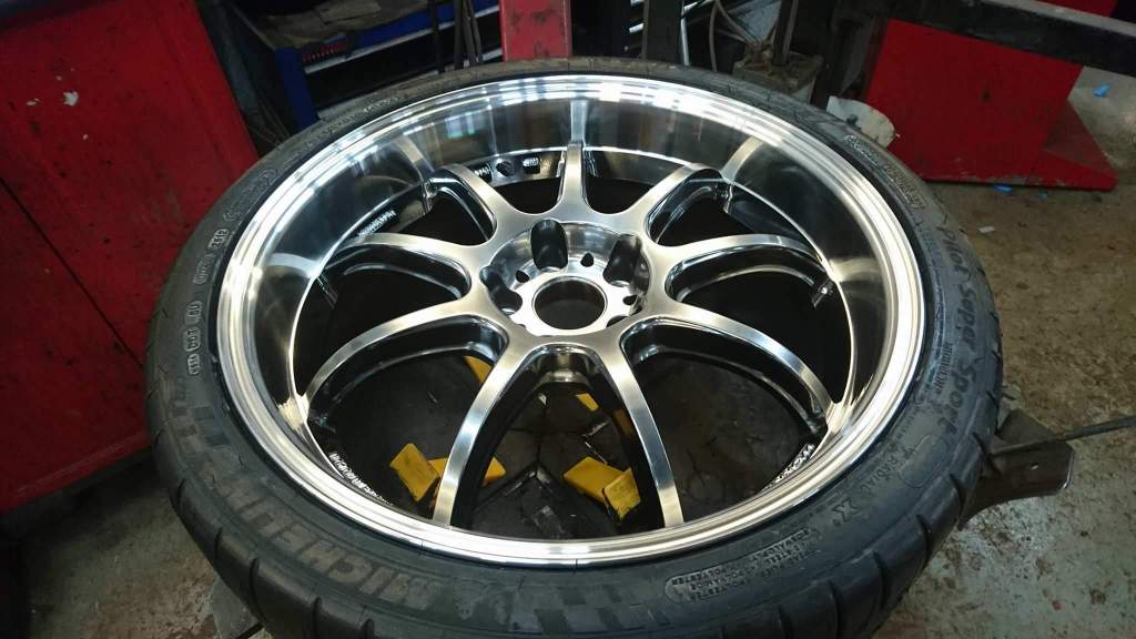

I've been really keen on seeing the tyres on the alloys but the garage have said they have ordered new
plastic rim parts for the tyre machine they use as to not damage my new rims.
Just have to wait until next week to see what the wheels properly look like.

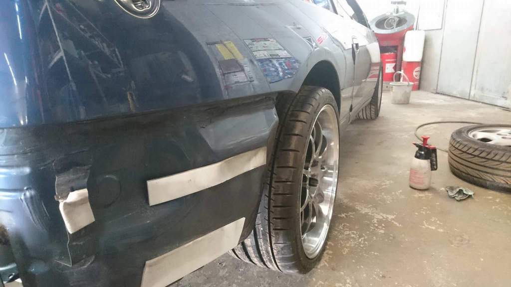

Ive a feeling this build is going to be as good if not better as the last ill fated one...great work so far.
Just be careful with the ride height bud, the side wall of those tyres is very "square" much like my PZERO's all looks well but they hit the return lip in the arch if you are not careful. Had exactly this problem with Zeb the old tyres were Eagle F1's and cleared because of a slightly more curved sidewall so no problem but the Pirellis catch so will change back to F1's when these are done.
Looking sweet though going to be an epic car again.
Already had the arches rolled to allow for extra space.:thumbup1:
