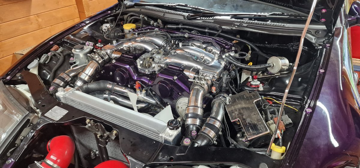

Nearly done, just the starter, exhaust and a few little things like wiring for the wide band sensors !
All fluids apart from gearbox has also been topped up which i'll do after i go get some.
Also had the first blood of war an hour ago when i stabbed myself with a screw driver taking a fuel hose off.
Spot the man bandage; only the best !
Tonight on JaiKai Tv....
Last night i managed to get nearly everything done apart from some of the fluids.
So that would include :
starter,
clutch piston,
Exhaust,
Radiator,
Front cooling fan,
Inter-cooler pipes
All ready for first start i managed to get the ground harness cable attached to the gearbox and installed the battery for first start.
I removed the fuel pump fuse so that i can prime the oil in the system and connected the battery up.
The zed came alive and starting chiming with the doors open and the interior lamp turned on for the first time in 3 years.
Quick check over everything we are ready for first crank..
And we get nothing, nadda.
Spent a further 2 hours goin over all cabling and checking the ecu but she simply wont crank over.
I'm thinking now either i have a power issue going to the starter or my starter has simply jammed.
Gave in for the night and will likely need to do some diagnostics another day.
I'm not very happy chappy at the moment but hopefully its something simple.
Latest troubles.
I think one side of the engine isn't firing and then it fuel locks - just a guess.

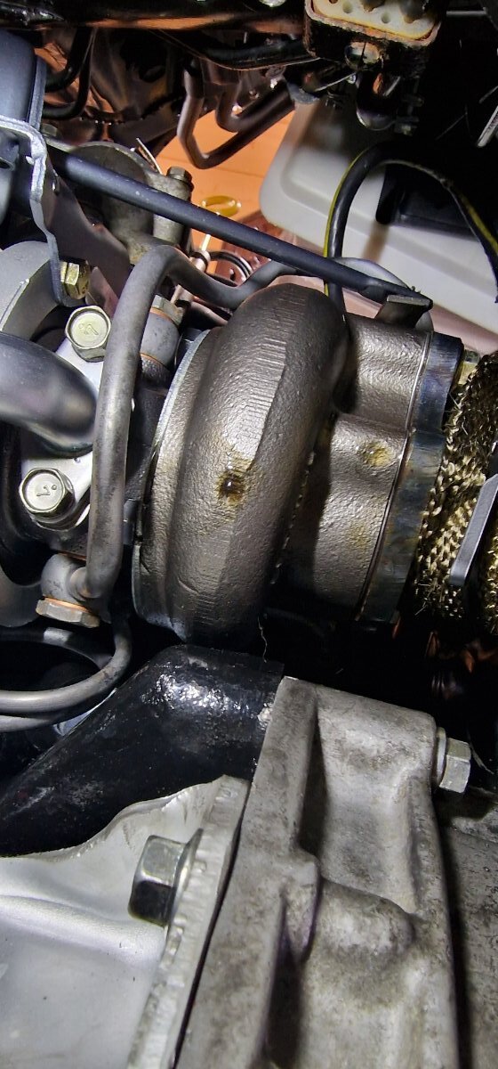

I saw an oil leak on the passenger side turbo as well as a smell of fuel.

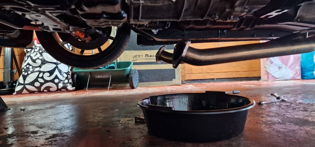

So I disconnected the test pipes and I would say half a pint of fuel poured out the exhaust.
Done the same to the driver side and it was bone dry.
In you case I would change the oil, you have spent enough time and money to take any more gambles.

I've swapped out the oil just incase but as the turbo seal seems to be leaking i may need to pull the turbo now.
