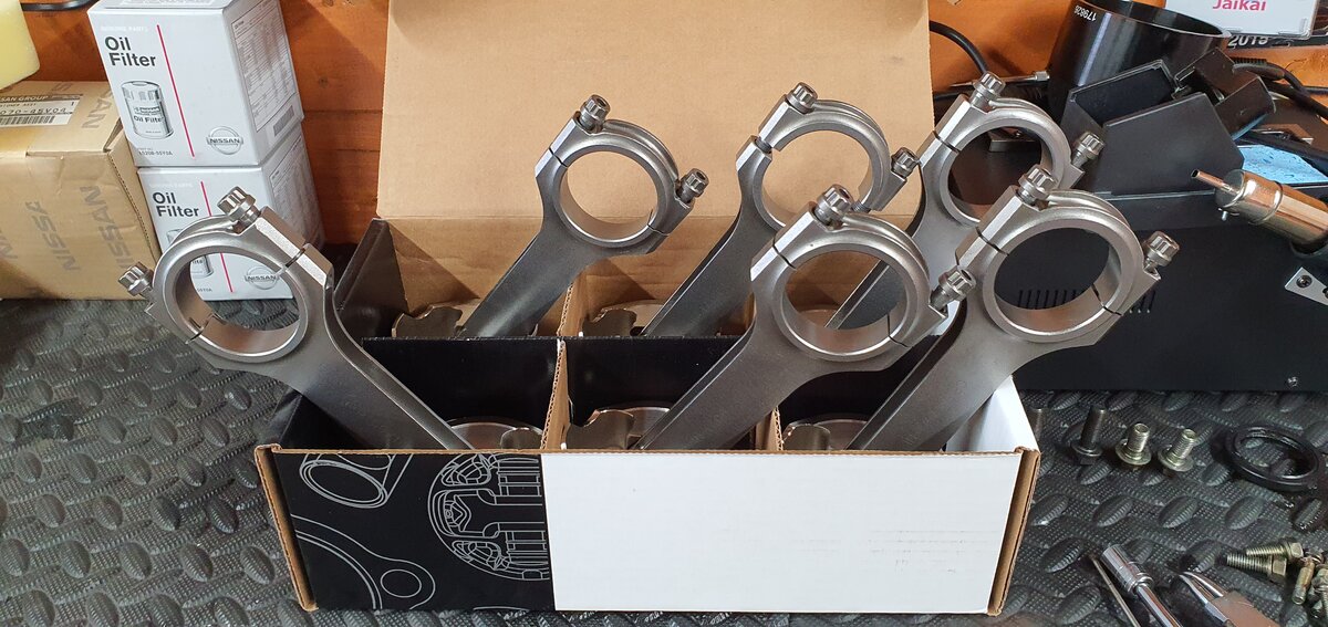

Wiseco Pistons and Eagle rods at the ready, took me a good few hours to get them connected;
Biggest peeve with putting the rods on the pistons was the cir-clips.

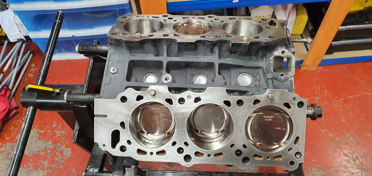

Couple of hours later and with help from a proper wiseco piston installer all 6 were fitted in place.
Whole crank and piston assemble rotates smoothly and i've added some oil to lube the cylinders up prior and after the pistons got installed.

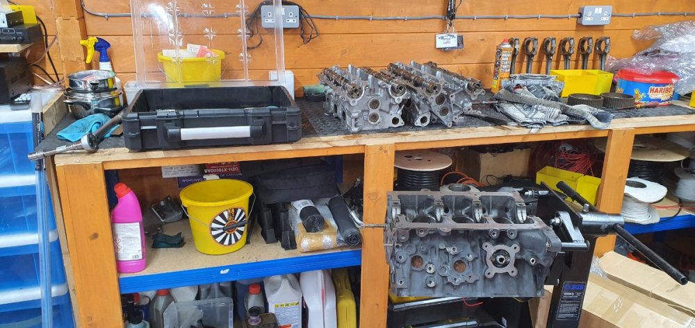

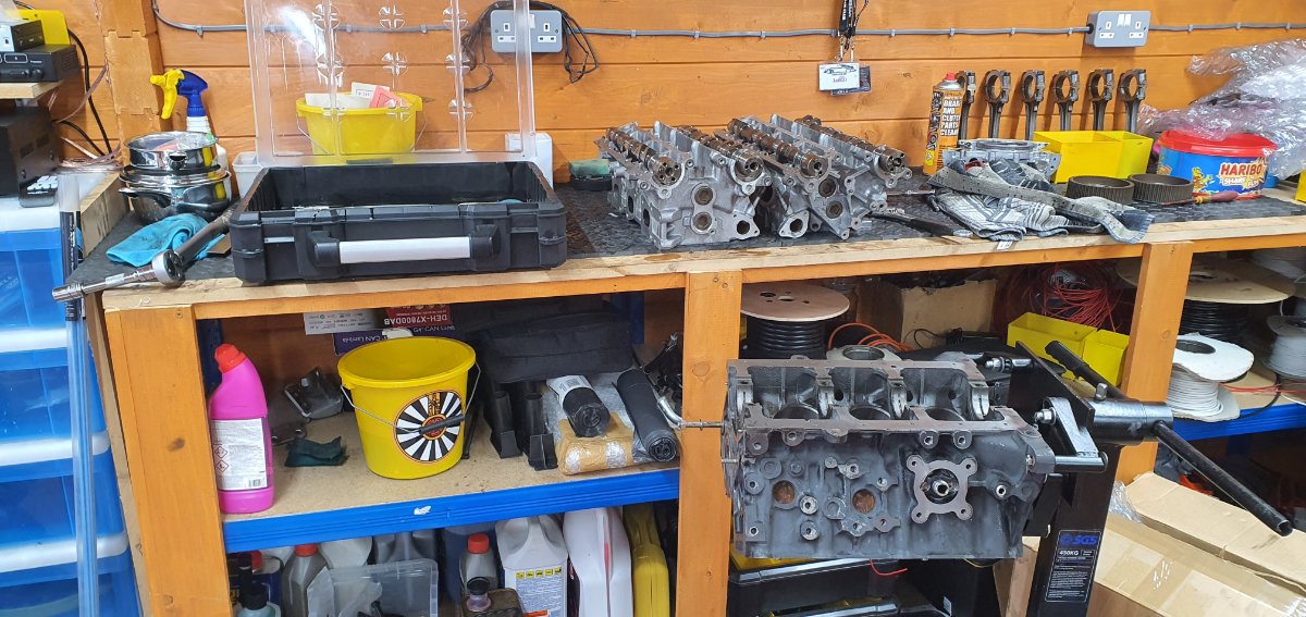

So i have broke the engine apart again ?
And partially reassembled the heads ready to be sent to an engineer works to refurbish them.
However one of the cams seems to be binding so i'm not trusting them at all now.
The cam shafts have been stored in oil for the last few months and have only a small amount of surface oxidisation.
When placing the cams back on the heads the interior right bank seems to jam up compared to the rest and i haven't even put the caps on yet.
I would expect to be able to rotate a few mm which the other three do fine, also it seems to rock in position as if the middle section was higher seated.
