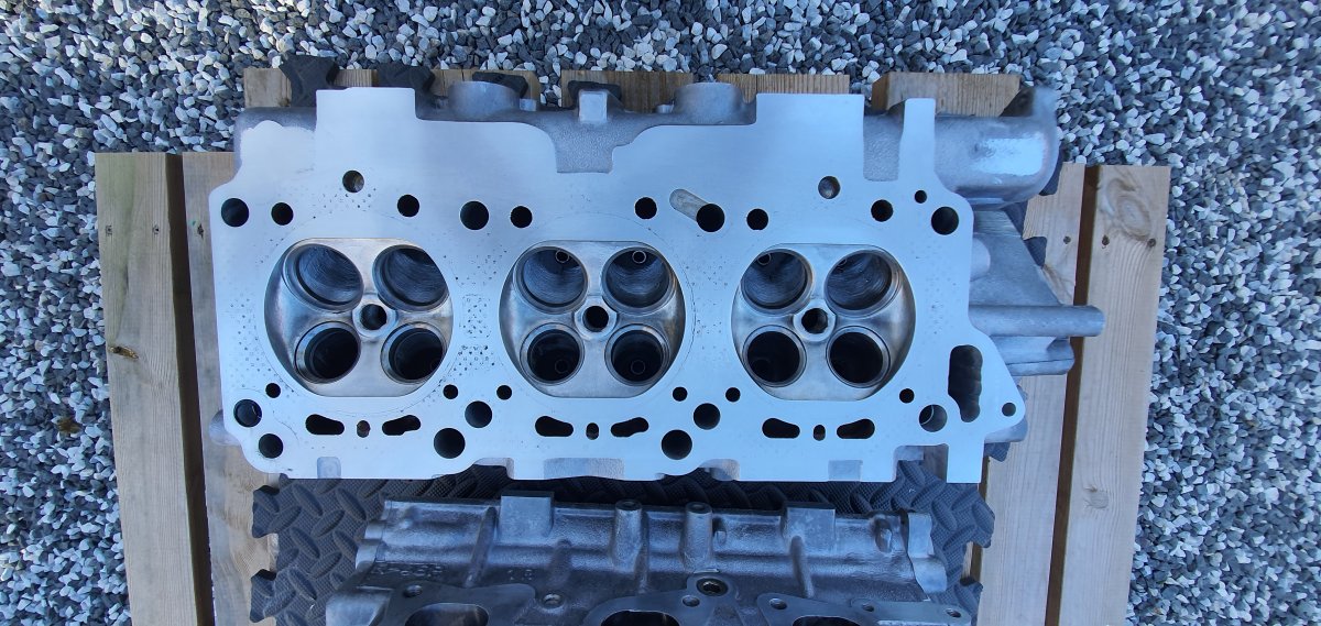

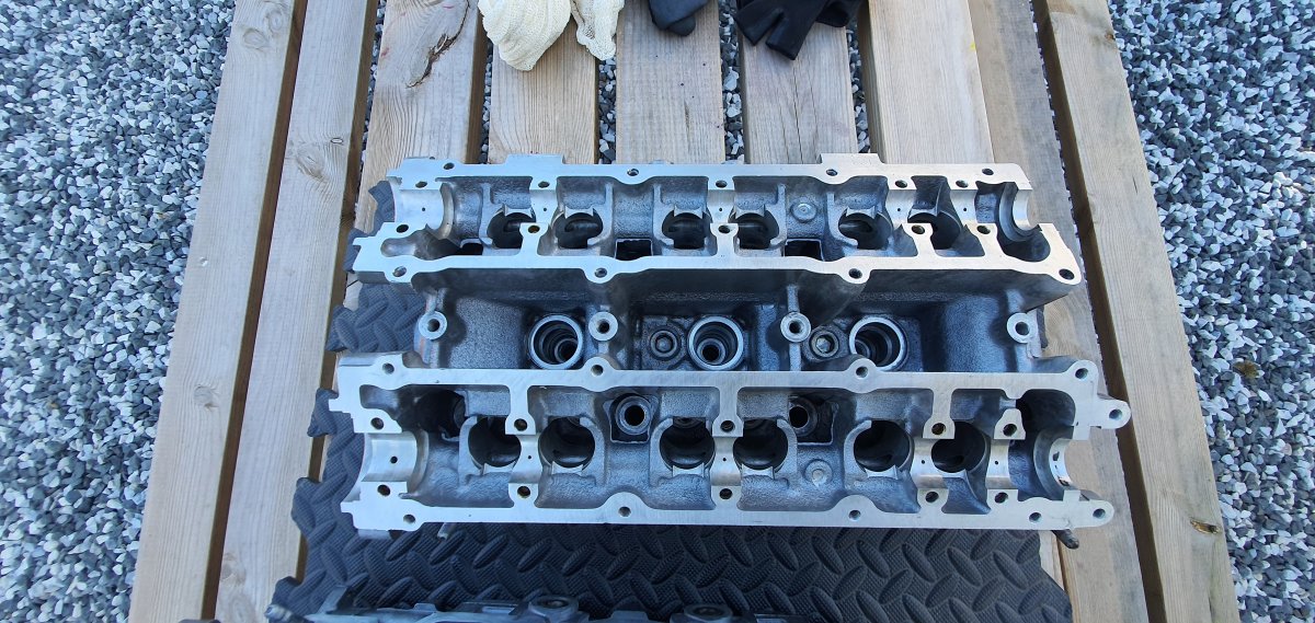

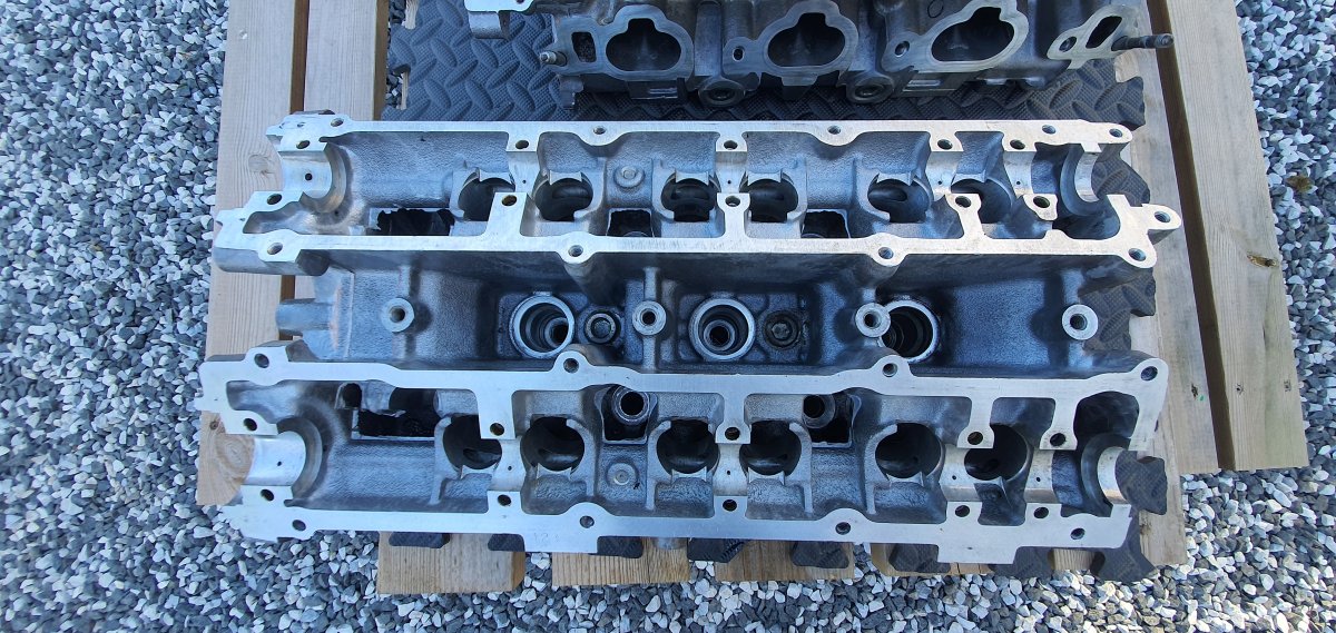

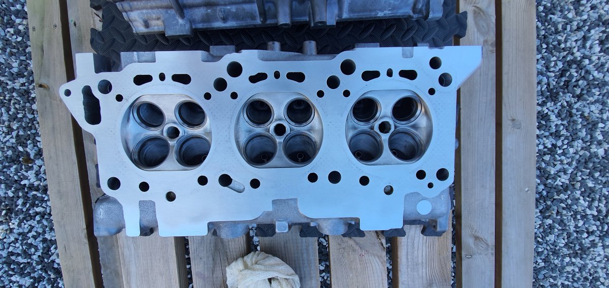

Where i am now is that i once again have to rebuilt the engine from scratch; but this time everything has to be scrubbed clean to make sure
that no contamination of the previous engine has got into the new engine.
The engine has once again been removed, stripped to the block and the cleaning process has begun.
I'll upload a few pics to show the process shortly.

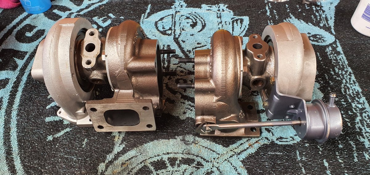

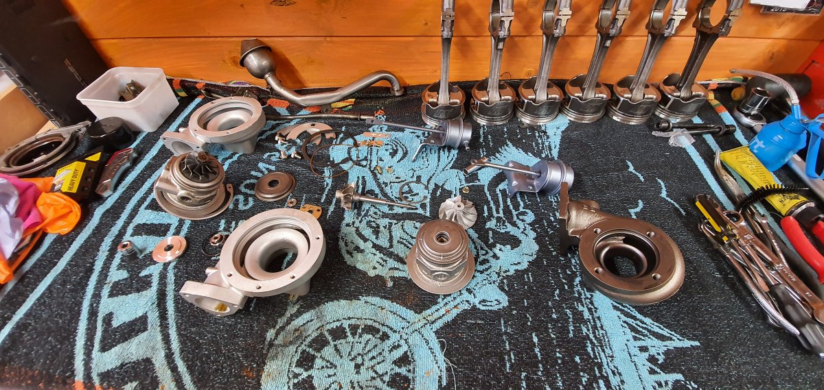

After the oil got contaminated and slightly washed down with fuel the turbos also ceased up.
I decided to strip them and do the rebuild myself as the costs for that at the moment to be done professionally are just too much.
Here the first one is stripped down.
Took me most of the day to clean these but using an air gun, wd40 and a can brake cleaner i got them to near new condition again.
On assembly i used fresh oil to lubricate the bearings and everything fitted together again perfectly.
I now have two turbos with freely spinning shafts and propellers.
