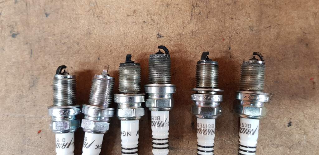

So after trying to start my zed many times with various fuel setting i've managed to foul up my plugs ever so slightly.
4 of them are a little worse for wear so i've ordered a new set, after which i'll start the process again.
Hopefully after the new plugs arrive i will have her started by the weekend.
